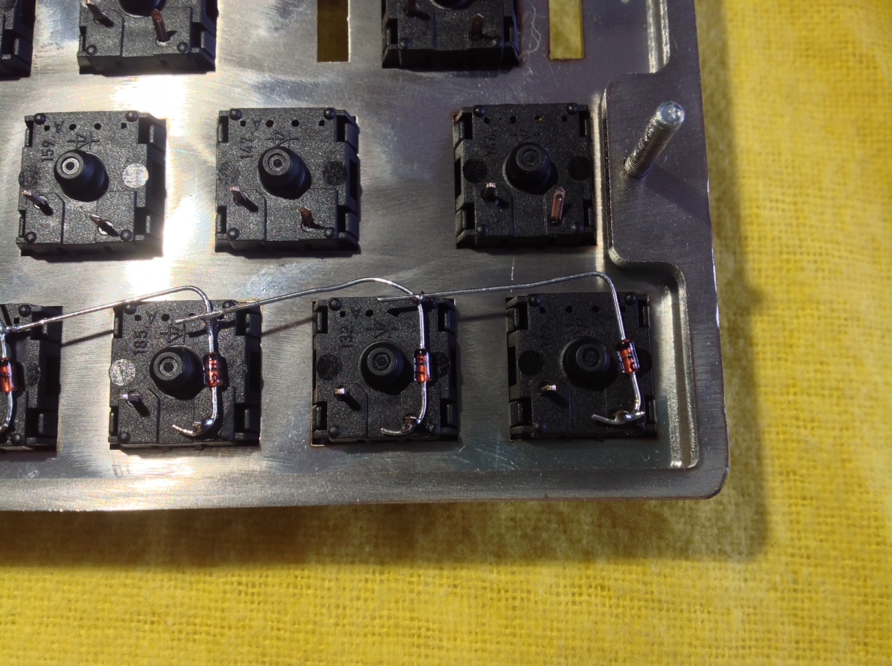

Okay, half an hour with the soldering iron, bending diodes along the way, and I have the first row done. I've done things differently from Matt3o's guide because my design prevents that:
photo 1.JPG (289.84 KiB) Viewed 6181 times
Note the slender clearance with the shiny layer at the back — the half-height mezzanine layer — which likely means some pin bending or trimming for that half of the keyboard. I'm attaching my diodes nice and flush with the switch housings to give me leeway on that. I'm about as quick with the iron as Matt, so no plastic was harmed in the process.

Posted: 10 Oct 2013, 14:01
by matt3o
you know that you have to go around the screw inserts, right? not above! (sorry if it sounds silly :) )
of course start from the most complex part and leave the easy tasks at the end.
Posted: 10 Oct 2013, 14:06
by Muirium
Yes! That's what I mean about using insulated wires (like with the columns) for jumping around those sections. The diodes which cross them currently due to be chopped. But they solder nicer with legs in place to help them sit right.
Posted: 10 Oct 2013, 14:46
by matt3o
Muirium wrote:Yes! That's what I mean about using insulated wires (like with the columns) for jumping around those sections. The diodes which cross them currently due to be chopped. But they solder nicer with legs in place to help them sit right.
you are doing well, then. I wouldn't solder the diodes so close to the switch chassis even though you have to cut the pins a little, but it's just a personal preference.

Posted: 10 Oct 2013, 16:42
by Muirium
Rows all done.
photo 1-2.JPG (476.26 KiB) Viewed 6163 times
Trimming the jump wires was the fiddliest part. Miniature soldering is fine, but trimming the ends of wires without cutting right through them never seems to get any easier! You use a scalpel to expose the middle bits of wire for your columns, don't you? Hmm. Not looking forward to working my way around that!
Posted: 10 Oct 2013, 16:52
by matt3o
seems good. a bit messy but should work :) I would cut the excesses where possible.
when you have to peel the wire at the edges the easiest is with your teeth :) If you can't peel them in the middle make small chunks and solder them one by one. longer but safer.
Posted: 10 Oct 2013, 16:59
by Muirium
Indeed, I've only done the "rough trimming" pass on the legs so far, not the "obsessive compulsive trimming" pass! Fortunately the conductivity meter says all five rows are perfect.

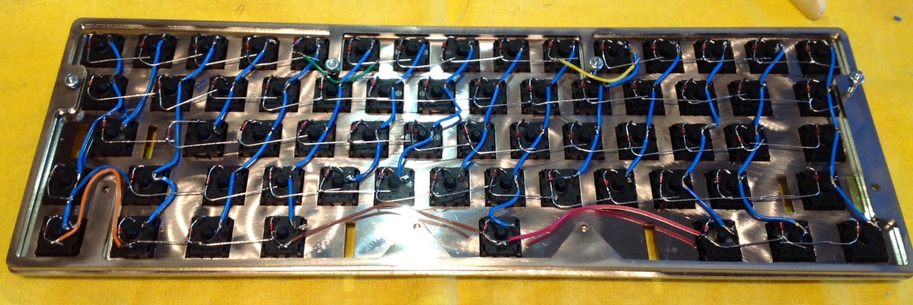

Last picture for the day (as it's getting dark already) now that the columns are done:

great progression Muirium.

Posted: 11 Oct 2013, 01:25
by mtl
Whoa.. that's some quick wiring! I am a slow poke. :-D
Posted: 11 Oct 2013, 01:32
by Muirium
Took about five hours, and as many cups of tea. I believe Matt3o is quicker and surely more precise. But I'm pleased with it for a first timer. Best of luck with yours! Be neat.
