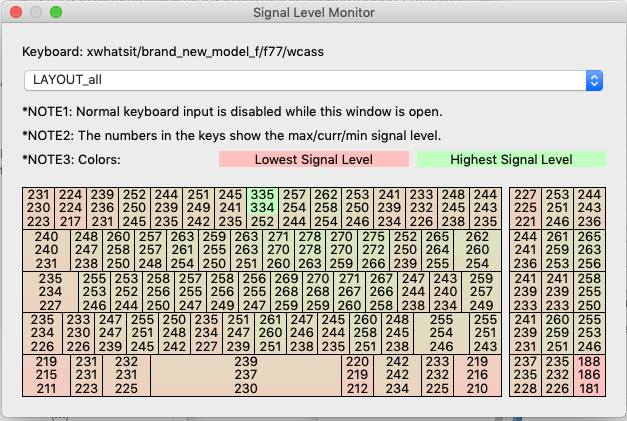

I tried to run ibm_capsense_usb_util.app v0.9.0 (latest on the xwhatsit site). I'm familiar with this program because it's what I use in my beam spring. But it just freezes if I select either of the 2 devices (that aren't the beam spring). Disconnecting the beam spring didn't help either.

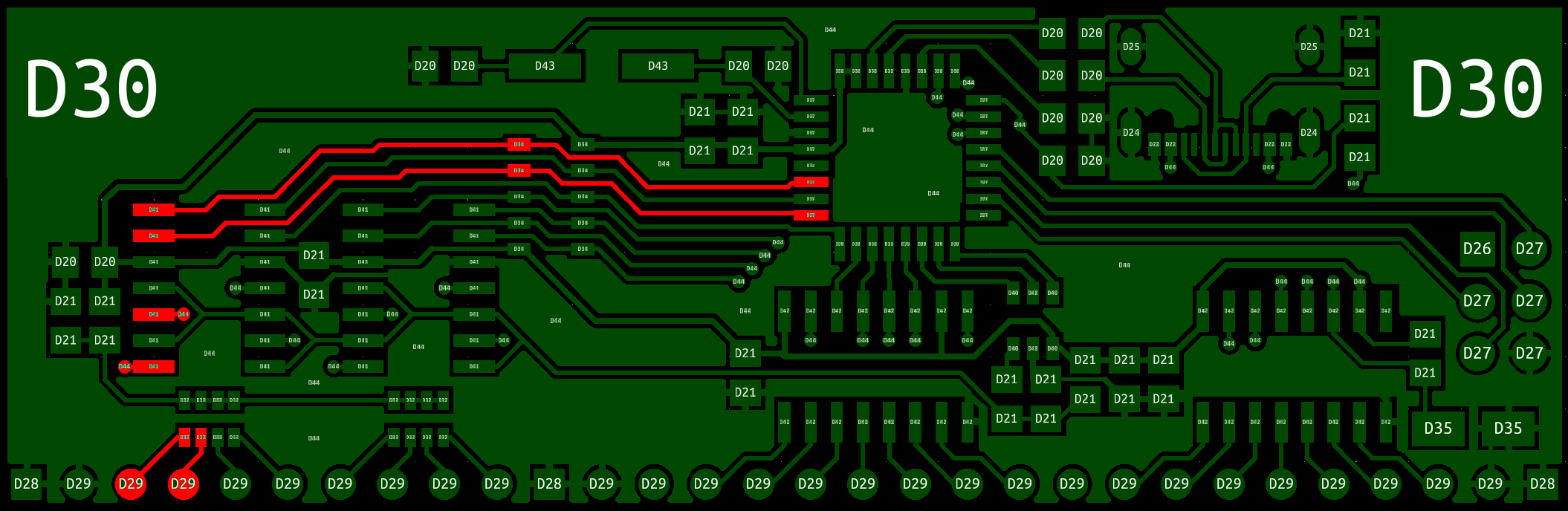

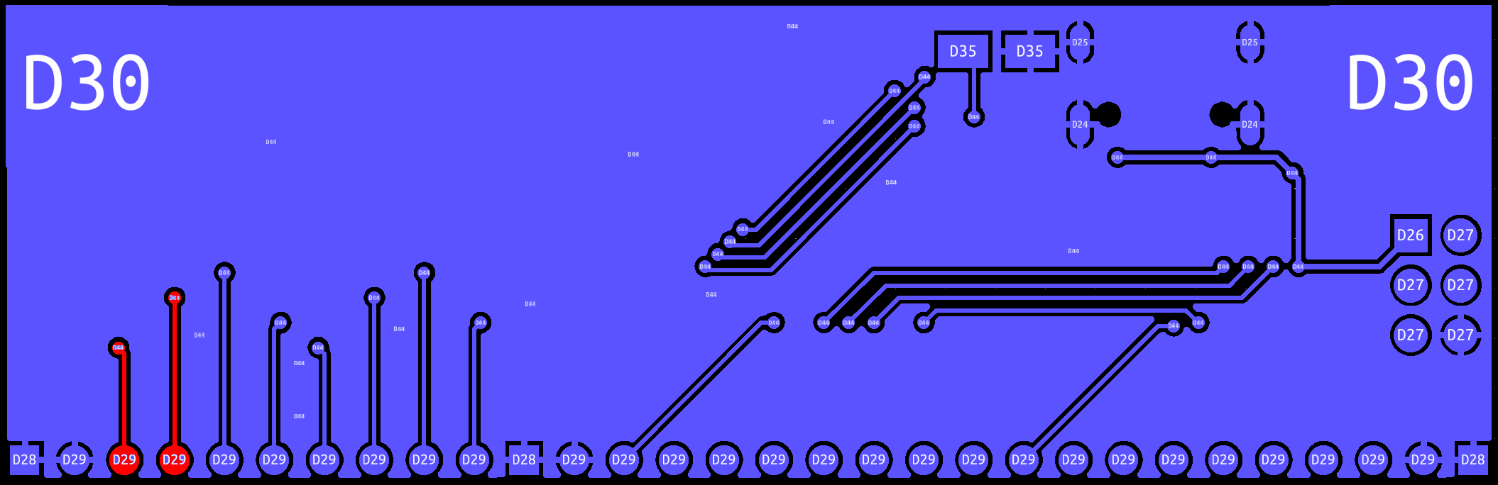

Looks like two of the rows are dead, I have highlighted all of the traces on the controller PCB related to those two rows. Since they are next to eachother I think it's most likely that they are shorted together somewhere.
Please see the attachments, and inspect those areas, and the attached wires visually. (If you have a multimeter, you might even try to beep it out to see if they are shorted)
There's a chance though, especially if it's the wires, that once you open up the keyboard the short goes away, just because you moved the wires a little.

I didn't see any obvious shorts on visual inspection, for the 2 wires you highlighted. I checked between them with the multimeter at various points in the circuit, and they didn't show a short. the far 2 on the left, and the far 2 on the right do show shorts (don't know the circuit, assume that's ok). I can upload pics of front and back of board if that would be helpful. I did check that those 2 wires have continuity between the xwhatsit and the main board (at least to the pads on the main board).
But... after I put it back together and plugged it in... the keys that work and don't work changed. Current situation:

warty wrote: 29 Aug 2020, 16:35 the far 2 on the left, and the far 2 on the right do show shorts (don't know the circuit, assume that's ok).
Yes, that's expected, those are all ground pins
warty wrote: 29 Aug 2020, 16:35But... after I put it back together and plugged it in... the keys that work and don't work changed. Current situation:
Hmm, strange, the list of keys you gave now make it look like you have maybe 3 columns going wrong. Except there are a few keys that you haven't listed that are on those columns, (like left windows key), and a few that are not on those columns (like space, and the bottom right keys that you said was intermittent).

Mixed results so far. I made a keyboard config hex with Andrei's online configurator. I shorted the prog pads to get into boot loader mode, and uploaded the firmware with QMK Toolbox. That wiped the cap sense logic of course, and also reduced the keyboard to less than useful state. I did that a few times to make sure it wasn't just a quirk of uploading.
I was able to build the util app on the mac, which makes it easier to update the firmware. The keypress monitor and signal level monitor are interesting. Just about every key on my keyboard is getting detected all the time. which is probably why it's not useful as a keyboard in current state.
It's not obvious to me how to change the capsense levels. I see this going on in matrix.c:

warty wrote: 30 Aug 2020, 20:50 and I can see the hardcoded threshold is defined to 142. I can see the design allows for finer grain setting, but I haven't looked deep enough yet to see how that happens, and how that gets stored in the config file(s).
Please ignore that hardcoded threshold. I don't think anyone has used it so far, and I only implemented it as a convenience just in case. I may even remove it in the future. Auto-calibration is enabled by default. And what it does is it measures the un-pressed state of the key when you plug the keyboard in (for this reason you must not press keys while plugging it in). It adds a "Threshold Offset" to the measured value, and uses that as a threshold. It also bins the keys into threshold bins in order to not slow down the scanning too much.
So ideally what I would like is for threshold adjustment to be completely unnecessary.
The threshold offset itself is not something I can measure automatically though. ( I can't use the calibration pads for that purpose, because they have a much higher signal level than real pressed keys.). So the threshold offset is something that matters, and if you are having problems, you might want to tweak it. In fact there were a very few people who reported that the threshold offset was not large enough for them, so I am planning to change the default value to increase it. I expect keyboards that are already stable to remain stable with that change, and the very few keyboards that weren't completely stable to get stable.
Once that change is made, I expect the value will be good enough that nobody will have to go tweaking any threshold-related settings.
If anyone has to adjust threshold settings, I want to know about it, to figure out why.
