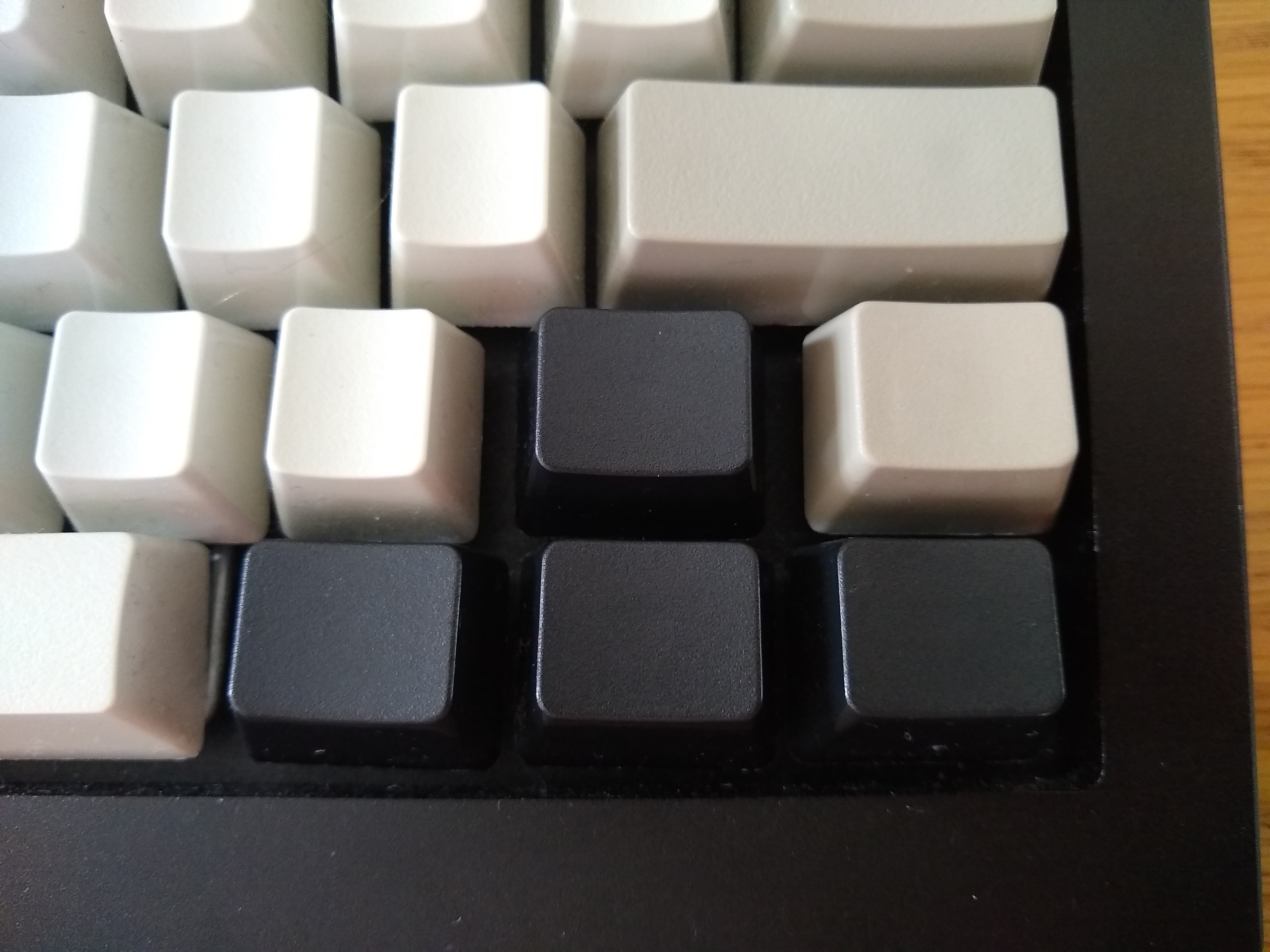

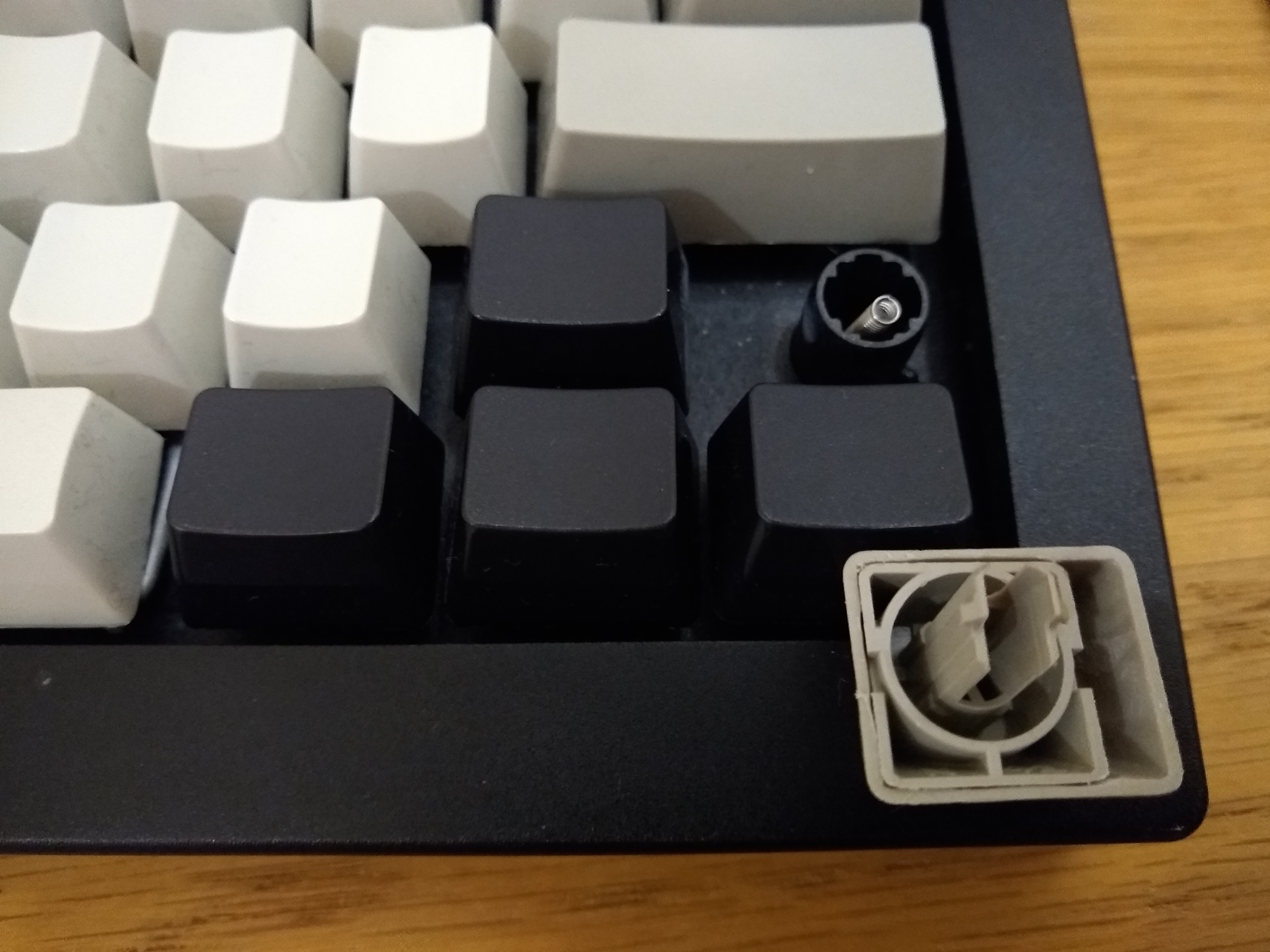

Finally got out the superglue and made my 1.25 U right shift key.

clickclack wrote: 10 Feb 2021, 12:28 Finally got out the superglue and made my 1.25 U right shift key.
I have a similar setup - why did you require superglue?

The inv. T made of 1.25 U keys lines up perfectly with a similar gap on the left and right of the 'up' key and to the left of the 'left' key.
I didn't like the way the non-stepped part of the Caps Lock wasn't centred above the 'down' key.
I superglued a Model M stem into a 1.25 U key to make the pebble-coloured key to the right of 'up'. I'm using it as shift rathar than function as, as a long time user of HHKBs, I didn't use that key for anything other than function shifting for arrow keys before.
The difference in shade between the unicomp 1.25 U pebble and the ellipse enter is less noticable in the flesh.

clickclack wrote: 10 Feb 2021, 21:37 bottom.jpg
I love that - you can bet I will try the exact same thing ;)

The really cute thing is that the 1.25 U key is an ISO left shift key. So there'll be a printed version of it as a "normal" key from both Unicomp and ellipse.
