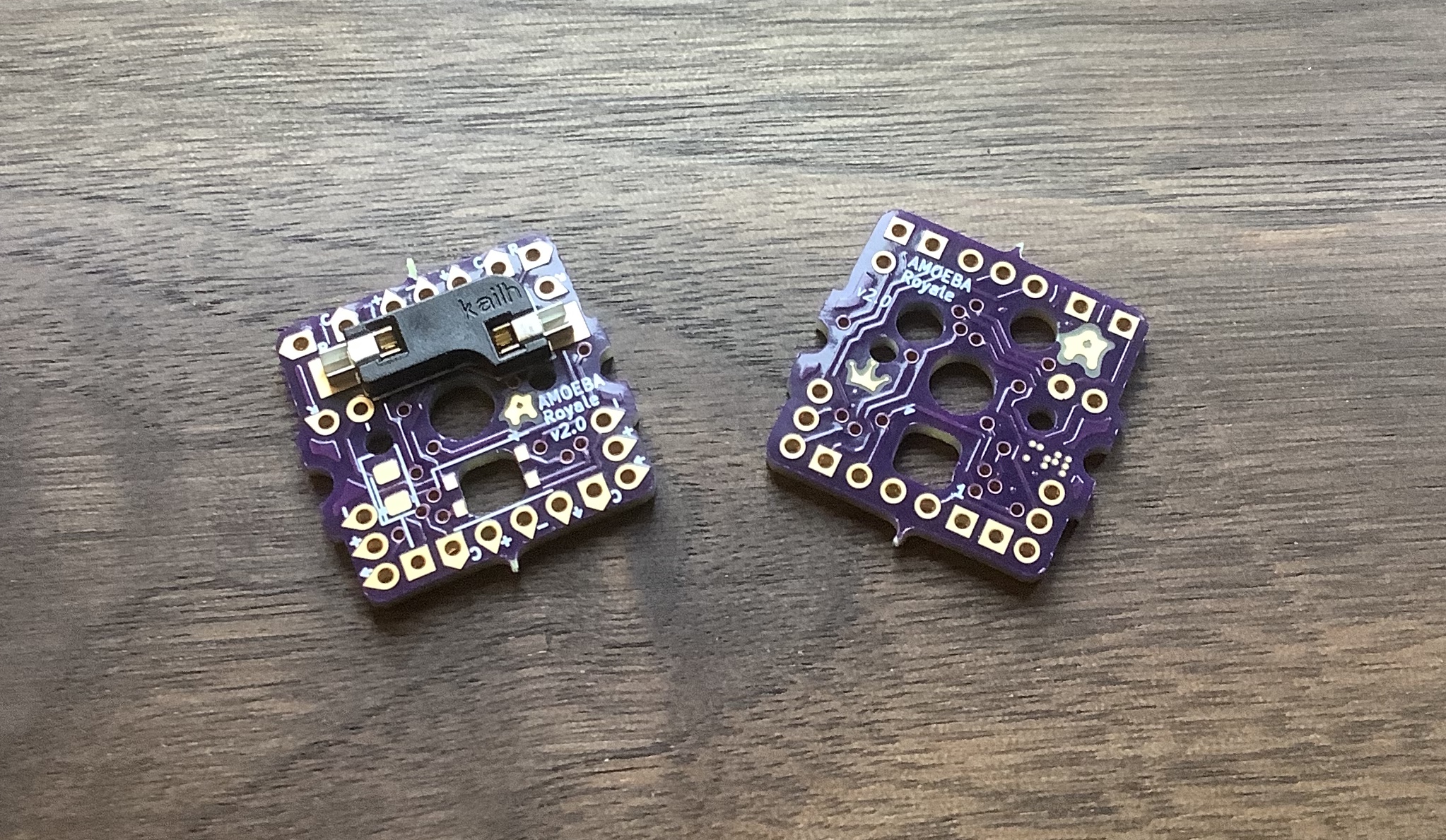

Ah, that makes sense. Thank you for that context. I'll put together the files for release, try to call attention to the milling issue, and create the 2u version at a later date (as time permits).
For now, here are a few pictures of prototypes that have been made. The first pictures show the current design, which suffer from the milling error and can't fit the LED without filing away at the PCB:
- IMG_3322.jpg (1.15 MiB) Viewed 33418 times
- IMG_3325.jpg (866.23 KiB) Viewed 33418 times
Here are a couple of shots of an earlier prototype with the LED:
- IMG_3337.jpg (394.14 KiB) Viewed 33418 times
- IMG_3327.jpg (1.02 MiB) Viewed 33418 times

The milling issue for the LED is unfortunate. If I understand correctly, they use a too big of a mill head, which results in the corners being too rounded for the LED to fit in? Is it possible to make the cutout longer, such that it's not completely square, but instead extends a bit to the top and bottom, allowing for rounder corners? I don't know if that would make it impossible to fit the circuit in though.
Also, do we know if any other manufacturers supports finer mills, such as JLCPC?
Also, you don't have to be in a hurry for my sake, I won't have time to play around with them for the next couple of months anyway. I would much rather wait a few month if that was what it took to figure out how to fix the LED issue.

It may be possible to dogbone the corners. Will give it an attempt. (PCB space is at a premium.)
I don't have experience with other manufacturers, but hopefully someone can offer insights. I can also produce panelized gerbers if someone can offer guidelines (optimal panel size, ability to do V scoring/grooves, etc.). These parameters would possibly vary by manufacturer.

Wow.. lots of cool projects and ideas, everyone. I didn't know the SK6812MINI-E existed. That seems like the better part to use, as it should be easier to solder and the solder points should hold up longer.
I'm ordering some new prototypes and LEDs to see how well they can be incorporated into the 2.0 design. If it works out, I'll publish the updates.

Small update on the changes to support the SK6812MINI-E. The revised design is good, but the LEDs I received are smaller than the spec sheet indicated. The difference is less than 1 mm and I'm not sure if the manufacturing is off or the spec sheet is off. Still, I may make a small change to the design before posting it as I think the solder pads could be a little bigger.

I have used the Amoeba King PCB to create a dactyl manuform with SK6812MINI-E on every switch.
It worked great.
Thank you for sharing your PCB design.
