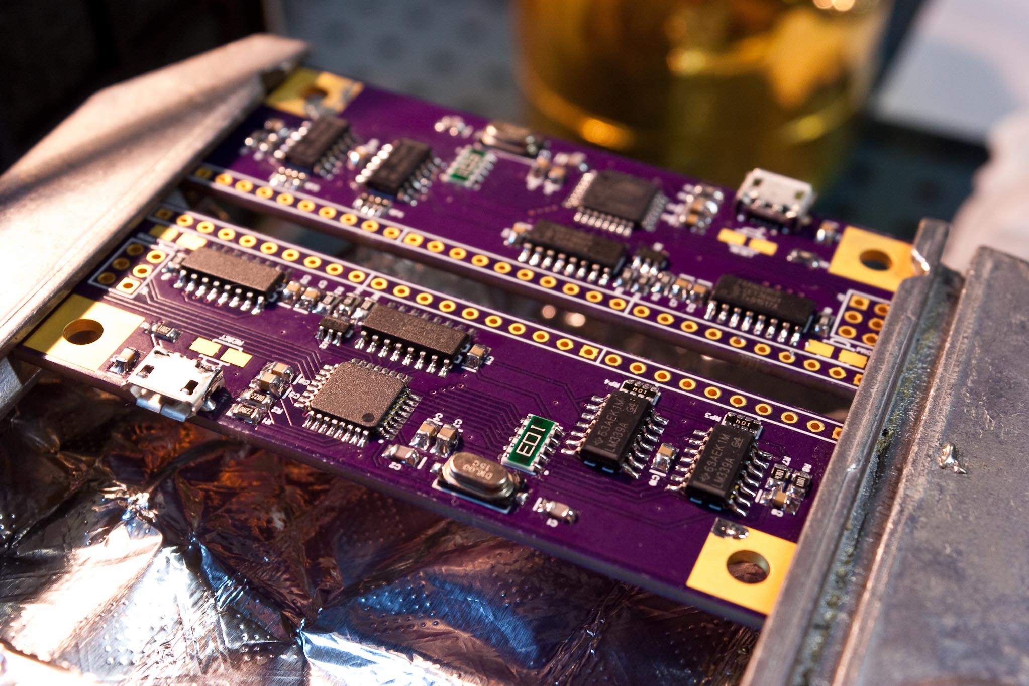

by phosphorglow
Super exciting stuff! My apologies for not being more useful and taking forever to actually get the soldering done... ;P
Just as Ellipse said - big thanks to red, wcass, joc, Ellipse, and xwhatsit for creating the whole thing in the first place.
Here's a bunch of hand soldered silliness:
- _MG_6510.jpg (340.6 KiB) Viewed 12152 times
If that doesn't prove that soldering SMD is no harder than THT, nothing does. Good work!
