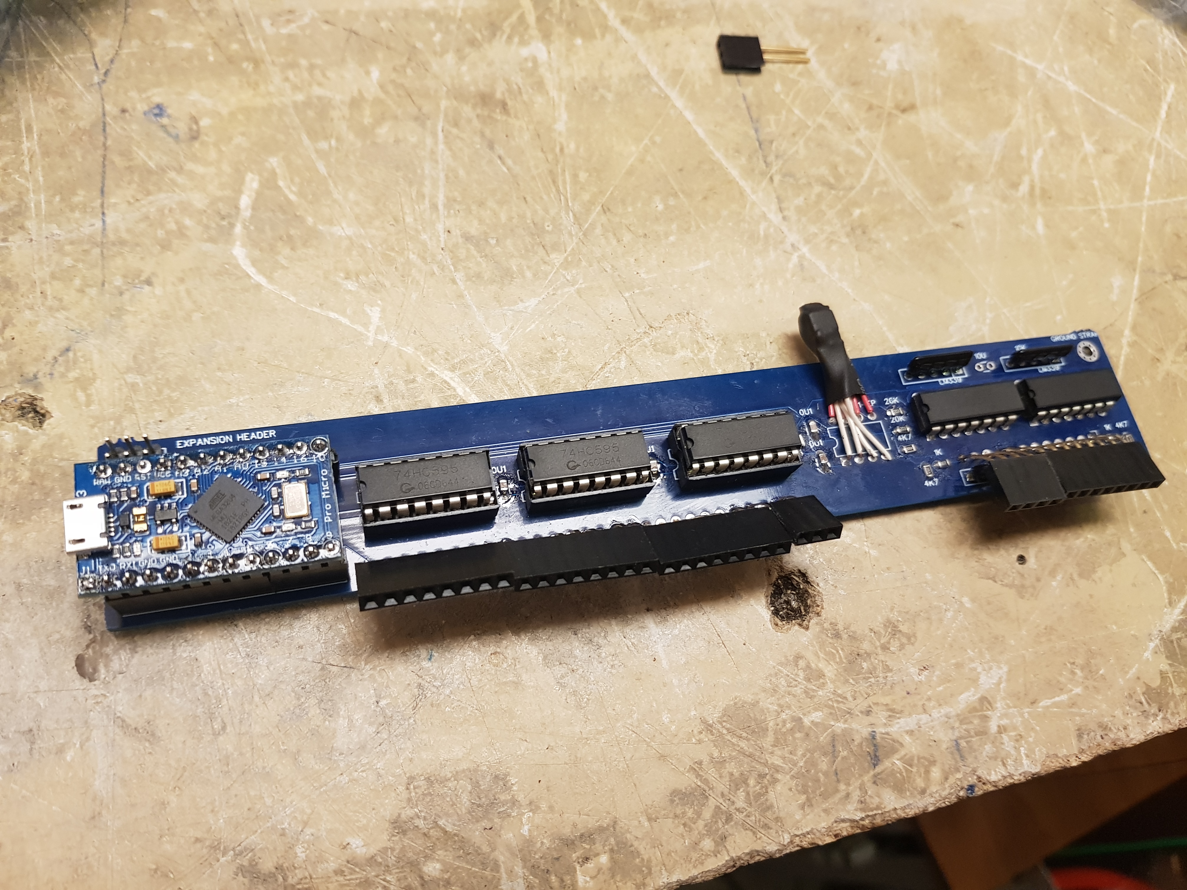

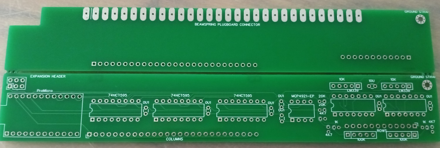

Hi I have 2 extra of the PCB anyone wants to buy. I was thinking around $5 + shipping. Send message if interested. They came with specifically the beamspring edge connector part which I will include/not break off.
xwhatsit through hole.jpg (210.06 KiB) Viewed 12243 times

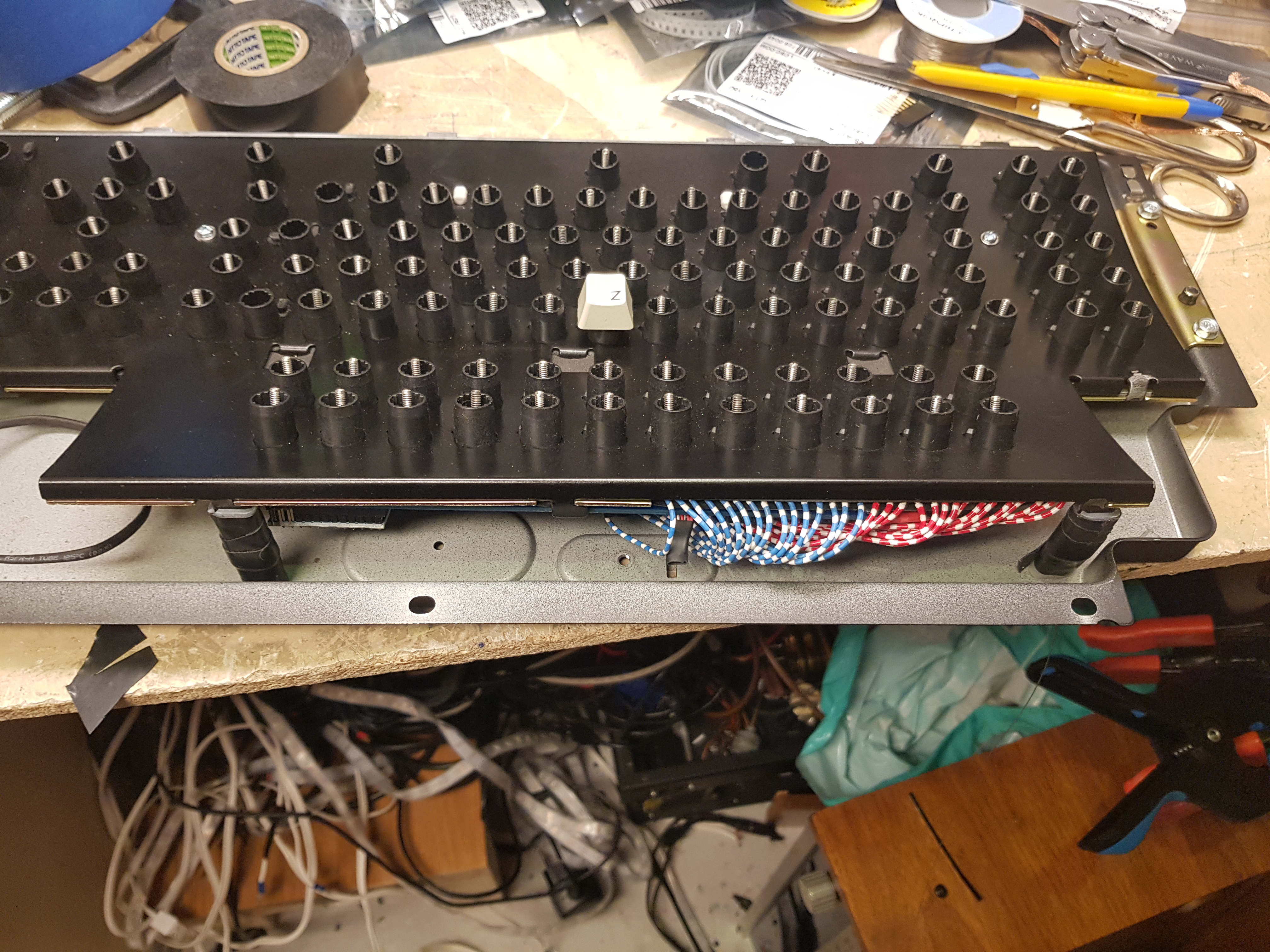

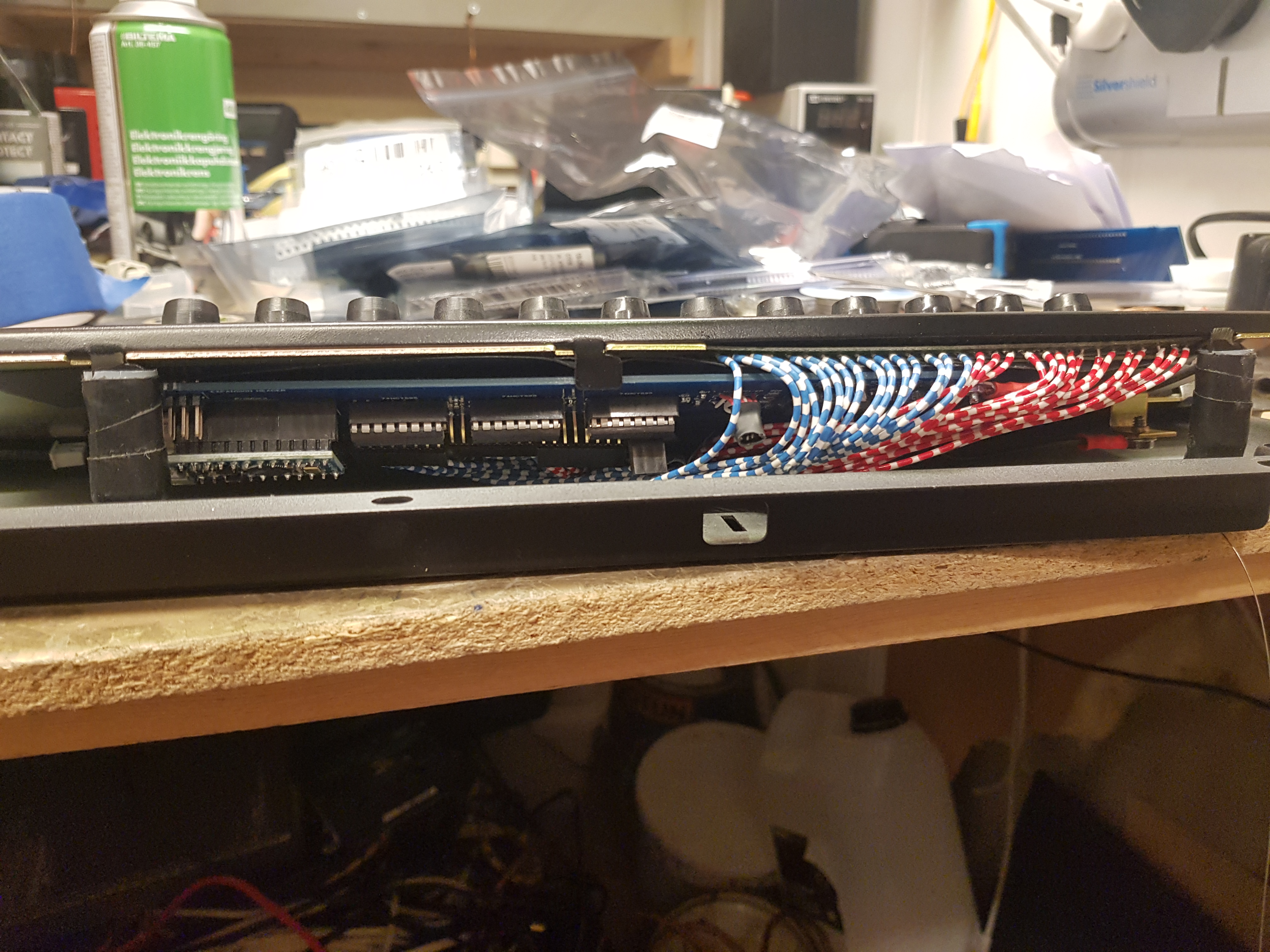

Had a go at this with my F122, and it works - sort of :D
I will be happy if someone will help me troubleshoot.
tentator wrote: 18 Jul 2020, 00:21 Yes I agree its always quite painful to order them, since there are so many options and each comes with a different ID etc..
If it helps I can attach here a bom I made with LSCS/Jlcpcb.
But you will have to decide if you want the smd resistors that will fit nicely but are a bit more difficult to solder or the axial resistors which are quite bulky.. No need to order both.. Anyway check it, also I think there might be a couple of things missing like the connector and the male pin headers etc..
Kr,
Tent.
Thank you for posting this list. Shame on me to not cross check every component - while it did provide with complete list of what's needed, the DAC was in the worng format. While I wait for the DIP8 replcement I soldered it up with legs to get it working;
Hopefully this will not cause any problems in the meantime.
th complete.jpg (3.44 MiB) Viewed 11833 times
th f122 mounted.jpg (4.29 MiB) Viewed 11833 times
th f122 mounted top.jpg (4.69 MiB) Viewed 11833 times

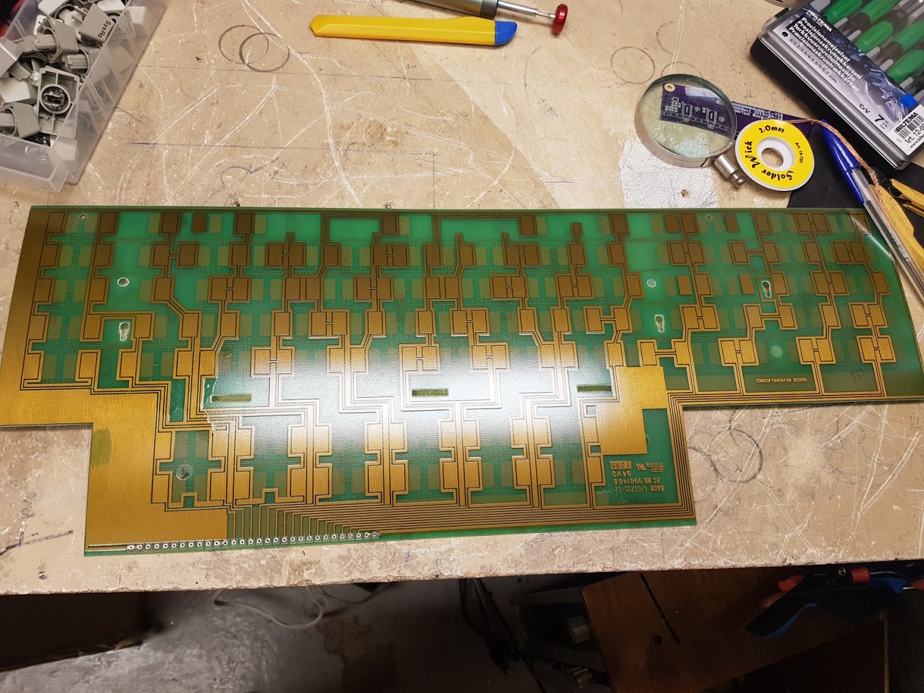

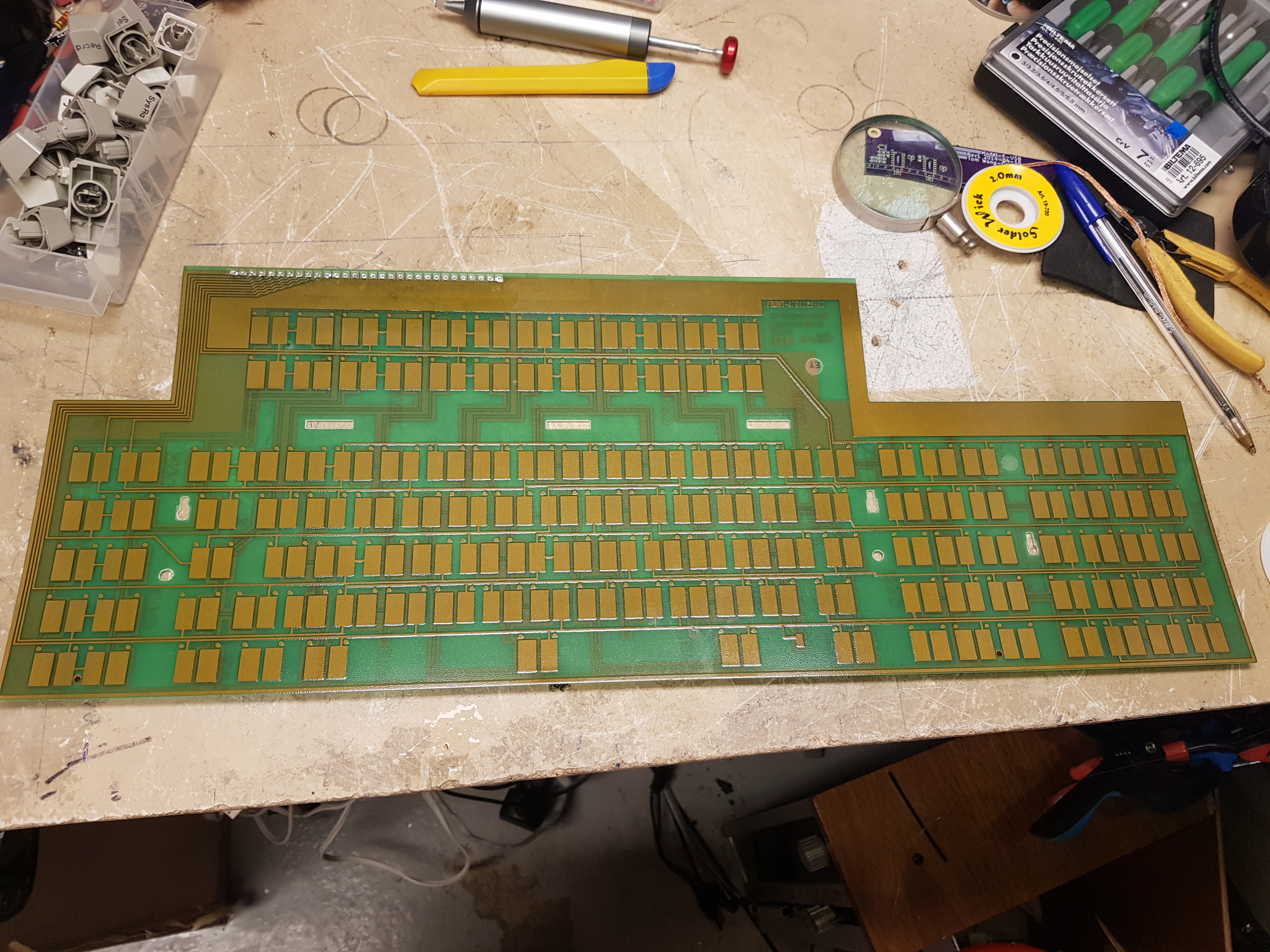

Now for the troubleshooting, here is my F122 PCB top and bottom;
F122 PCB top.jpg (4.68 MiB) Viewed 11833 times
F122 PCB bottom.jpg (332.13 KiB) Viewed 11833 times

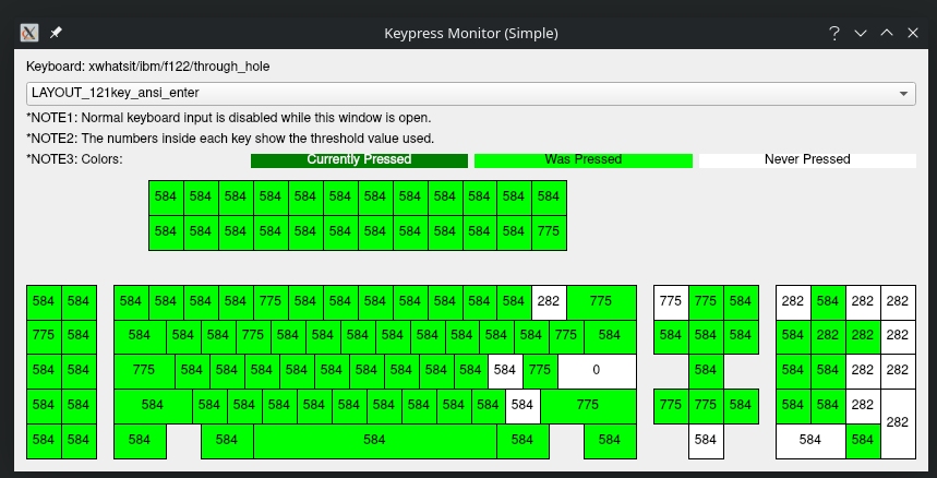

What happens when I plug the keyboard to the computer it's doing some random key-presses, and not giving anything reliable readout from the util. Guess the auto calibration portion on F122 firmware is not working as it should. However if I hold down a bunch of random keys when plugging the keyboard in it works reliable - just that the keys pressed are not in the correct places in the software and not all keys shows up as registered. Ie pressing "2" shows "1", pressing "D" shows "S" and pressing "K" shows "M" and so on.
I have no idea if this is firmware related - but I did hook it up as per the Model F plug-board. I did triple check this. I can draw up a diagram of how it is hooked up to the controller if needed.
Here is the key press util after I have pressed all the keys on the board;
Calibrated with presses - was pressed.png (41.34 KiB) Viewed 11833 times
Twst
06 Aug 2020, 21:31
All sorted! I had made a stupid mistake hooking it up and there was some tweaking needed in the threshold. Thank you Andrei!!
And a big thanks to everyone working on this project.
F122 is now tested working with this controller ;) Will report back when I have been using it for a couple of days.

Wow, really good wiring with the striped cables. Also smart workaround for the DAC form factor.

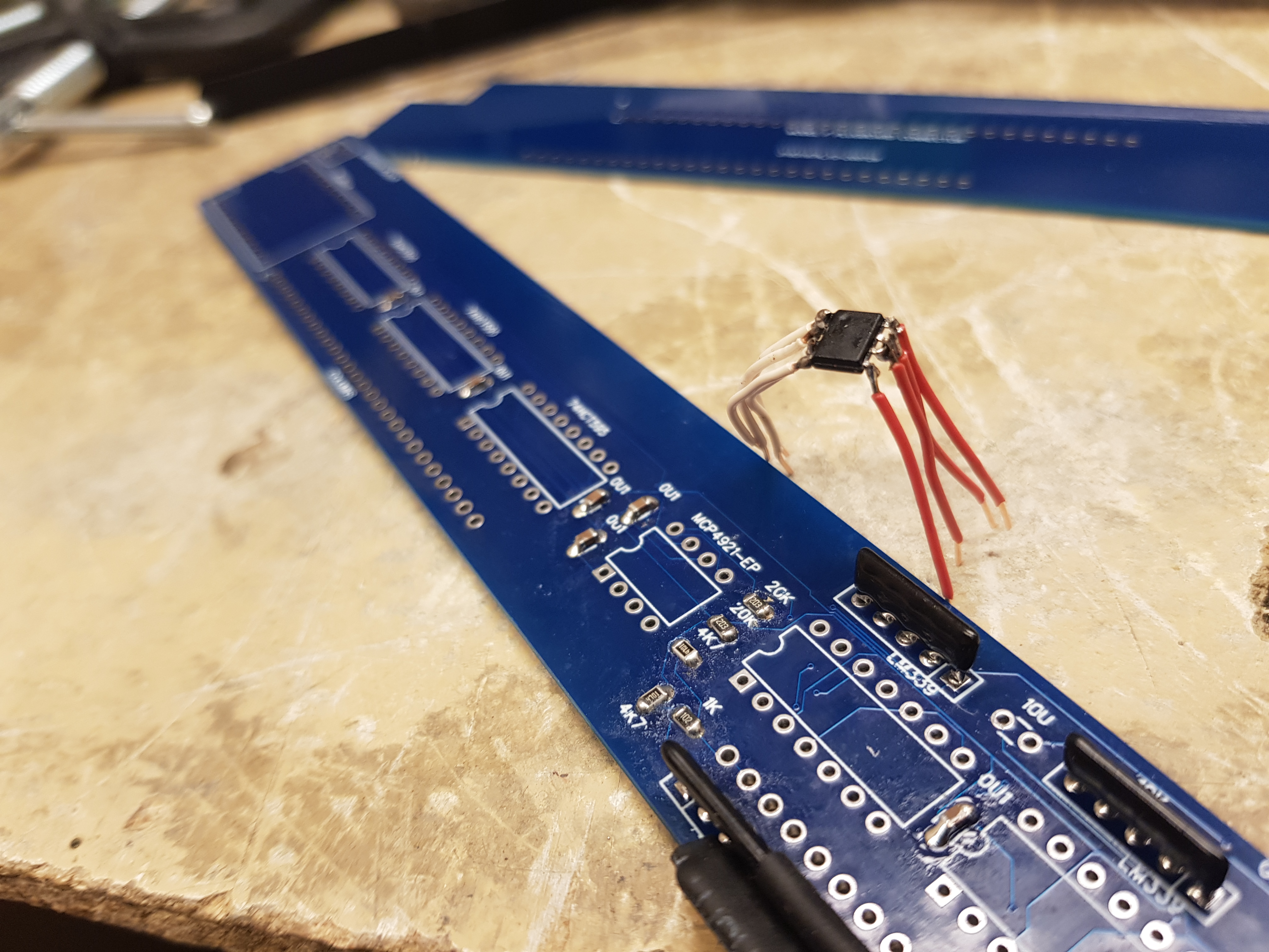

Looks like the 1K resistors won't fit!
I decided to file it down in order to reduce the wire circumference:
eyy it worked:
One of them I broke the end off filing:
So I decided to use one of the 20k resistor clippings to save it:
