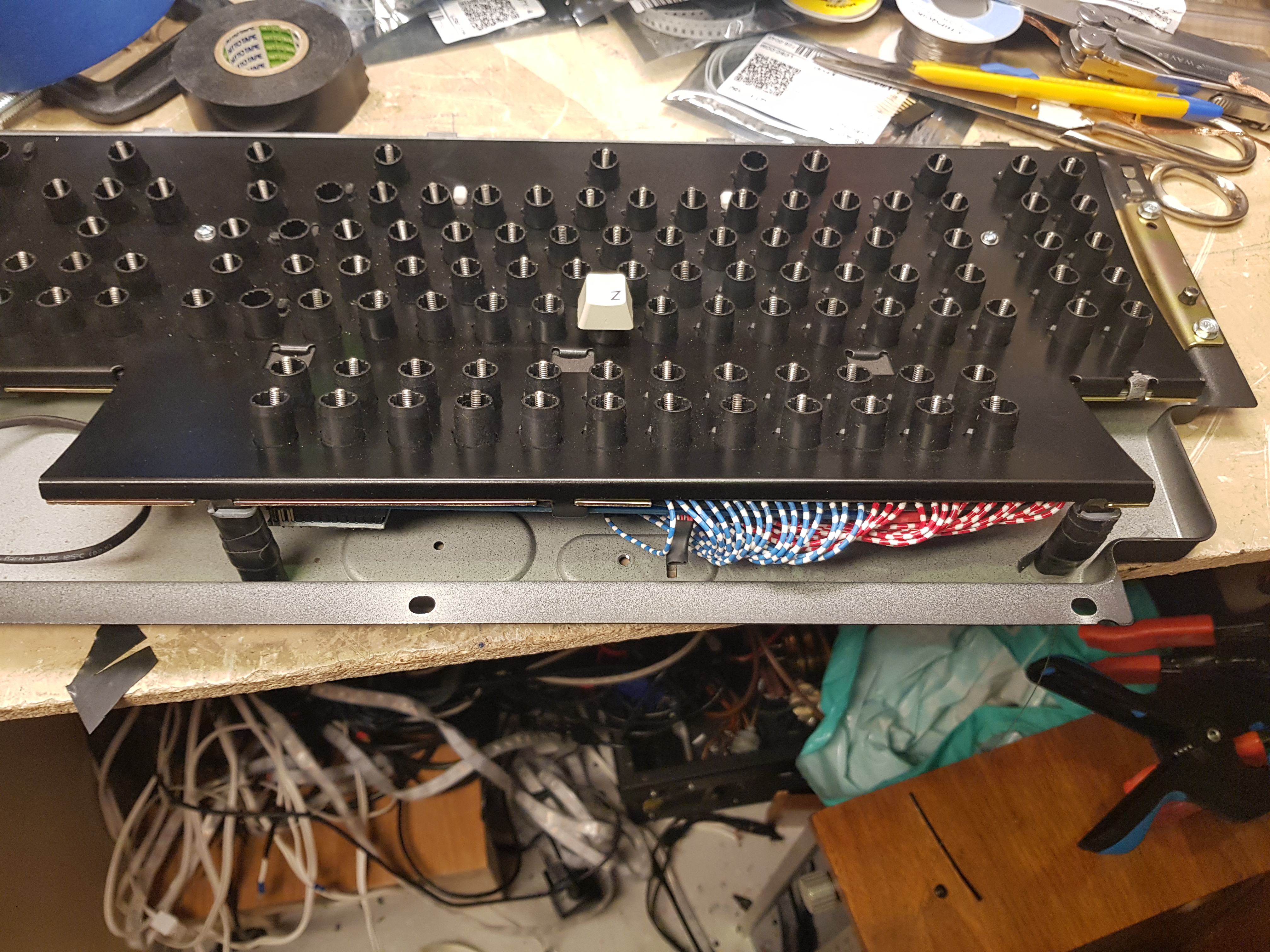

Had a go at this with my F122, and it works - sort of
I will be happy if someone will help me troubleshoot.

Thank you for posting this list. Shame on me to not cross check every component - while it did provide with complete list of what's needed, the DAC was in the worng format. While I wait for the DIP8 replcement I soldered it up with legs to get it working;
- dacadapter.jpg (3.32 MiB) Viewed 11836 times
Hopefully this will not cause any problems in the meantime.
- th complete.jpg (3.44 MiB) Viewed 11836 times
- th f122 mounted.jpg (4.29 MiB) Viewed 11836 times
- th f122 mounted top.jpg (4.69 MiB) Viewed 11836 times
Now for the troubleshooting, here is my F122 PCB top and bottom;
- F122 PCB top.jpg (4.68 MiB) Viewed 11836 times
- F122 PCB bottom.jpg (332.13 KiB) Viewed 11836 times
What happens when I plug the keyboard to the computer it's doing some random key-presses, and not giving anything reliable readout from the util. Guess the auto calibration portion on F122 firmware is not working as it should. However if I hold down a bunch of random keys when plugging the keyboard in it works reliable - just that the keys pressed are not in the correct places in the software and not all keys shows up as registered. Ie pressing "2" shows "1", pressing "D" shows "S" and pressing "K" shows "M" and so on.
I have no idea if this is firmware related - but I did hook it up as per the Model F plug-board. I did triple check this. I can draw up a diagram of how it is hooked up to the controller if needed.
Here is the key press util after I have pressed all the keys on the board;
- Calibrated with presses - was pressed.png (41.34 KiB) Viewed 11836 times
Re: READY - $10 - DIY Through Hole Universal Model F and Beamspring Controller
Posted: 06 Aug 2020, 21:31
by Twst
All sorted! I had made a stupid mistake hooking it up and there was some tweaking needed in the threshold. Thank you Andrei!!
And a big thanks to everyone working on this project.
F122 is now tested working with this controller
Will report back when I have been using it for a couple of days.
My fingers are happy typing again
