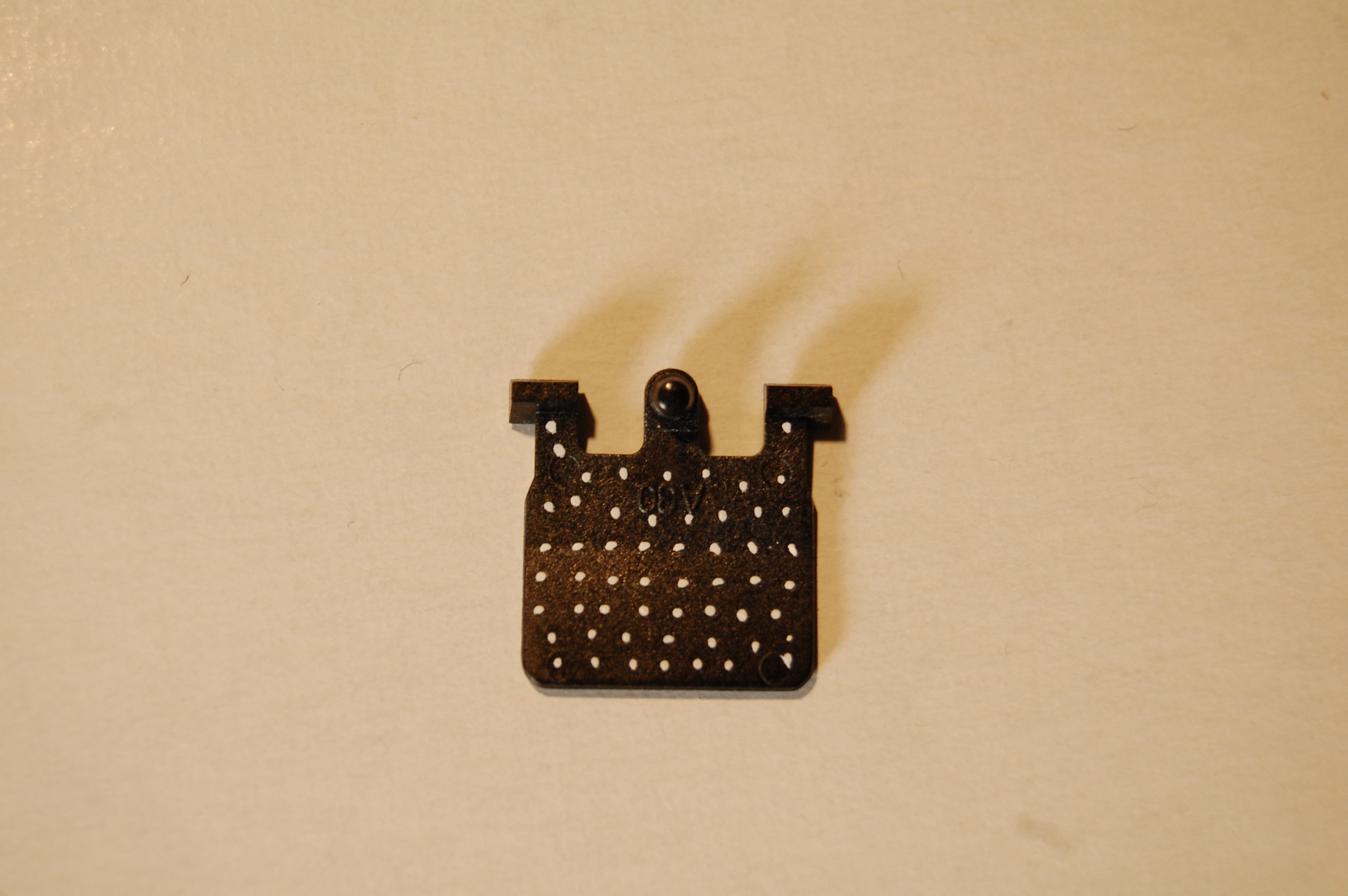

I must report success !!
I have been silently working on the 3d printed flippers using the conductive filament which I bought in amazon: EONO Electrically Conductive PLA Filament
Flipper 11.jpg (122.26 KiB) Viewed 14704 times
This is literally the first text which I am typing using a regular model m, using the FEXT PCB, a Leiden Jar and my 3d printed flippers using conductive filament.
The keyboard which I have used has a particularly bad barrel plate. This was a very bad decision as it has taken me long to ensure that all the keys register properly. I believe that now that we know that it can flippers can be 3d printed, the next step is to replace the original ones which I am using in my FSSK :)
These flippers are less conductive than the original ones. I had to reduce the threshold in the Leyden Jar firmware. I am typing with activation offset of 7 (instead of the 20 which I have been using with my "regular" FSSK.
Screenshot at 2025-02-14 01-29-05.png (19.84 KiB) Viewed 14718 times
Printing the complete keyboard was less than 3 hours.
I had print the flippers lying on one side, to ensure that the spring pressure is done along with the layers, so it does not break. In order to print efficiently, I designed my own support in the 3d model.
Flipper 11 -printb.jpg (70.16 KiB) Viewed 14704 times
Flipper 11 -printa.jpg (63.47 KiB) Viewed 14704 times
For the springs, I have simply reused the originals from the model m.
There is lot of things to tune, specially with the keyboard which I am using as Guinea-Pig. But, in my opinion, this is a great success which shows that it is possible to create flippers in a simple manner.
It opens, in my opinion, the path, to new ideas that were simply not possible before as they needed to harvest the flippers from original keyboards or buying them at unreasonable price.
It is late here in Europe. I will post additional pictures and details next week.
If you wonder if I plan to make the source files available, yes, I will.
I just want to work a bit more on them to minimise the time expend in removing the support.
I will post detailed information on how to produce these flippers :)
Cheers
i$

idollar wrote: 14 Feb 2025, 01:29 These flippers are less conductive than the original ones. I had to reduce the threshold in the Leyden Jar firmware. I am typing with activation offset of 7 (instead of the 20 which I have been using with my "regular" FSSK.
Congratulations! I specially approve of the extra step you took to print the spring support across the layers, not in parallel.
The "less conductive" part might be because OG flippers underside is actually not flat - it's a cylinder with some huge radius (I tried to figure out that radius from photogrammetry, but the photogrammetry effort failed miserably, so I'll try to deduce that radius from plain old photographs and counting pixels.), and your model appears to have a flat bottom.
Flat bottom over curved plate will result in a PCB contact patch being one or two narrow bands instead of a theoretically large rectangle with curved flipper.
There's no good way to compare - if you compare on a PCB laying flat on the table, printed flipper should get ahead, if inside actual keyboard - OG flippers should get ahead, and there's really no way to put them into "apples to apples" situation.

DMA wrote: 14 Feb 2025, 04:40 The "less conductive" part might be because OG flippers underside is actually not flat - it's a cylinder with some huge radius (I tried to figure out that radius from photogrammetry, but the photogrammetry effort failed miserably, so I'll try to deduce that radius from plain old photographs and counting pixels.), and your model appears to have a flat bottom.
The resulting part is less conductive. It is a fact.
It is also factual that with the right adjustment in the DAC threshold it works. I keep typing this text with my test keyboard :)
As I already said before, there are some adjustments that can be investigated:
  • Increase the thickness of the "flat" part of the flipper
  • As you said, shape it as a section of a cylinder
  • But we can go further, what about designing different shapes for different sections of the keyboard ? I have noticed that the flippers in the middle row register lower values (to be confirmed with the oscilloscope). It should be possible to design different flippers which adapt better to this "difficult" part of the keyboard.

I wish to retract this. Spent couple hours today trying to make a high-res photo - which I actually made, see below - only to find out that that cylinder radius is HUGE and only noticeable in how light reflects from the bottom of the flipper, actual non-flatness is like 0.01mm over the flipper area
While I was writing this down, it occured to me that I actually have a resin 3d-printer with supposedly 16x24um horizontal resolution and so I can just print curvature gauges (because I have some idea about said curvature radius being around 300mm) and measure by simply putting two parts together and looking at it at magnification (being old sucks, damn presbiopia). Sure, not NIST-traceable, but should be good enough.
idollar wrote: 14 Feb 2025, 08:16 The resulting part is less conductive. It is a fact.
Original flippers are not conductive at all. Their surface resistance is >20MOhm/mm, that's well within insulator territory (I have a megohmmeter, but it's currently broken, so I can't currently measure more than 20MOhm.). Your filament is advertised at 7 ohms/cm - you can check actual resistance by sticking multimeter probes into it 1cm apart (and if it displays "O.L" - 1mm apart).
Lower levels might be because flipper's bottom surface isn't smooth enough - which can be rectified by sanding OR just sliding the flipper over the flat part of the iron at "wool" setting (careful about melting flipper legs and burning fingers!) - probably wrapping the flipper in tracing paper to prevent it sticking to the iron and melting completely.

This is a set of convex and concave curvature gauges, R290 to R330. R315 is there because value calculated from the whole backplate gave me R315.
Turns out, the keyboard part (R2 to R6) is R310, and the upper part is >R330, may be >R400 - at least on my model M backplate. I have XT, AT and F122 backplates, but my lifting restrictions currently prevent me from accessing those. Expect more results in about two weeks.
Flipper also seems to be most closely matching R310 - so R310 is the golden value I guess (NOTE: that R310 arc must include the pivot point too!)
