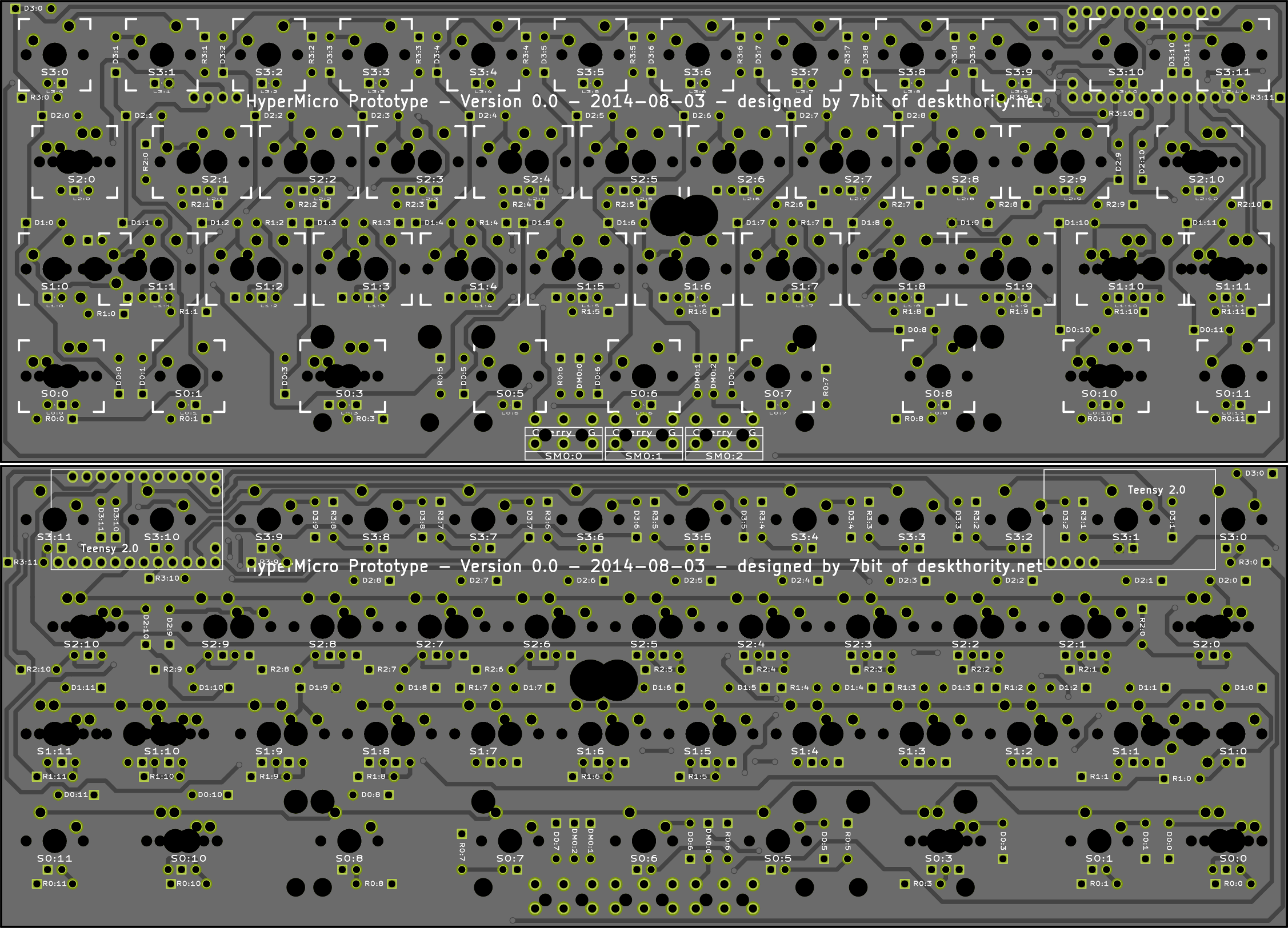

Posted: 03 Aug 2014, 22:22
by 7bit
I think I found it:
Add Zones (right under the icon "Add Tracks and Vias"). Now I know how to make that fancy frame around the PCB edges, I have seen in the Phantom file.

Posted: 04 Aug 2014, 23:14
by 7bit
OK, here we go:
:shock:
Posted: 05 Aug 2014, 19:28
by 7bit
I've finished the PCB.
:ugeek:
Next step is to wait for people who promised to examine the kicad files if there is anything wrong.
:roll:
Posted: 05 Aug 2014, 22:59
by 7bit
Stabiliser mounts are wrong. They must be higher up.

Posted: 08 Aug 2014, 15:44
by tlem
trace to clean up
trace to clean up
another trace to clean up
check with your manufacturer if there is enough space between the copper and board edge

Posted: 11 Aug 2014, 23:33
by Muirium
All those holes at the front are for the pointing device, right? Because the one place you don't want to put anything extraneous is down there, where the keyboard must be thinnest.
Posted: 11 Aug 2014, 23:42
by 7bit
These holes are for mouse buttons. You don't need to solder them in, just connect 2 pads with your fingers if you want to 'click' on something.
:evilgeek:
Posted: 12 Aug 2014, 04:37
by Findecanor
Why are the LEDs on the front of the switch? For locking keys, I can see why they should be front, but don't backlit keycaps most often have the legends on the back?
Posted: 12 Aug 2014, 10:19
by 7bit
This would mean to mount the switches upside-down. There is no space for that.
I've improved the whole thing a bit:
:o
