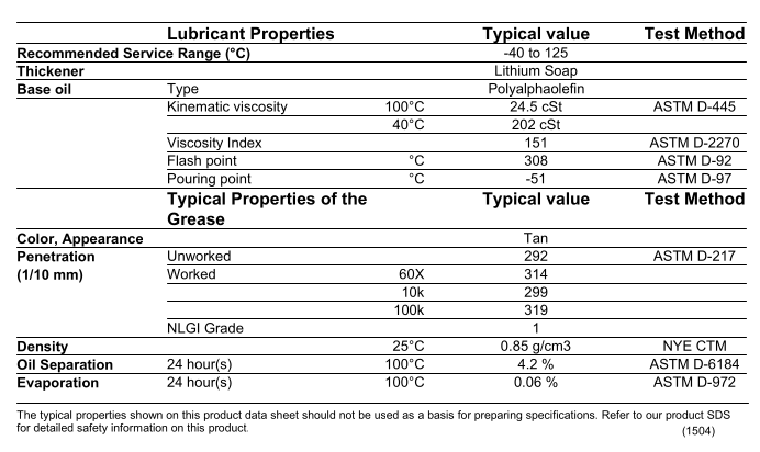

Quick update:
I found some time and tried one of the lubes the Rheolube 368 which I had the most hopes for and it was a failure. :( Here's a quck video and info:
F8 is OG lube, F6 is Rheolube 368
TDS:
It didn't eliminate the stick-slip (very light binding) when pressing on corners and it didn't smooth out the sliding, I could feel all imperfections of the surfaces. My guess why this didn't work is that it is not viscous enough (viscosity).
Next I'll try the 368AXF (a bit more viscous version with additives), and then on to the Nyogel 774 series which I hope they will work well.

Nice nice. The part about the solvent and how it evaporates is great info!
But OKS 402 is way to thin in viscosity. The OG lube is 800mm2/s at 25C (japan measurements) not 660. How did 660 came up?
Also the Rheolube 368 that I tried is more viscous. About 200mm2/s at 40C. So 100mm2/s @ 40C of OKS402 seems way, way too thin. If the R368 didn't work, it will be even worse with oks402. (Assuming that viscosity plays a major role, which may not)
Yeah, I thought the same about the viscosity when I received the mail. Might be interesting to try it out anyways.
I sent him the information on the ThreeBond lube thats where the number 600 comes from.

Yeah I've seen that post now too. Are we still looking for a more detailed description of the og lube or do we have all characteristics we need?
But 600 is not 800 as the OG specs state. What am I missing?
Also, no that is enough specs. I mean, we know the viscosity, the thickener that it had petroleum solvents that would evaporate after the application and that the main oil was a "paraffin" one.
For a lube, It's pretty standard stuff. In my opinion, it would be nice to know some more details, but they are not that important. I bet the "paraffin oil" is probably highly refined long chained hydrocarbons and that's it. That's as far as my knowhow can tell and I am saying it with reservations. Someone with real expertise may please correct me.
I can send you the mail from OKS if you like!
Also another company told me to try these lubricants:
"Aral" lube
Statermic X400
FG Grease AL 2
and OKS 422 which we already discussed

We already know what the original lube was. Alps themselves told us. Confused if Nek is trying to find a modern analogue (in which case, I have no idea why he dismissed wax boiling) or trying to find the original lube (which again, we already have.) I haven't been keeping track of this thread for a while, so I'm very out of touch.

Just bc it is not close to the OG lube, don't rule it out just yet. 30+ years has passed with intensive research at lube companies, so I miagine we might find something even better than the og lube, if we look well enough at it. We should ask for specific properties, like stick-slip reduction, and dampening greases in general.
