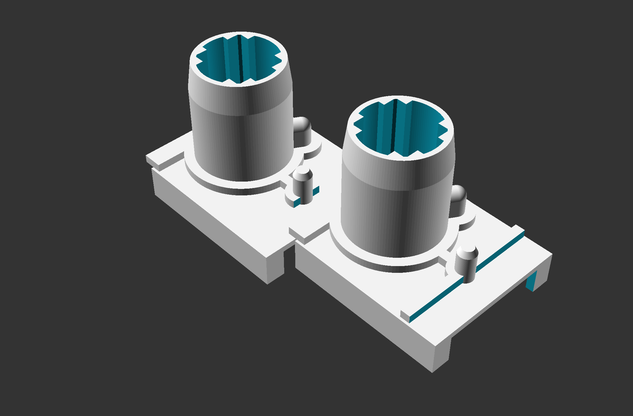

I believe we achieve both. The core ring is made of silicone rubber that both helps seal barrel openings and stabilizes with consistent pressure at key points. There are two flavors of the ring. Those where the barrel front is supported by the overhang of the previous rows ring, and isolated (includes bottom row) barrel rings. Also, should we make our own barrels in the future this two part approach would also accommodate flat plate profiles, the silicone stabilizer rings will still fall within spec.
The voids not accounted for by the stabilizer rings will be filled with MLV (mass loaded vinyl). At least that is the goal. If MLV proves cost prohibitive, the fall back is a thicker than normal closed cell foam like neoprene. I have ordered several foams to test on the laser cutter, and will report the results.
The following are the renders to help visualize. Regardless of the material chosen for the secondary foam, this design will be the final unless issues arise. Note that the secondary (form factor specific cutout) foam will sit INSIDE of the assembly, and will not be sandwiched between the top and bottom plate on the edges.
Standard silicone stabilizer ring.  Note that rectangle at the top of the barrel base stabilizes the rings barrel AND the barrel on the row above
Standard silicone ring fitted on a barrel.  The example shows both barrel locks (XT and AT)
Stabilizer ring for isolated barrels (barrels that do not have a row directly below them)
Isolated stabilizer barrel fitted on a fictional dual lock barrel
Standard and isolated rings fitted on stacked rows.  Note the overhang of the ring on the lower row stabilizes the one above
Closed cell foam cutout for the SSK to fill voids
Closed cell foam cutout for the Full-Size to fill voids
