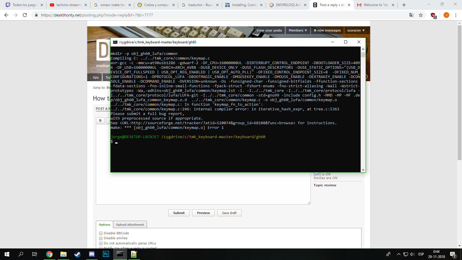

hi, I need help to solve this error
Captura de pantalla (15).png (257.36 KiB) Viewed 12611 times
Slom
29 Nov 2018, 06:44
scorpion wrote: hi, I need help to solve this error
maybe this has some information: https://github.com/tmk/tmk_keyboard/issues/378

     KEYMAP(ESC, 1,   2,   3,   4,   5,   6,   7,   8,   9,   0,   MINS,EQL, BSPC,  \
keymap_poker.c:5:67: error: 'MINS' undeclared here (not in a function)
keymap_poker.c:5:72: error: 'EQL' undeclared here (not in a function)
keymap_poker.c:5:77: error: 'BSPC' undeclared here (not in a function)
keymap_poker.c:5:84: warning: backslash and newline separated by space
keymap_poker.c:6:9: error: 'TAB' undeclared here (not in a function)
         TAB, Q,   W,   E,   R,   T,   Y,   U,   I,   O,   P,   LBRC,RBRC,BSLS,     \
keymap_poker.c:6:14: error: 'Q' undeclared here (not in a function)
keymap_poker.c:6:19: error: 'W' undeclared here (not in a function)
keymap_poker.c:6:24: error: 'E' undeclared here (not in a function)
keymap_poker.c:6:29: error: 'R' undeclared here (not in a function)
keymap_poker.c:6:34: error: 'T' undeclared here (not in a function)
keymap_poker.c:6:39: error: 'Y' undeclared here (not in a function)
keymap_poker.c:6:44: error: 'U' undeclared here (not in a function)
keymap_poker.c:6:49: error: 'I' undeclared here (not in a function)
keymap_poker.c:6:54: error: 'O' undeclared here (not in a function)
keymap_poker.c:6:59: error: 'P' undeclared here (not in a function)
keymap_poker.c:6:64: error: 'LBRC' undeclared here (not in a function)
keymap_poker.c:6:69: error: 'RBRC' undeclared here (not in a function)
keymap_poker.c:6:74: error: 'BSLS' undeclared here (not in a function)
keymap_poker.c:7:9: error: 'CAPS' undeclared here (not in a function)
         CAPS,A,   S,   D,   F,   G,   H,   J,   K,   L,   SCLN,QUOT,     ENT,\
keymap_poker.c:7:14: error: 'A' undeclared here (not in a function)
keymap_poker.c:7:19: error: 'S' undeclared here (not in a function)
keymap_poker.c:7:24: error: 'D' undeclared here (not in a function)
keymap_poker.c:7:29: error: 'F' undeclared here (not in a function)
keymap_poker.c:7:34: error: 'G' undeclared here (not in a function)
keymap_poker.c:7:39: error: 'H' undeclared here (not in a function)
keymap_poker.c:7:44: error: 'J' undeclared here (not in a function)
keymap_poker.c:7:49: error: 'K' undeclared here (not in a function)
keymap_poker.c:7:54: error: 'L' undeclared here (not in a function)
keymap_poker.c:7:59: error: 'SCLN' undeclared here (not in a function)
keymap_poker.c:7:64: error: 'QUOT' undeclared here (not in a function)
keymap_poker.c:7:74: error: 'ENT' undeclared here (not in a function)
keymap_poker.c:8:9: error: 'LSFT' undeclared here (not in a function)
         LSFT,Z,   X,   C,   V,   B,   N,   M,   COMM,DOT, SLSH,          RSFT,UP,\
keymap_poker.c:8:14: error: 'Z' undeclared here (not in a function)
keymap_poker.c:8:19: error: 'X' undeclared here (not in a function)
keymap_poker.c:8:24: error: 'C' undeclared here (not in a function)
keymap_poker.c:8:29: error: 'V' undeclared here (not in a function)
keymap_poker.c:8:34: error: 'B' undeclared here (not in a function)
keymap_poker.c:8:39: error: 'N' undeclared here (not in a function)
keymap_poker.c:8:44: error: 'M' undeclared here (not in a function)
keymap_poker.c:8:49: error: 'COMM' undeclared here (not in a function)
keymap_poker.c:8:54: error: 'DOT' undeclared here (not in a function)
keymap_poker.c:8:59: error: 'SLSH' undeclared here (not in a function)
keymap_poker.c:8:74: error: 'RSFT' undeclared here (not in a function)
keymap_poker.c:8:79: error: 'UP' undeclared here (not in a function)
keymap_poker.c:9:9: error: 'LCTL' undeclared here (not in a function)
         LCTL,LGUI,LALT,          SPC,                     RALT,RCTL,GRV, LEFT,DOWN,RGHT\
keymap_poker.c:9:14: error: 'LGUI' undeclared here (not in a function)
keymap_poker.c:9:19: error: 'LALT' undeclared here (not in a function)
keymap_poker.c:9:34: error: 'SPC' undeclared here (not in a function)
keymap_poker.c:9:59: error: 'RALT' undeclared here (not in a function)
keymap_poker.c:9:64: error: 'RCTL' undeclared here (not in a function)
keymap_poker.c:9:69: error: 'GRV' undeclared here (not in a function)
keymap_poker.c:9:74: error: 'LEFT' undeclared here (not in a function)
keymap_poker.c:9:79: error: 'DOWN' undeclared here (not in a function)
keymap_poker.c:9:84: error: 'RGHT' undeclared here (not in a function)
keymap_poker.c:10:1: error: expected ')' before '}' token
make: *** [../../tmk_core/rules.mk:557: obj_gh60_lufa/keymap_poker.o] Error 1
Keymap_poker.c

trey1901 wrote: 12 Jan 2019, 03:03 Was wondering if i could get some help trying to compile getting this error message
mkdir -p obj_gh60_lufa
Compiling C: keymap_poker.c
avr-gcc -c -mmcu=at90usb1287 -gdwarf-2 -DF_CPU=16000000UL -DINTERRUPT_CONTROL_ENDPOINT -DBOOTLOADER_SIZE=4096 -DF_USB=16000000UL -DARCH=ARCH_AVR8 -DUSB_DEVICE_ONLY -DUSE_FLASH_DESCRIPTORS -DUSE_STATIC_OPTIONS="(USB_DEVICE_OPT_FULLSPEED | USB_OPT_REG_ENABLED | USB_OPT_AUTO_PLL)" -DFIXED_CONTROL_ENDPOINT_SIZE=8  -DFIXED_NUM_CONFIGURATIONS=1 -DPROTOCOL_LUFA -DBOOTMAGIC_ENABLE -DMOUSEKEY_ENABLE -DMOUSE_ENABLE -DEXTRAKEY_ENABLE -DCONSOLE_ENABLE -DCOMMAND_ENABLE -DVERSION=preonic-1.0-7068-g9c2d77612-dirty -Os -funsigned-char -funsigned-bitfields -ffunction-sections -fdata-sections -fno-inline-small-functions -fpack-struct -fshort-enums -fno-strict-aliasing -Wall -Wstrict-prototypes -Wa,-adhlns=obj_gh60_lufa/keymap_poker.lst -I. -I../../tmk_core -I../../tmk_core/protocol/lufa -I../../tmk_core/protocol/lufa/LUFA-git -I../../tmk_core/common -std=gnu99 -include config.h -MMD -MP -MF .dep/obj_gh60_lufa_keymap_poker.o.d  keymap_poker.c -o obj_gh60_lufa/keymap_poker.o
In file included from keymap_poker.c:1:0:
keymap_common.h:41:1: error: parameter name missing
keymap_poker.c:5:5: warning: implicit declaration of function 'KEYMAP' [-Wimplicit-function-declaration]

Hello all, just stuck on this error while building fw, anyone can help or tell me what i did wrong.
Keymap : https://pastebin.com/4a5dKe48
Keymap Comm : https://pastebin.com/BrTv5U5y
Config : https://pastebin.com/k7qjEPmp
Matrix : https://pastebin.com/pH3KC2nx
Makefile : https://pastebin.com/8vcY5qs5
Error :
-------- begin --------
avr-gcc.exe (AVR_8_bit_GNU_Toolchain_3.6.1_1752) 5.4.0
Copyright (C) 2015 Free Software Foundation, Inc.
This is free software; see the source for copying conditions. There is NO
warranty; not even for MERCHANTABILITY or FITNESS FOR A PARTICULAR PURPOSE.
avr-gcc -c -mmcu=at90usb1287 -gdwarf-2 -DF_CPU=16000000UL -DINTERRUPT_CONTROL_ENDPOINT -DBOOTLOADER_SIZE=4096 -DF_USB=16000000UL -DARCH=ARCH_AVR8 -DUSB_DEVICE_ONLY -DUSE_FLASH_DESCRIPTORS -DUSE_STATIC_OPTIONS="(USB_DEVICE_OPT_FULLSPEED | USB_OPT_REG_ENABLED | USB_OPT_AUTO_PLL)" -DFIXED_CONTROL_ENDPOINT_SIZE=8 -DFIXED_NUM_CONFIGURATIONS=1 -DPROTOCOL_LUFA -DBOOTMAGIC_ENABLE -DMOUSEKEY_ENABLE -DMOUSE_ENABLE -DEXTRAKEY_ENABLE -DCONSOLE_ENABLE -DCOMMAND_ENABLE -DVERSION=unknown -Os -funsigned-char -funsigned-bitfields -ffunction-sections -fdata-sections -fno-inline-small-functions -fpack-struct -fshort-enums -fno-strict-aliasing -Wall -Wstrict-prototypes -Wa,-adhlns=obj_gh60_lufa/keymap_poker.lst -I. -I../../tmk_core -I../../tmk_core/protocol/lufa -I../../tmk_core/protocol/lufa/LUFA-git -I../../tmk_core/common -std=gnu99 -include config.h -MMD -MP -MF .dep/obj_gh60_lufa_keymap_poker.o.d keymap_poker.c -o obj_gh60_lufa/keymap_poker.o

I may be late on this post too, but i'm trying and it compiled ok, but it presses random keys in the moment i connect it. Teensy is not soldered to any cable, so no shorts possible.
If someone could check would be great!:

    // Output low(DDR:1, PORT:0) to select
    switch (row) {
        case 0:
            DDRF  |= (1<<0);
            PORTF &= ~(1<<0);
            break;
        case 1:
            DDRF  |= (1<<1);
            PORTF &= ~(1<<1);
            break;
        case 2:
            DDRF  |= (1<<4);
            PORTF &= ~(1<<4);
            break;
        case 3:
            DDRF  |= (1<<5);
            PORTF &= ~(1<<5);
            break;
        case 4:
            DDRF  |= (1<<6);
            PORTF &= ~(1<<6);
            break;
keymap_poker.c:
#include "keymap_common.h"
const uint8_t PROGMEM keymaps[][MATRIX_ROWS][MATRIX_COLS] = {
/*0:QWERTY*/
    KEYMAP(ESC,    1,   2,   3,   4,   5,   6,   7,   8,   9,   0,QUOT,PSLS,BSPC,  \
           TAB,    Q,   W,   E,   R,   T,   Y,   U,   I,   O,   P,LBRC,RBRC,PPLS,  \
           CAPS,   A,   S,   D,   F,   G,   H,   J,   K,   L, EQL,SLSH,      ENT,  \
           LSFT,BSLS,   Z,   X,   C,   V,   B,   N,   M,COMM, DOT,MINS,     RSFT,  \
           LCTL,LGUI,LALT,           SPC,                    RALT, FN0, APP,RCTL),
/*1:FN0*/
    KEYMAP(TRNS,  F1,  F2,  F3,  F4,  F5,  F6,  F7,  F8,  F9, F10, F11, F12, DEL,  \
           TRNS,TRNS,  UP,  NO,TRNS,TRNS,TRNS,TRNS,TRNS,TRNS,PSCR,HOME, END, INS,  \
           TRNS,LEFT,DOWN,RGHT,TRNS,TRNS,TRNS,TRNS,TRNS,TRNS,TRNS,PGUP,     TRNS,  \
           TRNS,TRNS,TRNS,TRNS,TRNS,TRNS,TRNS,TRNS,TRNS,TRNS,TRNS,PGDN,     TRNS,  \
           TRNS,PAUS,TRNS,          CALC,                    MUTE,TRNS,VOLD,VOLU),
const action_t PROGMEM fn_actions[] = {
    [0] = ACTION_LAYER_MOMENTARY(1)
Thanks!
