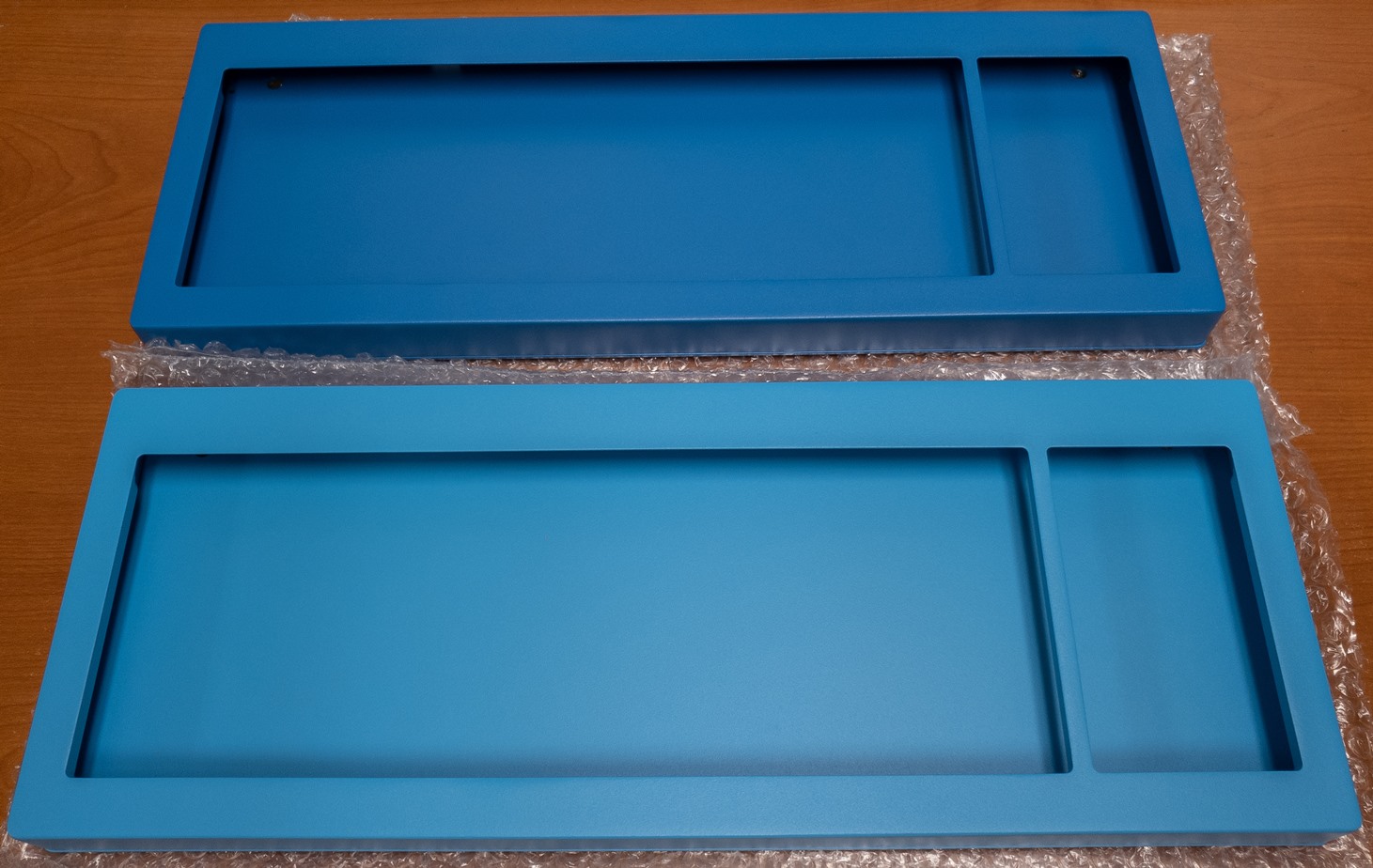

Here is a photo showing the new tougher powdercoating option on the compact cases that was mentioned several months ago. Dark Blue and Carolina (Light) Blue are shown below.
For compact keyboards shipping this year, everyone gets the new improved option instead of the anodized option which was more easy to scratch. The new cases are also from the brand new die cast aluminum molds as noted before (makes the case two piece instead of three piece) The new cases are fully compatible with the older batch of internals in case anyone wanted to upgrade.

Ellipse, I got a question - better: suggestion - for the F77 and F62 Ultra Compact Case: The cases a great, bot the bottom plate is absolutely lackluster. It would be kinda "meh" on an ordinary board, but on the ModelF Keyboards it is a bit ridiculous. It is like two levels below the rest of what you deliver. Feels like a bummer. Please don't missunderstand me - ALL of your work is highly appreciated, eternal love, man! But this specific part of the board just does not deliver the same feeling of luxuary and perfection.
The bottom plate should be improved via two things, one is imho mandatory:
Countersunk holes for the screws. Not sunken screws are just bad design, overall: They deliver no advantage, but look fugly and make moving the board without feet just strange, especially when you compare it directly to the OG zink case.
Second improvement would be a bigger one, but I'd love to see this: A second plate ground plate/addon with integrated lifting to give the board a nice 5% lifting - this would mimik the feet (albeit in the lower setting) of old XT/AT Model Fs AND would add even more heft to the board.
Would one or even both of these upgrades be possible?

Shihatsu regarding your suggestions, as noted a while back there was an issue with the countersunk holes breaking through the original prototype. Overall they weakened the board as they could not be screwed in tight enough to avoid a gap between parts of the compact case. The new design with exposed screws fixed that issue. However I will note that with the more recent beam spring project those screws are countersunk and I have not seen the same issues appear. However the compact case design has been finalized with the current design, which uses custom-made torx screws from brand new molds that have already been produced. Regarding the tilt there are bumpers of varying heights that can adjust the angle of the board. I have no plans to recreate the molds for additional IBM style supports, though maybe some folks could design some 3d printed options? I recall one or two projects with 3d printed feet for the new Model F keyboards.
