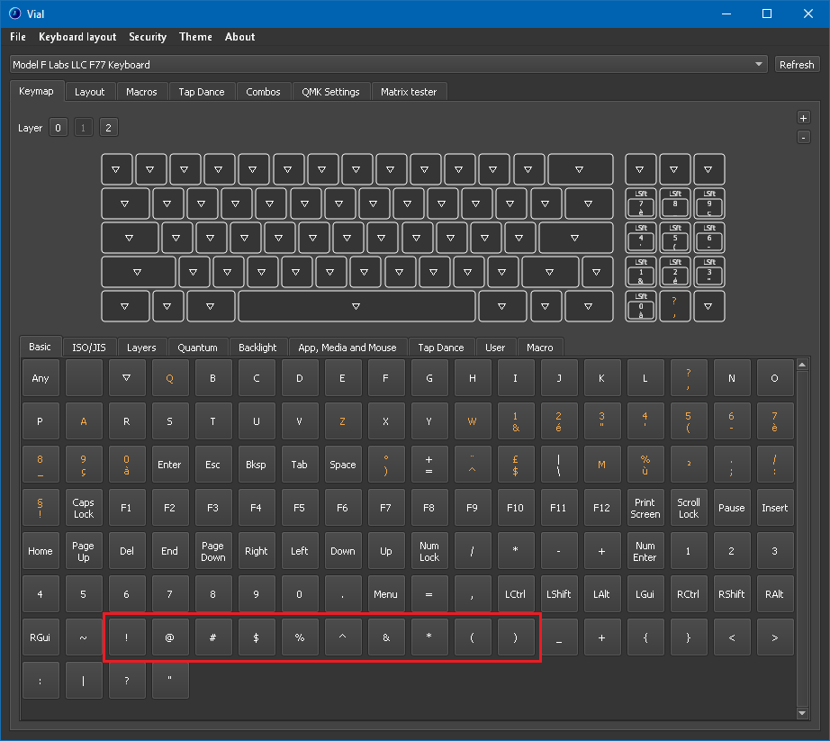

- the firmware apparently just crashed for no apparent reason; un-plugging the keyboard rebooted it
- I'd like to setup the numpad as per "layout 3" on Ellipse's website, and I discover (Linux) that Shift + direction does not "extend the selection" but "switches to numeric"... I'll search for the proper QMK setup for this; any pointer appreciated...
Ah, nearly forgot about Vial app (fresh 0.5.2). As I understand it, everything is saved inside the keyboard, and reloaded when openning the app.
The specific layout is apparently saved, except for the "split backspace" option: split right/left shift and Enter style are restored, but not the split backspace checkbox. The key value is OK though when re-checking that box.

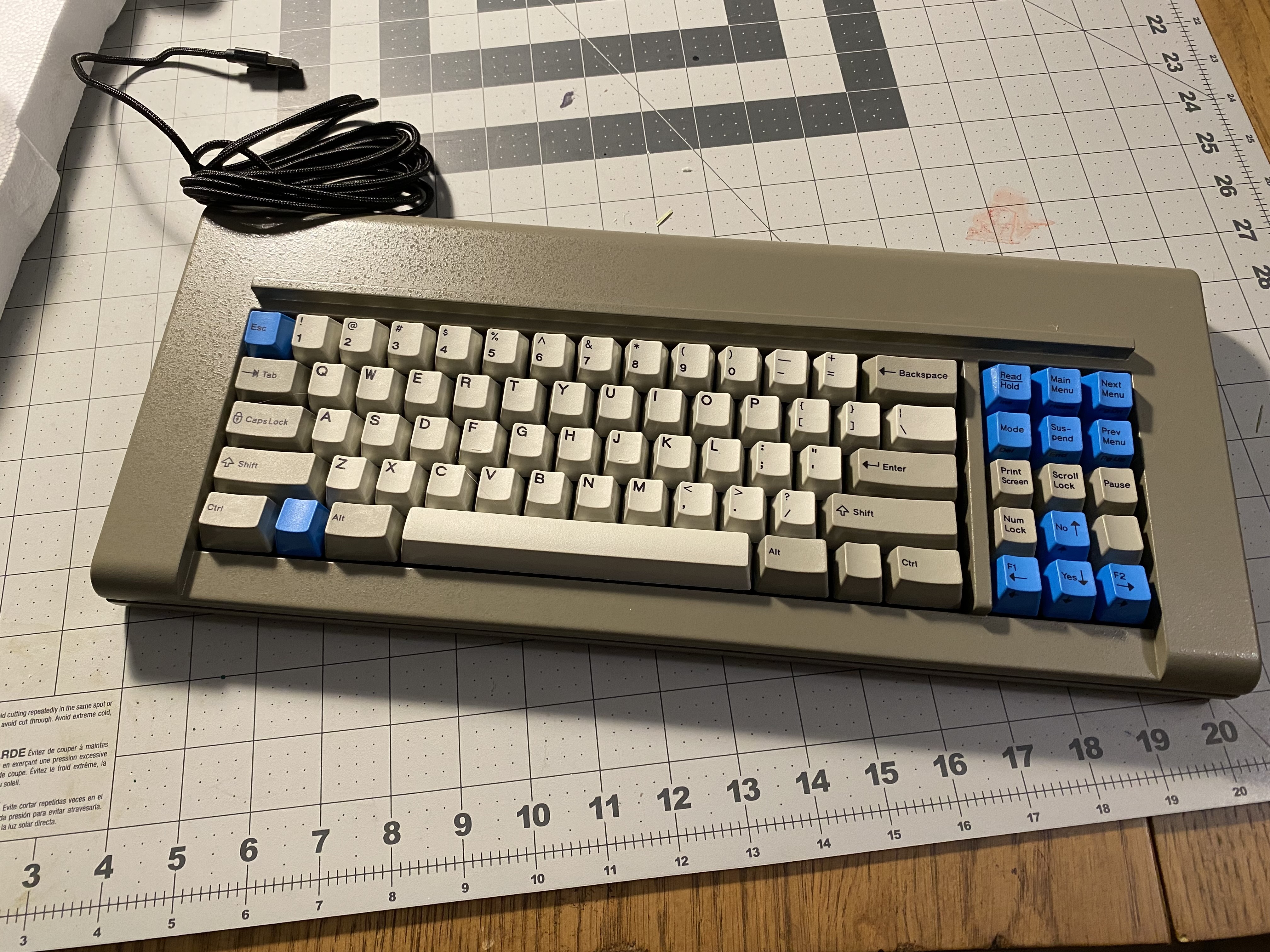

Hello! I have finally received the F77 I ordered in 2018. I managed to get through the hell of fixing a non-responding enter key (the only key on the keyboard to do this), only to find I don't really understand how the keymapping works. I was under the impression that the keyboard would have been programmed to work with my chosen numpad (block 4), but it is not (it is instead set up for printscr/arrows/etc). From looking at the QMK generator website, I cannot figure out how to set up the layers to work with numlock the way I imagine they should (numlock is pressed once, now i have the numpad). Could someone please give me a file that is set up correctly for a regular layout F77 with numpad 4 (image below to verify layout)? I have not yet updated any firmware, but have confirmed that I run QMK (the pandrew QMK utility works).
Very excited to finally use this!

Interesting; I'd definitely be interested if this keeps happening to you. I have only experienced instability when trying to build firmware from newer copies of Vial (checked out from git 'master' anytime within the last few months), which is why to-date I have kept the Vial firmware builds for New Model F at roughly the version 0.4.1 level (though as you noted later, newer versions of the Vial app have no problems working with this older firmware; that said, of course any newer 0.5.x features won't be available).sedevidi wrote: 13 May 2022, 19:08
The symptoms when I have seen crashes or other weird behavior with fresher Vial codebase make it appear that certain Vial features (namely, Tap Dance and/or Combos) and pandrew's capsense matrix code are scribbling over each other's memory spaces. Those specific Vial features don't even have be actively used, just enabled in the build. So far I've been unable to get to the root of the issue, but to I'd love to chat with pandrew about this sometime...it would be nice to be able to keep up New F Vial firmwares with progress that's happening in Vial core development.
All that said, I have been "dogfooding" my own Vial hex files for many months now, and they have been perfectly stable for me...
Not entirely clear to me what you mean...are you saying that you expect Shift + any number pad key to always result in a nav action (+ of course expanding selection due to Shift) regardless of the state of Num Lock? Because assuming Num Lock is on, Shift + a numpad key is still going to result in a number, not a nav action. [EDIT: I'm wrong! See further discussion in later posts!]sedevidi wrote: 13 May 2022, 19:08
If you're saying this is happening while Num Lock is for sure off, though, then not 100% sure, but it almost sounds like your Linux is configured to ignore state of Num Lock if you activate a number pad key with a modifier. It is of course entirely the OS's prerogative what to do when particular scan codes are encountered; for example, going back to its classic origins, even modern macOS has no concept of "Num Lock" & the numpad always generates numbers and never nav actions, which as I recently learned makes F77 block option #3 extremely inconvenient on a Mac. Turns out I use the nav commands more often than the numbers on the numpad, and so to avoid having to continually change key mappings within the keyboard firmware when switching between Mac and Windows, I had to remap the keys at the OS level on my Mac to do what I wanted (nav default / as if Num Lock is "off"). But without Num Lock, I now have no way of toggling between nav commands and numbers with just the press of a single key.
A quick Google on my part unearthed this SO / AskUbuntu post, where someone describes a problem eerily similar-sounding to yours, implying this isn't actually the F77's fault but has something to do with how the OS itself is configured. Might be worth a look: https://askubuntu.com/questions/57079/x ... ke-windows
Yes, this is a known issue, although I thought it was previously discussed in this thread but cannot find it now (it may be that I only addressed it with somebody else via PMs).sedevidi wrote: 13 May 2022, 19:16The specific layout is apparently saved, except for the "split backspace" option: split right/left shift and Enter style are restored, but not the split backspace checkbox. The key value is OK though when re-checking that box.
It actually has nothing to do with Vial: the same problem also happens in the VIA app, and it happens in both the VIA and Vial apps regardless of whether you use VIA or Vial firmware. It also only happens on the F77, and not on the F62. I can reproduce the bug as far back as darkcruix's original VIA firmwares, so it has actually existed since the beginning. It's not clear to me if this is a VIA firmware bug on the keyboard (remember that at the firmware level, Vial is built on top of / is dependent on lots of VIA code), or some problem with the composition of the VIA JSON keyboard definition for the F77, but I also haven't taken a lot of time to debug this yet. As you noted, it works fine and is merely a weird cosmetic bug (you have to recheck the box after restarting the app every time you want to change that extra key).

That link is apparently the same issue. I found the "Make Shift+NumPad work like Windows" checkbox in the Gnome Tweak Tool, but it doesn't seem to do what I need.NathanA wrote: 13 May 2022, 22:39Not entirely clear to me what you mean...are you saying that you expect Shift + any number pad key to always result in a nav action (+ of course expanding selection due to Shift) regardless of the state of Num Lock? Because assuming Num Lock is on, Shift + a numpad key is still going to result in a number, not a nav action.sedevidi wrote: 13 May 2022, 19:08
The exact problem is:
- numlock ON: keys type numbers
- numlock ON: shift+keys moves the cursor while selecting
- numlock OFF: keys move the cursor
- numlock OFF: shift+keys types numbers
I just also noticed that desktop keyboard shortcut using arrows or pageup/down rely on pressing the actual keys from the nav cluster, but do not work with the numpad keys even with numlock OFF.
So I'm thinking about the same solution you thought about above: dedicate a full layer to the numpad numbers, and make numlock toggle the keyboard layer instead of letting the host determine the numlock state. The F77 will then send nav cluster keys when not-pseudo-numlocked, and numpad keys when pseudo-numlocked. Some Fn+NumLock key must also remain somewhere, just in case the host is not in the correct numlock state. I don't know how it could work with other temporary layers (Fn+HHKB alpha keys).
As I understand, memory constraints in the firmware don't allow more than 3 layers, though...
Adding an LED to show the current layer would also help.

Hah, fascinating. But also...that's screwed up. So, I actually had no idea (...never tested it; never had a reason to...) that apparently even in Windows, if you Shift the keypad keys while Num Lock is on, it executes the nav commands. I would not have guessed/assumed that shifting the keypad keys does anything. The difference apparently is that shifting the keypad keys in Windows with Num Lock off continues to output nav commands, and then just modifies them as you would expect (making/expanding selections). (I now wonder if this works the same way going all the way back to MS-DOS, and I just never knew it.)sedevidi wrote: 14 May 2022, 00:45
Why some Linux distros would change that, no idea. Perhaps they figured it would be more consistent if shifting keys affected by Num Lock works both ways, since shifting alpha keys when Caps Lock is on also acts as a negation in the same way. But yeah, with a less-than-100-key keyboard, that's a non-starter.
I actually just managed to get the simulated Num Lock working pretty easily within VIA/Vial. I'll respond to HatefulLight's post with the deets. But, yes: the major drawback is that there is no way for the host to know with this solution whether your simulated Num Lock is actually "on" or not, so no way to display the status of it anywhere. And since the keyboard itself lacks LEDs (at least when stock...), you have no way of knowing whether "Num Lock" is on or off until you hit a key.
EDIT: additional comments
Eeehh...I mean, you can do that, but honestly why bother. Since your keyboard will never transmit any actual keypad scan codes to the host, does it ever practically matter if "real" Num Lock is on or off? Your keyboard will do exactly what you'd expect regardless of the host's Num Lock state.sedevidi wrote: 14 May 2022, 00:45Some Fn+NumLock key must also remain somewhere, just in case the host is not in the correct numlock state.
I address this below. Regular keyboard functions stay at layer 0, everything on layer 1 gets moved up to layer 2, and "Fn" key definition on layer 0 is reconfigured to access layer 2 instead of layer 1. Number keypad goes on layer 1 with all other keys set to passthrough to layer 0. So everything works as expected regardless of state of pseudo-NumLock as you call it. The only problem is that it displaces the few kinds of keyboard management functions that were on layer 2 (like bootloader mode, NKRO toggle, solenoid toggle & dwell time adjustments, etc.); you will have to find new homes for the ones you want to keep around.sedevidi wrote: 14 May 2022, 00:45I don't know how it could work with other temporary layers (Fn+HHKB alpha keys).

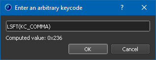

...oh, also in other "TIL" news, until I did some poking around today in Vial, I had no idea that QMK has a built-in version of the Esc key that sends ~ when you press Shift+Esc.
This. Changes. Everything.
...no, really. It is clearly super difficult to change years of established muscle memory...
(I presume it would be possible to craft some complex QMK formula that does this, but it's extremely convenient that this just exists out-of-the-box, so to speak.)

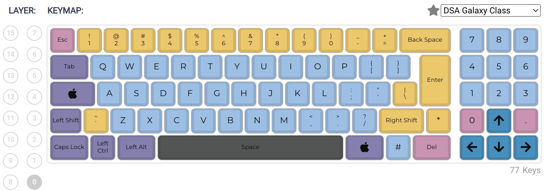

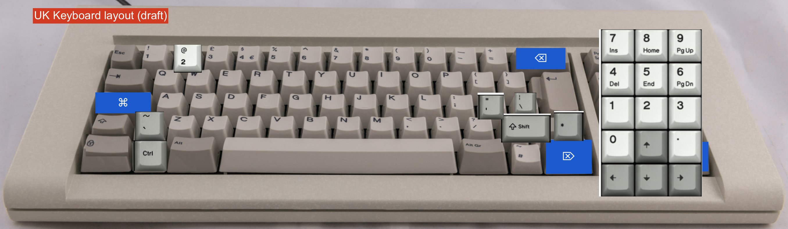

I just received my F77 ISO (UK) keyboard last week, ordered in Feb 2017! I didn't realise that I'd have to assemble all the keys on the keyboard myself, I genuinely believed the keyboard was shipping entirely pre-assembled. I hope to get time to put my keyboard together next month and would like to order a few extra keys and make a custom layout. I mostly use MS Word, Markdown or LaTeX, but have no knowledge of hardware, software or programming, and I know nothing about flashing keyboards.
I am considering ordering a few extra keys and hope to make a custom keymap to mimic my ISO-UK Macbook Pro's layout, with just a few little tweaks (cf. my ugly collage picture of my draft layout) Just to quickly see which keys I want to order and how the configuration works, I headed to Purdea Andrei's QMK Configurator website and selected the layout: ISO_hhkb_split_shift_regular_backspace (see picture)

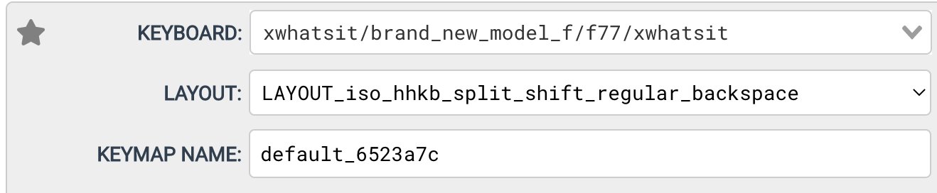

I have then configured the KAYMAP using a mixture of the ANSI and the ISO KEYCODES (see picture) to make the Keymap appear how I wish to use it.
QUESTIONS TO THE COMMUNITY
1. I have a key as part of my F77 purchase that I do not see in Andrei's QMK configurator - the number 2 key in the number row with @ and € symbol (FYI - identical to the number 2 key on my UK macbook laptop), but I don't see any equivalent option on the QMK configurator. Is this a known issue with the QMK configurator? I don't even see the € symbol anywhere on the configurator website...?
I've just watched:
- MechMerlin's video "QMK Tutorial: QMK Configurator" at: https://youtu.be/-imgglzDMdY
- and MechMerlin's video "QMK Tutorial: QMK Toolbox (Flashing Firmware On Your Keyboard)" at: https://youtu.be/fuBJbdCFF0Q
2. Can anyone vouch for the ease and accuracy of following this step-by-step video guide for a complete newbie using Andrei's QMK configurator on a f77 and a Mac?
3. Okay, so on a keyboard on a Mac, how do you activate a "layer"? (as in the QMK programmable layers...) Sorry, this feels like it must be such an obvious question, but I truly don't have a clue.
4. How would I program the numbers row keys to act as function keys? So that when I press fn + 1 = F1, Fn+2 = F2, etc?
The idea of installing keys and flashing the board myself scares me a bit, especially after reading some nightmare stories and videos like Chyrosan's. I'm hoping that Andrei's QMK configurator and the MechMerlin videos have paved the way to painless and beginner-friendly configurations. I guess I'm looking for a little reassurance from the community.
Cheers!

First off,
When you press a key on a keyboard, like say the '1' key, the keyboard isn't transmitting (the ASCII or Unicode encoding of) a literal number 1. Rather, it's telling the computer that "the key that is (as us mere humans would describe it) the second key from the left in the top row got pressed". At that point, the (software on the) computer has to decide how it is going to respond to that particular key getting pressed. Generally, it responds by outputting a numeral 1. But it doesn't have to: that's just conventionally what most do, because that's the legend that is printed on that key cap on most keyboards. But the computer software could be reprogrammed to do something different in response to that particular key getting pressed.
Likewise, you can also (re)program a keyboard to tell the computer that a different key got pressed than the one that actually did: you could (in a sense) tell the keyboard to "lie" to the computer and say that the 3 key got pressed instead of the 1 key. The computer wouldn't know, so from its perspective, you pressed 3 when you actually pressed 1. (I mean, at the end of the day, what's printed on the key and what spot on the 'board you put that key cap on is arbitrary, right? But generally speaking, most reasonable people want them to match up as well as be located in a relatively sane arrangement.
So the determination re: what happens when a given key gets pressed is a result of a combination of both the keyboard and the computer taken together, not strictly one or the other.
That said...
This again goes back to the first principles I opened with. A "layer" in QMK is just a way of being able to have more available keys to press than you have physical keys that are present on your keyboard. You can think of them as "virtual" keys, if that's at all helpful. You designate a particular key as a special modifier key that causes QMK to select a different "layer" when you press it. At that point, if you press another key while holding down that layer-selecting key, the function of the key you press can be completely different than if you weren't pressing the layer-selecting key. So for example, you could configure a second "layer" of keys on your keyboard where the spot that is normally occupied by the 'B' key causes the keyboard to instead send a Tab. You can then configure QMK to use Caps Lock to select this second layer. Then if you press Caps Lock + B, the keyboard sends the same code to the computer that it would send if you pressed the actual Tab key.
This is a rather mundane example of course, just to explain the concept. Where it can become truly useful -- especially in the case of a keyboard with fewer-than-average keys on it like the F62 or F77 -- is that if there is a key that you just can't live without but for which there is no open spot, you can stick it on a second layer and access it that way. Or you can map a macro that's built into the keyboard to keys on the second layer, etc.
The crucial way that this whole concept differs from when you're using other common modifiers like Shift / Control / Option / Command / etc. is that the computer knows and is aware that those other modifier keys are being pressed, and the computer is involved in determining what happens when you employ a key chord that includes one or more of those modifiers. But the key you designate to select a QMK layer doesn't send a key-down event to the computer. 100% of what's taking place there is taking place wholly within the keyboard alone, and the computer has no idea that additional key is being pressed. So in the above example, if you make Caps Lock your select-2nd-QMK-layer key, not only is it no longer acting as Caps Lock, but your computer has no idea that Caps Lock got pressed when you did Caps Lock + B. From the computer's perspective, it only saw Tab happen. Not some analogue to Shift + Tab or Caps Lock + Tab or (Mac) Fn + Tab ...just plain ol' Tab.
The default layout that Ellipse pre-loaded onto your keyboard should already have this set up for you, but if you compile a new QMK firmware for yourself, you will have to reproduce this if you want to maintain it. If you didn't get Split Right Shift option, then by default the key normally labeled Ctrl on the bottom-right is acting as QMK second layer select ("Fn" for short). So you'd press RCtrl+2 for F2 out of the box. If you have a Split Right Shift, the key to the right of Shift is your QMK "Fn" key by default.
Note that "Fn" in this context has nothing to do with the key marked Fn on your MacBook's built-in keyboard, whose sole purpose is pretty much to allow you to use the top F1-F12 row to either act as actual F-keys or to act as the shortcuts for certain system functions (volume up/down, screen brightness, etc.). As far as I know, there is no way to duplicate that key within QMK. Would love to know if I'm wrong...
Hopefully this is starting to "gel" for you now a bit after reading all of this, and now that you know some of this stuff, it may influence how you've been thinking to re-arrange your keyboard. For example, you didn't designate any key (at least that I can see) to be a (QMK) "Fn" key, which I dare say is going to make your life more difficult! (In QMK parlance, the layer select key is called "MO" for MOmentary layer select [only is selecting the layer as long as it is being held down]. Layers are zero-index, so the 1st layer is layer 0, the 2nd layer 1, etc. Layer 0 is the "default" layer and is what you do all of your regular key mapping on. To program a key to act as the second-layer-select, you would configure the action for that key to be MO(1) for MOmentarily select layer 1. The MO(x) key function is located under the Quantum tab of QMK Configurator.)
Congrats if you managed to read through all of that, and hope this helps.

I just watched them, and I'd say yes: those are generally correct. In particular, QMK Toolbox is absolutely the right solution for flashing a QMK-capable keyboard on a Mac for sure. The things I would add and the caveats I'd give would include:Jean-Loup wrote: 14 May 2022, 04:10 2. Can anyone vouch for the ease and accuracy of following this step-by-step video guide for a complete newbie using Andrei's QMK configurator on a f77 and a Mac?
- The MCU on the controller for this keyboard is the ATmega32u2, not the more common u4. Make sure to choose correctly.
- You cannot force this keyboard into bootloader mode using either the "Bootmagic" or "Bootmagic Lite" methods that the second video shows. Depending on what firmware it is running, you may be able to use LShift + RShift + B while the keyboard is plugged in, or there may be another key sequence that has already been mapped to "bootloader mode" like Fn + Spacebar + R is on most stock 'board firmwares from Ellipse. Or you may have chosen a different combo whenever you last configured the keyboard.
- If no key sequence seems to kick the keyboard into bootloader mode, you can try to see if the pandrew utility can detect it, and if so, use it to force the keyboard into bootloader mode.
- If all else fails, this keyboard does not have any kind of reset "button" on its circuit board as the video discussed. Instead, it has 2 open pads that need to be manually shorted together while you plug the keyboard into the computer. Ellipse's manual on his site has more information, as do posts further back in this very thread.
Part of the answer is that it has absolutely nothing to do with whether you have a Mac or not...that part of the equation is absolutely immaterial and doesn't change the answer to the question in the slightest.Jean-Loup wrote: 14 May 2022, 04:10 3. Okay, so on a keyboard on a Mac, how do you activate a "layer"? (as in the QMK programmable layers...) Sorry, this feels like it must be such an obvious question, but I truly don't have a clue.
This is exactly where the QMK layers thing comes in handy: as noted, there is no dedicated function row on this F77 keyboard, and real-estate on a board with fewer keys on it is valuable. So: if you don't want to lose additional keys on your keyboard (like for example the right 3x5 block of keys) to act as dedicated F1-F12 keys, you instead put F1-F12 on a second QMK layer, and naturally the top number row is a great place for that. Once you pick a key on the 'board to be your QMK "Fn" (second-layer-select) key, you press that key plus the appropriate number key to get the keyboard to output F-whatever to the computer.Jean-Loup wrote: 14 May 2022, 04:10 4. How would I program the numbers row keys to act as function keys? So that when I press fn + 1 = F1, Fn+2 = F2, etc?

I followed your detailed instructions, and re-did the same with my initial setup, except aiming for block #3, and the added difficulty that in my locale, the number row needs shift to output numbers, so... I had to use true numpad number keys in the numpad number layer (which is kind of logical).NathanA wrote: 14 May 2022, 02:31 So making the first option work (simulated Num Lock using QMK layers) turned out to be easier than I thought.![]()
The downside is that I need to make sure the host is in numlock state, or the direction keys are no numbers, and subtly different: eg. nav cluster PgUp vs. numpad non-numlock PgUp, which work in a text editor or Firefox, but not as desktop shortcuts. I thus added KC_NUMLOCK on the numlock key in layer 2 (Fn+Numlock will toggle system numlock state).
And also added numpad number keys at their location in layer 2: Fn+2 is thus "2" in both default layer and navcluster layer 1.
The keyboard is now very much like I wanted it. A bit more easy tuning with Vial, and I'll be OK (I just need to get used to the split backspace, which I apparently hit on the "Del" side more than I anticipated, and the large spacebar, which makes AltGr a long way on the right).
I also fixed a little problem in your initial settings: LGUI was mapped to nothing in layer 1 (Fn), rendering a key combo needing LGUI + some other key triggered with Fn non-working. Changing LGUI to KC_TRANS (transparent) made the combo work.
Thanks to all!

I had no idea AZERTY required Shift to be applied to get numbers from the top row number keys!sedevidi wrote: 14 May 2022, 17:04[...] except aiming for block #3, and the added difficulty that in my locale, the number row needs shift to output numbers, so... I had to use true numpad number keys in the numpad number layer [...]
The downside is that I need to make sure the host is in numlock state, or the direction keys are no numbers, [...] I thus added KC_NUMLOCK on the numlock key in layer 2 (Fn+Numlock will toggle system numlock state).
Just to be clear: you have "Num Lock" key set to TG(1) on layer 0, but set to actual Num Lock on layer 2, so you have to press both NumLock followed by Fn+NumLock to get numbers from the keypad? (After you do Fn+NumLock once though, it should remain enabled, so then you can toggle back and forth between numbers and nav commands just by pressing NumLock?)
You actually don't need to do all this to get working pseudo-NumLock, even with French AZERTY. You can have single keys send modifiers along with the assigned keystroke, so instead of using keypad 1, you can use top row 1 but have Shift be applied to it automatically so that you get a number. You don't even need to use macros to do this.
Here is a screenshot of Vial configured with a numpad layer without requiring "real" Num Lock that I think should work for AZERTY:
To set the keys with the Shift modifier applied to them, I just used the built-in keys in the Vial list that show the shifted values for the top number row in a QWERTY context, which I highlighted in red...using these applies the Shift modifier for you automatically (e.g. the '!' key is Shift+1 because on a QWERTY keyboard Shift+1 is how you get '!'). But you can also manually edit any key in Vial simply by double-clicking it, which will give you a text box that you can use to type in the exact QMK key value you want sent when that key is pressed. You can see in the screenshot that all of the key values for the numbers are a "box within a box"...outer box is the modifier (LSft in this case for Left Shift) and inner box is the key being modified.
One thing that wasn't clear to me when I was putting together this example is how AZERTY handles the full-stop (.) key on the numpad. I thought France used decimal commas, but every example picture I could find of an AZERTY keyboard shows a period key in the numpad area instead of a comma. Does that key actually output . or does it output , even though the legend on the keycap is a . ?
In my example from above, I put the regular comma key in that spot. But if you want it to output a period/full-stop instead, then you can substitute as appropriate. On AZERTY it appears that . is achieved in the alpha block area by Shift+; so you will have to apply Shift modifier to that key just like with all of the numbers. However, since QMK is QWERTY-centric internally, and since the ; and . key on AZERTY is in the same place as the < and , key on QWERY, you need to set that to KC_COMMA to get the right key. Thus the full key definition would look like this with the Shift modifier applied:

Yes, that Shift+numrow is ugly. We can type SOME accented characters without any modifier though... And some punctuation too, which is nice. AFNOR (french normalization) is designing a new AZERTY layout to solve those issues, but I don't see any desire from manufacturers to follow...NathanA wrote: 15 May 2022, 05:22 I had no idea AZERTY required Shift to be applied to get numbers from the top row number keys!
That's exactly it. I also added a desktop extention that show the lock statuses (num, caps). In theory, numlock should always be ON since boot, but I needed the key there, just in case (and used it once).NathanA wrote: 15 May 2022, 05:22 Just to be clear: you have "Num Lock" key set to TG(1) on layer 0, but set to actual Num Lock on layer 2, so you have to press both NumLock followed by Fn+NumLock to get numbers from the keypad? (After you do Fn+NumLock once though, it should remain enabled, so then you can toggle back and forth between numbers and nav commands just by pressing NumLock?)
I was wondering what those buttons were for in the Vial interface! I just tested this layout, and it works. I'll report if I see any practical issue in the long run.NathanA wrote: 15 May 2022, 05:22 You actually don't need to do all this to get working pseudo-NumLock, even with French AZERTY. You can have single keys send modifiers along with the assigned keystroke, so instead of using keypad 1, you can use top row 1 but have Shift be applied to it automatically so that you get a number. You don't even need to use macros to do this.

Ah, that's another ugly thing! The mapping to "," is at application level. Some application do, some don't... Gnome calc does not convert "." to "," but interprets them the same. Libreoffice Calc needs a regular "," for number, but does not convert numpad-".", but I think Microsoft Excel does. Maybe there is a checkbox somewhere in Libreoffice to hack this, that I didn't look for. I vaguely remember that Libreoffice did the substitution for me some time ago... And any actual computer code need "."...NathanA wrote: 15 May 2022, 05:22 One thing that wasn't clear to me when I was putting together this example is how AZERTY handles the full-stop (.) key on the numpad. I thought France used decimal commas, but every example picture I could find of an AZERTY keyboard shows a period key in the numpad area instead of a comma. Does that key actually output . or does it output , even though the legend on the keycap is a . ?
I forgot that this was one of the good thing of a fully programmable keyboard, and just did this. Thanks! I'm not sure it's practical for my usage though...NathanA wrote: 15 May 2022, 05:22 In my example from above, I put the regular comma key in that spot. But if you want it to output a period/full-stop instead, then you can substitute as appropriate. On AZERTY it appears that . is achieved in the alpha block area by Shift+; so you will have to apply Shift modifier to that key just like with all of the numbers. However, since QMK is QWERTY-centric internally, and since the ; and . key on AZERTY is in the same place as the < and , key on QWERY, you need to set that to KC_COMMA to get the right key. Thus the full key definition would look like this with the Shift modifier applied:

Here is a nice photo (shared with permission) of the Industrial Gray keyboard with the Industrial SSK 12 key set and a right side block arranged in an alternative way.
