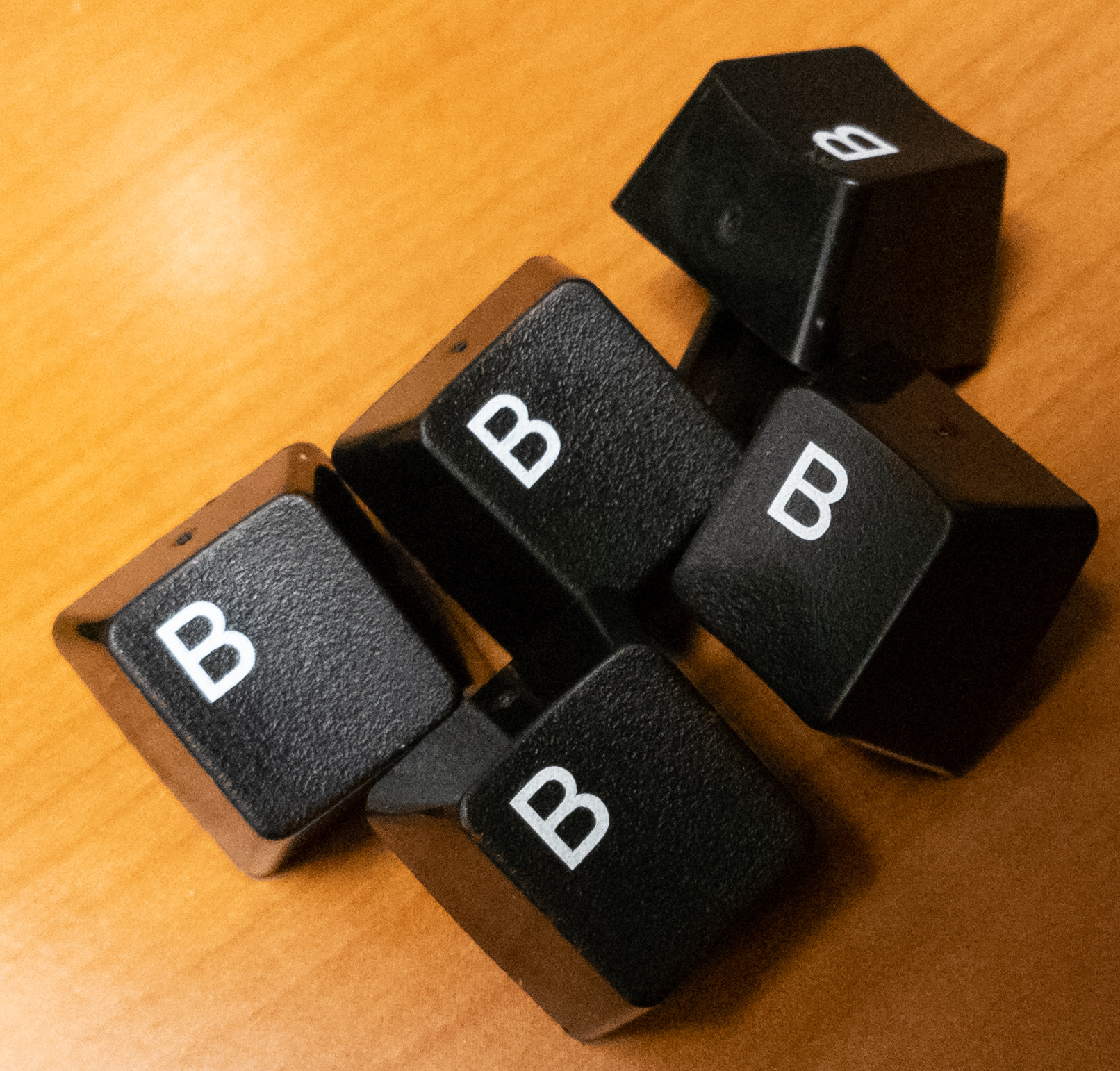

Re: F62+F77 orders now open! New Kishsaver+Industrial Model F Keyboards
Posted: 31 May 2022, 20:15
by Ellipse
Pad printing update: I received the air shipment from the factory and here are the latest pad print samples. I requested the printing to be thicker like on the original IBM M13. Of course the samples do not have the correct alignment of the finished products. Please disregard the cell phone quality of the photos.
As a reminder please sign the White text on Black Keys Pad Printing Interest form to reserve your spot in line for these sets:
https://docs.google.com/forms/d/1873Q9w ... 4XtN1DfNk/
So far there are 65 requested sets which is enough quantity to proceed with production after good samples are produced.
- 20220531_135121.jpg (668.61 KiB) Viewed 53938 times
- 20220531_135142.jpg (1.13 MiB) Viewed 53938 times
- 20220531_135144.jpg (1.16 MiB) Viewed 53938 times
NathanA I don't think I'll be making the smaller LED overlays for Unicomp boards as the tooling would be different/extra.
