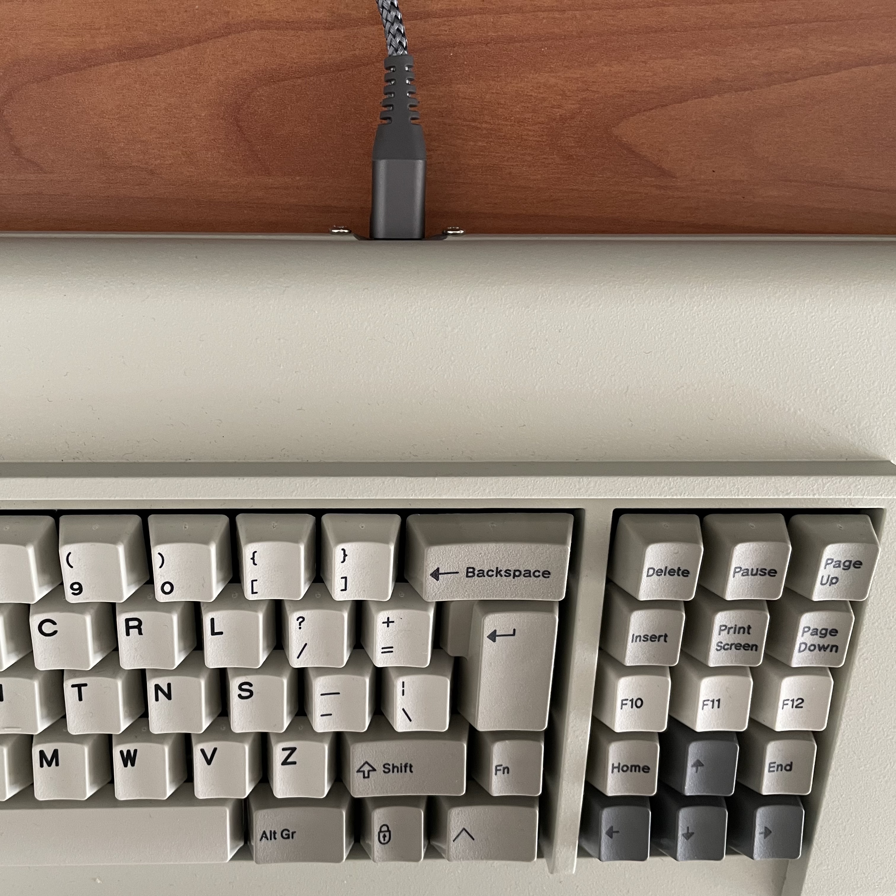

So, I modified my F77 and F62 to have a detachable USB-C cable. Even though it looks clearly DIY, I actually prefer this panel-mounted connector over the ultra-compact version's PCB-mounted connector accessed through a hole. And if the connector wears out or breaks, it's like €10 to replace the extension cord inside the keyboard.
(I also modified both of the keyboards to work with USB-C to USB-C cables, which is what I'm mostly using these days. Thanks again to pandrew for the instructions!)
Re: F62+F77 orders now open! New Kishsaver+Industrial Model F Keyboards
Posted: 14 Aug 2022, 23:29
by BuGless
Arkku wrote: 14 Aug 2022, 18:20 So, I modified my F77 and F62 to have a detachable USB-C cable.
Can you be more specific about the components used? From the picture it's not quite clear what you did.
Posted: 14 Aug 2022, 23:53
by Arkku
BuGless wrote: 14 Aug 2022, 23:29
Sure, there's just a 90º angled USB-C extender directly plugged in to the controller inside the keyboard, and then a 15–20 cm long USB-C extension cable where the female side has screw holes for mounting to a panel. The case of the keyboard is thinned around the connector (the plug doesn't reach the socket otherwise).
(I've linked to the specific ones I bought. For the resistor modification to make USB-C to USB-C cables work, see my earlier post.)
Content warning: crudely modified keyboard case:
I considered airbrushing the exposed metal with black paint, but in the end I decided I kind of like it as is, and it is behind the keyboard anyway.

Here's an interesting F77 setup reported at Cult Of Mac: https://www.cultofmac.com/787679/the-pe ... st-setups/
