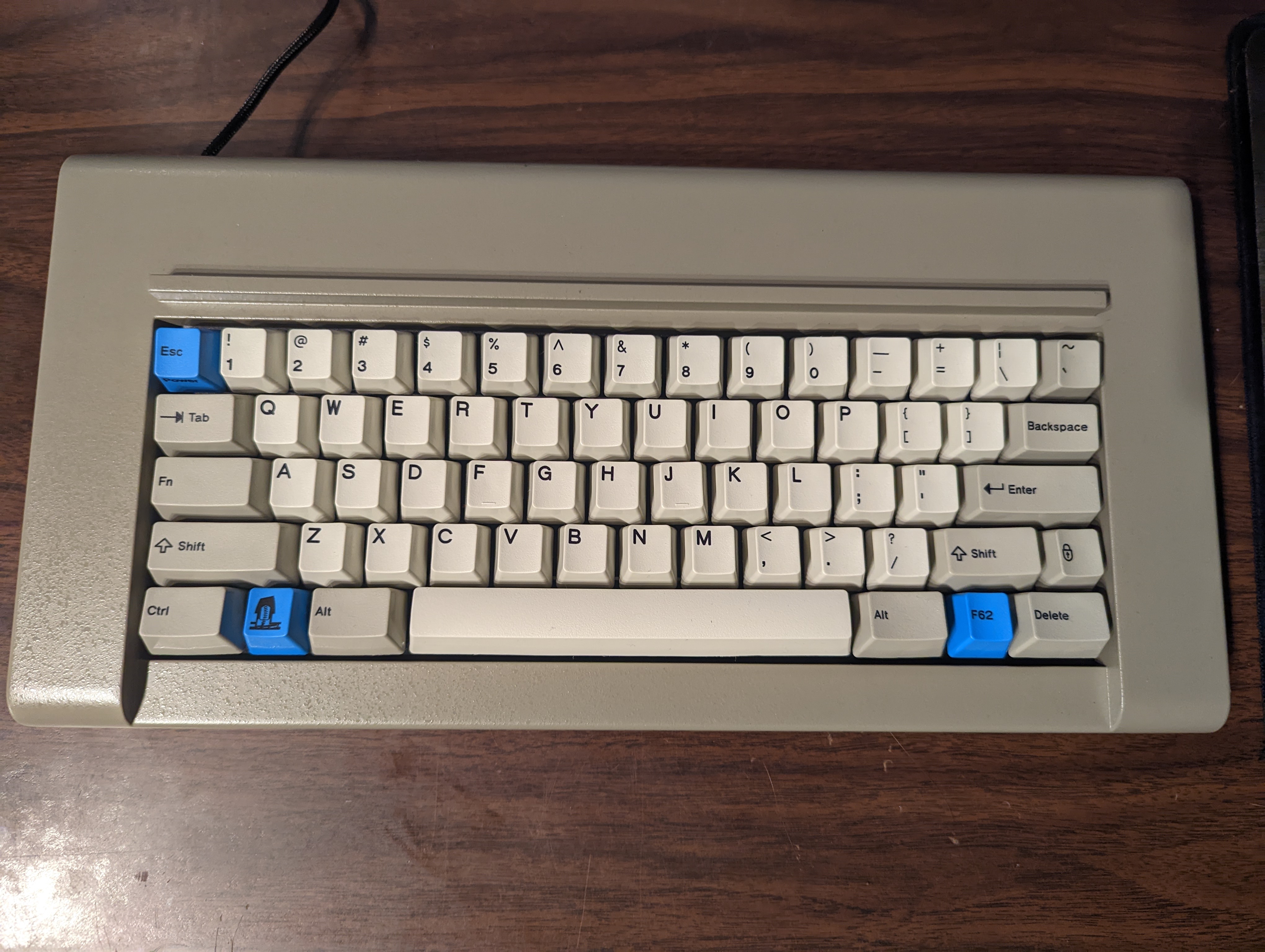

Posting, with permission, another nice and unique setup, this time of the F62 classic style keyboard in Industrial Gray, with a customized split right shift layout.
f62 - Copy.jpg (2.52 MiB) Viewed 11359 times

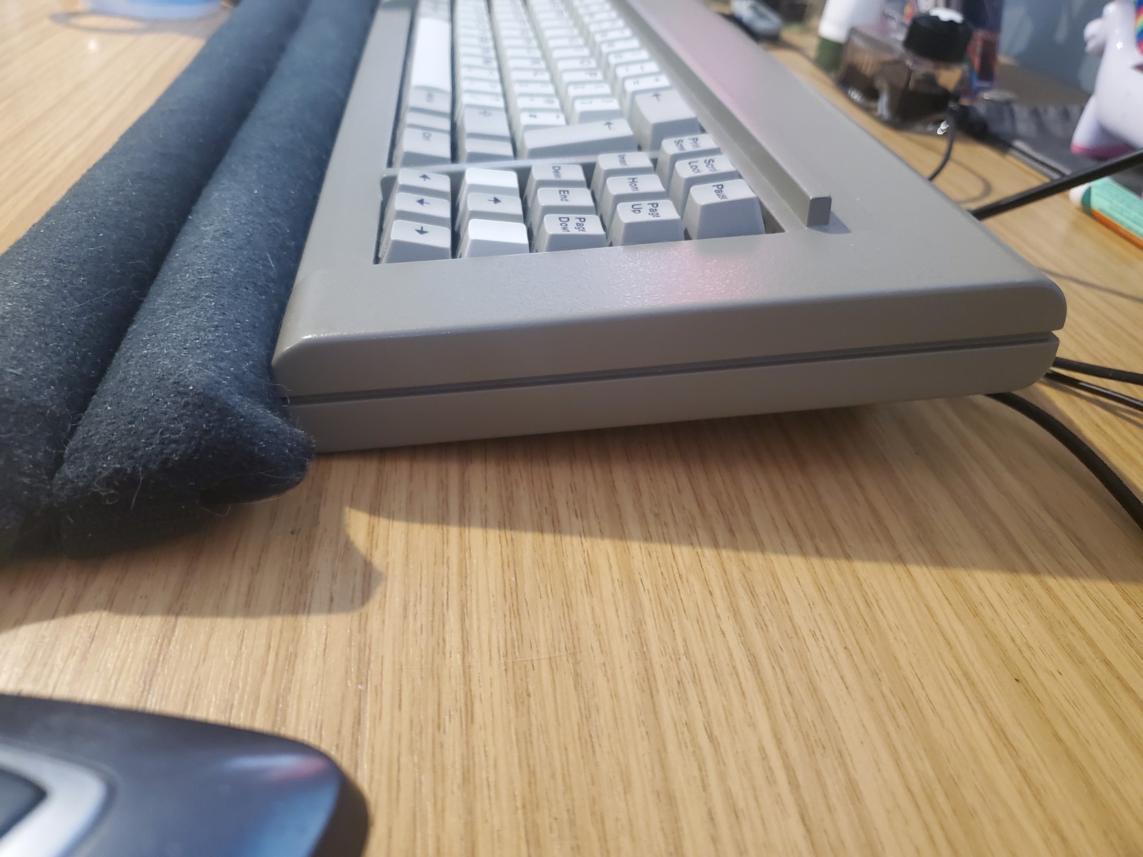

Another nice F77 classic case setup, sharing with permission. I had to share it as it features my favorite pen. I've been using Pilot Precise V5's for over 20 years.
repo_code I don't think it's possible to unsplit a key without opening up the inner assembly and removing the flipper. After uninstalling the keys it only takes a couple minutes - check out the video in the manual on the project web site.
Thanks for the feedback Serhei.
nice setup.jpg (3.73 MiB) Viewed 11145 times
