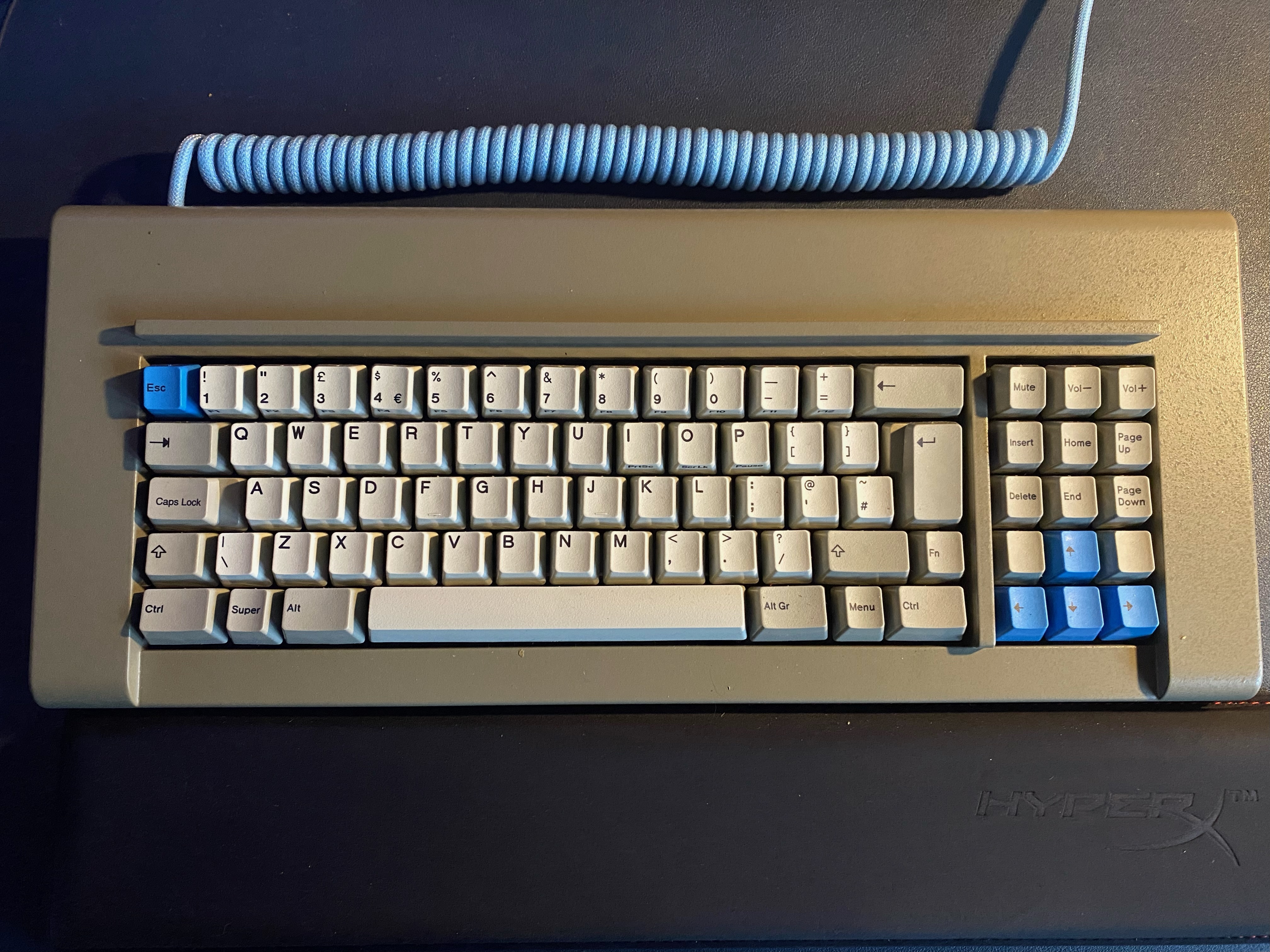

Posting with permission a nice F77 Industrial Gray photo sent to me. The UK layout customizations include HHKB style split right shift, UK front printed keys and some blue Esc and cursor keys.
The unique cable is from https://cablelab.co.uk/
