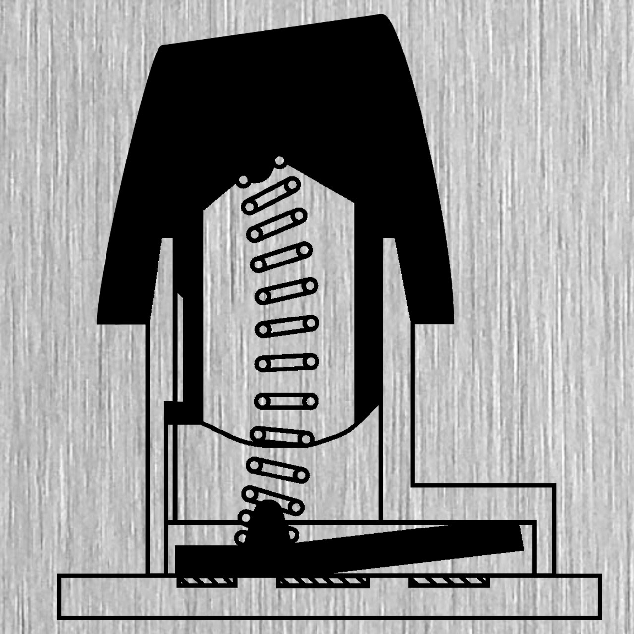

Ellipse, would you consider manufacturing springs of differing weights for your project?
I've always found the Model M actuation weight to be perfect, but Model F's a bit too light for my liking. Of course I stuck with Model F due to its superior key feel and construction. If you offered Model F replacement springs in heavier weights (and perhaps lighter) for your New Model Fs, I (and others I'm sure) would be interested
Re: F104+SSK+122+62+77+50+Ergo orders now open! New Kishsaver+Industrial Model F Keyboards
Posted: 23 Aug 2023, 08:24
by NathanA
jsahmiens wrote: 23 Aug 2023, 08:13I've always found the Model M actuation weight to be perfect, but Model F's a bit too light for my liking.
Not that it would be easy or quick, but I suppose you could try buying a bunch of
Model M springs and flippers, removing the springs from the flippers, and attaching them to the flippers of your Model F...

jsahmiens here is my old note on Higher force springs - these are still available.
Is anyone interested in higher-force springs? I have a sample set of ~120 springs that were rejected as they required a little more force to process. The whole lot is available to one person so they have enough to fill a keyboard with them; please PM me if interested. Pricing will be based on best offer, with a minimum of $1 per spring. Flippers not included. Due to slight variations in the diameter of the flipper nubs I can’t guarantee this will work with original flippers (none of my springs are recommended to be installed on original flippers, as noted a while back). These ~120 springs are a slightly tighter fit than the production springs, so you have to press them a little more forcefully onto each nub. I would describe the sound as approximately the same as the production springs, maybe slightly quieter but still audible.
I also have 230 QC rejected springs without flippers (sound characteristics are off – too high pitch) available in batches of 80, 120, or you can take the whole lot. If you prefer a changing to a higher pitch spring this is the only batch available. Again, only recommended for new Model F flippers but will possibly work with originals. Pricing is the same $1 per spring.

Personally I see higher force springs as an interesting novelty although I could live without them. Would be something I'd like to try out and maybe swap out a whole board if I liked them but I wouldn't be in a mad rush to get them right off the bat.
