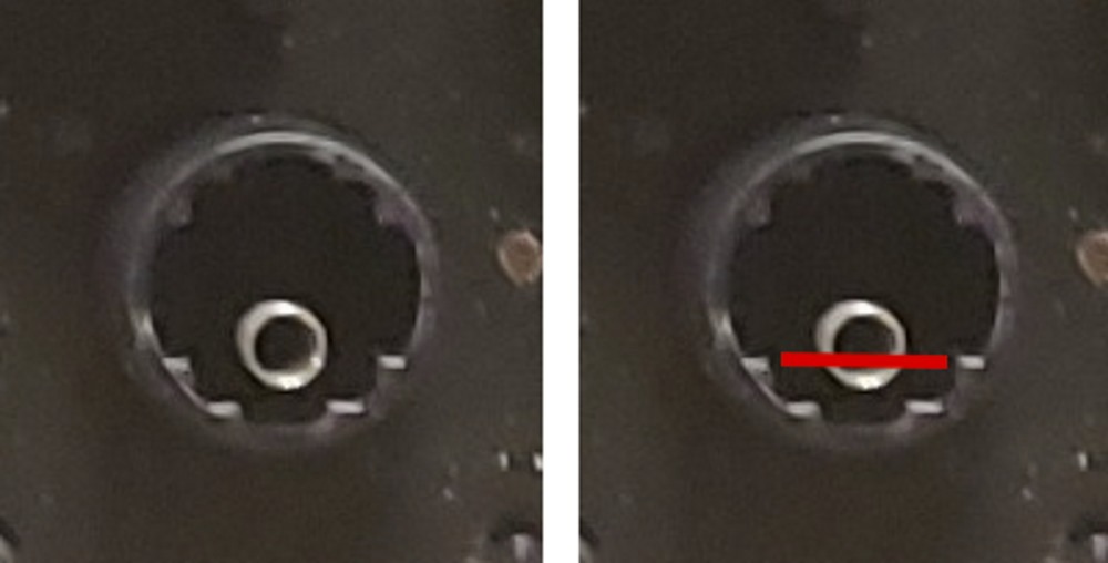

I am getting inconsistent registrations of my "F" key (oh the irony!). Most of the time it works just fine, but it occasionally doesn't register, or it registers twice. I've already tried twisting the spring around and even swapping it with the spring from another key. The signal level also looks OK.
What else can I try?

pilcher wrote: 25 Oct 2024, 01:28 I am getting inconsistent registrations of my "F" key (oh the irony!). Most of the time it works just fine, but it occasionally doesn't register, or it registers twice. I've already tried twisting the spring around and even swapping it with the spring from another key. The signal level also looks OK.
Did you do a full disassembly when you swapped the spring? Try swapping barrels or feet (maybe one of them has a defect), or see if maybe a small piece of debris worked its way down into the assembly?

pilcher my guess is you are not reinstalling the spring correctly, in the correct 12 o'clock position as well as with the spring about 1mm away from the 12 o'clock position of the barrel when the keyboard is held vertically, space bar end up. If the spring is too high up (too close to the 6 o'clock barrel position), buckling errors will occur as you mentioned. I also recommend swapping the keycap with another keycap to see if the F keycap itself was somehow deformed or damaged.
As reported to me through another GH/DT forum member's great research back when the project was just getting started 8 or 9 years ago:
It is important for the spring to be close to the 12 o'clock position of the barrel (as shown below) when the keyboard is held vertically, space bar end up, because the click is not strong otherwise and click errors are more likely to occur.
It is also important for the spring to be close to the 6 o'clock position of the barrel when the keyboard is held vertically, number/function row end up, because the key press will cause the spring to buzz if not in this position. This means that the spring cannot touch the 12 o'clock position because then the spring will be too far away from the 6 o'clock position when the keyboard is flipped to the right side up position.
And finally, springs that are installed too much left or too much right compared to the vertical center will cause errors with installation such as keys not working reliably.

pilcher
26 Oct 2024, 21:18
Ellipse wrote: 26 Oct 2024, 09:09 pilcher my guess is you are not reinstalling the spring correctly, in the correct 12 o'clock position as well as with the spring about 1mm away from the 12 o'clock position of the barrel when the keyboard is held vertically, space bar end up. If the spring is too high up (too close to the 6 o'clock barrel position), buckling errors will occur as you mentioned. I also recommend swapping the keycap with another keycap to see if the F keycap itself was somehow deformed or damaged.
You beat me to it. :D
I connected the keyboard up to my kids' Windows machine, so I could run the signal level monitor, and that allowed me to confirm that the flipper does, in fact, work properly. Armed with that knowledge, I re-re-re-re-re-...-installed the spring, and I was finally able to get it working properly. So I won't need to take apart the inner assembly, which is good news, because I still don't see where the pliers can grip the two plates on the classic F104 in order to slide them apart.
I have a couple of takeaways from this.
  • I don't know that it's really possible to determine if the spring and keycap are installed correctly just from the sound & feel. Personally, I would recommend that folks use the signal monitor when doing the initial keycap installation.
  • Installing the springs onto the flippers is really, really difficult, and that's even more true when the springs have been damaged in shipping.
