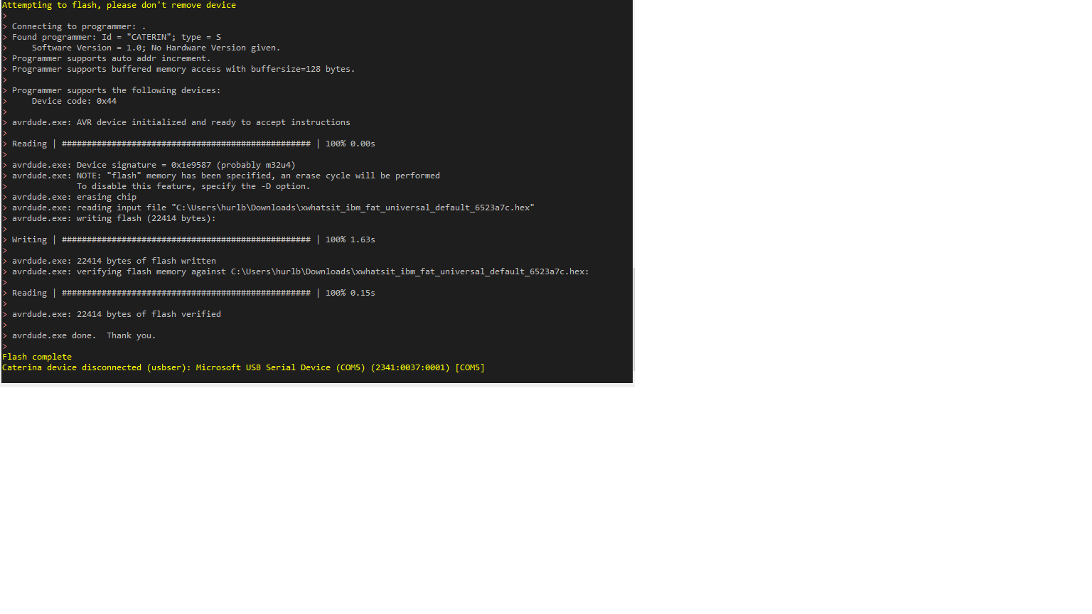

Quick question. Just getting a new controller from the site installed into an original Model T AT and was wondering what the reason was behind having to short J1 on the RP2040, or if that is still needed.
NathanA
29 Nov 2024, 23:34
Rotti wrote: 29 Nov 2024, 11:29 Quick question. Just getting a new controller from the site installed into an original Model T AT and was wondering what the reason was behind having to short J1 on the RP2040, or if that is still needed.
I was confused by your reference to RP2040 since that is the microcontroller used on Leyden Jar, while any references to "shorting J1" are in the context of a Pro Micro, which is ATmega based (specifically, 32u4, vs. the original xwhatsit which uses 32u2). Furthermore, though it should be entirely possible to install a Leyden Jar in any buckling spring capsense 'board including an F AT, you implied you ordered your controller from Ellipse, and though he has Leyden Jars listed on the order form, lower down in the description it is explained he doesn't yet stock these in quantity & thus this is a pre-order situation (not sure if that information is stale or still current, though, admittedly). So if you have a Leyden Jar, you would have needed to order some yourself from a build-to-order outfit like PCBWay or JLCPCB, etc. or participate in someone else's group buy for one.
So I'm going to assume the "RP2040" reference in your post is a mistake, and you really mean that you bought one of the "universal"-style "SMD Model F Controllers" that are driven by a Pro Micro, which it looks like Ellipse is now also manufacturing and selling in addition to the small "wcass" xwhatsits.
According to this post by pandrew discussing these Pro Micro driven controllers, under "Assembly Instructions", it clearly states that "You MUST short the J1 jumper on the 5V pro micro", though he doesn't explain why (for the benefit of us who are unfamiliar with the Pro Micro). Googling around for more information about J1 on the Pro Micro leads me to this site, which gives a very good explanation for the reason: J1 controls whether you are using the on-board voltage regulator or not. On the 5V version, if you feed it 5V and keep the voltage regulator in-circuit, the resulting output will experience a slight voltage drop. Therefore if you have no need for the voltage regulator (which you'd use in order to step the voltage DOWN when you are feeding it MORE than 5V), because something upstream of the Pro Micro is already guaranteeing clean 5V DC power, then it is best to not use the Pro Micro's regulator. This is exactly the situation you would have when driving a Pro Micro using USB, since USB spec (outside of newer USB-PD stuff) requires the use of 5V. Presumably the design of the capsense circuitry downstream of the Pro Micro assumes a steady 5V and needs every bit of that, thus the "you MUST" language in the documentation for this controller.
For what it's worth, about a year ago I built a Vial firmware for somebody who installed an xwhatsit controller into their F AT. I've still got the layout files around, so if you are interested I could easily adapt this to build a F AT Vial firmware for this "universal" style controller.

Sorry about that, yes, it is a pro micro with the "universal controller". I am not that worried about the firmware. The QMK stuff should work just fine. The only issues I had really firmware wise with my Kishy were pretty much all user error on my end.
Just curious, what is this pandrew utility I am seeing screenshots of with signal levels? For what it's worth, I am on Windows 10. Most of the screenshots I have seen look to be Linux based. But I could be wrong.

Looking to get my PC AT programmed. Using the universal with the Pro Micro. I am getting this from the QMK Toolbox. Any idea?
Edit: Got it working. But still curious about that.

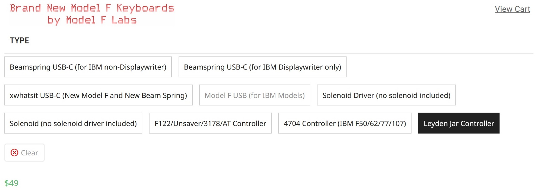

The only alternative which I know is "new model f keyboards". They sell the controlers at $49 + shipping (https://www.modelfkeyboards.com/product ... ontroller/)

12 Dec 2024, 12:06
Rotti wrote: 07 Dec 2024, 04:30 Looking to get my PC AT programmed. Using the universal with the Pro Micro. I am getting this from the QMK Toolbox. Any idea?
That output mostly looks fine to me. Are you talking about the mention of a "Microsoft USB Serial Device"? I do know that the bootloader on the Pro Micro is a bit screwy, in that it exposes itself as a virtualized serial port (and only remains in bootloader mode for like 10 seconds before it boots whatever application is in flash memory). It could be that whatever driver Windows decided to bind to the virtualized serial device just calls itself that. As long as it works (and it seemed to, from the output), I don't think it's a big deal. In any case, glad to hear you got it working.
If you (or anybody else) would like a Vial firmware for your F/AT keyboard that has a pandrew&Co. "universal" style (Pro Micro based) controller installed in it, I have built one. Just run the .bat file located in the flash-scripts folder, then kick your controller into bootloader mode. Hopefully this proves to be a more straightforward process for most people than wrestling with QMK Toolbox.
