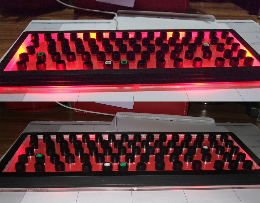

This is probably the last update from me until after the KeyCon. I want to get the keyboard to look and feel as much like the final product as i can - considering that I still don't have a real top membrane or programmed controller yet. To achieve this, i painted the case (3 white base coats and 3 black coats) and hot-wired the LEDs. FYI, it is really difficult to capture light effects with a point-and-shoot camera - if you use a flash, it washes out the effect, but without a flash the LED appear
much brighter than they really are. My camera does that "with-flash-without-flash-double-shot" thing, so here they are.
First, these shots taken in a brightly lit room.
- 0102.JPG (153.49 KiB) Viewed 12054 times
- 0304.JPG (101.41 KiB) Viewed 12054 times
And now some shots with the room lights off.
- 0506.JPG (148.11 KiB) Viewed 12054 times
- 0708.JPG (95.88 KiB) Viewed 12054 times
If you average the with/without flash, it would be much closer to the actual visual effect. Yes, there are LED hotspots, but they don't look yellow at all, or as blinding as they do in the "no-flash" shots.

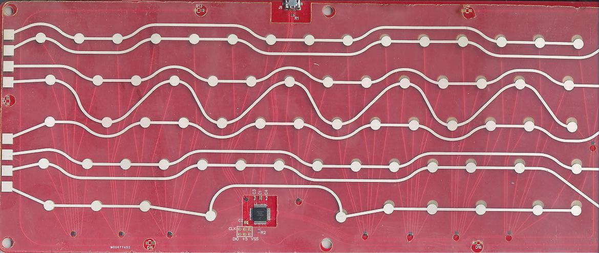

When I sent out RFQ for membranes, i asked for 10 copies of my design (attached PDF, DXF, and gerbers), "conductive silver ink on 3 or 4 mil PET substrate". I sent requests to about 20 printers in the US and about 4 in China. I got replies back from about half. The quotes from the US vendors were between $230 and >$1000. Some were helpful with little tips like "We know you specified the .003 but we have found that thin of material likes to crinkle and float around in our dryer. We can go to a .005 but prefer .007 thickness."
In the end, i went with the low bid of $80 (+30 for shipping) from China. There were several communication issues, but I believed that all that was resolved. The membranes came in on Thursday, but i have been too busy to get a good look at them until today. My first impression was ... WTF? On one side the traces are silver-white but on the other side they are black. There is noticeable scorching, a crease, and it feels too thick.
The first thing i did today was to get out the multimeter and check the resistance from start to end of the longest trace. I suspect that the black is carbon and would be very resistive. Well, it might be carbon, but the traces are not any more resistive than a 25 year old model M membrane, so the color of the trace is not a concern. Only one of the ten has a crease and that is in a corner not near any of the traces. The cuts and print line up perfectly with the PCB. The scorched edges are mostly cosmetic, but the thing i am most concerned with is that the substrate is 10 mil (and up to 15 mil near some of the laser cuts). I'll try these out an hope that 10 mil is not too thick.
- membrane.jpg (107.99 KiB) Viewed 11893 times
- membrane 001.jpg (78 KiB) Viewed 11893 times
- membrane 002.jpg (126.66 KiB) Viewed 11893 times
