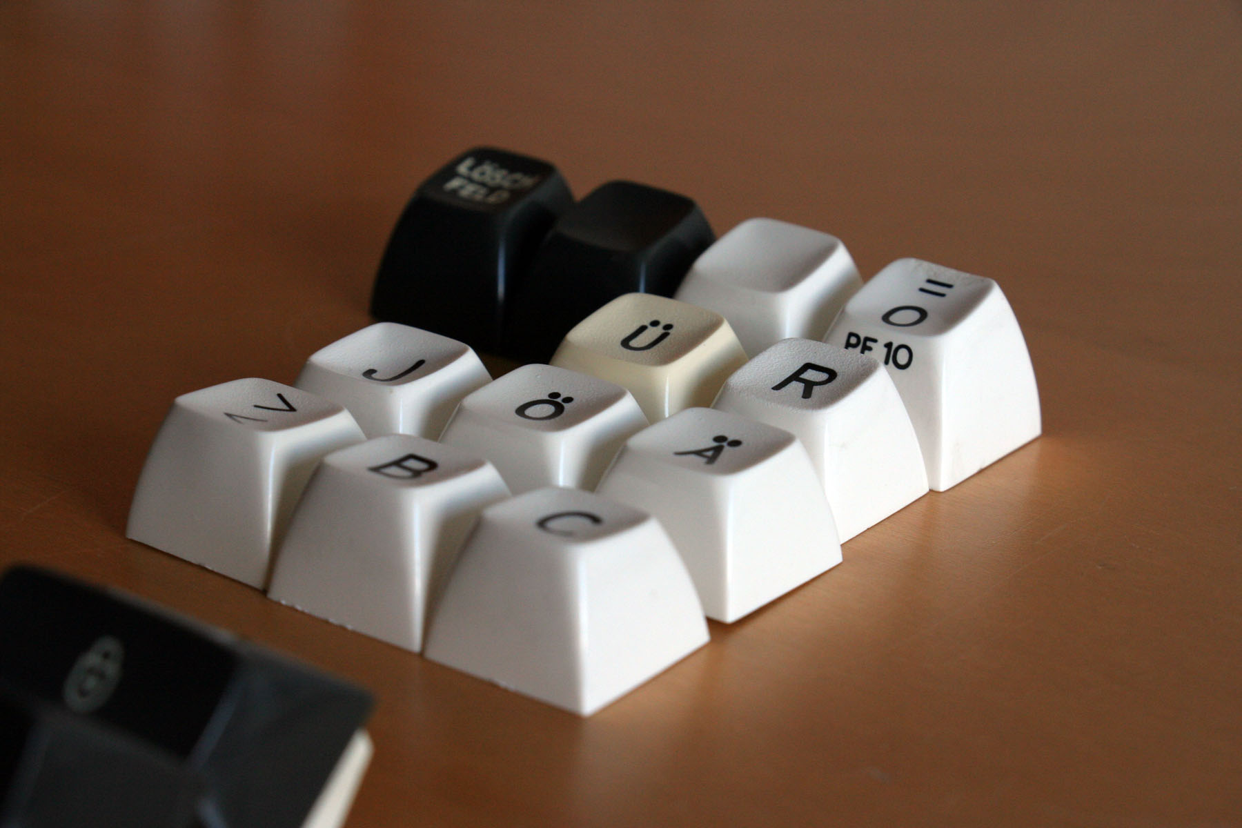

Okay, these are the caps I've selected to send to Matteo. I'll run them past him first, which is why I've upped pictures. Might as well let everyone take a look.
Authentic 3276 German beamspring caps on the left. Unknown origin (punch card machine?) beamspring compatible caps on the right.
I do like this colour scheme, too. The deep graphite but ever so slightly brown mods are very 70s. I've included all the 3276's mods. Including the vertical Return key. Might be useful for Numpad Enter, I guess. Although it is a very vintage convex shape!
The mods are from a few different rows and sizes. And the bottom row has those two big stepped mods. Both convex, as is the vital little Alt. Oh, and spacebar. (Which has one broken stab mount I need to fix.)
The alphas cover all four rows from the keyboard. Plus deep dish. And happy Ü has a tan.
And now for the other set. Studying it side by side with the 3276 caps, I'm not sure they're 100% the same. Matteo can take a close look with his keen designer's eye. I'm bundling a full array of both.
Also included is that tripleshot J key. It came from Cindy's spares, looks deep dished next to my other triple shot J. But it's not as deep as the F and J from my 3276. Looks like we have three different dish depths to choose from?
