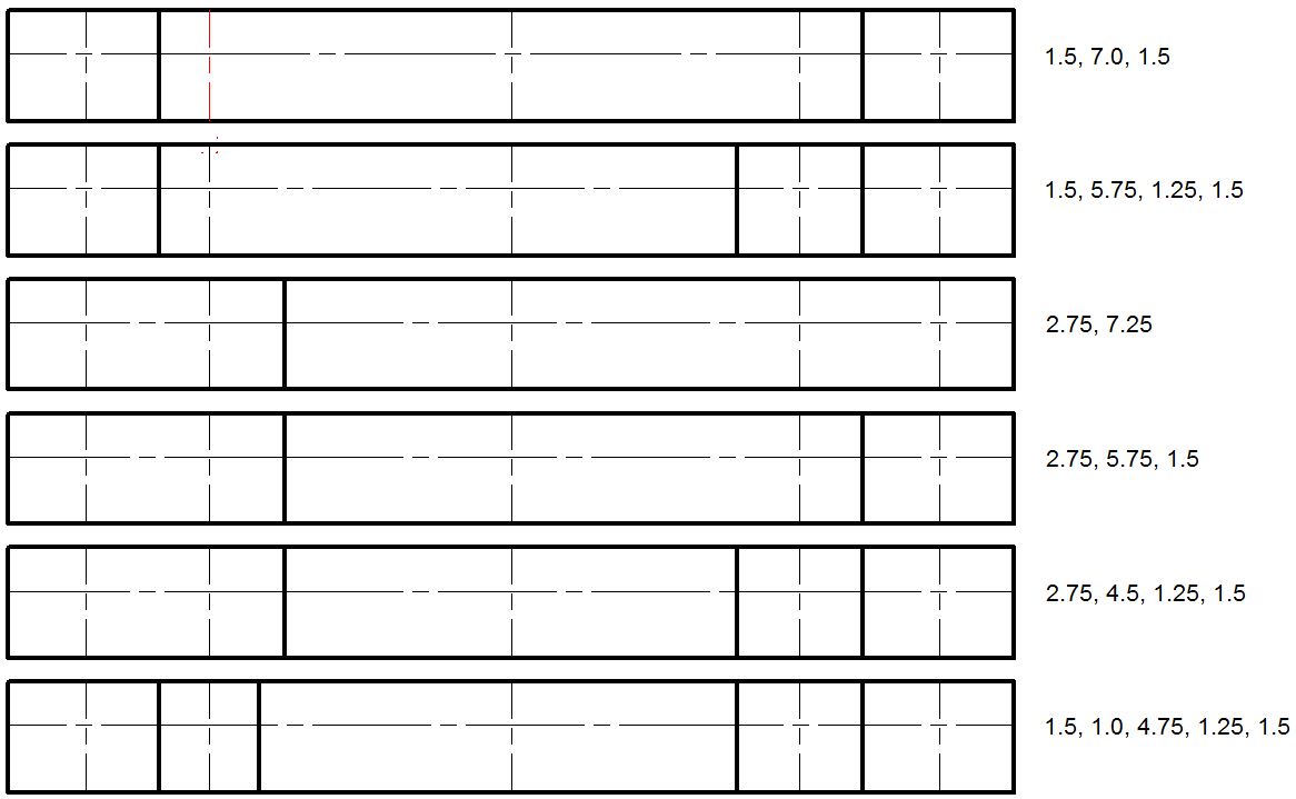

rsbseb wrote: My question centers around the bottom row. I have five keys modeled with a convex surface 1u, 1.5u, 2.75u (code), 7u, 7.25u
1u, 1.25u, and 1.5u are used on the bottom row, but these are usually concave.
7u and 5.75u are the only common convex caps. 2.75 and 7.25 are rare (take 3 keys and replace them with two!). The 2.75 probably has a future - 7.25, probably does not. You could make 5.75u, 4.75u, and 4.5u to work like the examples below ...

wcass wrote: 2.75 and 7.25 are rare (take 3 keys and replace them with two!)
The 2.75 / 7.25 layout is what's on my Wheelwriter. I don't think I've seen it anywhere else. It's not bad and I personally like bigger space bars but will probably downsize for the sake of symmetry. Thanks for the proposed configuration chart, that helps a lot.

So, for completeness, I wanted to link lot_lizards picture of the Model MF mockup with dual 2.75 spacebars. In terms of wcass's theoretical layouts, this is 1.5/2.75/2.75/1.5/1.5. Of course it also requires extra plate holes, so it would only be usable by Model MF owners. I hope this will be a growing market in the future, though, since lot_lizard plans to continue development on the MF concept.
rsbseb, before you dive into making ALL of the oddball sizes that wcass proposed, you might want to take some polls to figure out if anyone will want to use them. I do think a 5.75 space bar is important, because the 1.5/5.75/1.25/1.5 layout matches Unicomp's 104-key models, right? Owners of those keyboards (and maybe even Unicomp themselves) could potentially be a good source of cap buyers.

The wire stabilizers mount to tabs at the ends of the keys and will be integral to each one and not related to the stems. stem alignments on the code key will be optional for both configurations.
As for the special sizes I am open to conversation on the issue. I'm pretty sure the 2.5u and 6u keys will drop from the lineup before it's all said and done. Perhaps others as well if there is no interest.

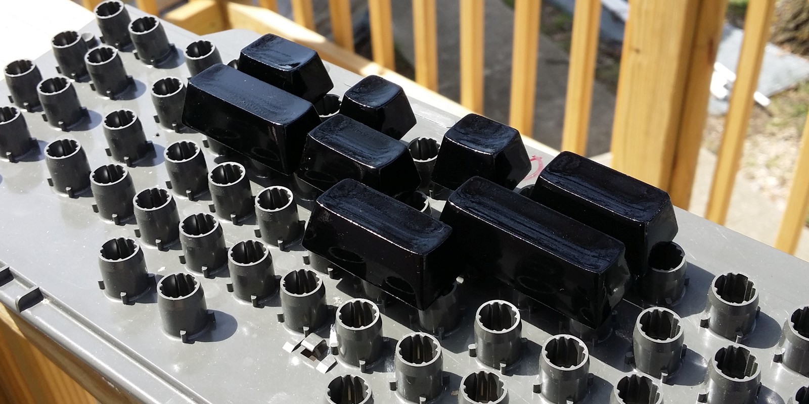

I like black caps as well. Here's a little teaser picture. Sorry for the poor quality image,I had to take them outside to get enough light and then I wound up with reflections of the clouds and trees to contend with. Black keys are difficult to photograph. I was going to hold off on posting any images until I could display a full set but that will be several weeks out at this point. Enjoy, SBS is happening :D
