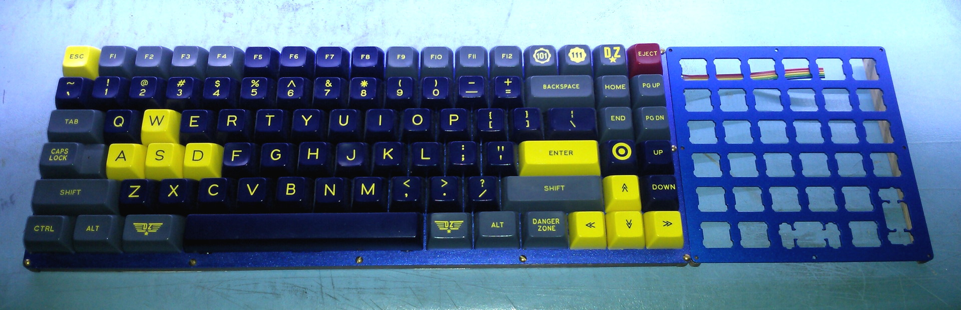

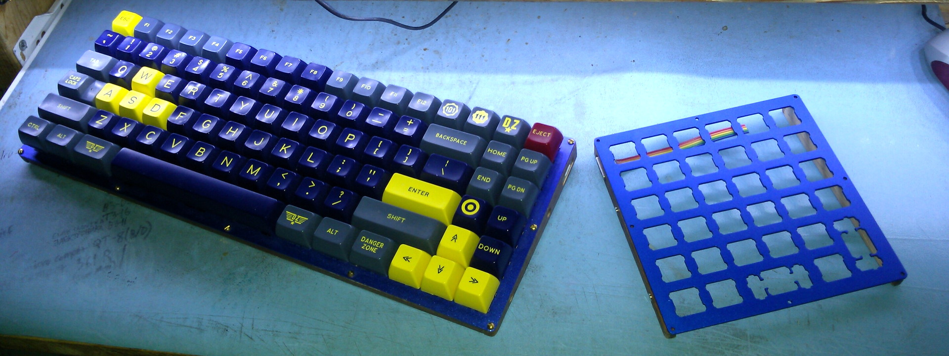

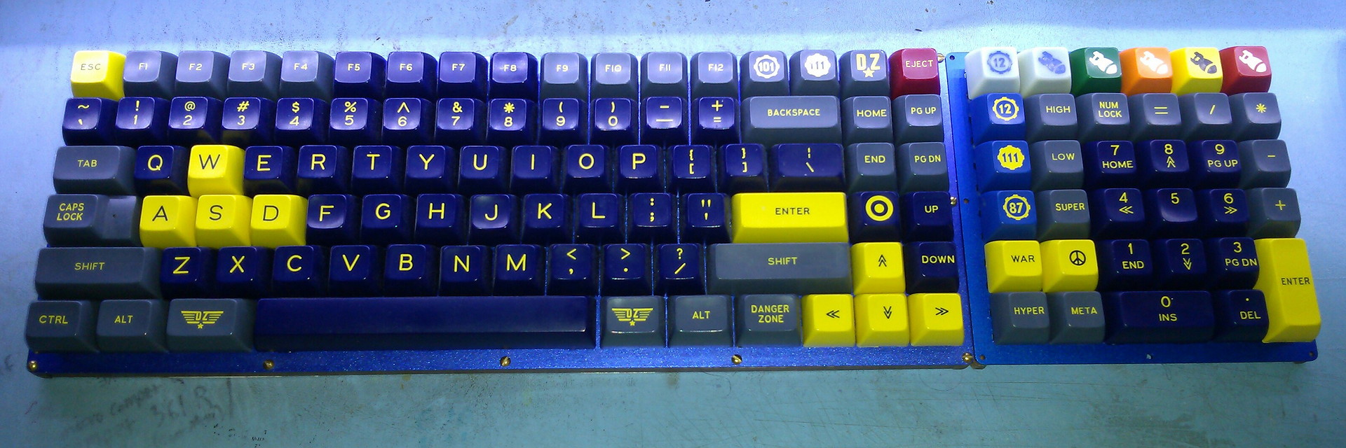

So, I gotta drop a big thanks to LeandreN for once again coming through and getting me the plate I needed to finish this project! Number pad plate came in today.
No idea when I'll get it finished, hopefully soon. I counted up my dyed switch tops... I have 30, needed 34. Grr... I gotta mix up a batch of dye for FOUR switch housings! I'm bummed I can't find transparent Plate Mount MX Stabilizers. Sorry, I don't care for Costar, and I don't have a PCB, so the Zeal transparent ones really aren't an option either. For now, I gotta settle with black ones...
Anyway, I have the trim parts already cut out (I did this WAY back when I did the original ones for the main keyboard.

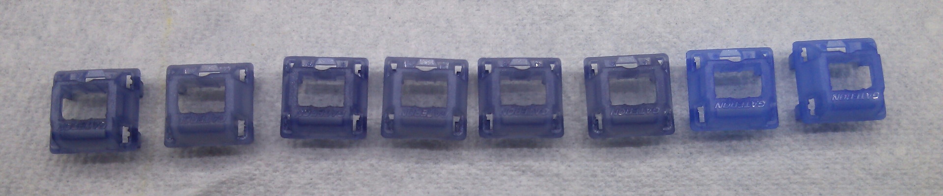

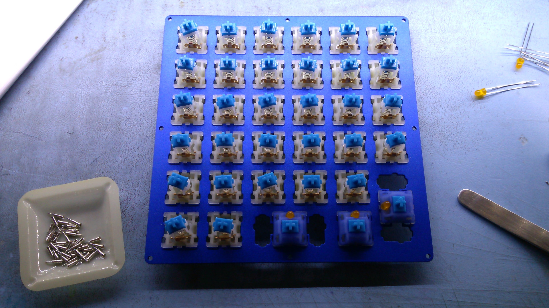

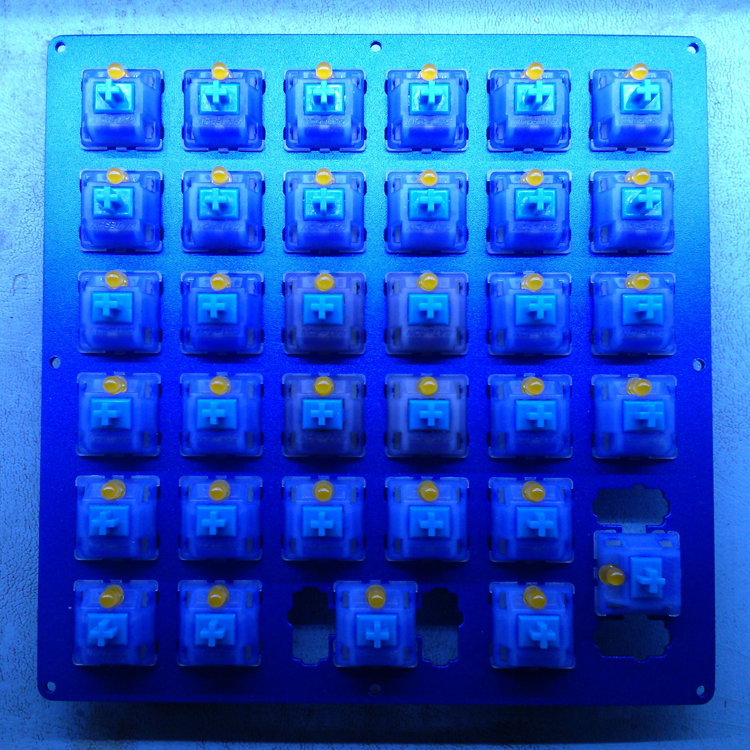

It seems my dye might have been a bit... old. It came out more purple than blue. I attribute the color shift to it being LITERALLY a year and 2 months old. Fortunately, I only need four more keys (though I dyed six). I think if key caps are off, it'll stand out, but with key caps on, and if I place them in the center, it probably won't really be noticeable, so I'll give them a pass.
Got the switches dyed, installed, lubed, with SIP sockets inside and LEDs plugged in... That's as far as I've gotten.
The four switches that I just dyed are in the middle. They do look slightly more purple than blue, but it's only slight. I'm more than okay with it.
And a pic of the assembly process... I think, if I could go back, I'd have put the numbers on the left, and the extra functions to the right. I just mimicked the typical layout of a full keyboard, but by doing so, I placed my number pad further away from the main keyboard than I needed to. Oh well. Can't change it, so it'll stay as it is. At least Enter will be easy to find by feel.

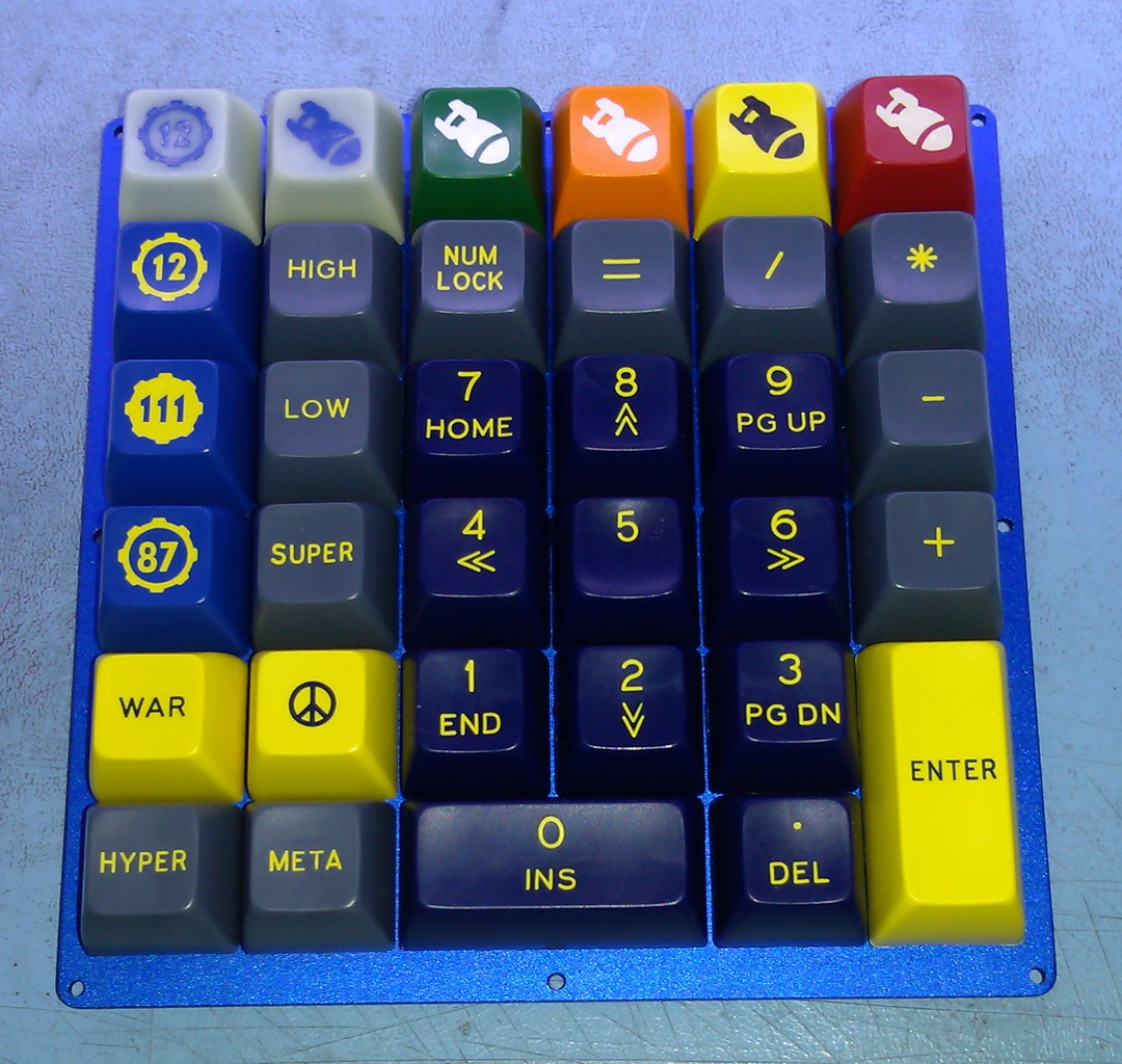

Just threw the number pad keys, and a bunch of various Fallout and mod keys, but yeah, I wanted to see how she looks!
She's a real beaut, isn't she! :mrgreen:
I can't WAIT to have this magnetic split functioning!

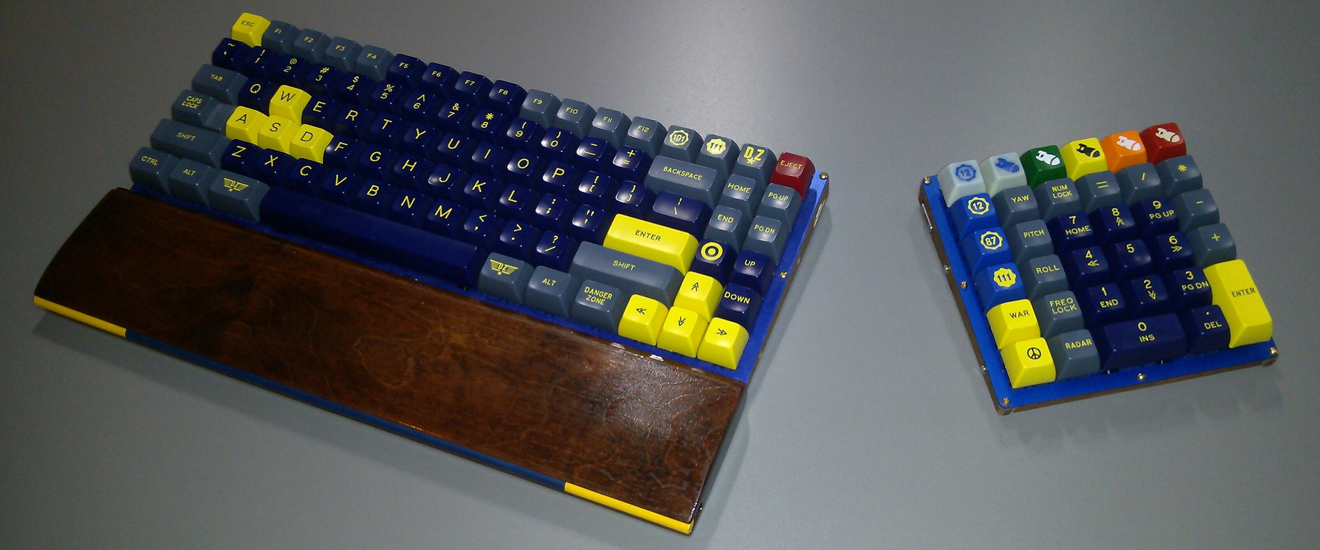

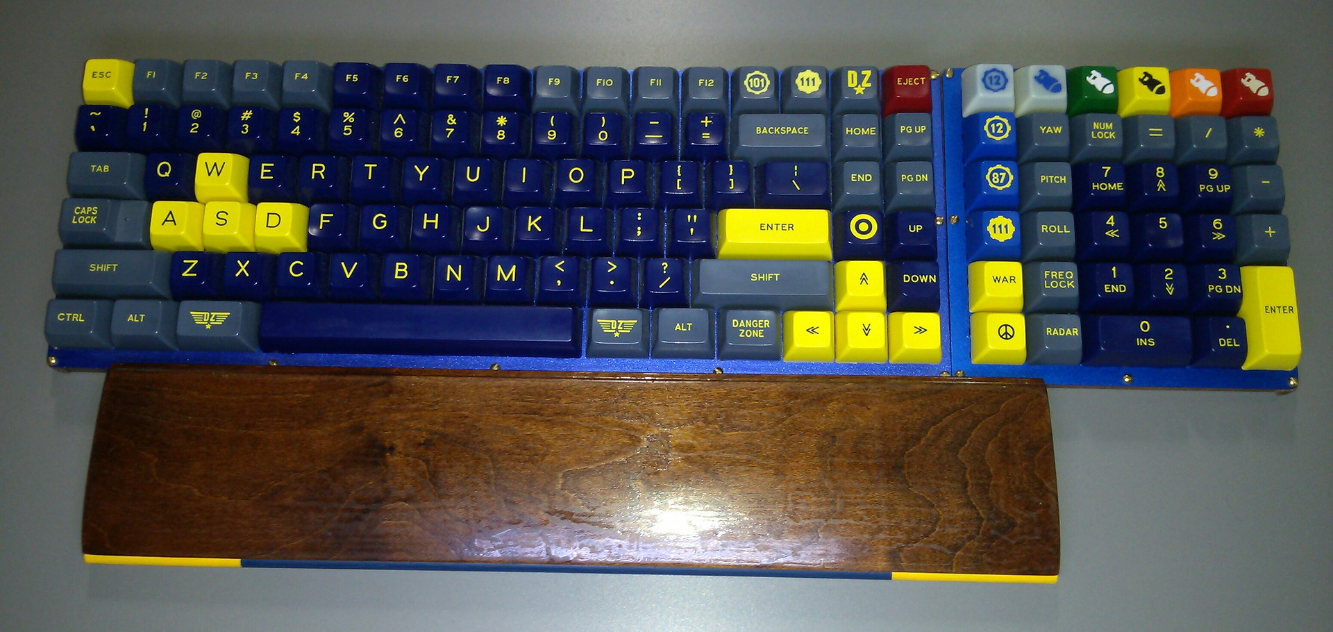

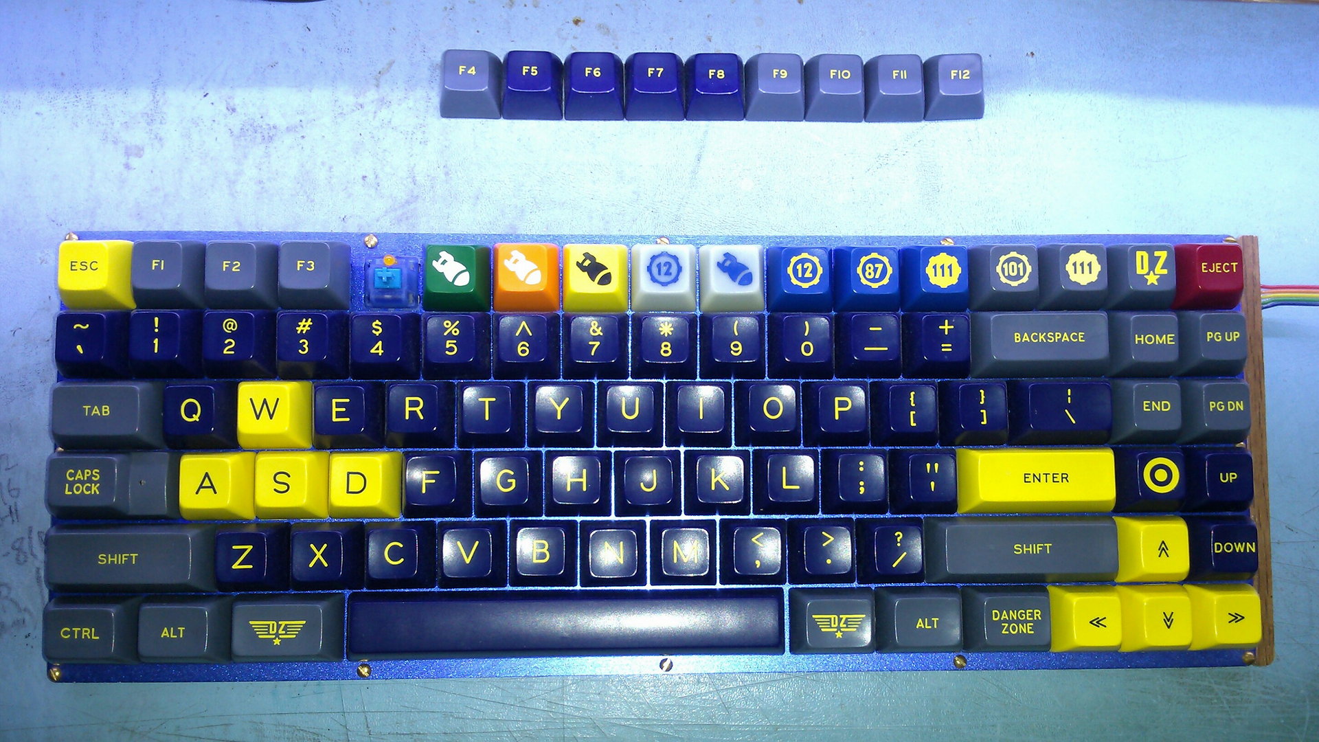

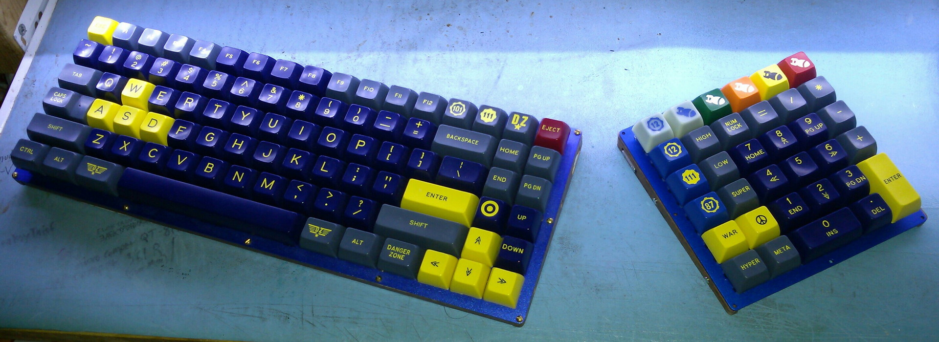

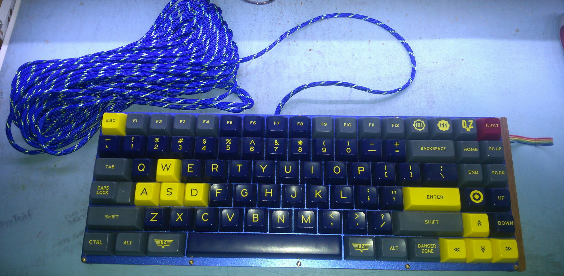

I worked on this over the Christmas holiday break. You can see the final trim and layout assembly. I might change up the misc keys from time to time, as I get other more interesting key caps. That's why I have a 6x6 number pad! Plenty of room for creative keys! :mrgreen:
The wrist rest is actually just wide enough to type comfortably, and still rest the left side of my right palm on it to reach the number pad, but I plan to make a wide wrist rest and a mini wrist rest in addition to the one I already have. I'll have a spot under my desk to stash the long one and the mini one, so i can bring out the one I want to use. I've also considered just attaching the wrist rests to the keyboard segments. Not really sure on that one yet. We'll see as I use the keyboard and get a feel for things.
I still have to finish some wiring in the number pad, and then do the programming. That's ALL! :D
I'll post more pics soon. ;)

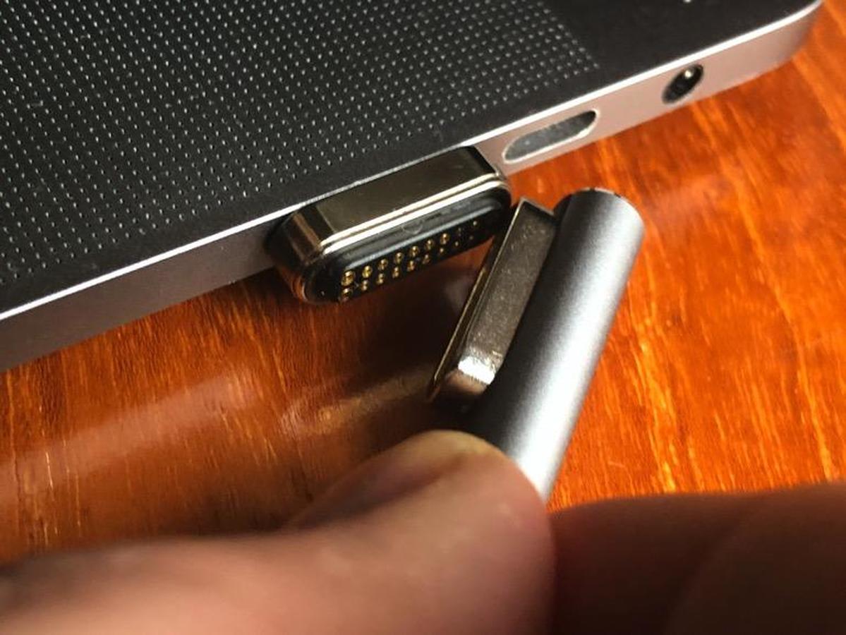

Power and I2C connections have been made at the tiny board that attaches to the MagSafe port.

If the chips can't operate in tandem, then I can just change the num pad DAC's I2C address, and send the same data twice, to each address.
One of the nice things about these DACs, is they have an integrated EEPROM that stores the last value,
so it remembers the last brightness setting, even after power off, or number pad detachment.
This means I only have to update LEDs on a brightness change, or after attachment or detachment of the num pad.
The fact that it's a steady analog value also eliminates PWM flicker entirely. The DACs are 12-bits, which is overkill,
but I had them on hand, and they will still work for the application.
After the last hardware is soldered in, it's ALL software from here. I have very little experience there, so advice and help are welcomed.

The absolute irony of my absolute failure to put in the time to figure out the unique coding situation to resolve the hot-swapability of this keyboard, and the ridiculous amount of time that has passed since procrastinating on finding a solution to the problem, has left me with an unexpected hardware development...

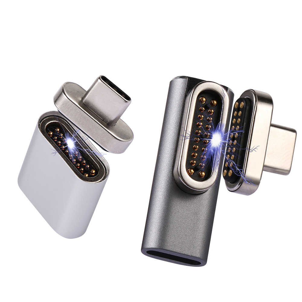

In the time that has passed, 20 pin "magsafe style" USB C connectors have been developed, and are now being mass produced. These feature a very dense 20 pin magnetic connector... Honestly... I could essentially "brute force" this entire keyboard, strictly in hardware, if I were to purchase one of these and wire it up to the matrix, LED driver, and power. I might still need the port expander, but it would interestingly enough, end up situated in the main keyboard, and not in the number pad. There would be no risk of hot-swap lockup of the firmware, because the I2C would always remain connected to the port expander. Only the matrix, which is normally open anyway, would ever be disconnected, and the power and LED driver lines are non significant. The power just is or is not connected to the numberpad, and the LED driver output is strictly a passive output. It has no feedback at all. This, while a less elegant a solution, does still suit my style of building well, in that I am, and always have been, a hardware type, not a software type. I may be forced to redo the trim featuring the magnets and magsafe style connector, if I'm unable to pop the old ones out. They were epoxied into place, and may never want to actually come out. I will most definitely be slightly irritated, if I have to redo those parts, as the oak I used was very annoying to work with. We'll see...
If I undo my recent alteration, and Switch the LED control back to PWM on Pin D12, and I eliminate I2C all together, I can reclaim pins D5 and D6, and if I eliminate D24 as a numberpad sense wire, that gives me three unused pins that I can assign as new rows R8, R9, and R10 in the matrix. If I feed Columns C1-C12, and the three new rows, R8-R10, that takes 12+3 pins (15), to do a 3x12 matrix, which would cover the entire 6x6 numberpad (I'd do 2x6 groups of keys as 1 row, and 12 columns, electrically). I'd need two pins for power, plus the LED PWM, adding three more used pins to the total count. That leaves 18 pins used, with 2 unused. If I make the + and - power the same pins as the standard + and - USB connections used on that connector, then even if a USB cable is inadvertently attached to the numberpad, it will actually do nothing (it would actually power the LED driver, but the PWM signal would be off). With no communication, the USB would not negotiate fast charging modes, and thus not increase power above standard USB voltages, so again, the numberpad should be safe. For simplicity, I think the numberpad should mate to a USB cable's mag connector, since it'll be almost entirely passive, and thus have the least risk involved. That, at least, mitigates any risk of damage due to error, for using any manner of standard connector. I do belive I did a similar thing with the old MagSafe connector I used previously, where the main keyboard had the cable connector, and the numberpad had the device connector. As for finding what pins are default USB power (5 volts) on the new style 20-pin magnetic USB-C connector... Well, I'll just have to measure. Finding ground is easy. I just check continuity to the shield. It's also almost certainly gonna be one of the big corner pins... Bigger pins are typically used for power delivery. After I find ground, I just measure the other pins to find 5 volts. Simple!
I think I'm gonna order a few of these from China... They'll probably take a good month to show up. I legit wanted to pick one up for my phone. I do not know yet if I even have room to mount these, nor do I know how much larger they are than the 5 pin connectors (they are definitely larger). I want to search tomorrow to see if I can find the connectors standalone, but I suspect I won't. I'll likely be forced to disassemble a USB-C adapter, extract the connector, and solder some 18 wires to 20 of the pins. Should be fun!
I really should just plan on making a new pair of trim pieces. Like I said, I'll have probably a month to wait for the parts to show up off the slow boat.
