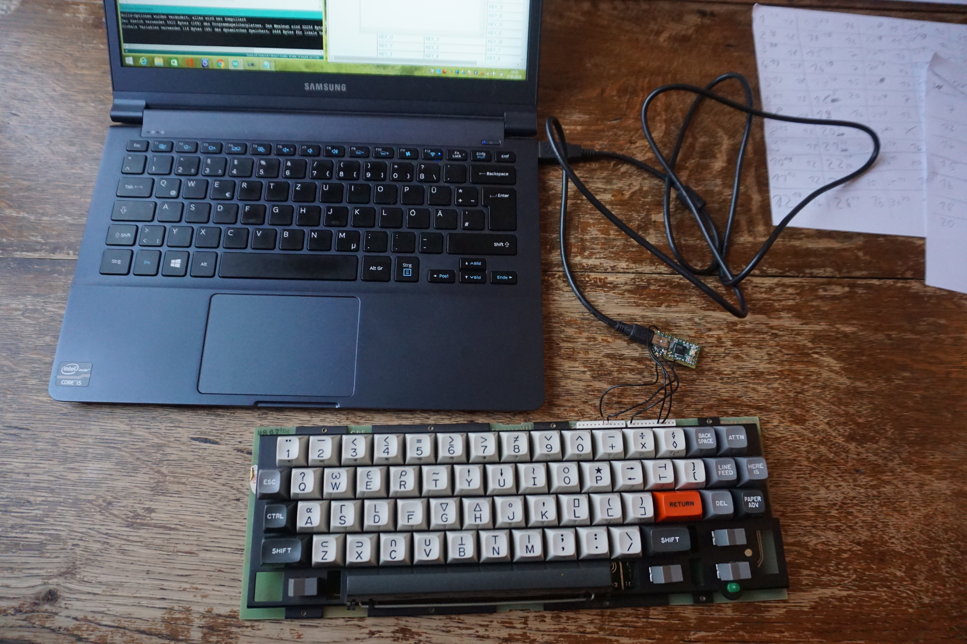

Ok, I have decided to go for the TI silent first. These have scan modules, with one input that can be pulled low and one output that will switch to low if the key is pressed AND the input is low. I completed a proof of concept today, connected two drive columns and one sense row. When you look at the keyboard from above, the pins in the connector are counted from the right:
 Board  | Teensy | Comment
  4     | VCC    |
  5     | GND    |
 12     | B1     | drive input for '1'
 17     | D0     | sense output for '1' and '9'
 18     | B0     | drive input for '9'
My first solder job ... can only get better from here :oops:
And here's the arduino code. Note that inputs for the keyboard are outputs for the teensy and vice versa. Also note that the input has to have a input mode INPUT_PULLUP (see setup function).
int outputPins[] = { PIN_B0, PIN_B1 };
const int outputPinCount = sizeof(outputPins) / sizeof(outputPins[0]);
int inputPins[] = { PIN_D0 };
const int inputPinCount = sizeof(inputPins) / sizeof(inputPins[0]);
const int keyCount = inputPinCount * outputPinCount;
bool keyState[keyCount];
unsigned int keys[keyCount] = { KEY_9, KEY_1 };
void setup()
  for (int outputIndex = 0; outputIndex < outputPinCount; outputIndex++)
    pinMode(outputPins[outputIndex], OUTPUT);
    digitalWrite(outputPins[outputIndex], HIGH);
  for (int inputIndex = 0; inputIndex < inputPinCount; inputIndex++)
    pinMode(inputPins[inputIndex], INPUT_PULLUP);
  for (int keyIndex = 0; keyIndex < keyCount; keyIndex++)
    keyState[keyIndex] = false;
void loop() {
    digitalWrite(outputPins[outputIndex], LOW);
    delayMicroseconds(15);
      int keyIndex = (outputIndex * inputPinCount) + inputIndex;
      bool newState = !digitalRead(inputPins[inputIndex]);
      if (newState != keyState[keyIndex])
        if (newState)
          Keyboard.press(keys[keyIndex]);
        else
          Keyboard.release(keys[keyIndex]);
        keyState[keyIndex] = newState;
Posted: 23 Jan 2018, 16:25
by OldIsNew
Slom wrote: I completed a proof of concept today, connected two drive columns and one sense row...
Nice work! Great to see progress like this - hope you have time to continue with it!
Posted: 23 Jan 2018, 17:18
by Slom
I completed the conversion yesterday (safe for the mechanical toggle switches and the LED):
post398120.html#p398120
I will do a proper write-up once I find some time. First I have to decide where to put the source code. Another open point is checking whether the second TI Silent I have shares the same matrix and pin-out.
I should also mention that your work was a great inspiration. Thank you so much!

Wow thanks for posting this! I was reading your post and saw this:
If you can indeed use one of the center pins to turn the output off like that, then you could get NRKO without a PCB swap, which is HUGE! I actually have one or two of that exact keyboard, and one other TI Silent 700 that is completely different despite the fact that they are both from 1979. It only has a 1 layer PCB and I already drilled it for re-wiring, but that's an easy fix.

Posted: 29 Jan 2018, 18:43
by Slom
I'm going to hook my test switch up (which I'm currently turning on and off at 2MHz to see what happens) and see if I can validate that.
This only applies to the "scan module" type of SD switches. These with a 'S' as last character in the part number.
The pins are: +5V, OUT (sense), IN (strobe), GND
On the TI silent you can see which pins are IN and GND by looking at the shift and control keys. For those keys GND and IN are connected on the pcb, which means that the switches are always active.
dorkvader wrote: In the meantime I wrote up some hall effect sensing and wiring ideas, which is completely outdated by the above claim.
workshop-f7/hall-effect-keyboard-sensin ... ml#p398665
As I said above, my conversion only works for those "scan module" types of switches. All the hold low/pulse low switches still need some other method, and for those your write up is still very much valid. So I would strongly contest this "completely outdated" :).
dorkvader wrote: edit: I have some foreign keycaps for my TI Silent 700 board (no idea what they were doing on a KB in the USA). I would happily mail them to you wherever you're located in exchange for helping us get our KB working like yours I have Å Ä Ö which I saw on your modern keyboard on your laptop.
No, that is not necessary :) Keep the key set together. I will send you a PM about the software, but give me a few days please.
Posted: 25 Feb 2018, 21:46
by dorkvader
Hey guys, I have been able to confirm slom's results with my copy of the board he used (from a silent 700). If Pin1 is VCC, pin 2 is output pin3 is what I'll call output control and pin4 is ground. When connected to power, output control pin shows about the same as vcc and pressing the switch, nothing happens. power draw does not change and no output is detected, When the output control pin (which is about the same as vcc when floating) is connected to ground, the switch acts normally, and power draw goes up by a little when it's pressed, and you get close to VCC on the output.
I did not have time to get decent scope shots or experiment photos since this was just a quick test. I'm also unsure if all switches or keyboards with the "s" designation operate in this way. However you should be able to identify keyboards that do by the following features
1. If 2 pins are connected together, they are the lower one (output control) and ground. This results in a switch which is always active. Look for modifiers, like "shift" which are wired this way in this keyboard
2. If you have a DMM, put 5V to pin 1 and 4, then measure 0V on pin 2 and ~5V on pin 3. Note that the switches have maximum ratings up to about 30V, so if you "only" have a 12V wall wart (or a 9V battery), then you can try with it. Pressing the switch nothing will happen at pin 2, and if you bridge pin 3 and 4 (output control to ground) you will now get ~5v at pin 2 when pressed.
*note* Right now I think that keyboards which have the inner 2 pins tied together will *not* support this technique. Also my 1977 keyboard with tripleshots ( https://www.flickr.com/photos/dork_vade ... 9601264430) definitely does not either, because I have fully reverse engineered that keyboard
What is next? now that we have a keyboard confirmed to work with an output control pin, we can characterize it further. I will feed a square wave into the output control pin and see how "fast" it turns the output on/off I strongly suspect it's faster than powering/depowering the switch entirely and using this we can achieve a 100KHz scanrate (or better?) Using the power pin to control output on/off we can only reliably use a scanrate of perhaps 40 kHz or so. Also looking at the shape of the waveform as we turn the output on/off with the output control pin will be good.
But now that the underlying mechanic has been tested and verified by two people, we can start converting these keyboards to USB very easily using normal sense/scan techniques. Debouncing is likely not needed but that remains to be seen. And then "because we can" we can crank the scanrate up to 100KHz and have proper "gaming" switches from the 1970's.
I'll work on my homework today and if I get a chance, I'll solder up a quick test fixture on a switch with a pull-up resistor and post some preliminary results. Note that due to the much higher input impedance of my DMM (over 10 MΩ) a pull up resistor was not necessary to test the switch, but it is required for a 50 Ω impedance of my scope. This is why I have no scope shots for now. Discerning the switch you can "see" it rise up, but not enough for proper characterization. Then I'll write up a post and put it on GH and DT but I get better feedback here, so I might make the switch to being primarily on DT's workshop forum than GH's MST.
That's all for now. Very exciting news and many thanks to slom for reporting on this.
