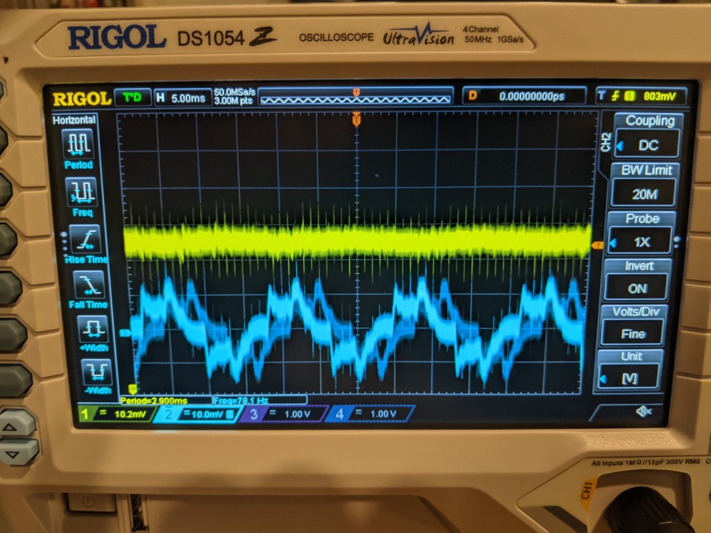

Posted: 06 Dec 2020, 08:08
by hupshall
ok, I hooked up my scope. CH1 is on Row 1, CH2 is on Column 1
Here is a steady state capture:
PXL_20201206_070405355 (Medium).jpg (218.66 KiB) Viewed 3599 times
Here is with my finger pressing down on the pad which would be F1:
PXL_20201206_070413156 (Medium).jpg (222.34 KiB) Viewed 3599 times
So the PCB is at least responding..
