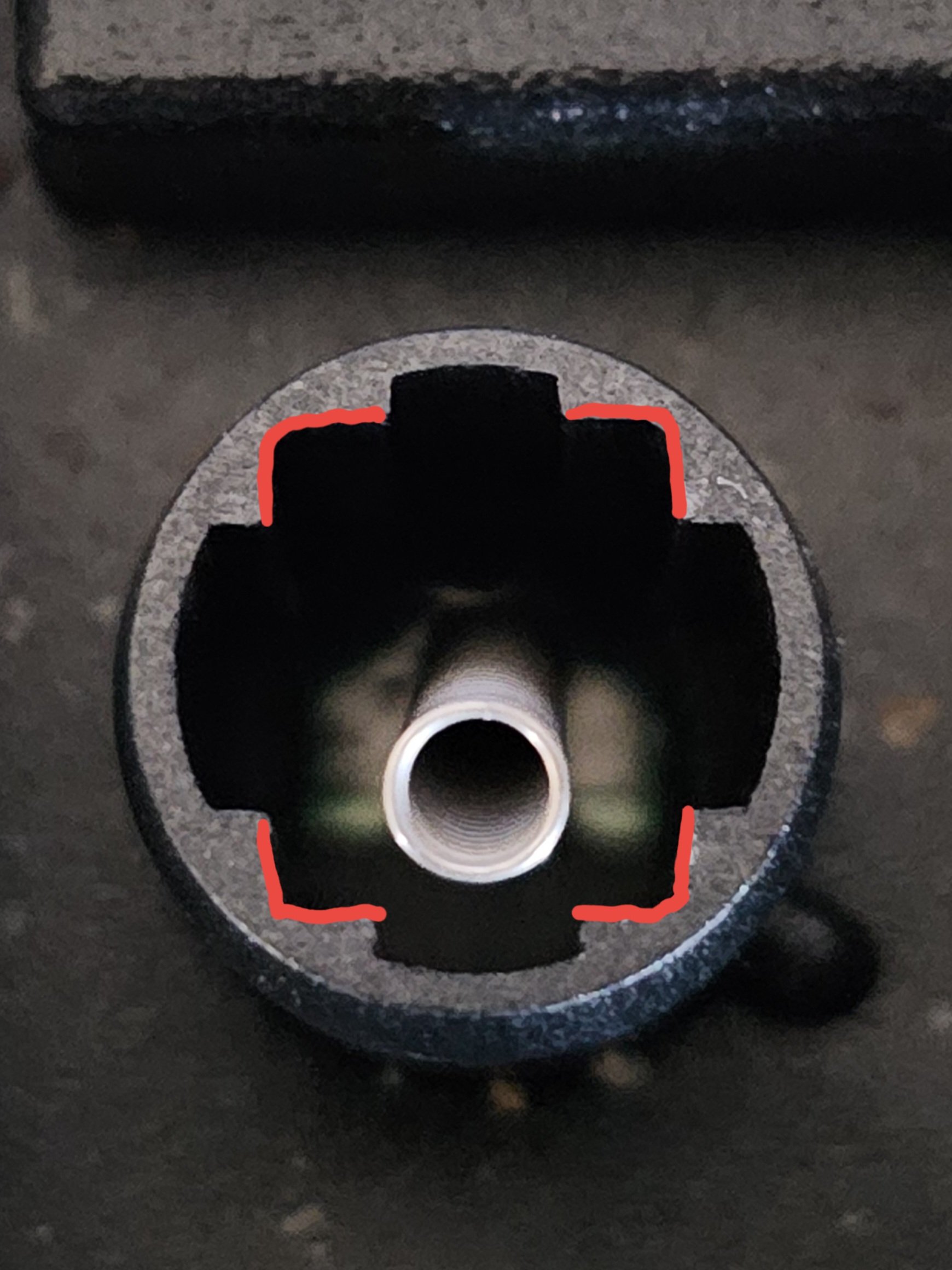

Oelmuvun wrote: 11 Feb 2025, 00:02
After sitting here for three hours rapidly tapping switches taped to my desk I think I would like to hold off on the de-burring operation.
So to re-cap(ha, puns):
L-Ctrl and L-Alt were the first to start fetching up originally. In early January L-Ctrl got silicone and L-Alt got lithium. Once month later L-Ctrl was still great but L-Alt was starting to bind up again.
As a test just within the past 24h I got out a new barrel and cap, de-burred the barrel, and it seemed really great initially.... It is now starting to get scratchy if pressed off-centre.
Since cleaning L-Ctrl and L-Alt(both have burr) with 99% isopropyl alcohol they are both operating equally smoothly, and at least so far, they seem even better than the fresh de-burred switch when it was still fresh.
I tried de-burring R-Alt and went a little harder on it than the fresh barrel. It was not all that much better initially, but has come around to a second-place completely reasonable state with a tiny bit of silicone grease.
The A key is also de-burred but a bit lighter than R-Alt. However I only have so many fingers here and haven't played with it for very long.
R-Ctrl is my control, it has never been lubed or de-burred and will remain that way for the time being. It is not a very nice switch to use, though did improve slightly once cleaned. It's still the worst of the lot currently.
I am wondering if I might need to eat my words about keys breaking in. I am wondering if the lubricant allows for easier wear-in by holding the particles in suspension so they can do their abrasive thing but still allowing easy gentle movement.
I
really want to just skim the whole board with silicone grease and see what happens.
Some other thoughts...
The burr, if properly broken in, perhaps is less surface area and less friction? But will the lack of support/bearing surface(skinny burr VS. wide flat barrel) ultimately cause more wear when the lube is removed in the future?
I'm pretty sure my surface finish is not as smooth as the natural as-cast finish, unfortunately I am not really equipped to deal with that at the moment. But I don't know enough about plastic to know if it should actually be glassy smooth or have some texture to reduce friction. I guess it depends on the viscosity of the lubricant you are trying to hold, if any at all.
Someone smarter than me knows this answer for the plastics involved in this. But for the time being when I get back at this again I am going to see what happens with the whole thing getting silicone grease. Those two initially lubed keys are
really nice during bench testing. So smooth, and crisp, just how a Model F should be. They are practically seamless when pushed from basically any angle.
I'm glad that the binding issues are getting some more thorough analysis. I hadn't even considered the possibility of a burr set deeper inside the barrel and I appreciate the trouble you went through to testing out a potential fix for it. Sucks that it didn't seem to hold, though I definitely think eliminating that burr is going to be part of a lasting solution.
I posted a few months ago about using a flathead screwdriver to burnish the inner edges of the barrels (I don't think anybody referenced it in the recent discussion):
At least for me, this still had the biggest impact in mostly resolving my key binding issues. It didn't work for resonator unfortunately, and a few of my keys relapse on occasion, but I just give the corners another pass and it feels good again. The bulk of the previously afflicted keys have still felt fine to me since I made those comments back in November and it hasn't been bothersome to type on.
I do have an F AT with me now and it's definitely still a bit smoother than my F104 overall, so maybe our ideas in conjunction might help point things in the right direction.

mbarszcz wrote: 15 Feb 2025, 21:17
YALE70, I gave your flat head screwdriver a try on my "E" key which is one of my worst, but it didn't seem to make any real change for me. I do see the light colored wear "dust" in the same place as you though.
Crud. Feeling like a bit of a special case here.
Just in case, and because my original pictures are probably somewhat unclear, I marked the suspect edges in red. I just ran the screwdriver blade up and down along each of those edges at a 70-80 degree angle - that way you're not drawing the jagged edge into the barrel. Not sure about the rough number of passes, but I just do each corner equally.
Again, there's certainly more to it based on the more recent evidence from other folks, so ymmv.
- 20250215_161807.jpg (635.09 KiB) Viewed 19041 times

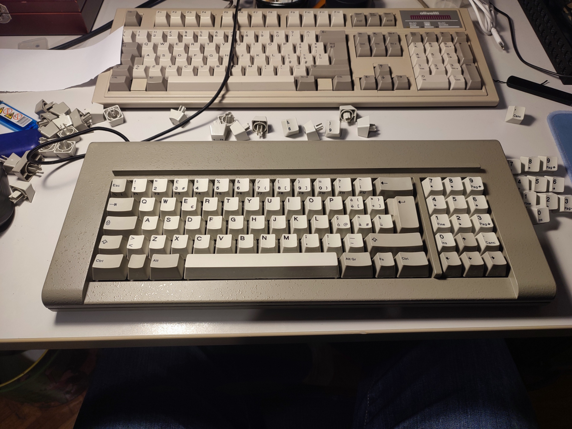

So I have two F77 that I've had for a while. One almost three years and the other one almost 2 years.
One came in very good condition while the other one came quite brutally beaten up by the shipping. The keyboard itself was quite intact, but a big bunch of the keycaps and springs were crushed but Joe was kind and sent replacements for these.
Now that I've used the beaten up keyboard a while, it doesn't "feel" as good as the first one.
I guess all the springs and caps were slightly off. It's been almost 2 years now so I just have to accept it I guess. The keys on the second keyboard are just more "scratchy" and not as smooth as on the first one. The left shift for example I have to press in the center for it to actuate. If I press it in the corner, it doesn't want to go down.
I've noticed that the color now gets loose (discoloring) on both of them. It's on the place where my hand is resting.
Keyboard #1
Keyboard #2
Not living in the warmest or most humid of places (Sweden).
Anyone has suggestions of what can be done? Don't feel like doing a total repaint of them. Maybe someone has some good ideas as I cant' be the only one with this problem?

by Ellipse
Yes, as I mentioned over email, it is expected that the uncoated original style paint will wear where it is rubbed during contact. To keep the project's goal as a reproduction of the IBM originals, the paint has no glossy automotive style protective finish.
Several years ago I changed the paint formulation for a less historically styled, tougher modern powdercoating which currently has an excellent track record of little to no wear (this formulation was first used on the die cast compact case F62/F77 cases, while the very first production run from 2019 used anodized cases for the compact cases). The original F62/F77 project's remaining keyboards were not discarded and will probably sell out over the coming months.
We discussed your issue with some keys having chipped stems at the bottom and those keys being the ones that required more careful on-center pressing - I don't think you caught all of them from the originally damaged batch but I noted that I am happy to replace the broken keys with the order you were placing. Broken keys should not be used.
Why not switch all the keys from one keyboard to the other to see if what you call the scratchy keys are due to the keycaps or due to the barrels? I suggest using them for a month or so before evaluating.
Re: F104+SSK+122+62+77+50+Ergo orders now open! New Kishsaver+Industrial Model F Keyboards
Posted: 08 Apr 2025, 08:24
by Takashi
Ellipse wrote: 08 Apr 2025, 04:46
Thanks for the info! I'll make sure to order the spare keys!
Is there a way to know whether which paint formulation my keyboards are using?
I made an earlier post about it, it seems the texture of my paint coatings is vastly different between the two keyboards:
The upper is my "old" keyboard (serial number 6xx) and the lower one is the new (serial number 9xx).
Switching the keys is a good idea. Only problem is that the keyboards are 800km apart from each other (using them in two different locations).
Posted: 09 Apr 2025, 02:48
by Ellipse
All the zinc case boards use the same uncoated old style powdercoating. The textures vary with each keyboard but they are the same paint formulations; just the bumps are different.

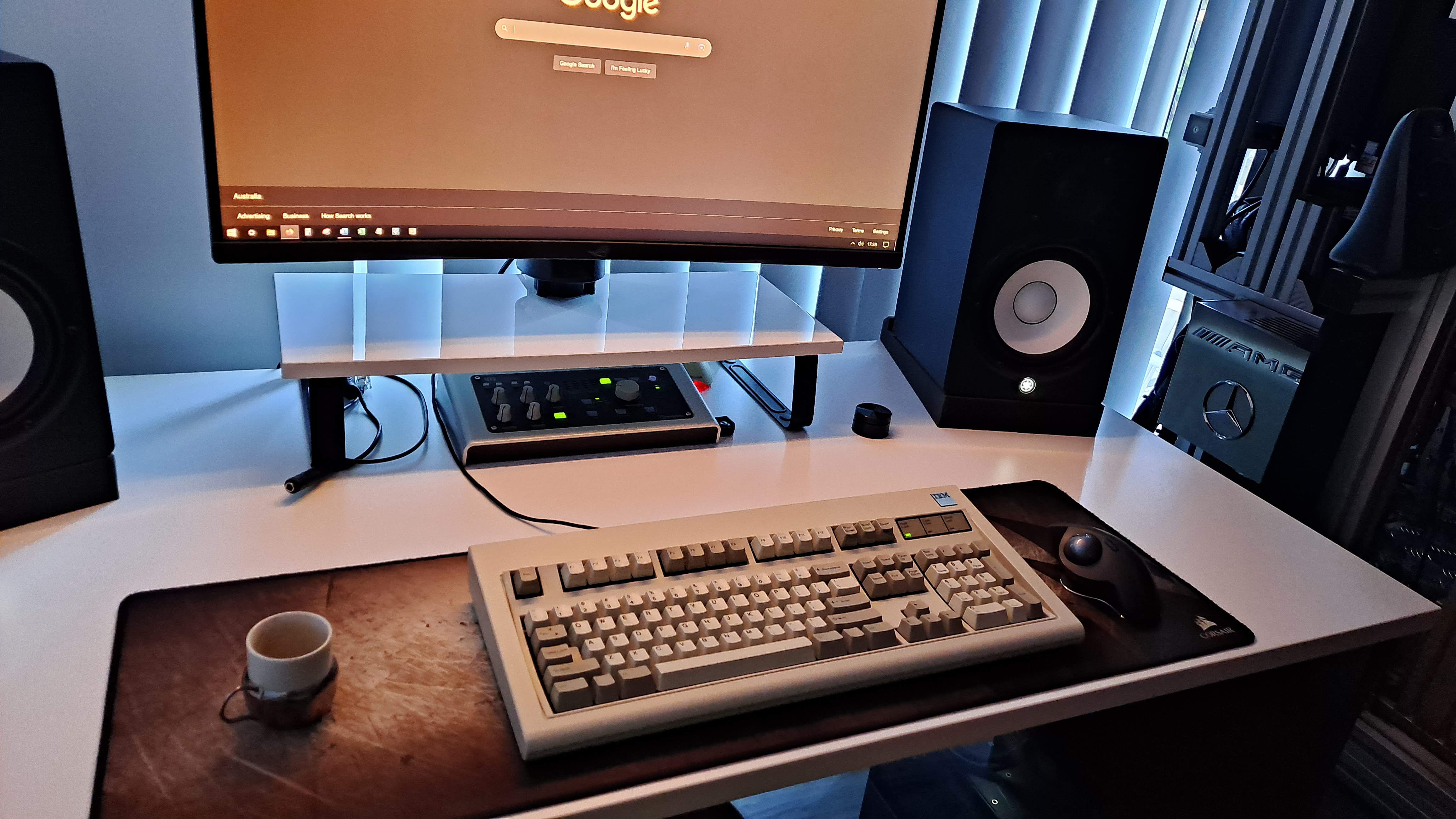

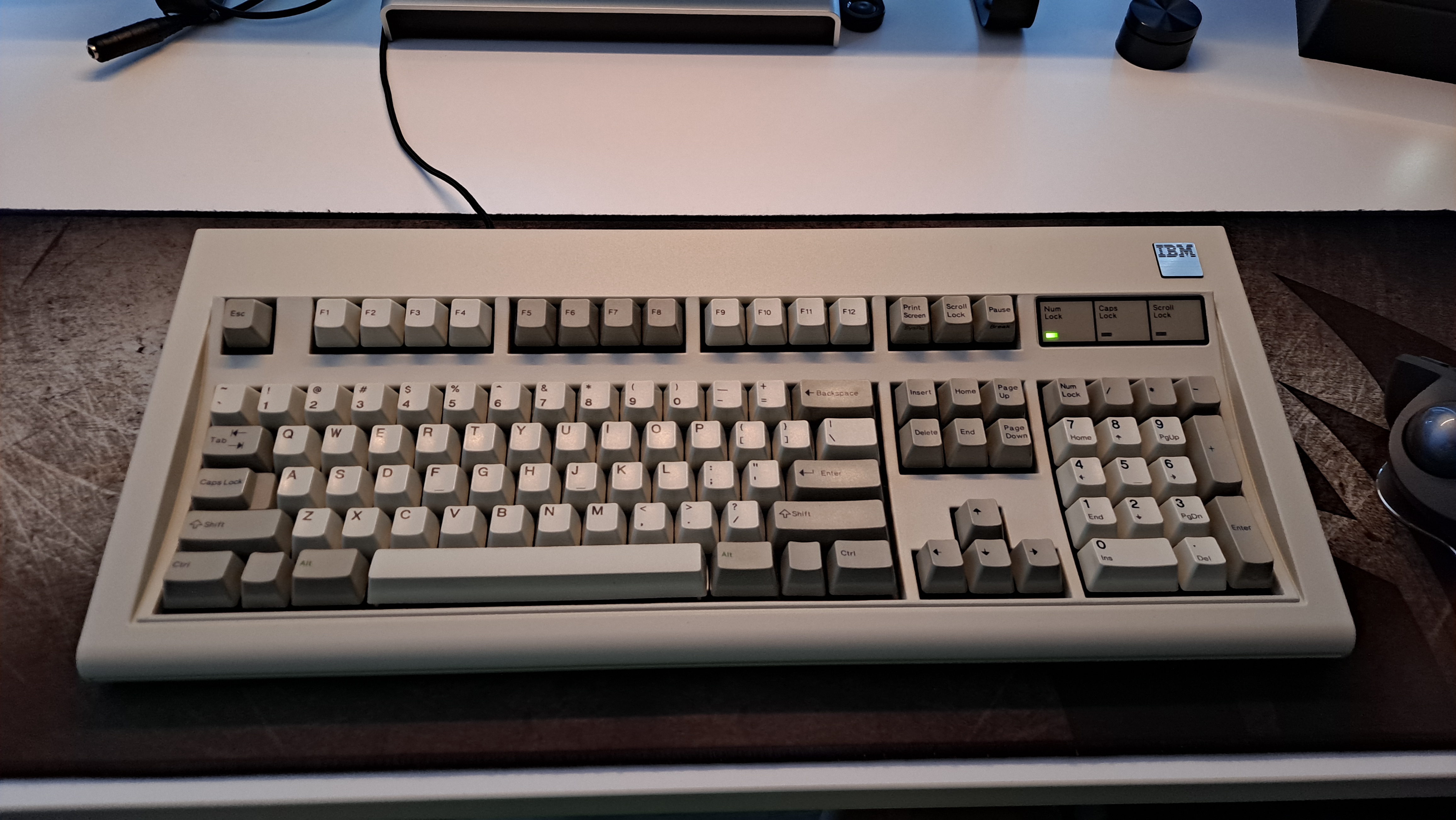

With permission I am posting a great review and photos of the classic style F104 keyboard from last month:
"First of all, I cannot thank you enough for the time and effort you’ve put into designing and developing the Classic Style Model F keyboards. It’s truly a blessing for IBM and keyboard enthusiasts alike.
Here’s my experience with the Classic Style F104 Model F Keyboard after using it for a few months:
I’ve been a long-time IBM Model M enthusiast, user, and screw-and-bolt modder, so I have a deep appreciation for these keyboards. When I first tried the Classic Style F104 Model F Keyboard, it was an entirely new experience, unlike anything I had encountered before. The keystroke, touch, feel, and overall typing experience completely blew me away. This keyboard is on another level, and I never realized just how incredible the Model F typing feel truly is. The metal case is the icing on the cake, it’s like a dream come true. Once again, I can’t thank you enough for making this possible.
I also decided to keep my original Model M keycaps, as I prefer the smoother feel over the newer, rougher texture. The solenoid was successfully installed, but despite the detailed instructions, I couldn’t find an option to control the power/intensity. Ideally, I’d like a slightly softer solenoid actuation. If there’s a way to adjust this, I’d love some guidance.
Your hard work is truly appreciated. I am very pleased with the product.
P.S. I also bought a third-party silver label, I think it’s a nice touch!
Best regards"
(My reply to the solenoid question: The power can be controlled by adjusting the 2 screws on the solenoid, which adjust amount of extension of the bracket. The wider it is, the more force you get!)
- nice f104 (2).jpg (3.54 MiB) Viewed 10076 times
- nice f104 (1).jpg (3.3 MiB) Viewed 10076 times
