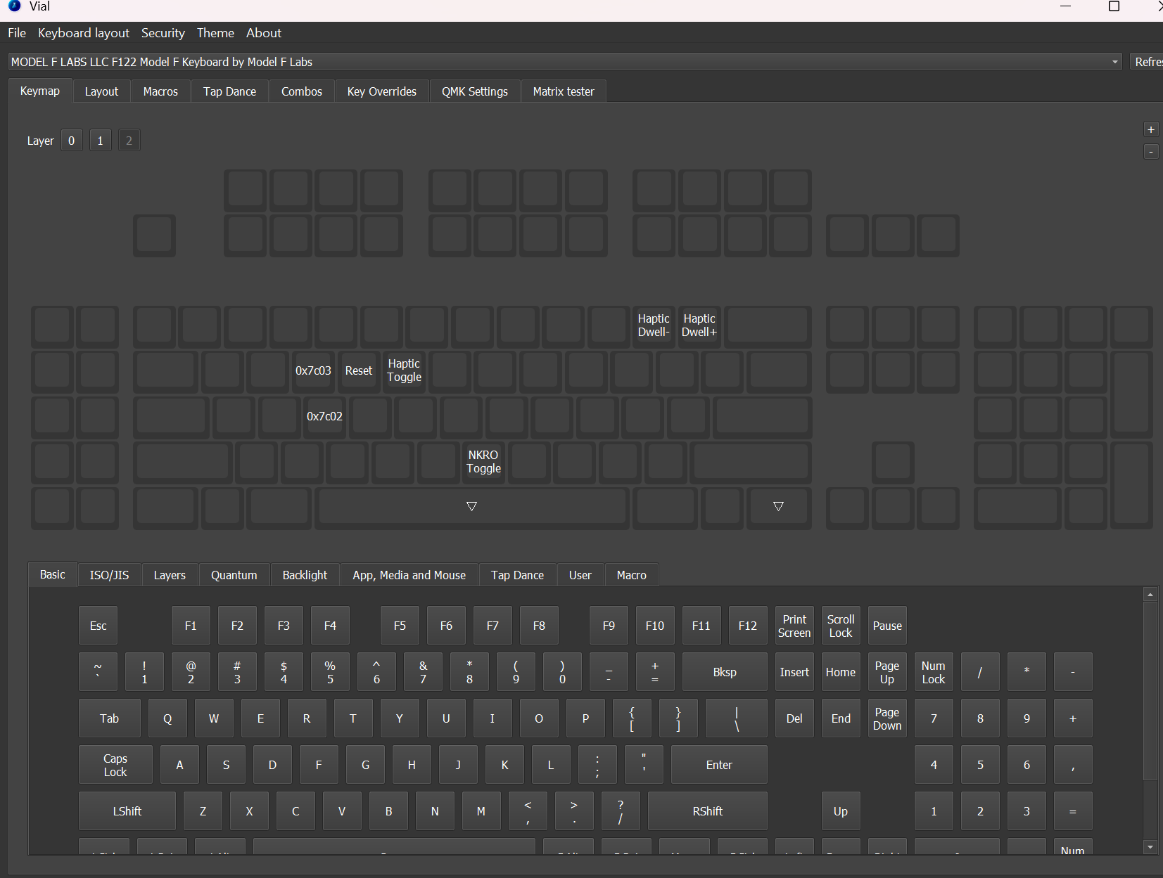

I installed the Solenoid, taking extreme care to make sure that the red wire is on the square pad of both the LeydenJar controller and the xwhatsit solenoid driver.

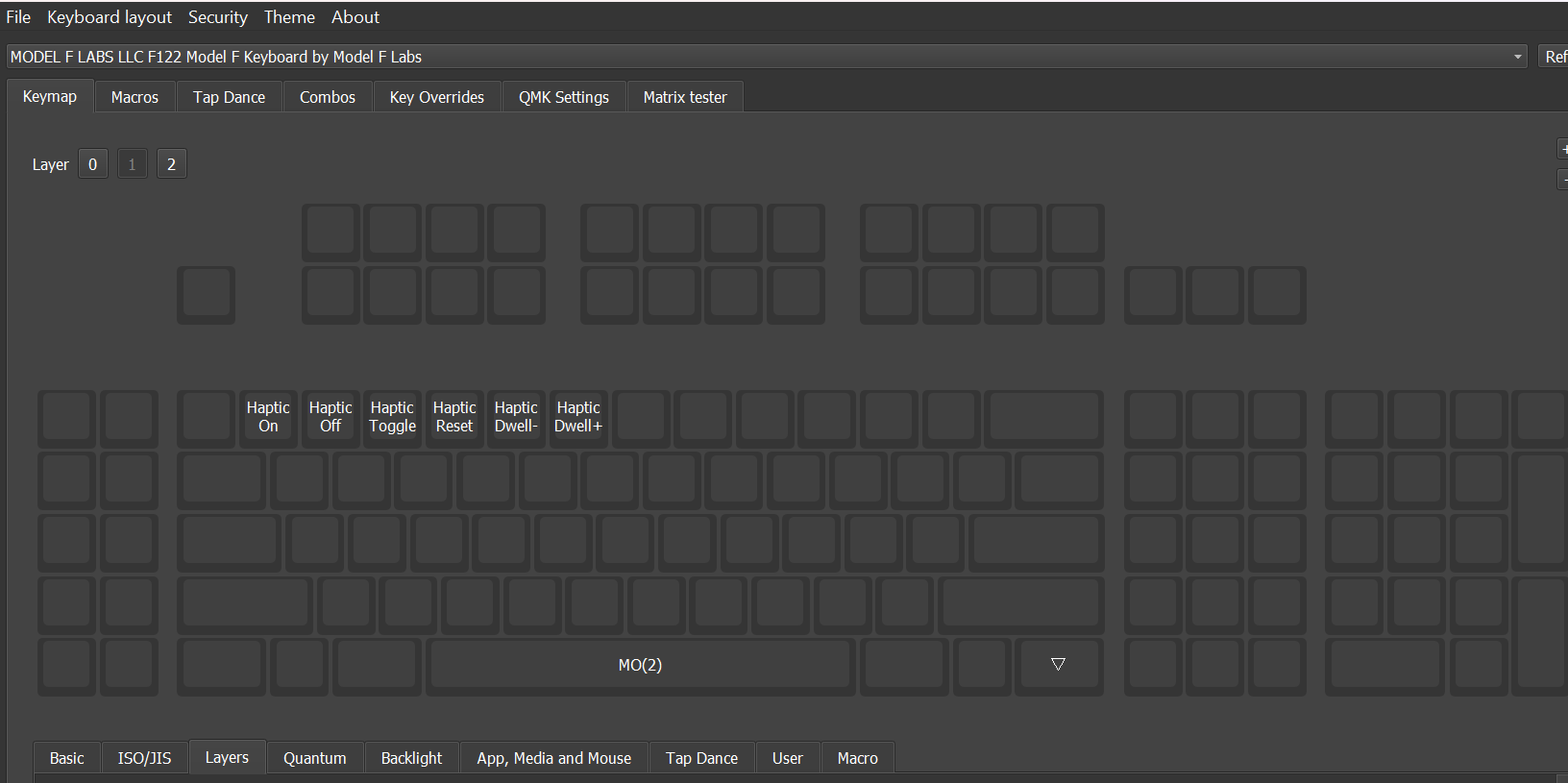

I couldn't get the solenoid to do anything, so I tried installing the latest firmware from The ModelFKeyboards website using the LeydenJar diagnostic software and eh F122 firmware that was in Joe's zip file
According to Vial, these are the keymappings on layer 2 that control the solenoid.
- Screenshot 2025-05-30 133054.png (87.25 KiB) Viewed 18331 times
If I press the layer-2 selectors and "T" (Haptic Toggle) the solenoid will go THUNK! But if I start typing after that, the solenoid doesn't sound. I tried turning the haptic dwells all the way up and down and it doesn't make a difference. The only time the solenoid will sound is if I press the Haptic Toggle key.

The solenoid should work by default without any configuration or keypress combinations. I recommend erasing the eeprom in the leyden jar tool and reflashing the firmware. Since the solenoid is able to fire, it may be an issue with your USB port (not enough power, USB hub, etc.). I recommend trying another port, another computer, and maybe trying your other Model F keyboard if all else doesn't work.

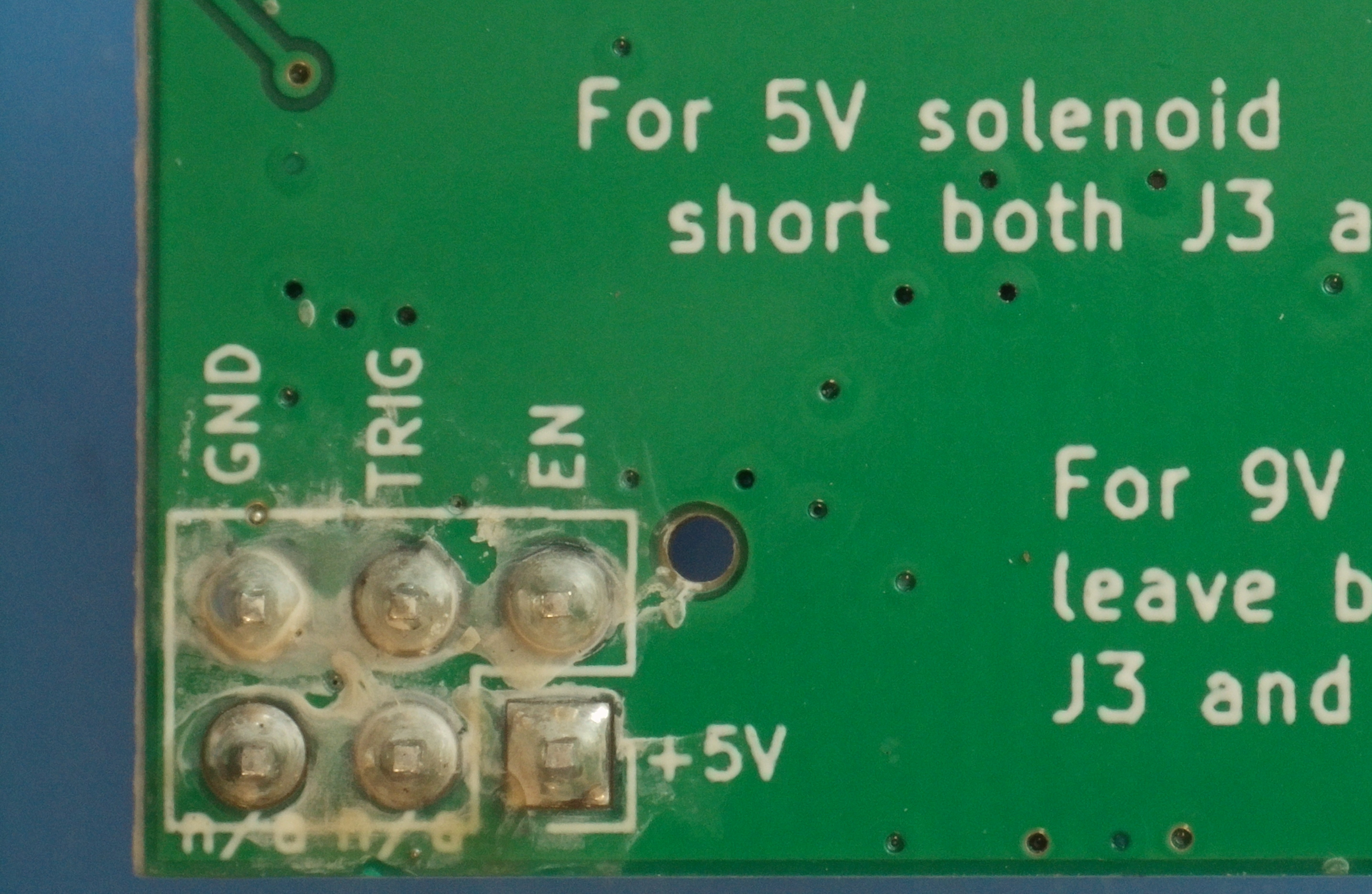

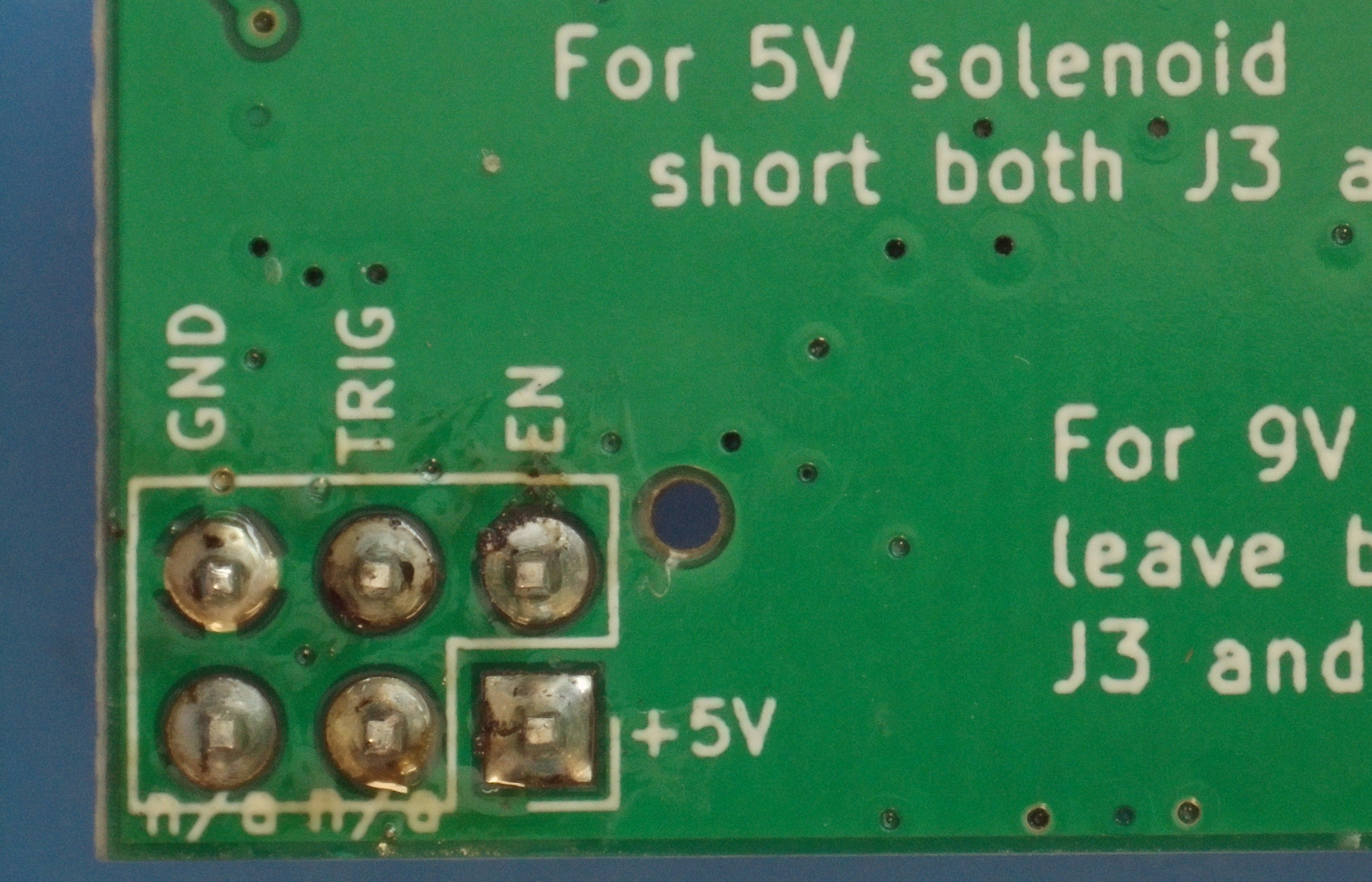

I also tried touching up the solder on the driver board. The original solder job looked sketchy.
- 20240512_123958.JPG (2.5 MiB) Viewed 18293 times
- 20240512_124911.JPG (2.48 MiB) Viewed 18293 times

Check the leyden diganostic tool signal level monitor - maybe a key is being registered as pressed down.
Maybe the solenoid L bar itself needs adjustment as it's getting stuck. Does the cylinder move freely by hand and not get stuck? Are you seeing 6 to 9 volts where the solenoid is plugged in, when keys are pressed? Then it may be due to the solenoid.

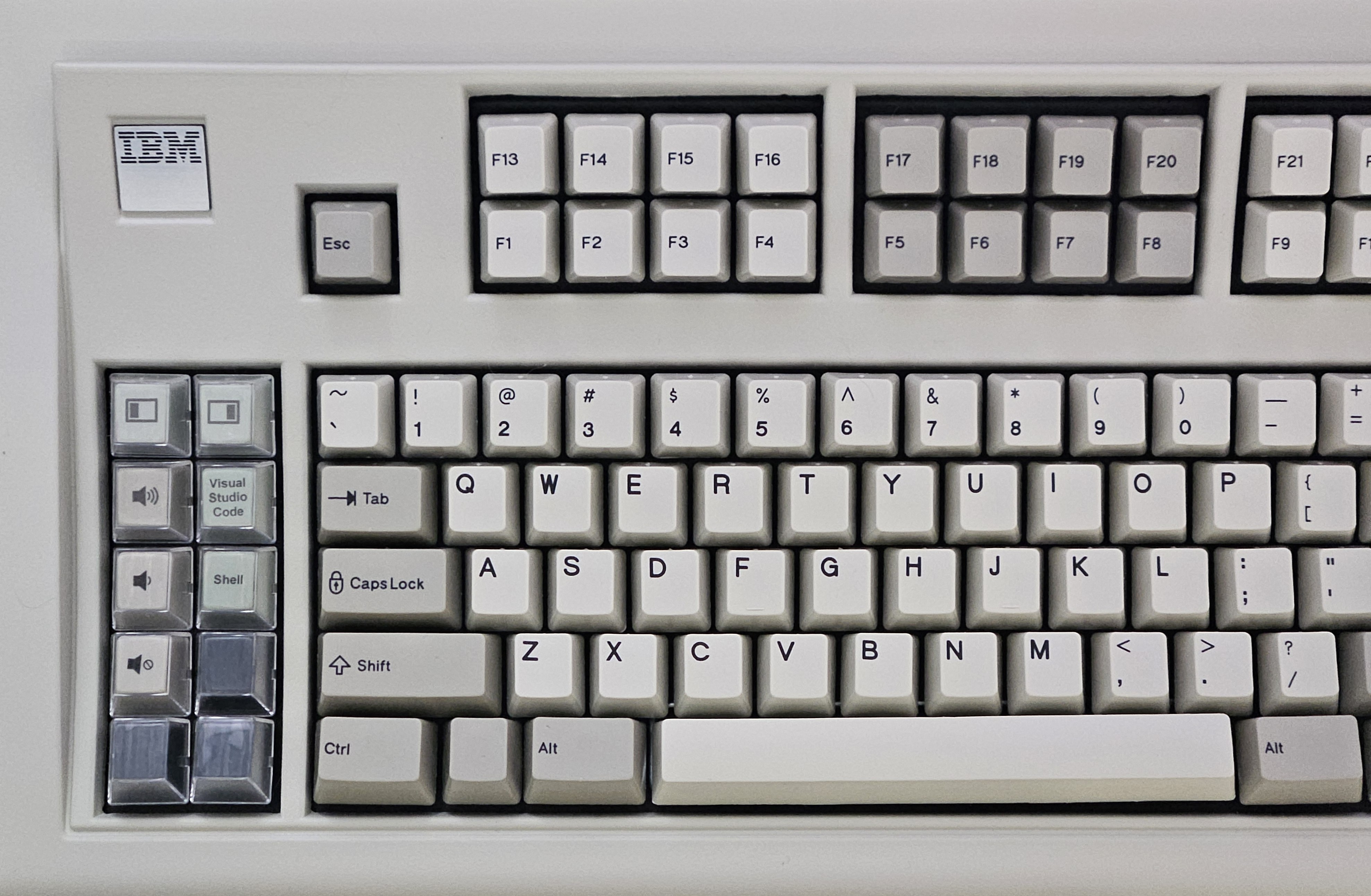

Ellipse wrote: 01 May 2025, 20:39
Please do share photos of how you have customized your transparent relegendable Model F / M keys, whether new or original, as I have not seen too many such photos. Any advice for how to use these keys?
- PXL_20250601_100837551.jpg (138.29 KiB) Viewed 15265 times
I have used M122s for quite some time now. So I'm quite used to the 22 extra keys.
For me, the left 10-key-block is where I put things I use very often for me that's
- Escape. It's there, because M122s don't have a key where the Esc key is on standard keyboards. So on my M, I mapped the most left upper key to Esc which is that one. I have become so used to this position, that I also mapped it there on my F. I'll have to see how fast I can retrain my muscle memory to use the standard Esc position.
- MS Teams raise hand
- Print (= Screenshot) Window
- Print (= Screenshot) Area
- Output Volume Up
- Output Volume Down
- MS Teams mute mic
- Hardware mute mic
- Stop (On my M I used to have LCtrl there)
- Play/Pause (On my M I used to have LGui there)
F13-F19 map to command sequences of text editors and ticket systems etc.
F20-F24 map to hardware control (turn on/off touchpad etc.)
For optical reasons, I've always kept these F13-F24 instead of relabeling them (a meaningful label would require a too small font).
While I like the labels on terminal keys, I also like my keys not to be misleading. I'd rather prefer an unlabeled key (like the LGui/RGui keys on my F122) than misleading ones. This is why I don't use "original" terminal keys for my custom keyboard functions.

I wanted to share a terrific 3d printed solenoid and solenoid driver holder project from f4pv:
https://www.thingiverse.com/thing:7076392
This allows for secure mounting of both the solenoid driver and solenoid inside the F62 and F77 keyboards, as well as being an external solenoid holder for the compact case F62 and F77 keyboards.

Thought I'd post a photo of my F122 w/ bonus cat. I don't have a use for all my keys yet so there are a few blanks. The ones I have added a legend for so far have used the template from @Cyber_engineer -- super handy.
I'd love to hear advice from folks on a few things I've been dealing with. The main one is that pressing "x" or "." bumps the space stabilizer a little, which causes the spacebar to rattle -- making the experience unpleasant. Is there any way to adjust (bend?) it so it clears freely and doesn't interfere with those keys at all?
Second issue is that I've not been able to find a setting or hardware arrangement for my solenoid that makes a nice subtle haptic "tak" -- it's more like a loud typewriter, even with settings that barely get the solenoid to fire at all. Am I doing something wrong or were my expectations just not reasonable?
Re: F104+SSK+122+62+77+50+Ergo orders now open! New Kishsaver+Industrial Model F Keyboards
Posted: 01 Jul 2025, 03:47
by Ellipse
Nice photo TheJBW! Thanks for posting it. I would focus on the spacebar wire. I've also had success bending it in the other direction. I've just updated the manual with this additional information and a new photo. See action step 4 and let me know if this helps. Added text: "Additionally, as shown in the second photo below [added just now], you can bend the spacebar in the other direction, which would move the wire farther away from the > . key. "
Movement can also be reduced by pushing down the metal spacebar tabs slightly, not too much so as to slow down its movement.
You should not be adjusting the dwell times or other settings like that. Check out one of my last couple blog posts as someone modded the solenoid with electrical tape after adjusting the bracket to the shortest possible distance for the solenoid cylinder to move. Please keep us posted!

With permission here are photos of another nice F122 setup that combines two different-color key sets as well as the HHKB style split right shift and split backspace layout.
I like how these days the old style keyboards are bigger and heavier than the entire computers they are used with!

Ellipse wrote: 02 Jul 2025, 03:24
That looks truly gorgeous. After the money I've spent on the beamspring I ordered from you and four Battleships and a bunch of custom bolt-mod and keycaps and whatever, my wife's patience are a little thin (and I don't blame her), but if they weren't... I'd order one.
