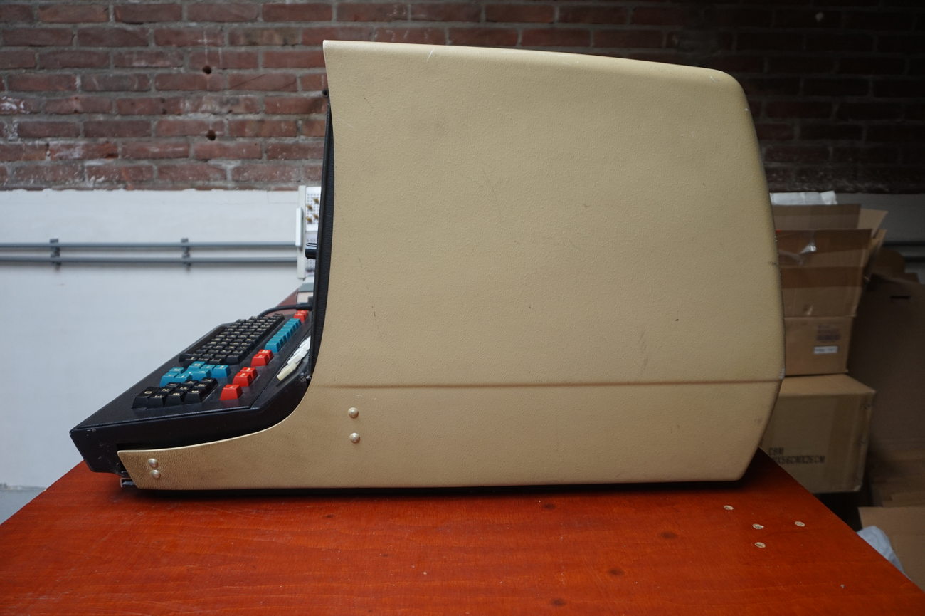

It is not a keyboard, but a terminal, and it was made by Control Data Corporation, one of these computer companies that used to be super well known but that have been almost completely forgotten since. For quite some years, Control Data Corporation made the fastest computers that existed, before their chief designer, Seymour Cray, started his own super computing company. This terminal surfaced in a secondary school, no idea how it got there, but it used to belong to SARA, the supercomputing centre in The Netherlands.
It is a CC609D terminal, and I have not been able to find much information about it. The manuals that are available online are from earlier or later terminals, and there is plenty of documentation about their mainframes (ofcourse), but hardly anything about terminals. I get the impression it came out in 1974 or perhaps 1973. Buried in the internals there might be more clues as to the date of manufacturing, but it does have a sticker saying that this particular terminal had something installed in 1975. It has another sticker elsewhere saying that the screen was repaired in 1981.

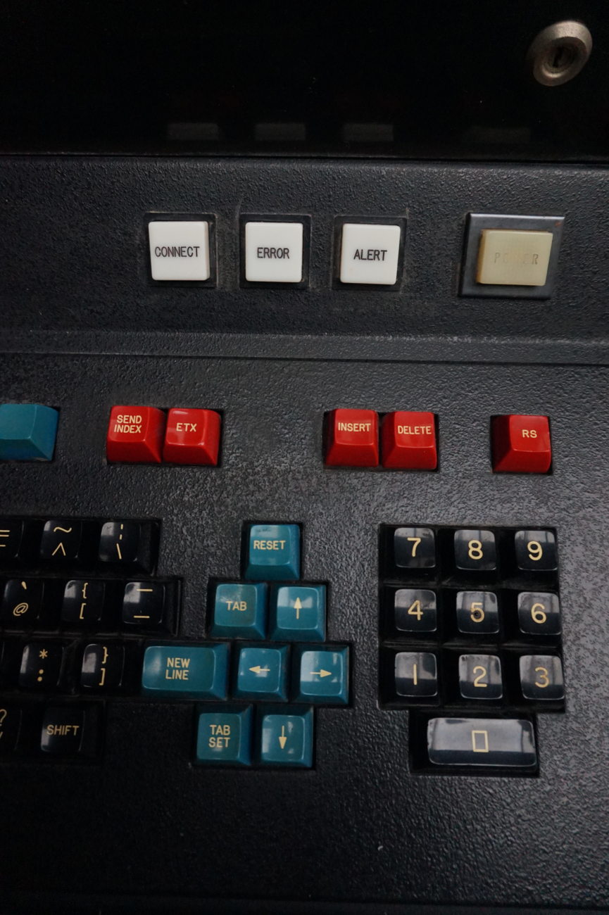

The keyboard is built in (the whole thing is built like a tank by the way, of 2mm thick aluminum plates and steel profiles, and it weighs appr. 40 kilos) and has a great color scheme and font (note the square '0' and the diamond 'O')

All switches in this keyboard are made by Clare Pendar (was very happy it was not Keytronic or Hi-Tek, since I have a few of them in other terminal keyboards and don't like them much...) and they are all identical. I have not yet been able to open this beast further, so the only keys I have not checked are the spacebar and the caps lock. The latter has some kind of mechanical latching mechanism that is deactivated by pressing the 'shift' next to it. Also I am curious to see what is inside these switches !
The switches feel rather nice and springy, but need cleaning and lubricating, since they have become scratchy with age. They could be not bad at all, very linear and potentially smooth ?

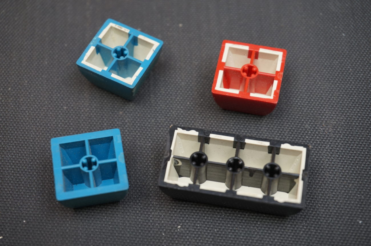

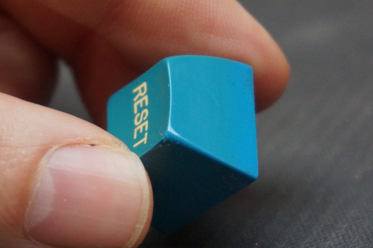

The keycaps are nicely thick doubleshots, especially the blue/turquoise ones are quite discolored, not sure how well that shows on this picture.

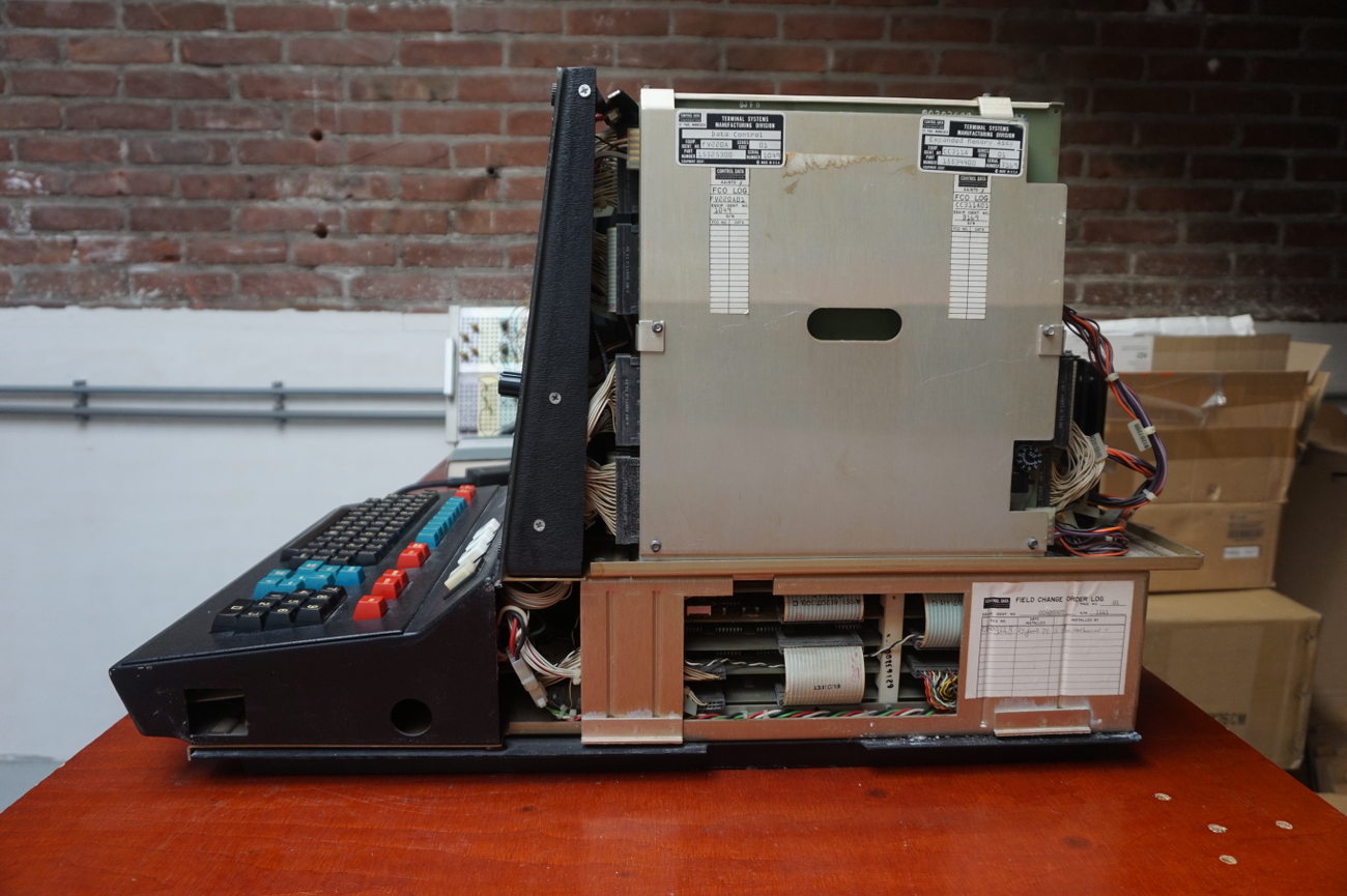

When I switched it on, one of the capacitors in the screen section smoked and split open, so I decided to first take it apart and replace (most of) the paper capacitors and check the electrolytic capacitors for leakage, before they cause problems. Fourty years old circuitry !
I hope I can get it to work, and I am especially curious if this terminal has some kind of graphical capabilities too. Its screen is much larger than the (later) terminals I have, so I wonder why that is ....

I am guessing it was a AC line filter cap that exploded ? The large electrolytic will properly be ok, its the little basteds that you want to worry about.
I would bring it up on a variac if you have one give them old caps time to warm up.
At the ages we are talking about i would check diodes as well.
Posted: 01 Oct 2015, 11:53
by nourathar
thanks !
the cap that exploded was a hi-voltage one in the crt section. I really hope the large electrolytics will be ok enough, since there are quite a few of them !
hmm, good suggestion of the variac, I do have one in storage somewhere. Would that still make sense after already having switched it on after its long sleep ? I had it on for a few minutes, and I suppose the seller did too before deciding to sell it.
Is that slow warm-up something you do once or something to do everytime you switch it on ?
Posted: 01 Oct 2015, 12:06
by andrewjoy
If something was going to explode ( spoiler it did :P), then it would have already exploded.
Its always the high voltage ones that explode! Tantalums like to go BOOM! If you have a big one of them, be somewhere else when it decides to go.
The big electrolytic caps will be fine they are made very well, its when you get small ones that they fail as they are usually not so well made, they wont explode , but they may vent and go high ESR.

Hi Jan,
ah, interesting ! There's so few pictures of this thing and so little information online; now at least we know that Amtrak had quite a few of them..
ofcourse I do not really know and we can not see what is inside that terminal, but I would guess that is the same terminal as mine, perhaps with a few different cards in it and some small modifications in how the buttons and indicators just above the keyboard are laid out; the differences I see are:
- the row of red/blue function keys (the terminal on your picture has a few keys more),
- the white square indicator lights / buttons just above the row of function keys (I see two here and I have three),
- the location of the lock (on mine it is next to the screen, here it is in the same row just under the screen)
- the led indicators (just above the logo on mine, more to the right here, and it seems there are fewer of them too)
So I would guess this would be CC609A,B,C or E or however many variants they had... but that is not based on any real knowledge at all !
