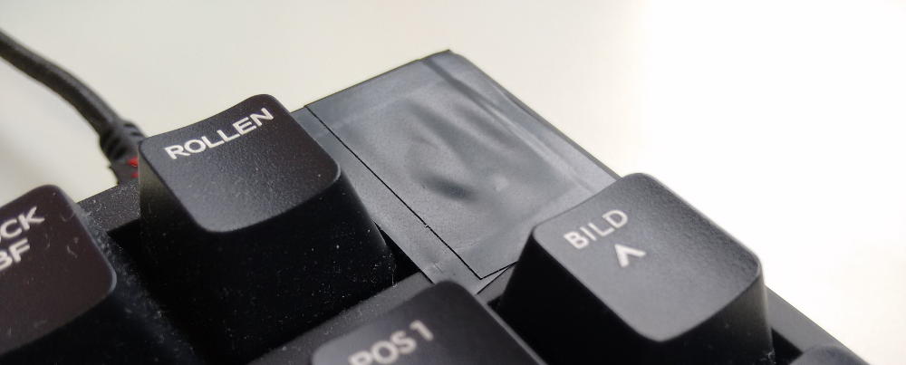

The first of many true believers in my cause that made a brave sacrifice was my current workhorse Sir Novatouch. It had to surrender the innards of one of its 88 limbs in order to further the advance in desktop technology we are all working hard to achieve:
That valiant deed deserves true recognition.

What foul deed did you enact upon the proud and noble novatouch ?

by Stabilized
ħ
Tis but a scratch!

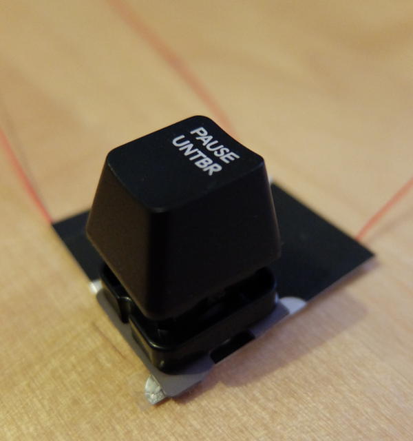

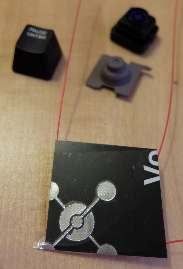

Posted: 08 Dec 2015, 20:27
by hbar
'Tis indeed!
Thou shalt blow your kitchen foil to tiny bits, ending up like this:
The sacred Novatouch parts can be seen scattered all over the place.
Measuring with a multimeter, the capacitance between the two half-moon-ish electrodes increases from essentially 0 to about 2pF when the key bottoms out.

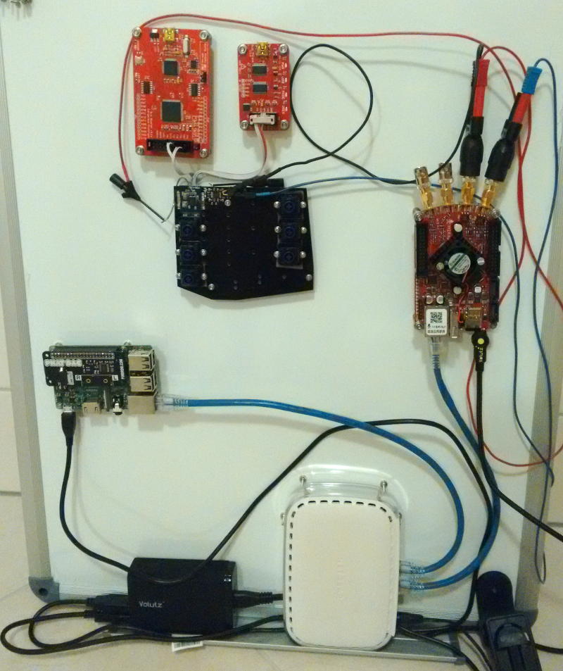

Let's see some pictures!
First of all, the set-up is quite a mess, as always:
As you can see, I'm testing with a single key only, just to see whether it works at all.

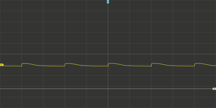

Now the first results, for a single row. Key present but not pressed:
Key partially pressed, around actuation point, you can clearly see some 50Hz as well there:
Key fully pressed -- you can see the overall signal level rise somewhat, that's because the sense capacitor is too small, I'll have to try a larger one next time:

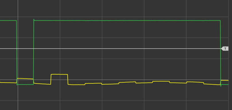

All graphs are at 1V/div and 5ms/div. The green plot is the reference excitation output from the controller (an extra column with fixed capacitors instead of Topre electrodes) and allows me to trigger the scope on a scan frame. Timing is (sort of) arbitrary at the moment, I just used the timers already in the SDK example my code is based on.
The yellow plot is the output of one of the row amplifiers, which is also connected directly to an ADC input of the controller, with the goal of measuring the key states using that ADC, so this signal is what the ADC will eventually sample. By principle, there is an unpredictable offset of the entire curve (which we'll have to live with), but the plateaus before and after each rising edge are very nice and flat, so there is plenty of time for the ADC to sample them. The idea is, therefore, to read the column signals before and after each excitation pulse (which is a falling edge of the row drive signal, resulting in a sharp rise in ADC input signal) and compute the difference.

How do you get those 2us steps on the input from the stable excitation level?
Posted: 21 Jul 2016, 00:09
by hbar
Since there is no resistor in the design, the rise time is only affected by the slew rate of the controller output and the bandwidth of the amplifier, which are both in the µs ballpark.

hbar wrote: Since there is no resistor in the design, the rise time is only affected by the slew rate of the controller output and the bandwidth of the amplifier, which are both in the µs ballpark.
But wouldn't voltage on TIA output drop to zero once voltage stops rising? I mean, wouldn't measure window be very short?
