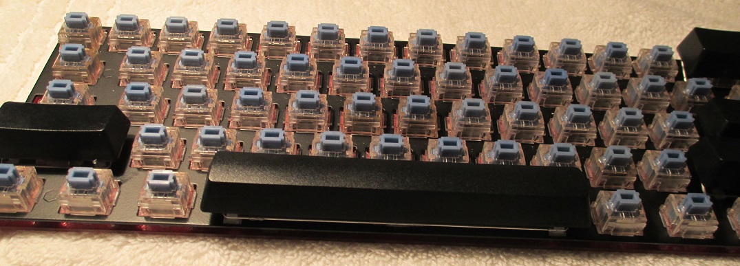

Here is my latest Matias hybrid -- Matias Click housing with slider, spring, and click leaf from Blue Alps. I'm provisionally calling it the "MatiaBlue" switch.
Here is a KBP V60 with the hybrid switch:

Here is a potato pic of the top housing, click leaf, slider, and return spring from a Matias Click (left) and Blue Alps (right) shown side by side. The reflectance is off -- the springs and click leaves should look silver-colored rather than gold-colored, and there is a speck of dust on the Blue slider.
From my own visual inspection of the actual components, the click leaves appear to have the same dimensions. Likewise, the sliders have the same dimensions, but the Matias Click slider has cutouts on both sides, whereas the Blue slider has a cutout on only one side -- the side facing the switchplate. The return spring in the Matias is also longer than the return spring in the Blue Alps. The main differences are in the housings and especially (not shown here) in the switchplate mechanisms. It is the switchplate that got simplfied in the simplified Alps and Matias switches.
So, the Matiblu hybrid is different from an unmodified Matias Click switch, but it is also different from a Blue Alps switch. The Matiblu is quieter and lighter than a Matias Click switch and has less wobble, but it is not a Blue Alps switch.
