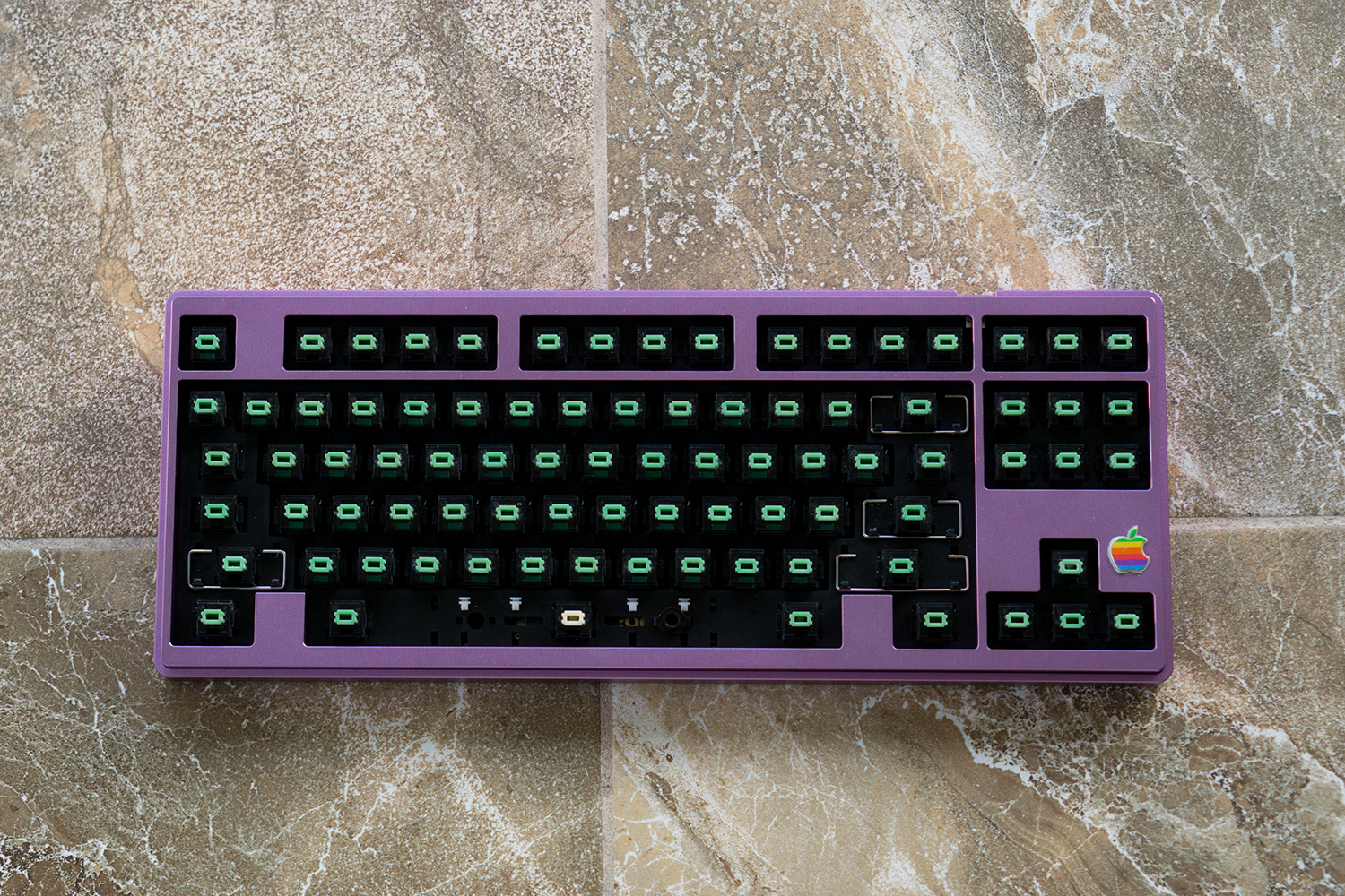

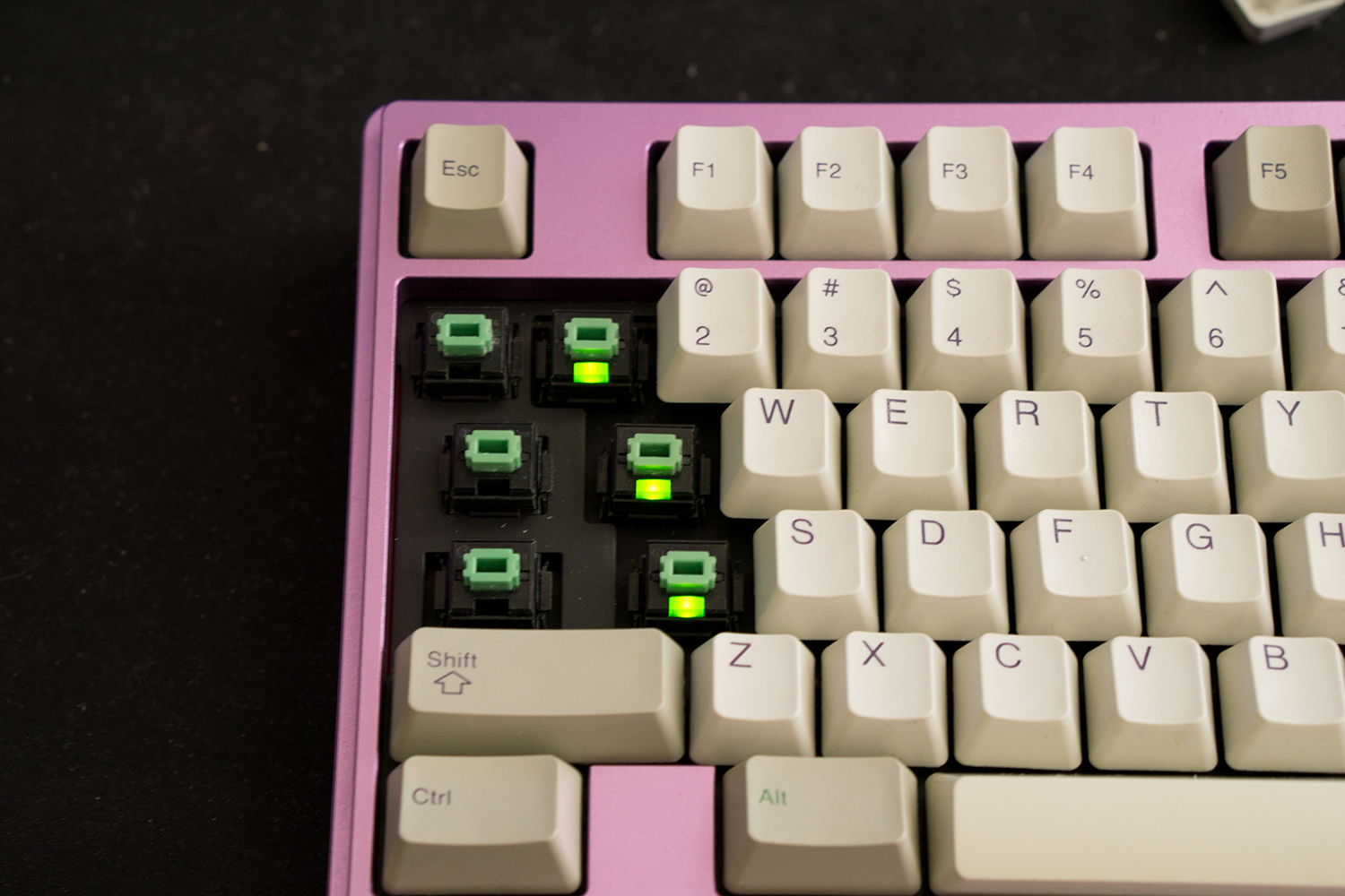

Build Log
I replace the leeku's pcb with The Leaf pcb, big thanks to Shadohhh and Mike for putting up with my shenanigans, kept building then desoldering then trading pcb's. The Leaf pcb and the Time pcb are virtually the same, except the Leaf pcb has the extra slot for Alps stepped capslock, so I dont have to drill the pcb like I did with the Time.
Evolution of the plate: Stainless Steel -> Acrylic -> POM
Evolution of the flex: No switches -> 6 switches -> switches and scissors. I was trying to find the most consistent weights that can grab hold onto the flexy plates.
Drilling the LED holes:
- 3/64'' drill bit
- instead of a dremel, I like to use the bigger hand drill. The hand drill just anchors on the table and I could feed the housings to the drill, that way it is more consistent. You only have to work with one hand really, less slip and slide.
Lube:
-Super lube for the springs to take care of the pings mostly. First gen SKCL's are notoriously pingy
-PFTE powder for the stems with IP as the applying medium
-Pictures show 5s, 30s, then 5min for powder drying
I go over the bottoms with a brush to get rid of excessive powder.
Prepping the capslock:
A little more drilling to widen up the holes. Same 3/64'' bit
Soldering the alphas:
-The little comb to line up the switches HORIZONTALLY. 3mm is the maximum thickness for the comb.
-The LEDs to line up the switches VERTICALLY
-Solder 3 columns at a time.
The Plate:
-Plate is 1.5mm which is a bit thicker than the standard 1.2mm for alps
-Toothpick trick to keep the stab hooks in place because of the 1.5mm thickness problem. Something I picked up from building cherry boards with clip-in stabilizers; and I think these are still the best pcb-mount stabilizers out there. You dont have to worry about shorting or the screws hitting the bottom case.
-Plate support to make sure the plate doesnt slide off the switches, a common problem with plastic plate for both alps and mx
Delirious
23 Feb 2019, 05:14
Alignment check
The case:
Final thoughts and shoutouts:
The build log tooks about 10 hours for this revision. And the result is something that I am very happy with. The board feels amazing now, as a matter of fact I am using it to do this whole write up. The plastic half-plate adds a tiny bit of flex which drags out the bottomings, sort of like a delay effect while the switches still retain the characteristic of SKCL's in general. I was trying to replicate the mx feels but in the end I got something unique by itself and I am happy about it.
Last but not least, thank you to all these people that make it happen:
-Shadohhh: None of this could have happened without your helps. We already built your LZ-GHv2 twice and when I asked you for the pcb, you gave it to me without any hesitation. I promise we will build your LZ-GH again, soon, and that will be the last time.
-Mike52787: For generously offer his Time PCB to me, also suggested me to use LED's as the extra pins to do half-plate alps build.
-Keebs from Homerow Co.: the most committed keyboard collector out there, one day we were talking about powder lube and you immediately bought 3 different types powder to test them out. IPA + powder is the best.
-E3E: Meticulous in your knowledge of alps, all the back and forth discussions.
-senter: My favorite gb runner for sure, it all started when I pm'ed you asking for the plate file of the Fox Orange TKL because I want to build my board in alps instead of mx. All the subsequent gb's you slowly implement bits by bits to cater the alps crowd.
