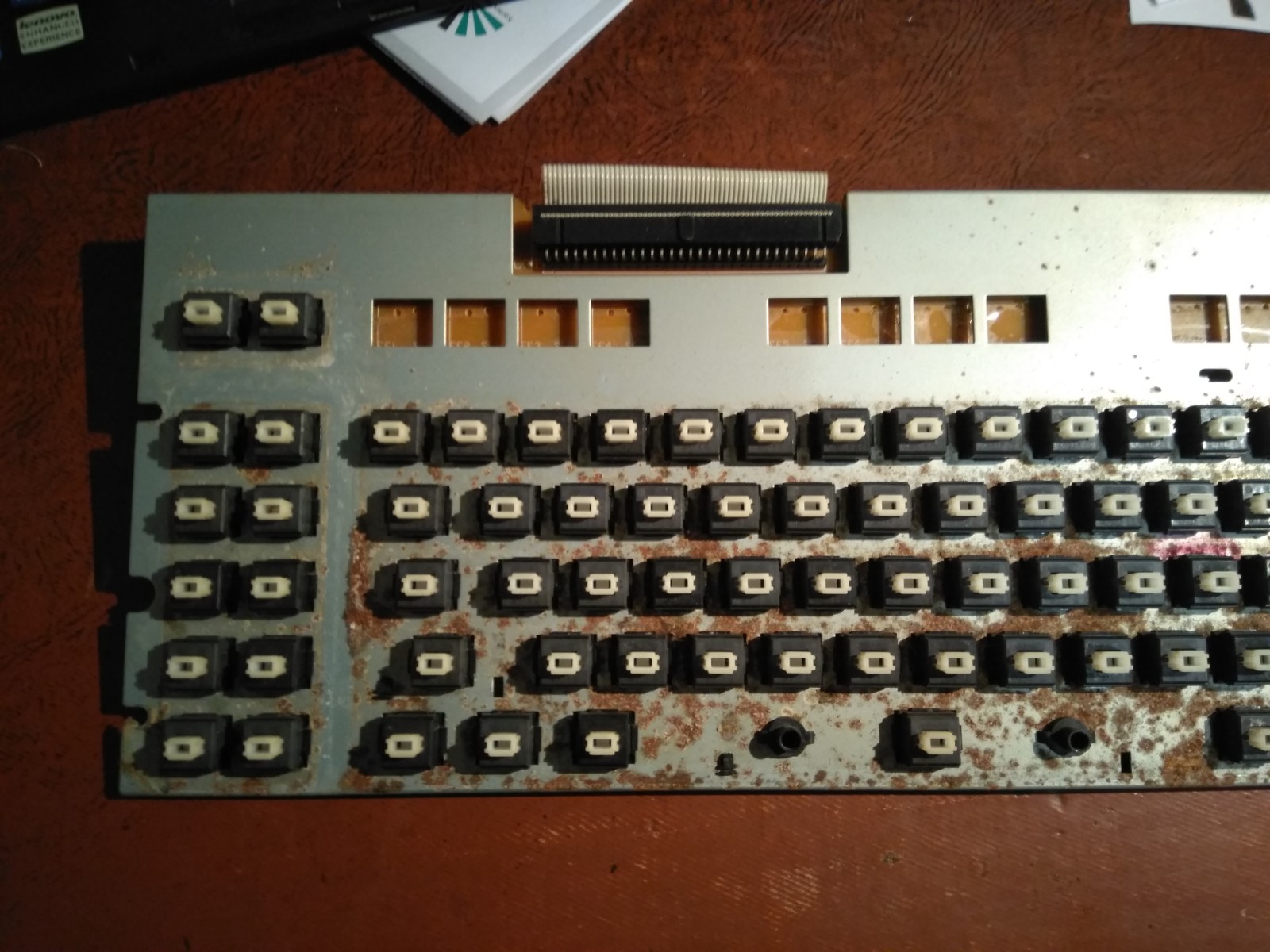

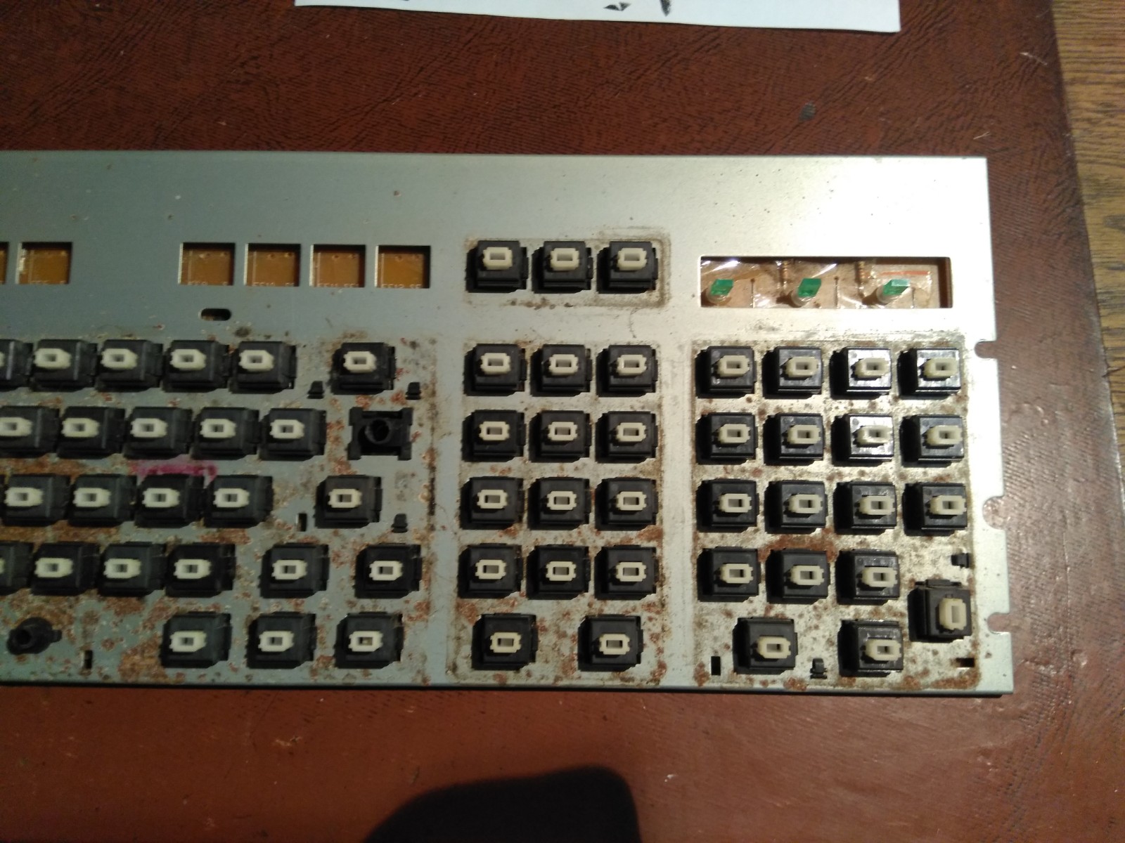

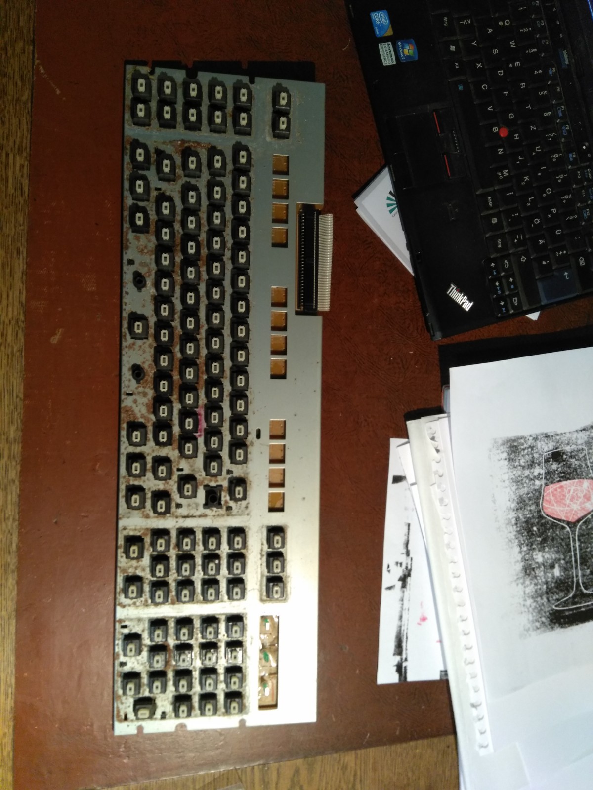

I need some help with repainting a plate. All of the plates on my keyboards have a little rust or areas where the paint has "warped" or is flaking off. All of those are ALPS boards, so I've never wanted to bother with desoldering all the switches. I've always just thoroughly cleaned the plates and moved on.
However, I've recently got an Omnikey in very bad condition. Rust all over the plate, very dirty, etc.
Since I will replace the switches anyway or at least remove them for cleaning, I'm inclined to give the backplate a new coat of paint. However, how would I do this? Do I have to sand off the old paint by hand, then repaint everything? What paint should I use, should I bother with some rust-stopper before the paint? A whole lot of questions :?
What about sandblasting? I cannot do it myself but would have to send it to some sort of service company. I have one more plate that I could send in, but that one is in a rather good condition and does not necessarily need a repaint. The whole thing is also not very cheap tbh. Worth it or not?
There are simple tutorials online about how you can build a simple DIY sandblaster and I already have a compressor. Anyone here who has tried that? I'm not sure if too good results can be expected from that...
Any advice on the procedure in general and anything I have to have in mind when doing this with an Omnikey plate?

jsheradin
28 Dec 2020, 17:51
You'll definitely need to remove the rust before you paint it but sandblasting and all that isn't necessary.
I would:
  • Remove the switches
  • Get the bulk of the rust off with a wire brush or 220 grit sandpaper
  • Soak the plate in Evapo-rust and rinse
  • Get it pretty smooth with some 220-800 grit sandpaper
  • Wipe it well with acetone/paint thinner/degreaser
  • Hit it with a coat or two of self-etching primer
  • Hit it with a couple coats of color

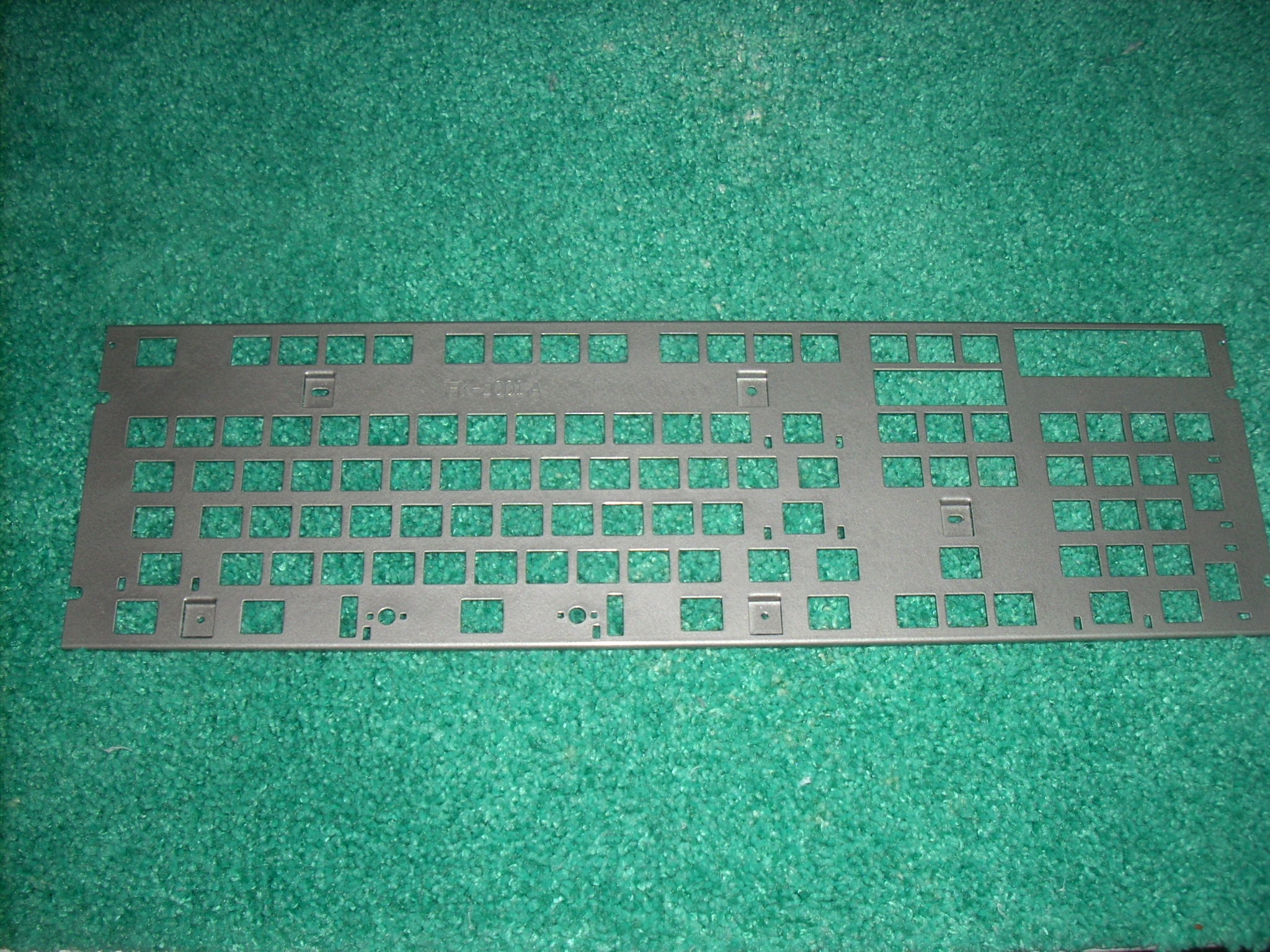

This is a Focus plate (very similar to Northgate) that I painted with the Aervoe engine enamel. Color is Cast Iron Gray. Two thin coats. If you do more than one coat either put on the second within twenty minutes, or wait three days between coats. You'll end up with a big mess otherwise (don't ask me how I know that).

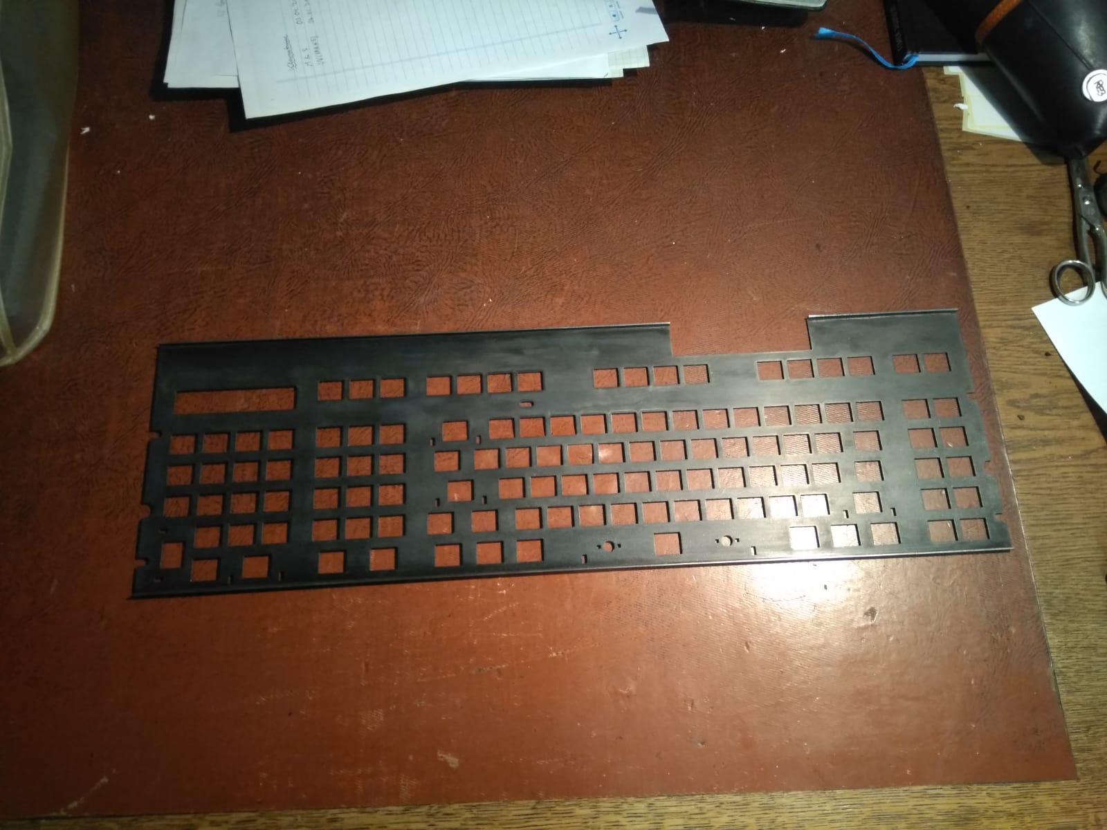

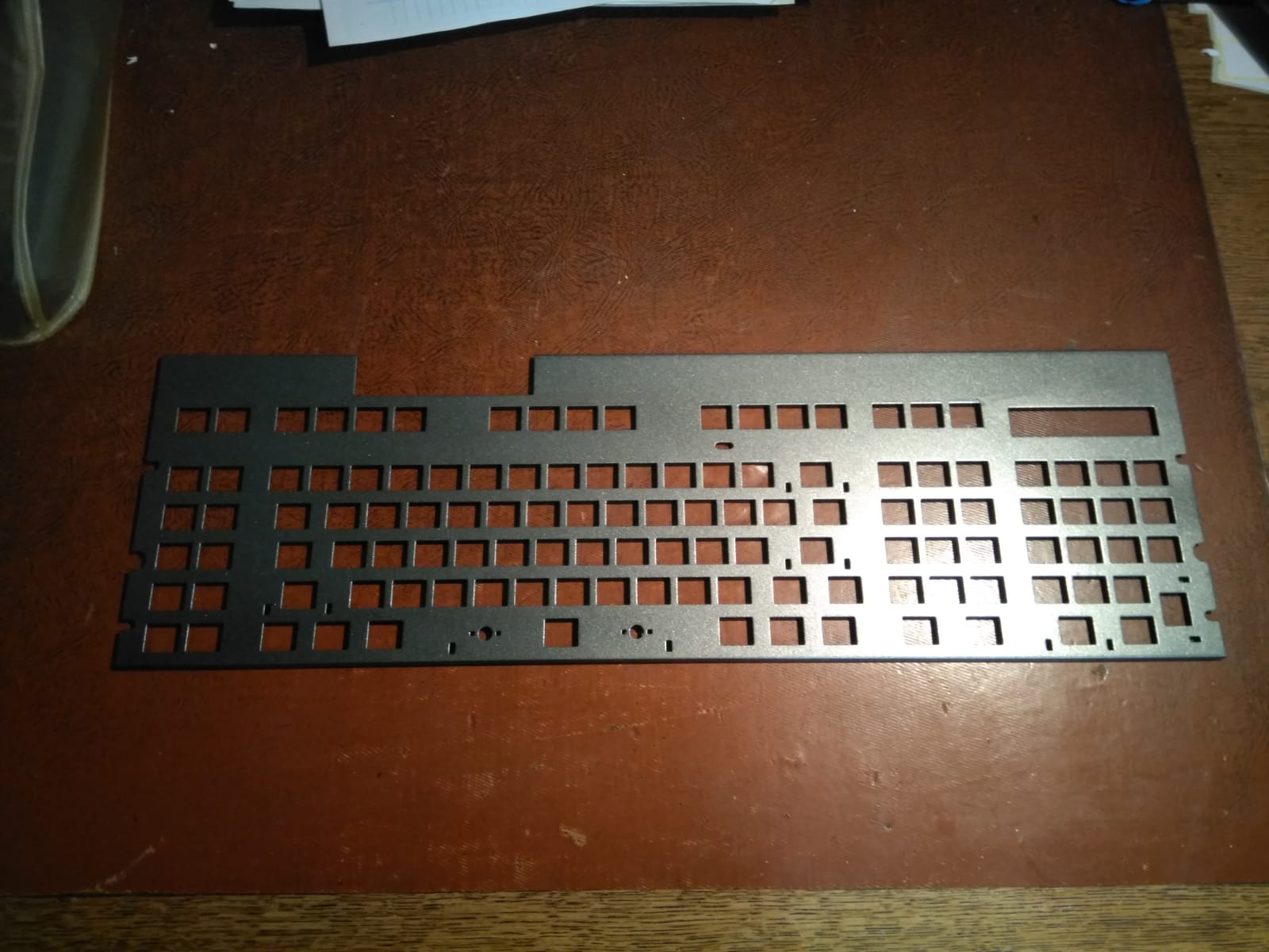

Soo, I finished the plate today and I think it turned out pretty ok. I chose a darker color cause it looked promising and I absolutely love it. "Cast iron gray", looks exactly like a fracture or crack surface on some cast iron machine part. I wanted to treat the backside too somehow since it was coated in some way on the plate in its original state. Another layer of spraypaint sounded too much for me. So I decided to try blueing. Also turned out pretty good IMO. Wouldn't recommend it tho, too difficult to make it look decent and you'll have to grease it up a little to make it actually resistant to corrosion. I drenched it in oil for an hour and wiped it off thoroughly, so it should be ok now, but still...
So the entire procedure went like this:
  • Rust Remover
  • Sanding
  • Blueing
  • Sanding the front again
  • Spraypainting

Polecat
18 Jan 2021, 02:09
TNT wrote: 17 Jan 2021, 23:27 Soo, I finished the plate today and I think it turned out pretty ok. I chose a darker color cause it looked promising and I absolutely love it. "Cast iron gray", looks exactly like a fracture or crack surface on some cast iron machine part. I wanted to treat the backside too somehow, since it was coated in some way on the plate in its original state. Another layer of spraypaint sounded too much for me. So I decided to try blueing. Also turned out pretty good imo. Wouldn't recommend it tho, too difficult to make it look decent and you'll have to grease it up a little to make it actually resistant to corrosion. I drenched it in oil for an hour and wiped it off thoroughly, so it should be ok now, but still...
  • Rust Remover
  • Sanding
  • Blueing
  • Spraypainting
Thanks again for the advice!
Looks great to me, thanks for sharing!
