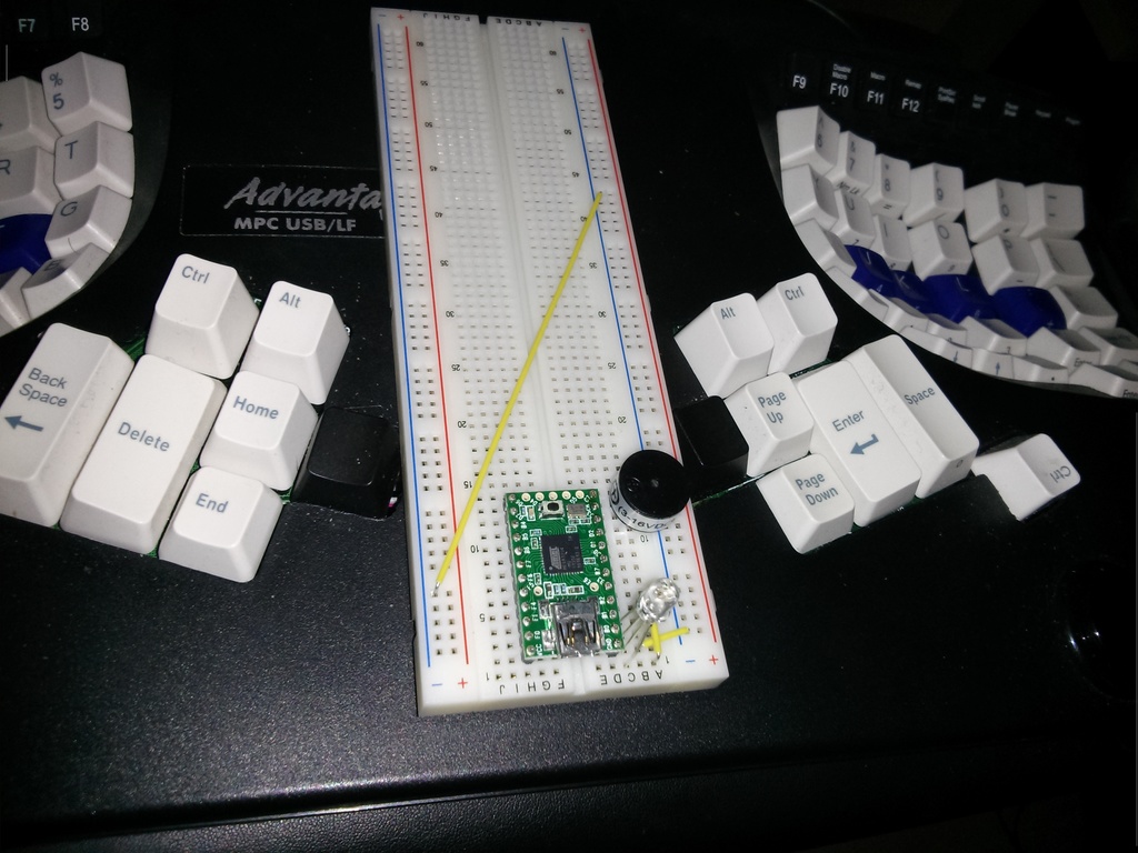

Actually, yours has more keys than mine, I have a teensy with the ErgoDox firmware loaded, on a breadboard, without any switch. I do have an led and a piezo buzzer on it though, for a click sound

smart! buzzer clicky sound for mx red

a buzzer for clicky sound?! O___O

A short burst (say 10ms) of a sine wave (around 2.4 KHz is my estimate of what my Kinesis does) is what makes a virtual "click" sound. Very useful to add feedback to linear switches, to avoid bottoming out. Kinesis and some old Zenith keyboards have it and it's very nice feature to have. It's like having (linear) Cherry MX blues that you can turn the click on and off whenever you like
You can try this on a linux box to see kind of what it sounds like:
$ sox -n out.wav synth 0.010 sine 2400
$ play out.wav
$ play out.wav
