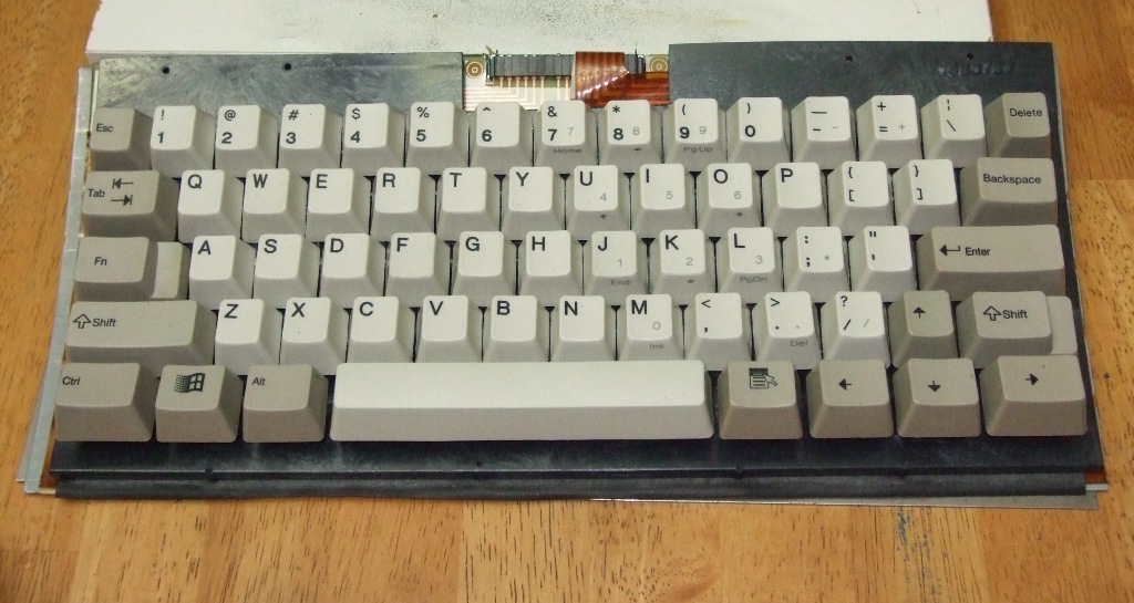

Instead of a PCB, I like the flexibility of the hand wired technique:
The custom project I'm working on with Matteo just now is another hand wired matrix. Just plain old Cherry MX switches, though.
I wonder what the chances are of building a discrete buckling spring switch mechanism based on simple electrical contact – the keyswitch equivalent of the Model M's membrane – because that seems to be the ideal modding recipe for really building your own. PCBs have their advantages of course, but ultimate customisation is where a hand wired matrix shines.
