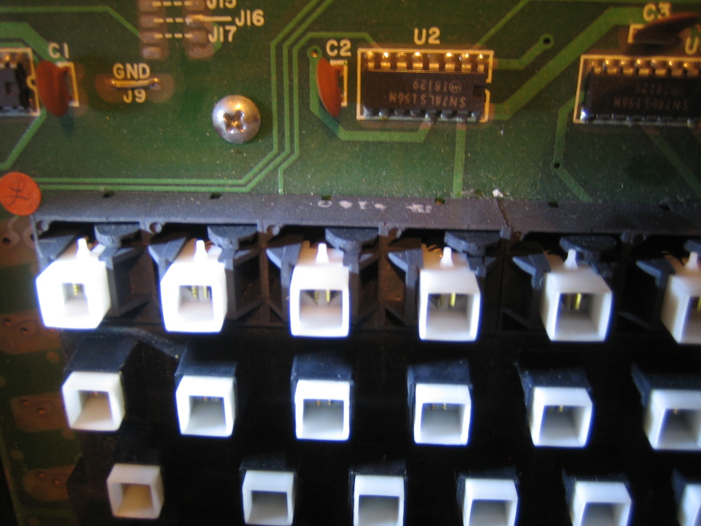

The switches are of the HiTek / Stackpole type that was very common in keyboards around that time. They are linear and this keyboard is more scratchy than some of the other boards I have with the same switch: that must be down to how it was used and stored.
This keyboard seems to have keys added on to an original design; the larger plastic housing has smaller units around it consisting of just a few keys. And the pcb has plenty of connection points for more..
Note also the little coloured stickers and the written notes: the terminal is full of them and it gives a sense this thing was actually built by real people.

All the function keys can be made to latch by slipping on that little mechanism; I'm not sure how that would ever be useful. The only switch where this mechanically latching capability is actually used is caps lock.

HaaTa wrote:
It uses
MEI WEAB switches. I don't think I've located a patent yet.
Yeah, I saw the pictures you posted of that board, and I was sort of disappointed to find out that this VC had HiTek / Stackpole switches since those are a lot more common !
