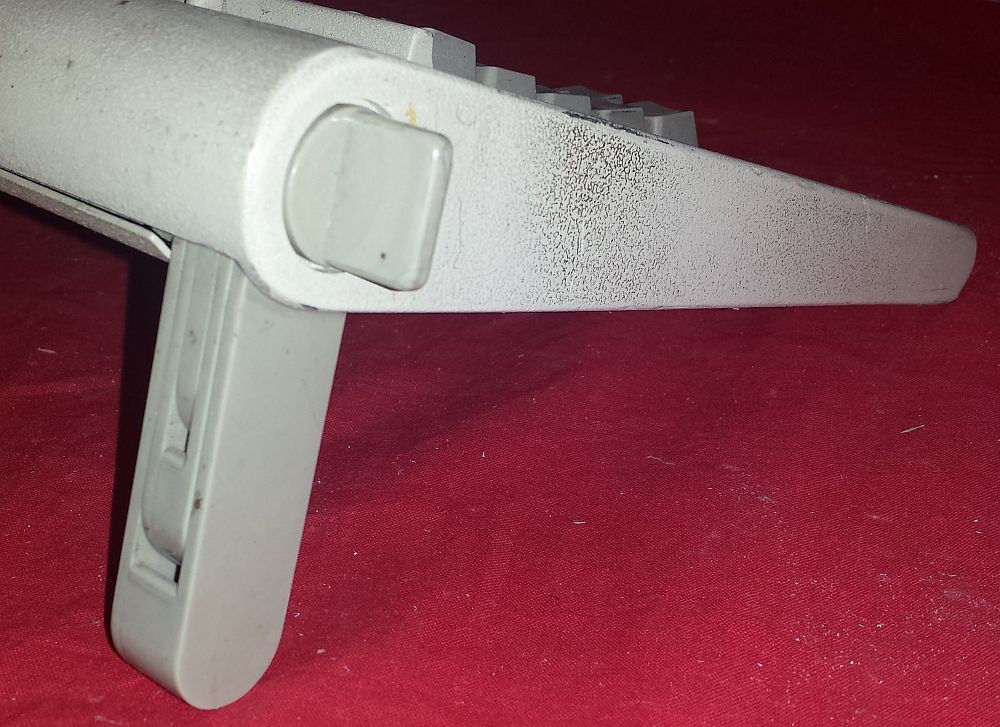

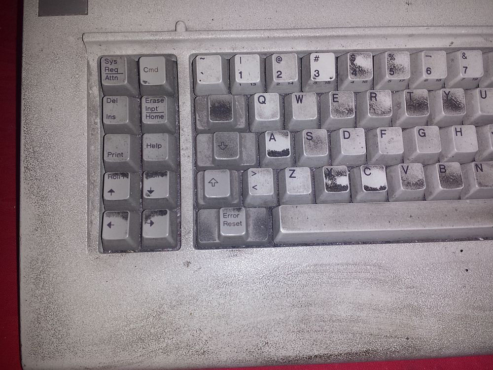

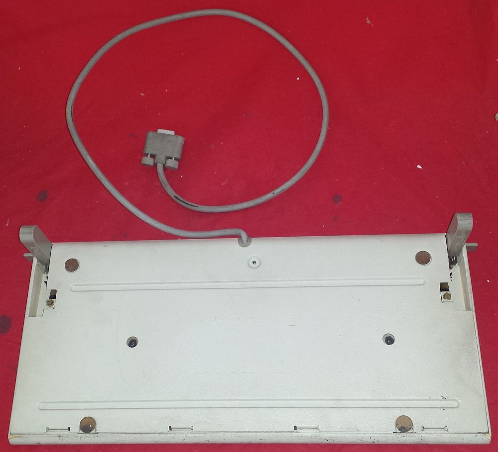

I couldn't help myself. I know nothing about it, but it's filthy, strangely proportioned, and has a cute stance. Waiting for it to arrive - anybody have some background info?

Hrm? Soarer's Controller firmware includes a bigfoot config file.
# IBM 'bigfoot' PC/XT layout 5291-2 terminal keyboard
# Works without modification to keyboard (bigfoot has no CPU!).
Also, I'm typing on my SSK with his controller firmware right now and wow - it's ridiculously easy to configure and install. Bam. Haven't done the layer mapping yet but it also looks super freakin' simple.

Perhaps he means a Model M version of the Bigfoot. Model F keyboards use a completely different sensing technology, which requires more complex electronics. (You have to probe with an oscillator instead of a simple flat voltage.)

It reads multiplexed strobes. Neato.
03 Jun 2014, 03:36
Oh, that's good! The one he's converted has a weird split controller design, where the capsense and the logic are separated entirely. Instead of a signal/protocol, the raw capsensed output is exposed over the wire, so he's processing that. Hopefully yours is one of these!
