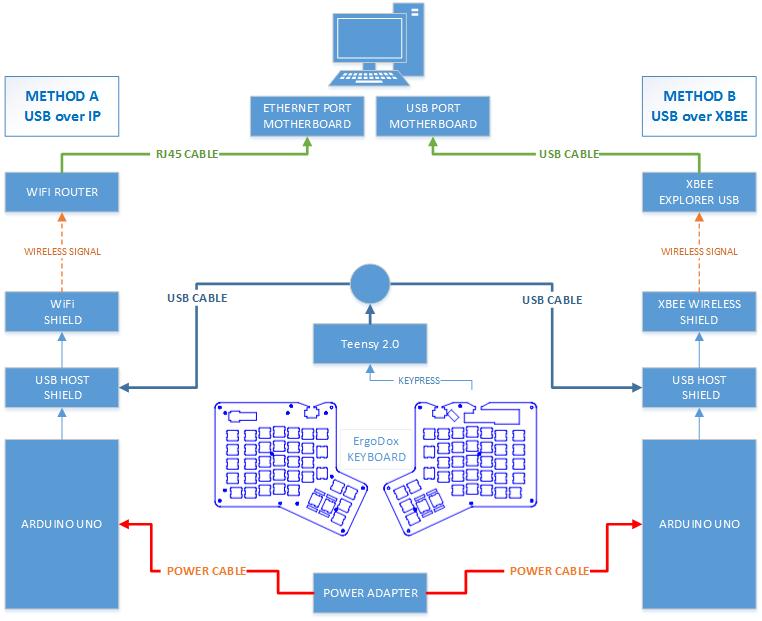

Hey guys,
Just like the 'subject' says, wireless ErgoDox... is it even possible? I'm one of many waiting for MD drop to ship out my kit, In the mean time I've been kinda kicking around the idea of hacking a wireless connection together for ED... Been looking at Arduino / ExBee / Wifi ... Reading up on arduino forums, thought i'd share some links , and see if anyone can shed some light on if/how this can be accomplished...
WHY: I am hoping to relocate my PC tower to the closet and get rid of as many wires as possible. The 'master' plan is to have Wacom / ErgoDox / 24" Monitors all "detached" from the tower... But I figure I should start by trying to get ED working first...
HOW: (see attached diagram)
method A (usb over IP(wifi))... ED (teensy) would need connect to an Arduino UNO via USB host shield and send user inputs, from there the signal would need to be passed over to the Wifi shield for broadcasting... The signal would need to be picked up by Router and routed to PC , then "somehow" interpreted as a keystroke(s)
method B (usb over XBEE)...ED (teensy) would need connect to an Arduino UNO via USB host shield and send user inputs, from there the signal would need to be passed over to the XBee Shield for broadcasting... The signal would need to be picked up by another XBEE module that would be connected to the PC through XBee Explorer USB , then it would also "somehow" would be interpreted as a keystroke(s)...
In both methods, ErgoDox would need to be powered through the Arduino...
I'm going to keep researching this idea, so If anyone has suggestions or links to existing solutions that would be great...

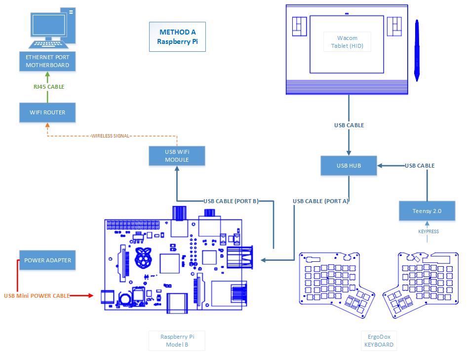

A cool idea was introduced on GeekHack
1.Desktop Computer > running 'Synergy - Server'(any OS)
connected by LAN cable to Network Router(BEST DAMN ROUTER EVER MADE
2.Raspberry Pi > running 'Synergy - Client'(Linux OS)
drawing power from USB power supply
connected by USB Wifi Module to the network
3.ErgoDox & Wacom Intous 5 & Whatever else HID device > connected to the Raspberry Pi through a USB HUB
I guess then the question would be, what are the limitations of Synergy:
Is there noticeable lag for HID input, making connection of a Wacom Tablet useless?
Does the Raspberry Pi need to be connected to a monitor to be compatible with Synergy?
Is there a light enough easily implementable battery power solution that would juice the Pi & ErgoDox & Wacom & USB HUB (possibly external monitor)?
If anyone else has any input on this , it would really help...
If this sounds like a viable theory to you guys, I'm going to order up the parts and post a complete breakdown on implementing this setup at home...
This is what the diagram looks like so far:
