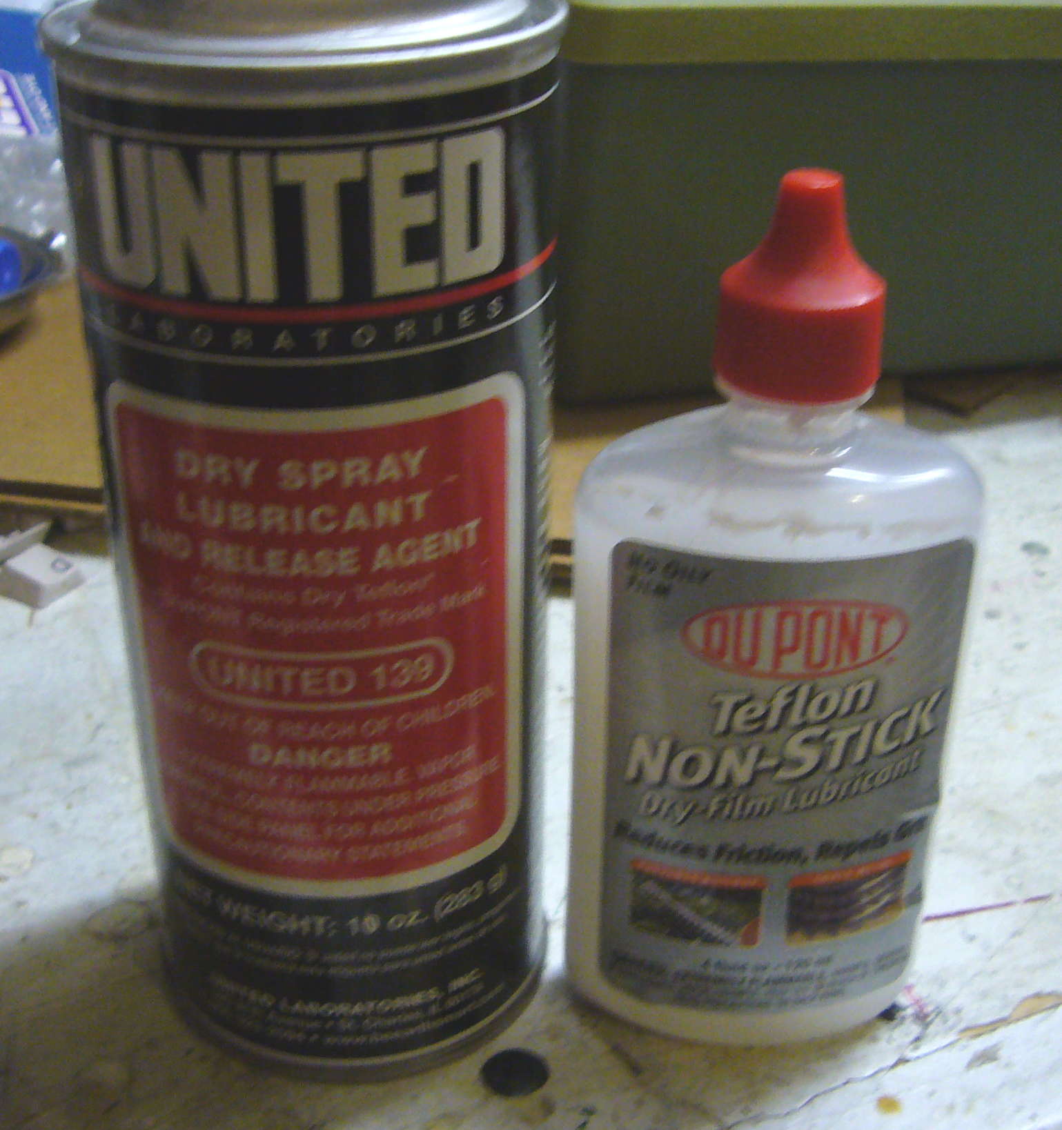

I am getting close to embarking on a new Dell AT101W-based project.
I already have my 4 "primo" Alps keyboards, full-sized and TKL, 2 of each (Northgate 101, Dell AT101W, Filco Zero, and Ducky 1087XM) with my 2 fave switches, blue and orange (stock switches but all decked out and whatnot), and now I want to look for the "ultimate family-friendly" full-size keyboard that is at least minimally tactile but quiet - including, if necessary, modding switches, which I have never really done with Alps.
The chassis will be a Dell AT101W again (in a black case with a weight bar and padding modded in) and I have a set of Dolch-repro doubleshots for caps (and plenty of beige and black spares to fill in gaps if need be, including Apple PBT that is dyeable for WASD, arrows, etc).
So, I have hundreds of black Alps, at least a hundred orange, at most 100 white (1st gen SKCM), ~100 old creams from a Wang 725, a small handful of blue, around 60 Matias Quiet clicks, and a couple each of odd things like locking switches from CapsLock. I also have a least 1 AEK2 that I could cannibalize but I would just as soon keep it intact. I don't mind mixing switches if they are close and there are a couple of dozen around the perimeter that I use a lot less than the others. Certain ones, such as CapsLock and Numlock, can be full clicky if need be.
What I am seeking are distinctly tactile switches but as light and quiet as possible. Sound means nothing to me but feel means everything.
This is a conundrum and a frustration because the best-feeling switches are so often the loudest.
In this instance, I am willing to sacrifice as much sound as necessary but would prefer to keep as much tactility as possible.
For the first time, I plan to disassemble the switches, clean them thoroughly, lube (and mod?) them, and re-assemble them to get the optimum fresh start.
Since no one has seemed willing to belly up and recommend a lubricant, I am probably going to go with the DuPont pictured here. I also have Krytox 103 but I am reluctant to use a wet lubricant for fear that it will attract dust, except in the wire stabilizer tabs, of course.
I am down to semi-click-modded (2 tabs bent or removed from the leaves but not all 4) orange or creams for the main body of switches with clicky blue or white when I want to be notified of something (such as CapsLock) and orange, black, or Quiet Clicks for those odd ones that I rarely if ever use.
My primary questions at this point are whether I should use the oranges or the creams (these are the old Wang ones, not the dampened Apple ones) and whether the 2-tab mods will give me adequate tactility without unnecessary noise.
TL;DR I understand, but don't answer unless you have something constructive.
Thank you very much! Harry
- 20160627-teflon-2.JPG (181.57 KiB) Viewed 5839 times

Fohat: I say you take the housing and sliders (with bumpers) from cream Alps, with the springs and tactile leaves from orange Alps.
If you want quiet, thick PBT is better than thin ABS.
And then you can stuff the case with padding to further cut sound.

Fohat, if I recall correctly, performing the click mod on tactile Alps will reduce the actuation force of the switches, I am not sure if this is what you want as far as tactility goes. I guess they would be lighter though. I believe Creams are somewhat heavier than Oranges, as well.
Have you considered using the damped sliders from your AEKII? Those would help dampen sound from bottoming-out.
Also, you may have already seen this, but here's a force graph of various Alps switches; maybe it will help:
EDIT: Whoops, ninja'd on using the damped sliders.

Jacobolus/Emdude -
The cream Alps are from an ancient Wang and I am pretty sure that they are not dampened, nor do I want them to be.
Second, the lighter the better as far as actuation force. I use heavy switches like buckling springs, but I really like light.
If the orange is lighter than the old creams, then I will use my oranges.
If O-rings worked on Alps, I would do that, too.

Fohat: I meant the cream switches from the AEK II. (Or maybe obtain another AEK II to harvest switches, if you don’t want to change the one you have?)
The non-damped ivory/cream switches should be roughly comparable in stiffness to salmon Alps; both are stiffer than orange. Other than the stiffness of the springs (and tactile leaves?), the housings and sliders of non-damped ivory/cream switches and orange switches should be approximately identical.
