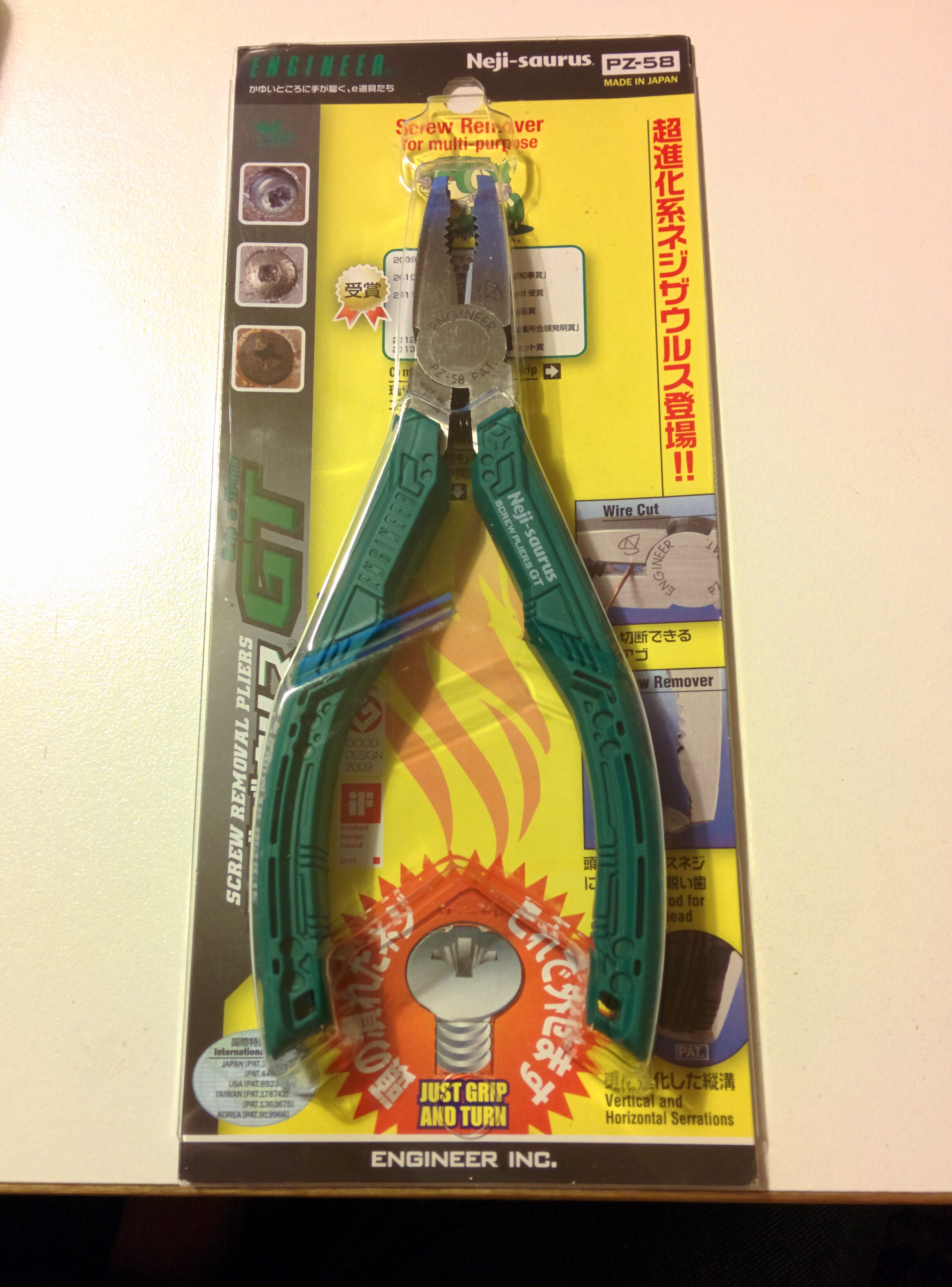

You've just reminded me of a tool I had purchased a long time ago specifically to remove a bolt due to a Model M bolt mod gone a little wrong, nearly pulled out all my hair and then.....the Engineer PZ-58 screw remover arrived by post.
Made in Japan and top notch quality.
- Engineer PZ-58.jpg (1.74 MiB) Viewed 6380 times

@J888www: It's important to use the right tool for the wrong job!
Seriously, though, thanks for the tip. This gadget could save the day when things go awry.

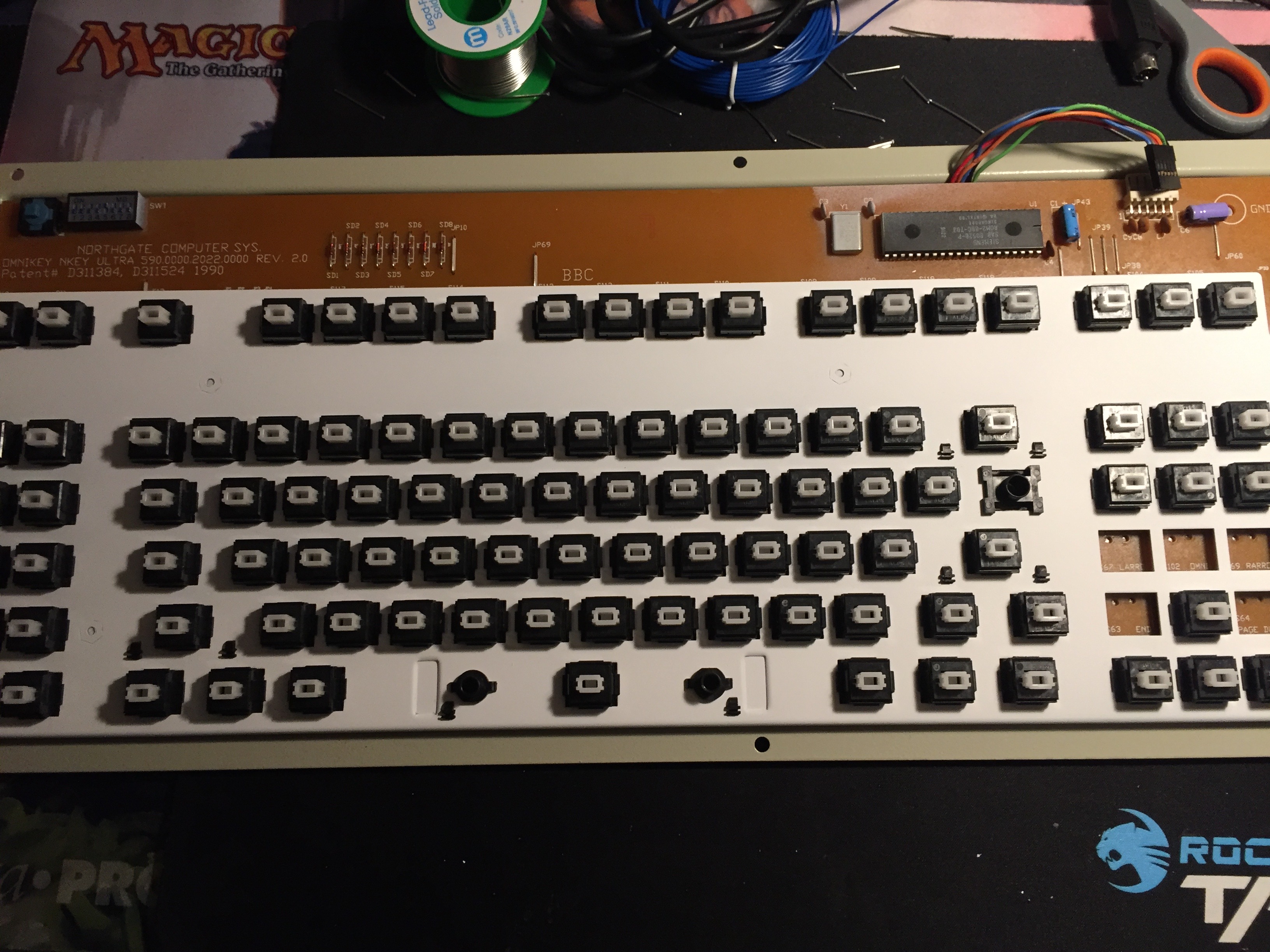

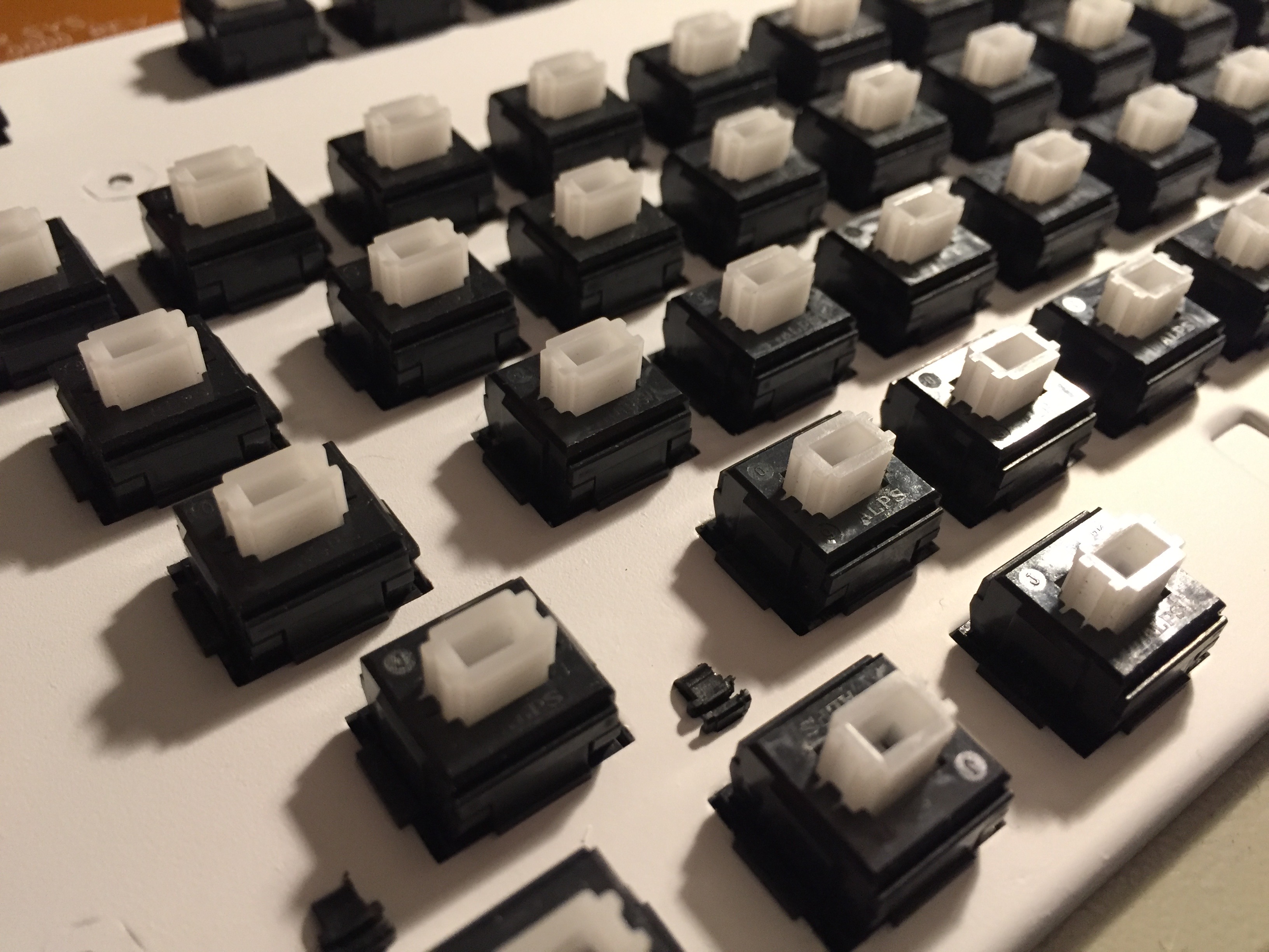

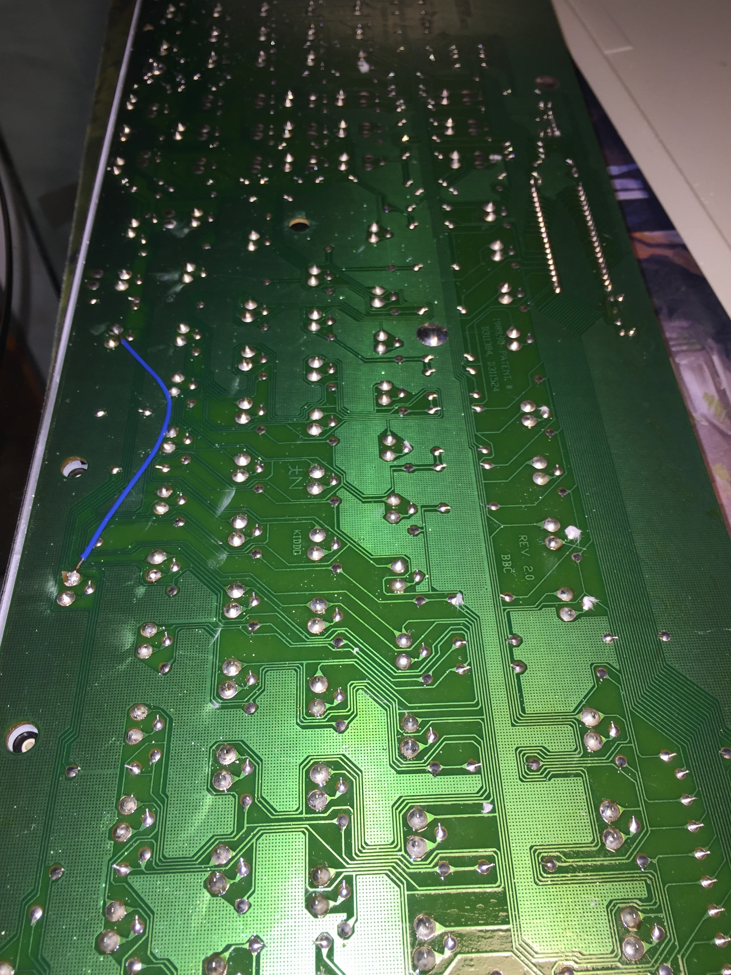

Weeeeeeeell, turns out around 30 switches had their pins bent riiiight back against the PCB, not unlike the Dell AT101. Anyway, all was going well desoldering, a few light accidental scratches here and there, no problem. Then today came the needle-nosed pliars and the desolder wire and the sucker and the last 30 switches.
All was going well until 3 switches before the end, and lo and behold, the metal contact ring around one drill hole on the space bar half comes away, taking with it a 2mm shard of copper trace, exposing the substrate underneath.
Soooooo yeah. Bummer.

You can fix that, follow the broken trace to where it meets a pin or another switch or similar , you can then solder a jumper wire from the switch pin to where it should be going.
I had to do this with the MX 6.0 keyboard Mµ broke when he was trying to disable the LEDs

Yeah I thought about that. It might be best to test all of the trace to make sure that the others don't have the same problem. I'm a bit reluctant to solder 116 switches and for a dozen to be non-functional or something.

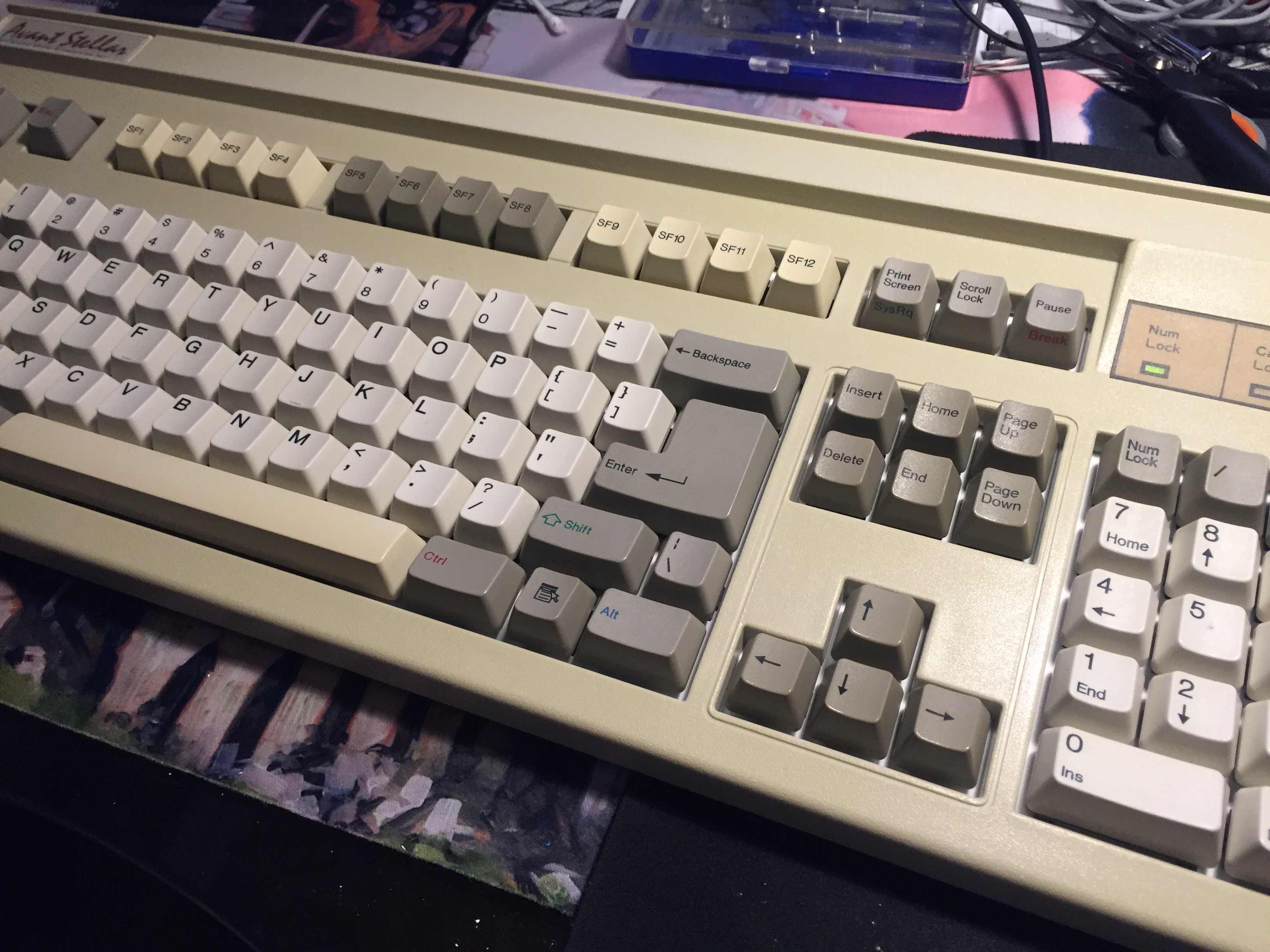

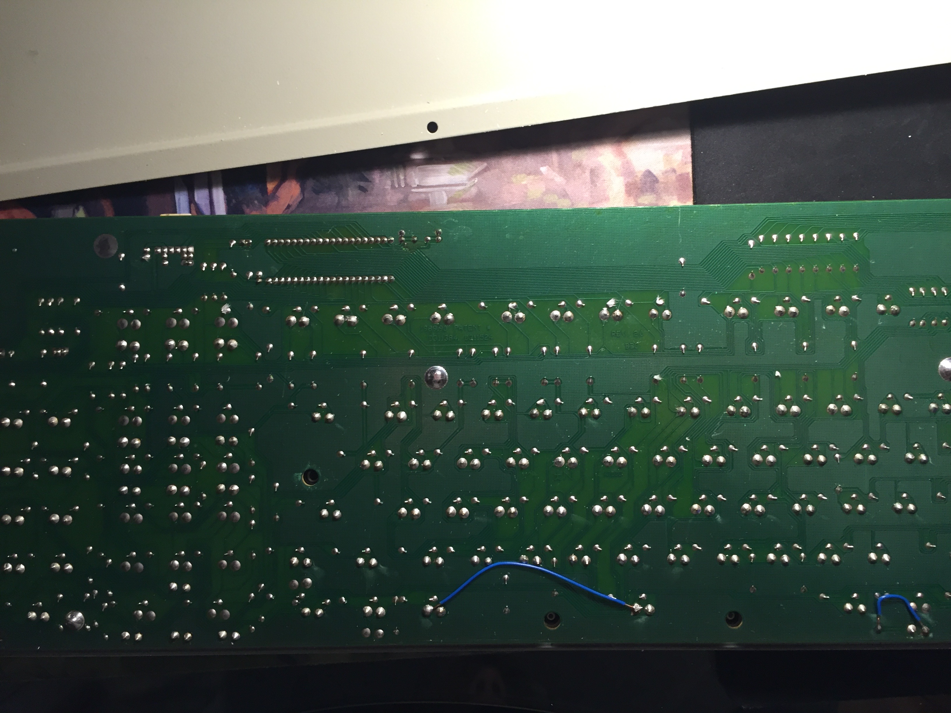

I finally finished my restoration project. Thought I'd share a few pics. It was full of rust and very dirty. Here's what I did:
Cleaned the board, desoldered all the switches, ripped the copper contacts on 2 of them (by accident), sanded the plate, prepared the plate, used Rustoleum primer on the plate, got some clean white Alps, got some keycaps from another Omnikey that were less used and whiter, swapped out those that I could, soldered the switches, put jump leads on two switches, reassembled, tested.
It works first time! I was surprised how easy the soldering was. The desoldering was a pain, but the soldering was perfect, really tidy and fast. Unfortunately I can't be bothered to disassemble the board again to show it off!

Congratulations!
- mac80211
- Favorite switch: Cherry
The menu key on the keyboard is definitely from an Avant Stellar.
CongratS! very nice and clean.

Nice! Congrats. What are those F-key keycaps? I don't remember seeing an Omnikey coming with anything other than F# keys. I did not pay that much attention, though.
Nah. Pics or it didn't happen!

Yeah it's pretty weird. It had a Northgate padded 'sticker' on top of it, I think someone must have stuck it on, it looked too much of a hack job for it to have come from the factory. So I took the home-made sticker off and left the Avant Stellar badge.
The internals and the case are definitely Northgate though. It's just got the wrong DIP switch cover on it.

Not bad soldering for a first time at all. Mod wires are a little long but good job on the nice joints.
I am guessing the pad was already lifted ?
EDIT
One thing i noticed looking closer , there are a few heat marks on the PCB , nothing that will hurt anything however for the future i would turn down the temp on your iron, if it wont melt solder at that temp get some leaded solder (60/40) that is much thinner 0.3 or 0.4 mm and has flux in it. Also add extra flux onto the PCB ( you can NEVER have too much flux EVER just down the thing in that shit)
This will let you use a much lower temp , and do less damage to the PCB.
EDIT

Thanks for the advice
Yeah the PCB on this Omnikey is brittle.
I did increase the iron temperature in increments and started using it when the solder was good to work with (i.e. actually melted) but then again it's a pretty rubbish iron (gets the job done, mind).
I'll look around for some better solder for my next project.

You will also want to make sure you are using a tip thats shaped like this ( if you can change them on your iron)
The ones that are just a point are well , useless. You have to have it way hotter to get the thermal transfer needed.

Oh like a chisel tip? Ok I'll have a look for one of those. The one I have is a point. I believe I can swap them in my iron.

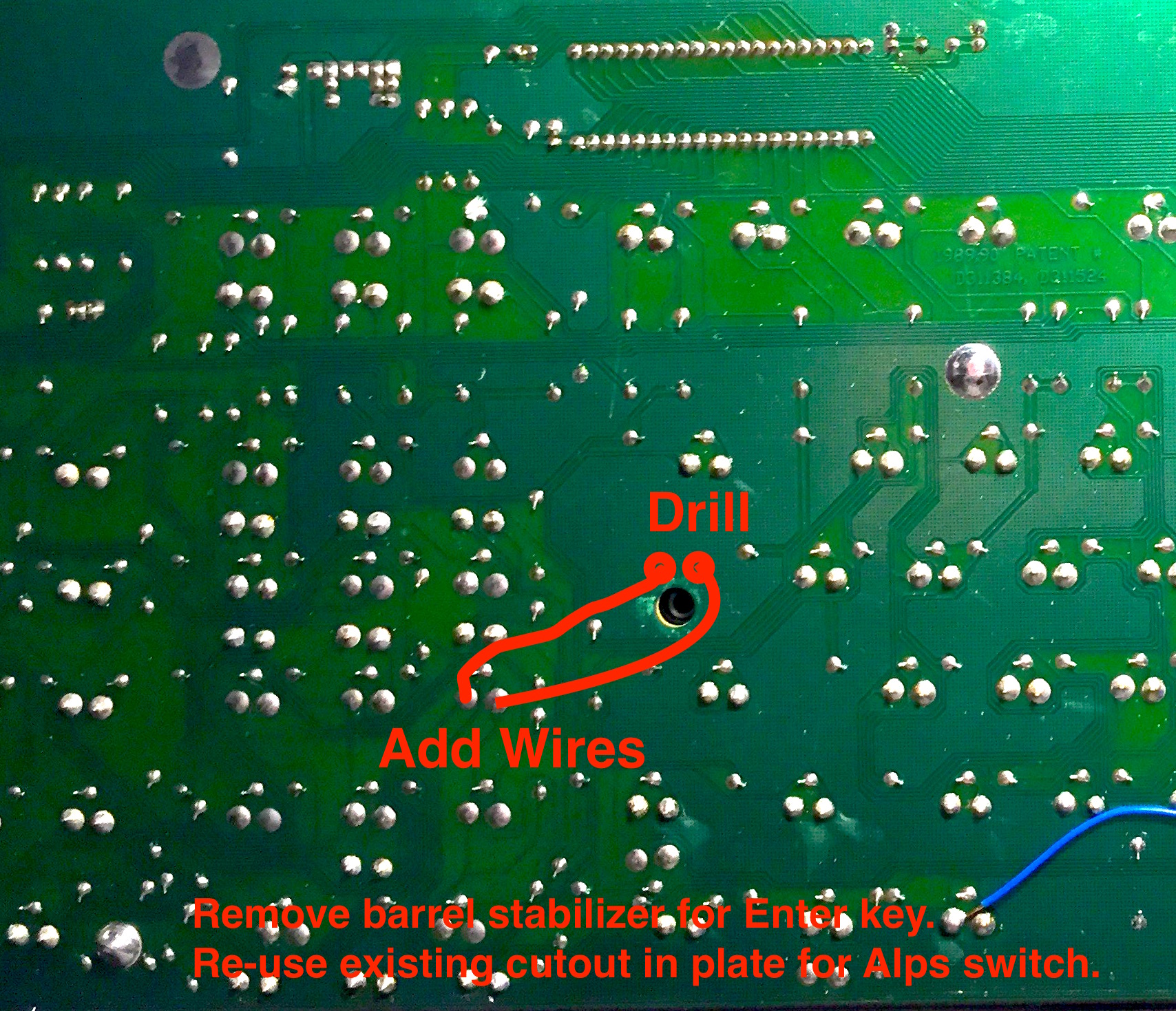

- XMIT
- [ XMIT ]
- Location: Austin, TX area
- DT Pro Member: 0093
Oh, perfect, thanks for providing a great shot of the rear of the PCB. I've been thinking about a modification to this board for a while and it looks like it is very doable.
I *HATE* the Big Enter key on this board. Everything else about it is nearly perfect. I have one here that is in okay condition but could be magnificent after a nice restoration.
If you remove the Big Enter key you'll find a barrel stabilizer right where the switch for the \| key should go. Lo and behold, that stabilizer - and the cutout in the switch plate for it - are exactly the right size for an Alps switch. I confirmed this over the weekend.
Moreover, since the Ultra and the Ultra-T appear to share the same PCB, it looks like there are a number of unused switch positions right around the arrow cluster that we could tie a new switch into.
Finally, even though there are no leads for an additional switch, it does look like the barrel stabilizer is only surrounded by ground plane (on the rear of the PCB). Before actually doing this I would need to confirm what the front side of the PCB looks like to make sure there are no interferences (or at least, nothing I can't otherwise rework).
A photo would help here.
If I'm going through this much trouble, I would also replace the controller on the board, and install either Soarer's Controller or (more likely) TMK on the thing. That would let me map the top keys to Fn and the side keys to programmable macro keys.
Hmm... I think I know what my next project is...
