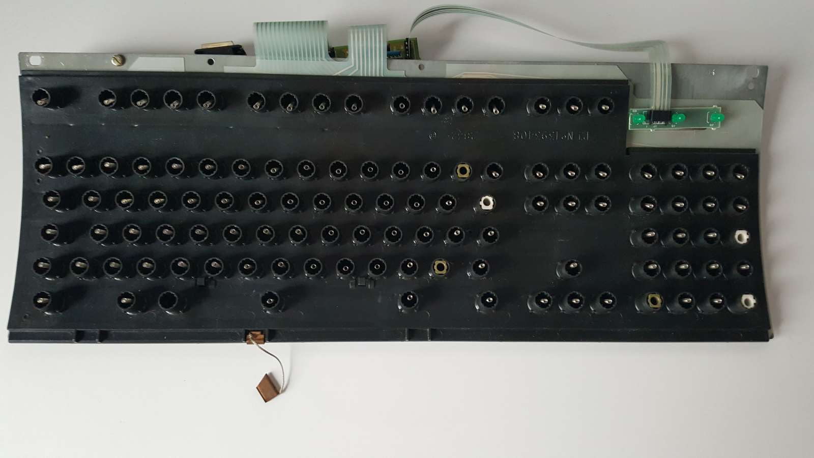

Stabilizer insert requirements for full size ISO Model M keyboards:
3 vertical (white on my Greenock board with black barrel plate, bright blue on my Mexican board with pearl barrel plate):
Enter: in the top position and rotated 180° from those on the numpad, where | \ is on ANSI
Numpad Enter
Numpad +
3 horizontal (olive green on my Greenock board, white on my Mexican one):
Backspace
Right shift
Numpad 0
By deduction, an ISO SSK needs 1 vertical, 2 horizontal.
Numpad Enter
Numpad +
Backspace
Right shift
Numpad 0
giokkk
- Location: Rome, Italy
- Main keyboard: IBM 3101, Model F AT, XT
- Main mouse: Microsoft intellimouse
- Favorite switch: Beamspring
It should be something like this (taken from a picture posted here a while ago)Darkshado wrote: Stabilizer insert requirements for full size ISO Model M keyboards:
Numpad Enter
Numpad +
Backspace
Right shift
Numpad 0
- Stabilizzatori 6 per IBM ISO MF.jpg (82.09 KiB) Viewed 8447 times
