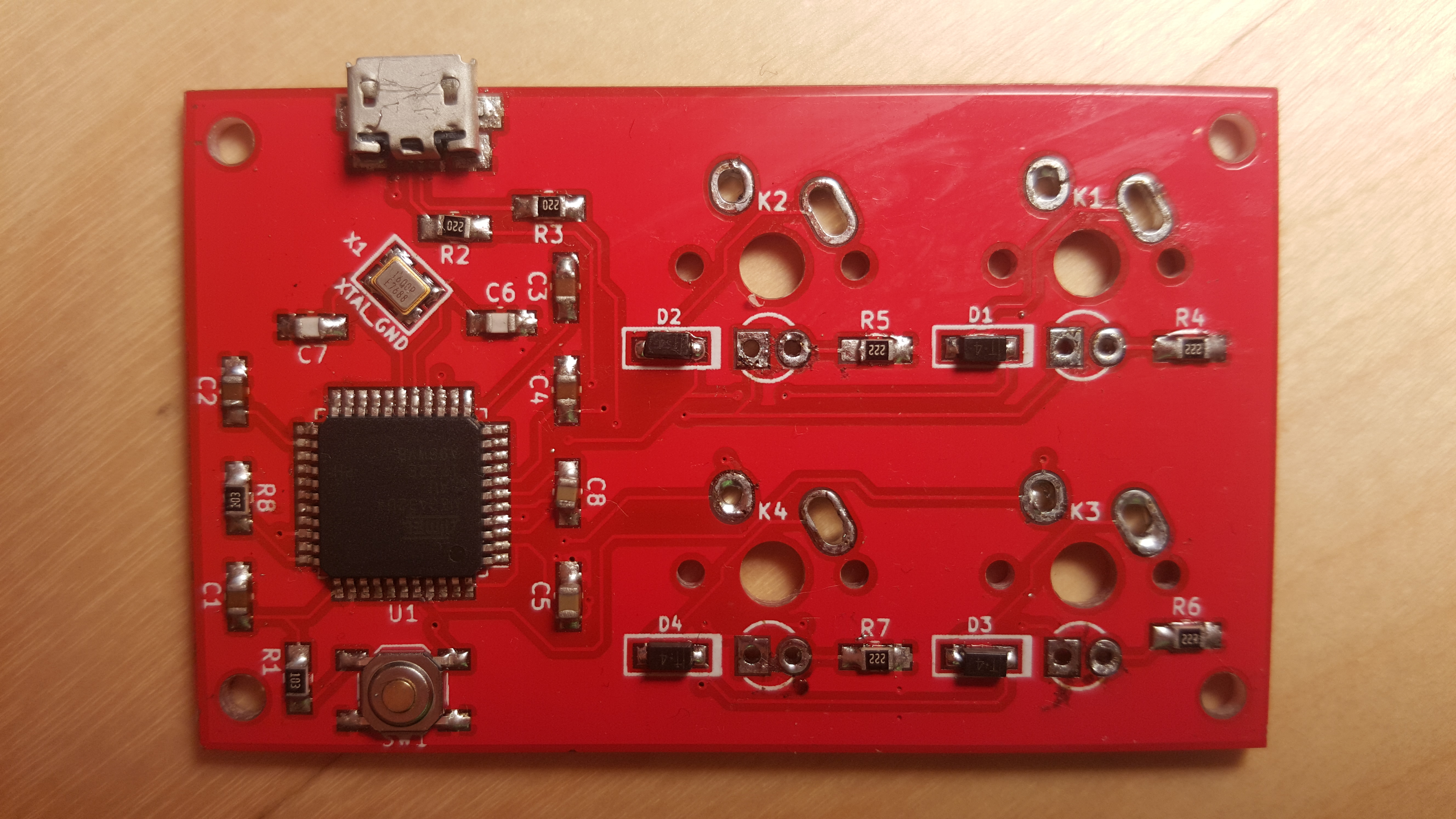

New to the forum, was talking to the guys from 1up keyboards at makers faire yesterday and they suggested I post here, so here I am. So to make a long story short, I figured I'd take a stab at designing a pcb and making a small keyboard.
I followed this guide here: https://github.com/ruiqimao/keyboard-pcb-guide and created a PCB based on his tutorial, with the addition of LEDs and a couple small component changes (swapped the mini usb for a micro). I had the PCBs made by PCBWay, ordered the parts, and reflow soldered all the components using a skillet. The temp I went up to was about 280F give or take since I didn't have a temperature probe that could go above 225F.
After reflow I touched up the pins on the ATMEGA32u4 that had bridges, everything else looked great under my microscope. I plugged it into USB to test but my computer didn't detect any devices. I started probing around the board with my multimeter to check for issues I might have missed... everything checked out continuity wise, no grounds seemed to be connected to VCC or anything like that but, with power applied, if you probed any VCC pin you only get 0.6v instead of 5v. If you leave it connected to power, the chip also starts to get hot. (Also if you take the chip off the board and apply power, the proper 5v can be measured to all VCC pins.)
I was wondering if anyone could help me diagnose this issue I'm having. I tried 2 different chips on the same board and also put together a second board and tried a third chip there just for good measure. I'm just not sure how to go about figuring this one out. Any help would be greatly appreciated and if needed I can upload my kicad or gerber files so you guys can take a look.

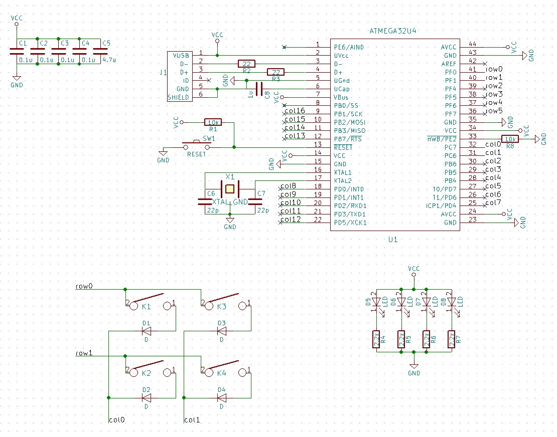

The schematic is mostly the same as whats on the tutorial, heres a screen shot of it
- schematic screenshot
- kbd schematic.jpg (262.91 KiB) Viewed 4032 times

seems like you need to... REVERSE THE POLARITY!
seriously. your power line is shunted to 0,6 volts. 0,6 volts is a quite credible value for a voltage drop on a diode. so it is reasonable to assume you are shunted through a diode. if you remove the "chip" (I assume you mean the microcontoller), the shunting goes away too. so it is likely the diode performing the shunting is in the microcontroller. it would make little sense for a microcontroller to shunt it's power supply during normal operation - on the other hand, it would make a lot of sense for a microcontroller to shunt it's power to protect it's circuitry if power was applied with the wrong polarity (+ and - reversed, fancily called VCC and GND here
verify the proper pins/pinouts in the datasheet of your microcontoller. then, with your voltmeter, check that when powering the board, the + indeed goes to the pin of the microcontroller expecting +, and - to the pin expecting -.
my hunch is, you either used a wrongly laid out (mirrored) USB connector footprint, which would in effect reverse polarity of the power lines (as well as probably the data lines too - but that cannot be observed yet since you don't have power to begin with). or the same for the microcontroller footprint. or you routed the power lines on the PCB to the wrong pins of the microcontroller (e.g. off by one - and since there's a lot of ground pins and protective diodes in modern microcontrollers, chances are you are triggering one). or you are soldering the microcontroller in in the wrong orientation.
double-check everything carefully, and I'm sure you'll find the problem quickly.

Crap, you're right. If only I read the datasheet for the usb ports I bought. Welp, you live and you learn and now I'll never screw that up again
To test I just took a usb cord and plugged one of the spare usb ports I had into it, probed it with my multimeter, and the pin that should have been vcc gives me -5v... So now I'll have to see if I can find a usb port that matches the footprint I used or respin the board, which fortunately was pretty inexpensive, so not the end of the world.
Thank you! I feel like an idiot now, but a slightly smarter idiot

Nope.... The footprint that was in the keyboard parts library I used is just completely backwards.... every usb port out there has the pins in reverse. I fixed the footprint and will just have to order new PCBs
