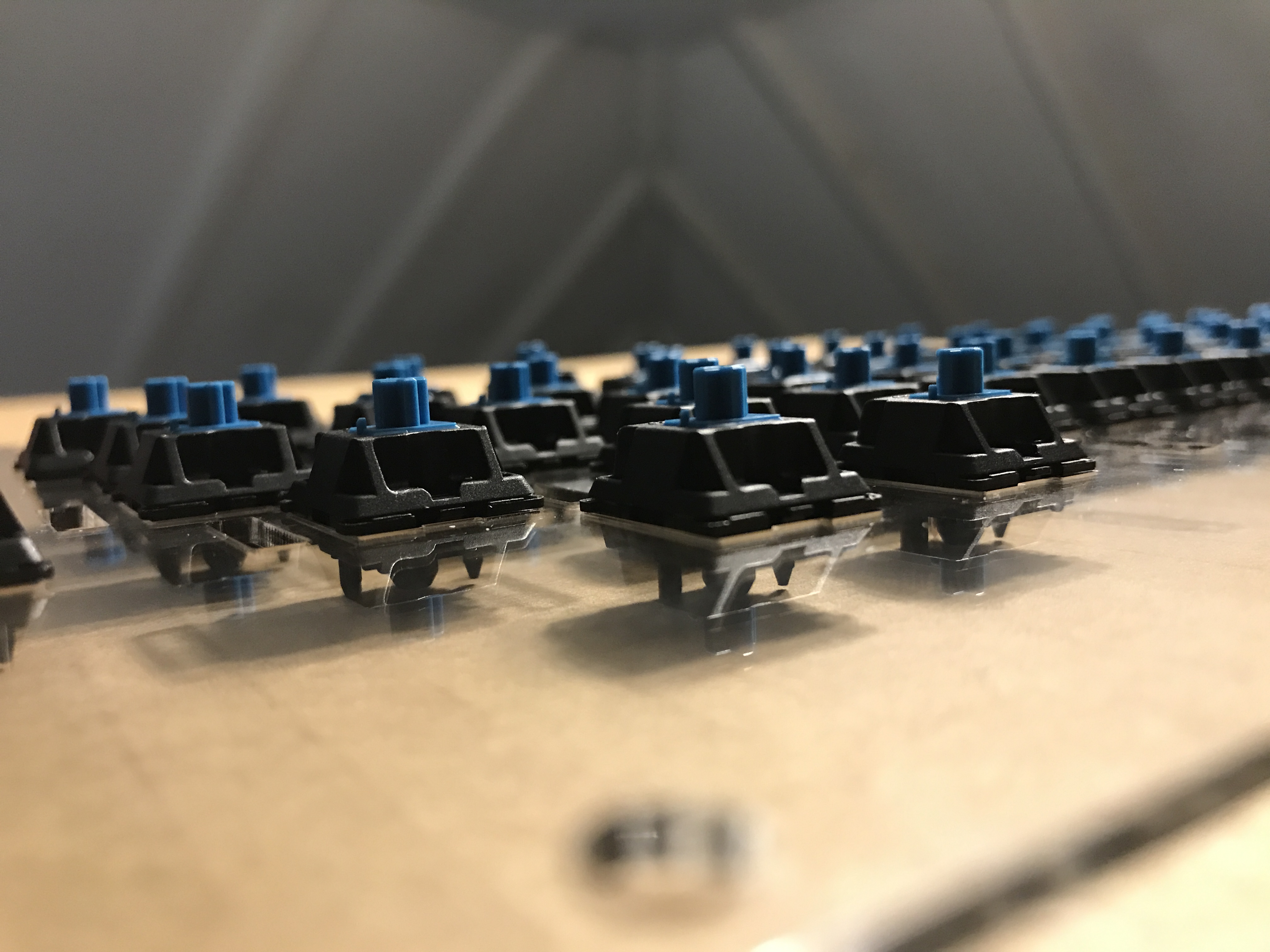

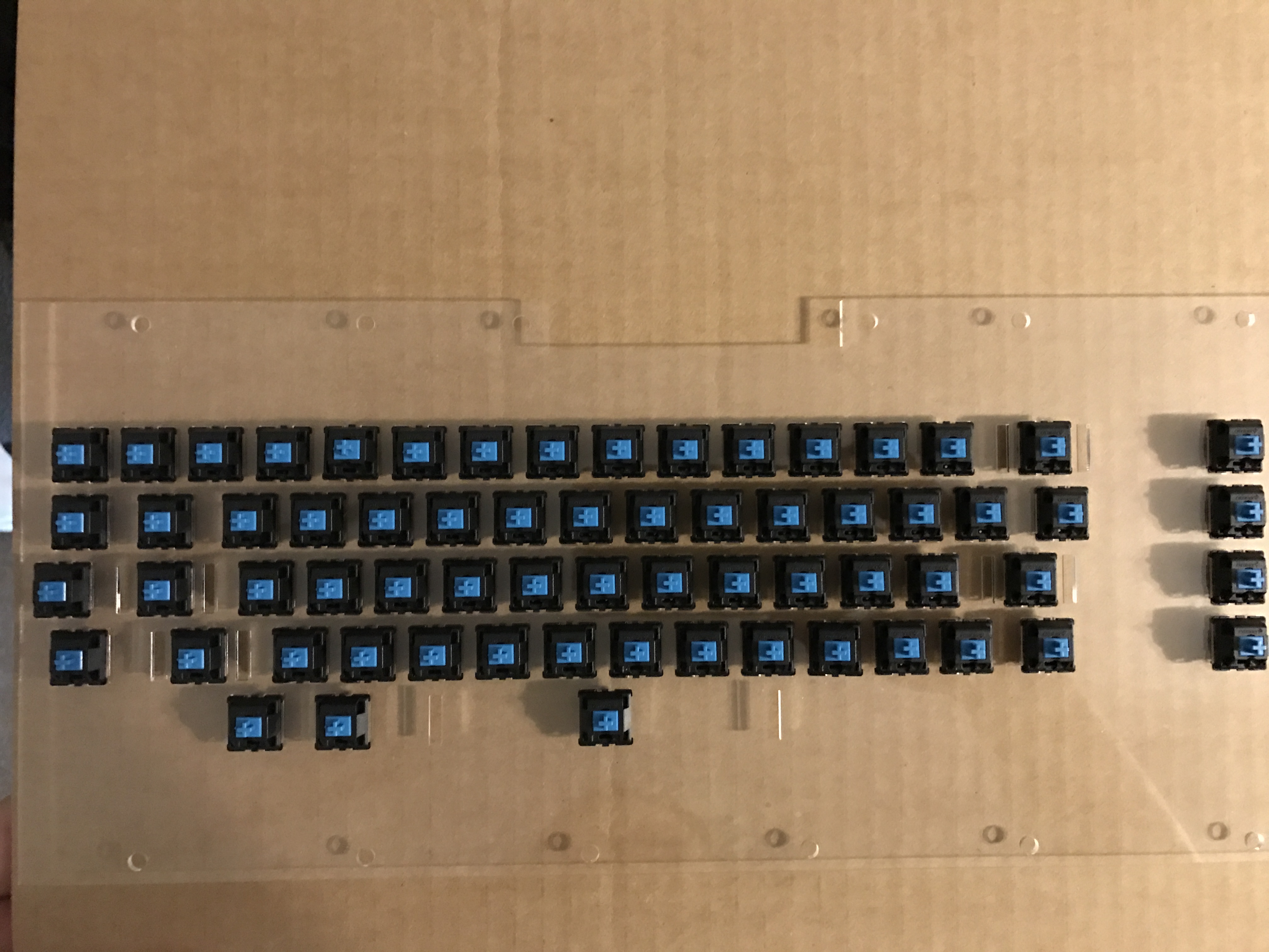

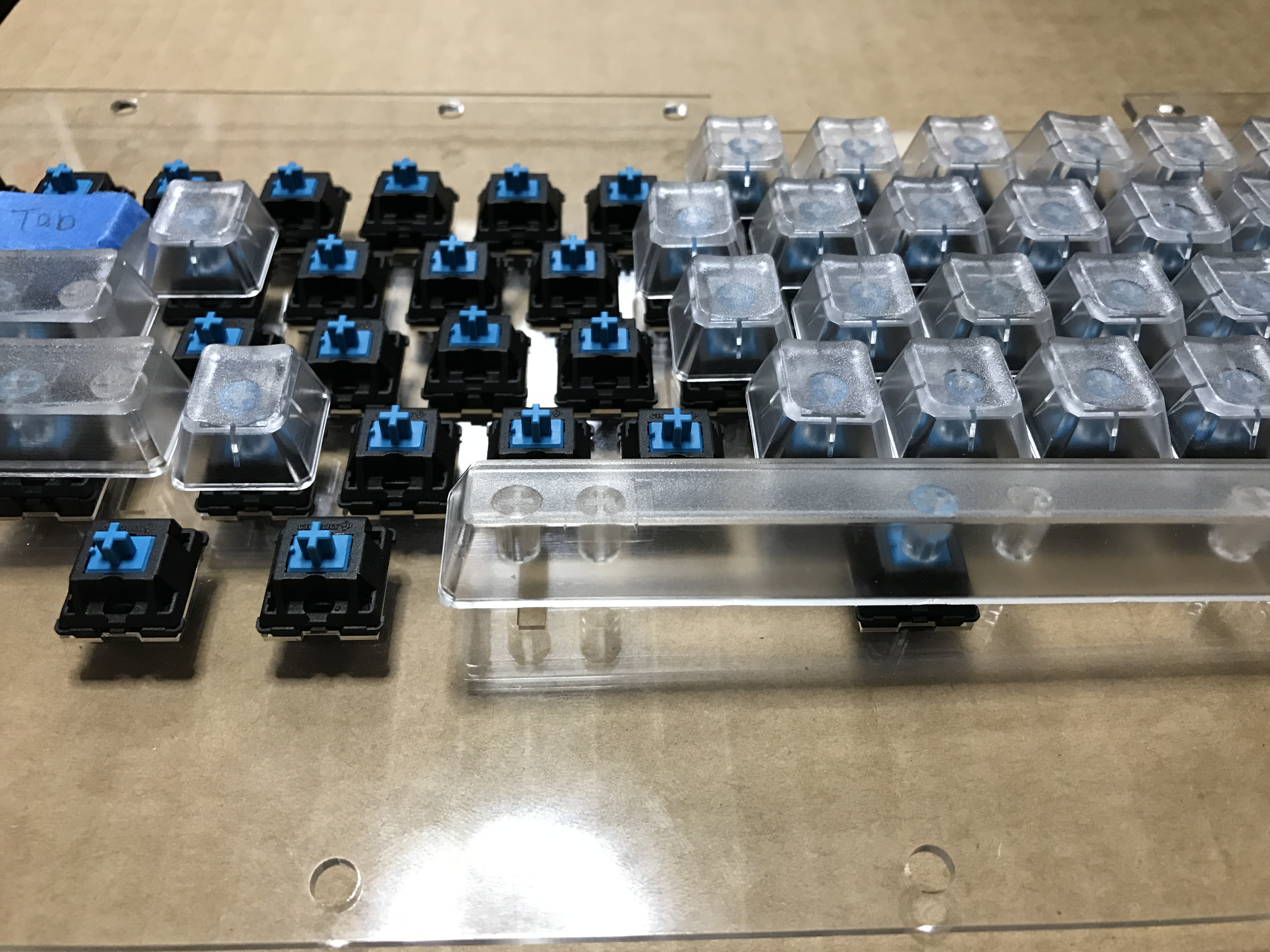

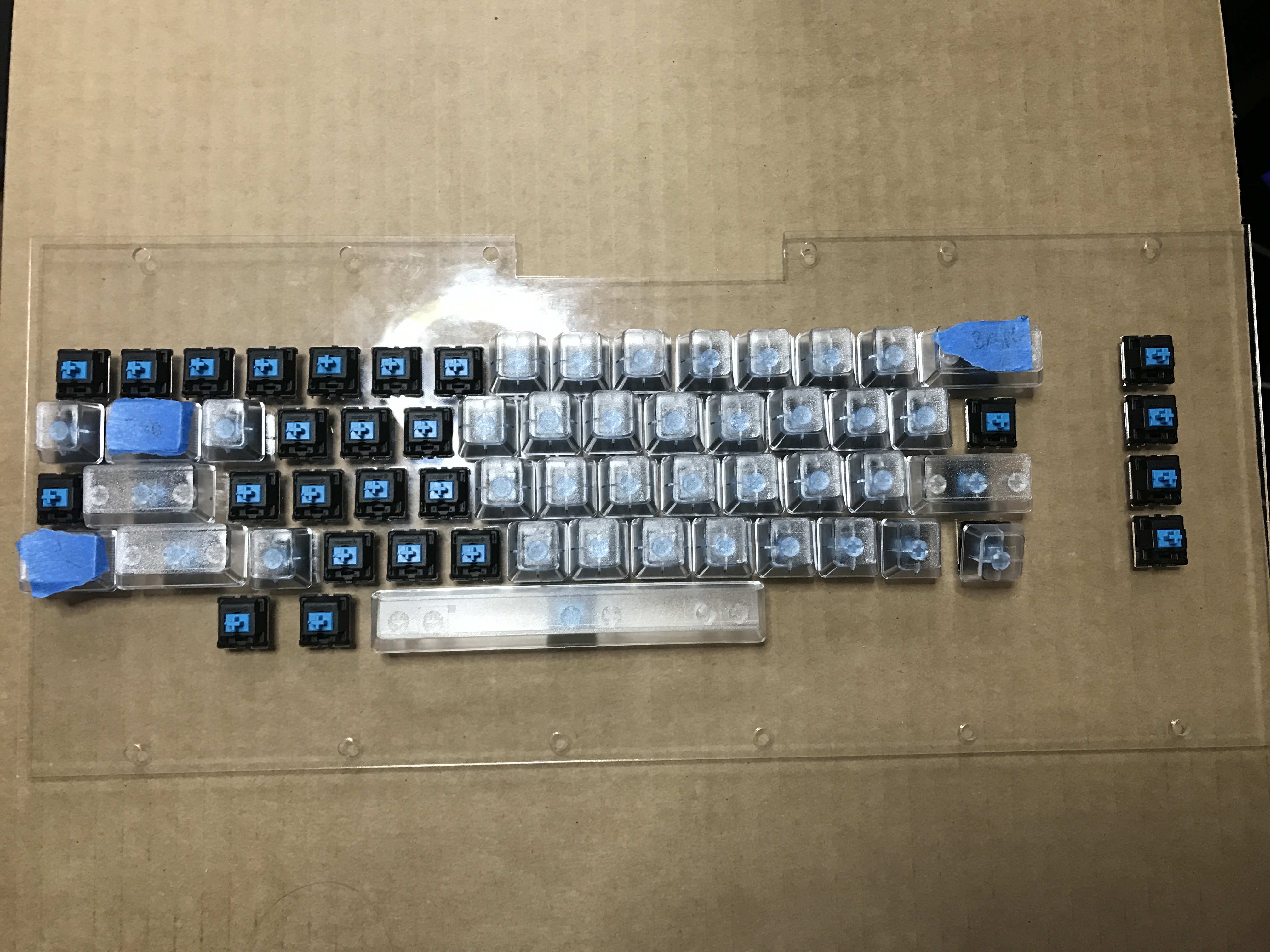

I received the acrylic prototype and I'm happy to say that all of the adjustments look and feel great. I've attached a few pictures of the plate with switches and switches+caps.
@iceberg, I'm def going to be choosing aluminum for my build. I'm waiting for my friend to get back from vacation so I can ask him to make me a few more. In the meantime, I'll search the net for a company like ponoko that can work with AL and possibly bend it for me as well.
Here are some pictures of the acrylic prototype with switches/key caps etc...

Yea, Acrylic isn't ideal because it doesn't bend well, and it flexes too much for typing.

@ riddleywalker, Any news? Were you able to get the bends in the Acrylic so it fits in the C64 case?
I've played with a few solutions for using the keycaps. The absolute best solution is SA Retro caps with Petscii, but those are all but impossible to get and when you can find them super expensive. It might be possible to get them redone from one of the new Chinese manufactures Massdrop is using but they would be PBT Dysub print if at all.
The next best thing is a semi-permenat or permeant mod the caps. This works better than the adapters and I haven't tried to model something and have it printed yet. What I did was take so ABS cherry caps can cut the sides off and glue them inside the C64 caps. Since I'm cutting them they are not all 100% straight but I'm using hot-glue so I can redo them till I get them close enough that you cannot tell. However with lots of typing the hot-glue tends to come undone. I may see what the price points with Signature Plastics would be for DSA Retro PBT Dysub with PETscii are and if it's worth doing an IC for a GB.
