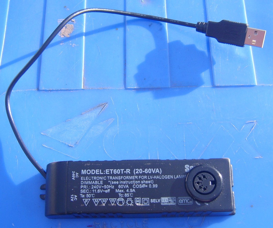

ThePillenwerfer
02 Dec 2018, 18:28
I certainly wouldn't like to trust them far. I boxed mine up in such a way that there's no strain/wiggling on the socket.
