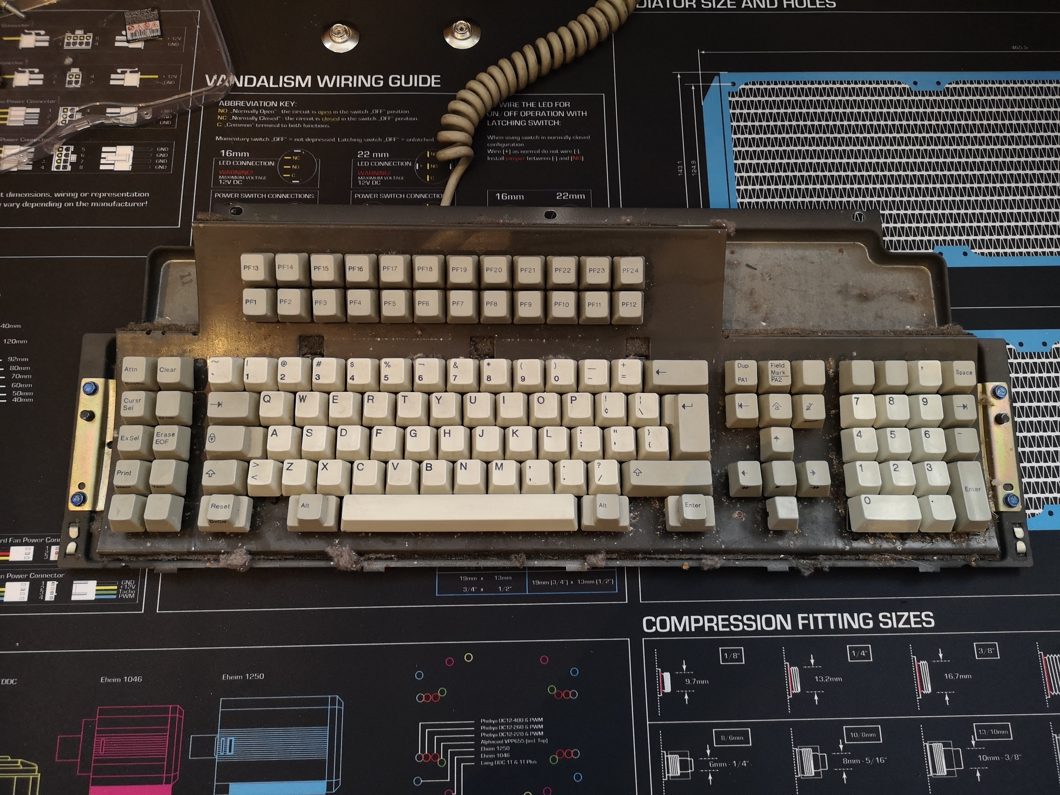

IBM Model F 122 Restoration
Fkazim
23 Jun 2019, 23:11

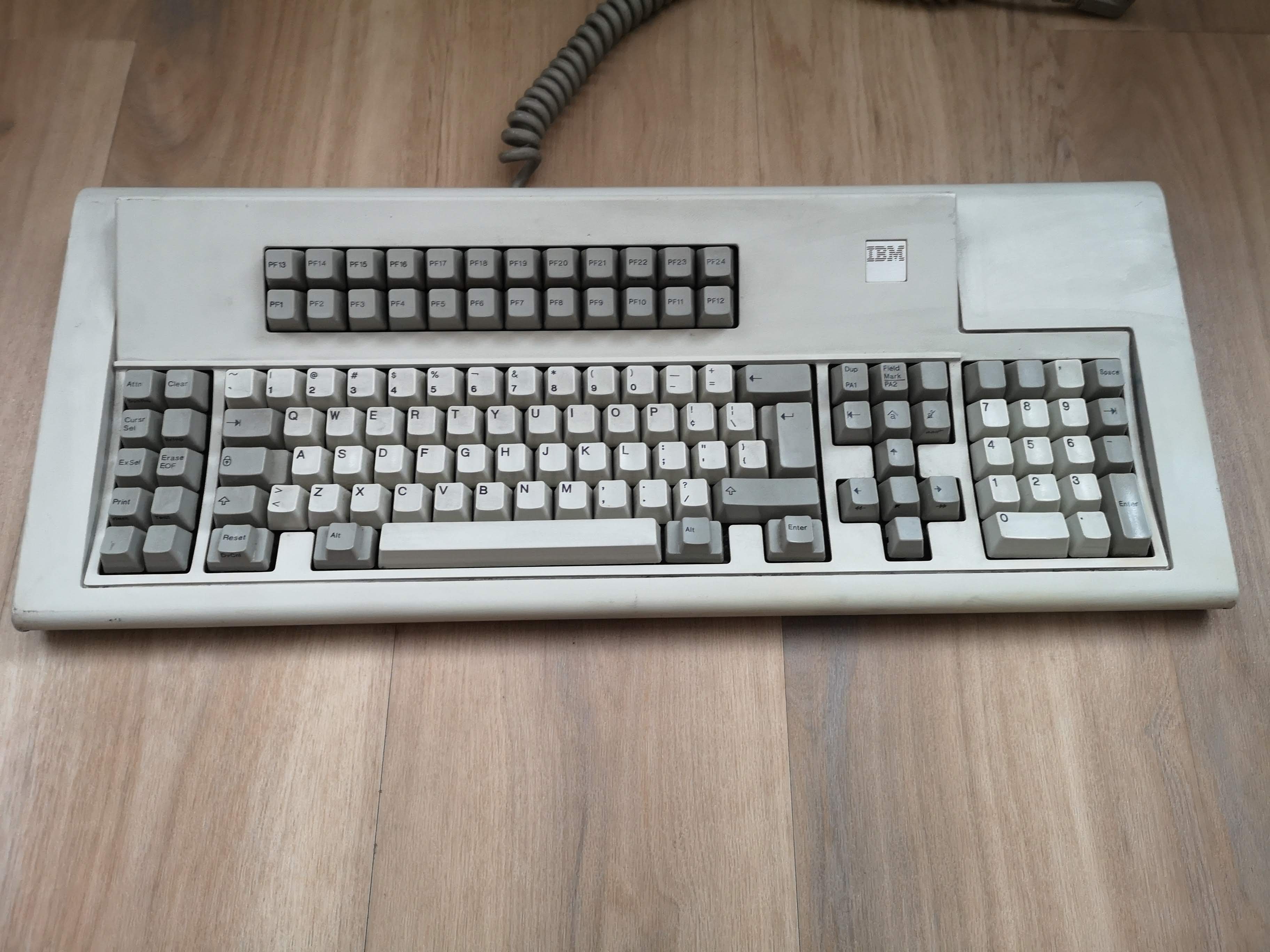

How the keyboard looked when I first got it.
Keyboard before restoration.jpg (466.51 KiB) Viewed 19698 times

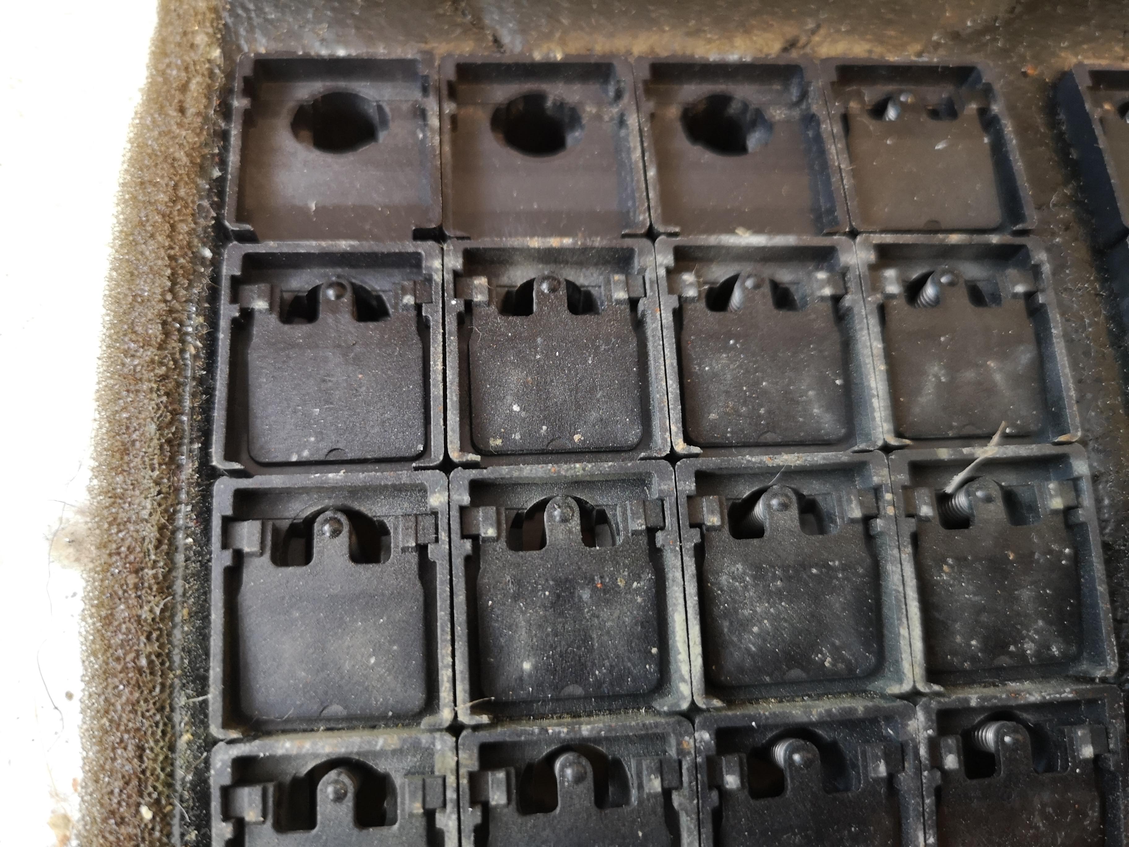

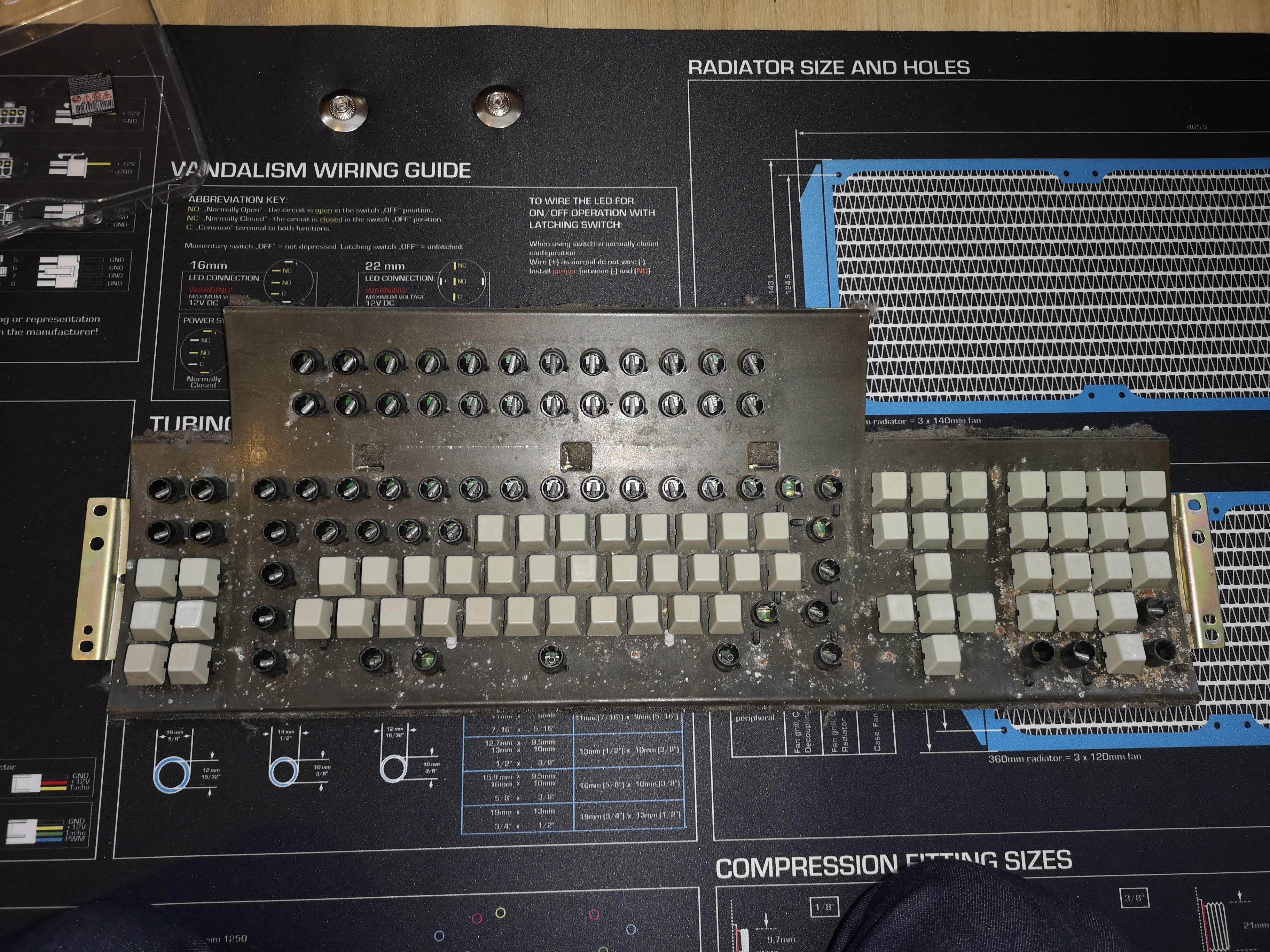

Key barrels and flippers very dirty.
flippers and barrels very dirty.jpg (1.05 MiB) Viewed 19698 times

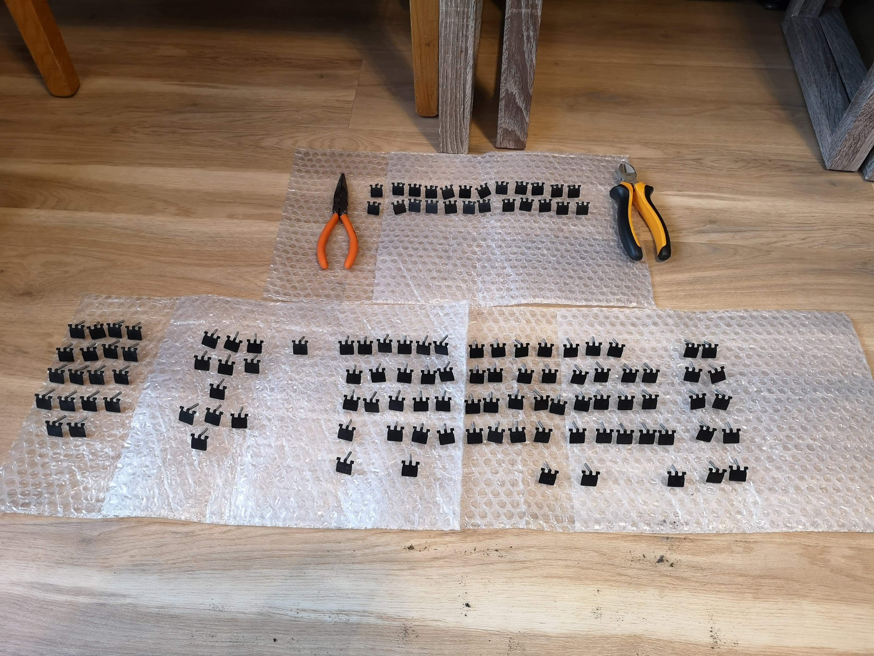

Starting to remove all key barrels and flippers.
starting to remove all key barrels.jpg (1.22 MiB) Viewed 19698 times

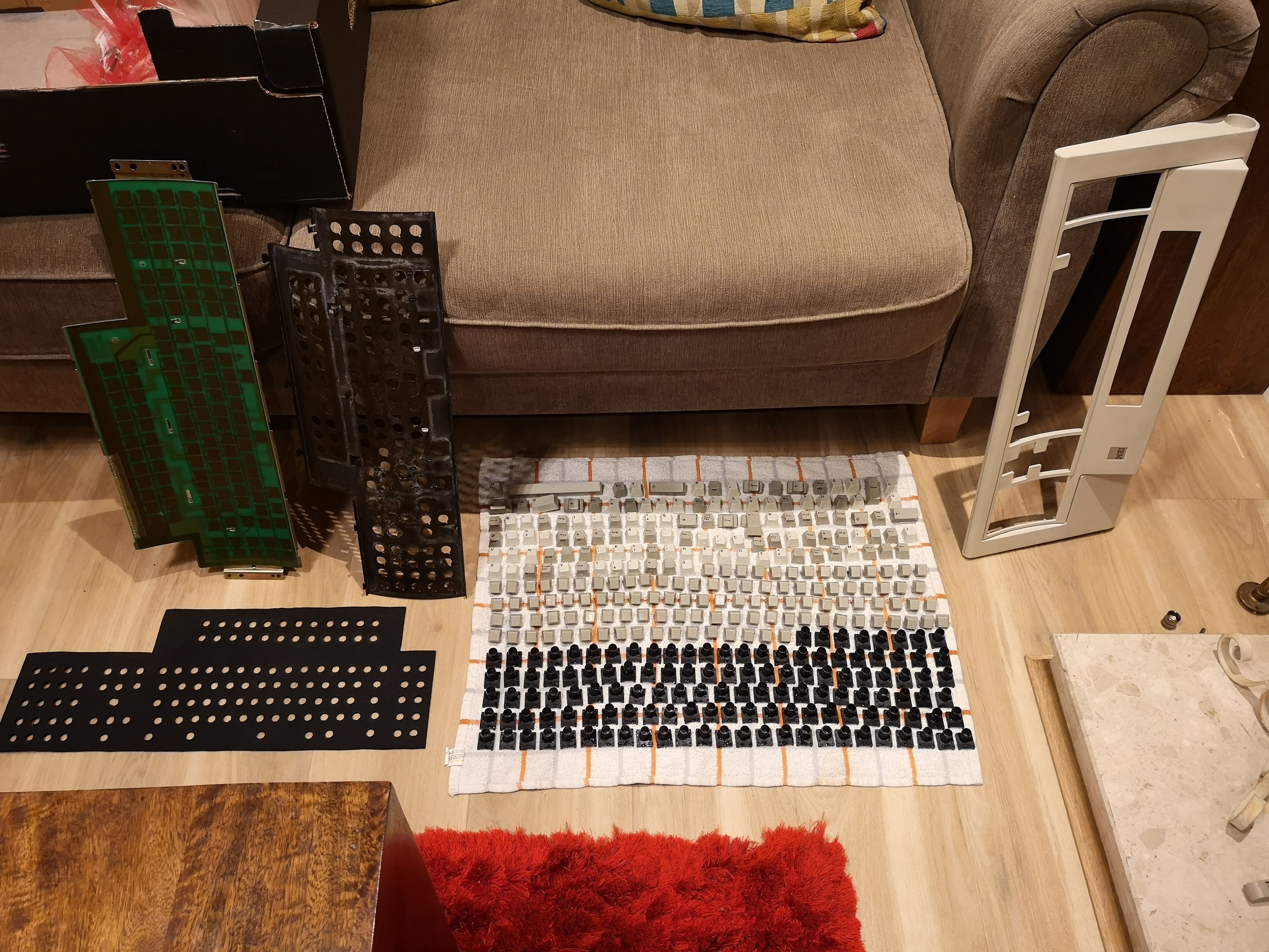

All flippers and key barrels removed.
all flippers removed and nicely layed out.jpg (1.95 MiB) Viewed 19698 times

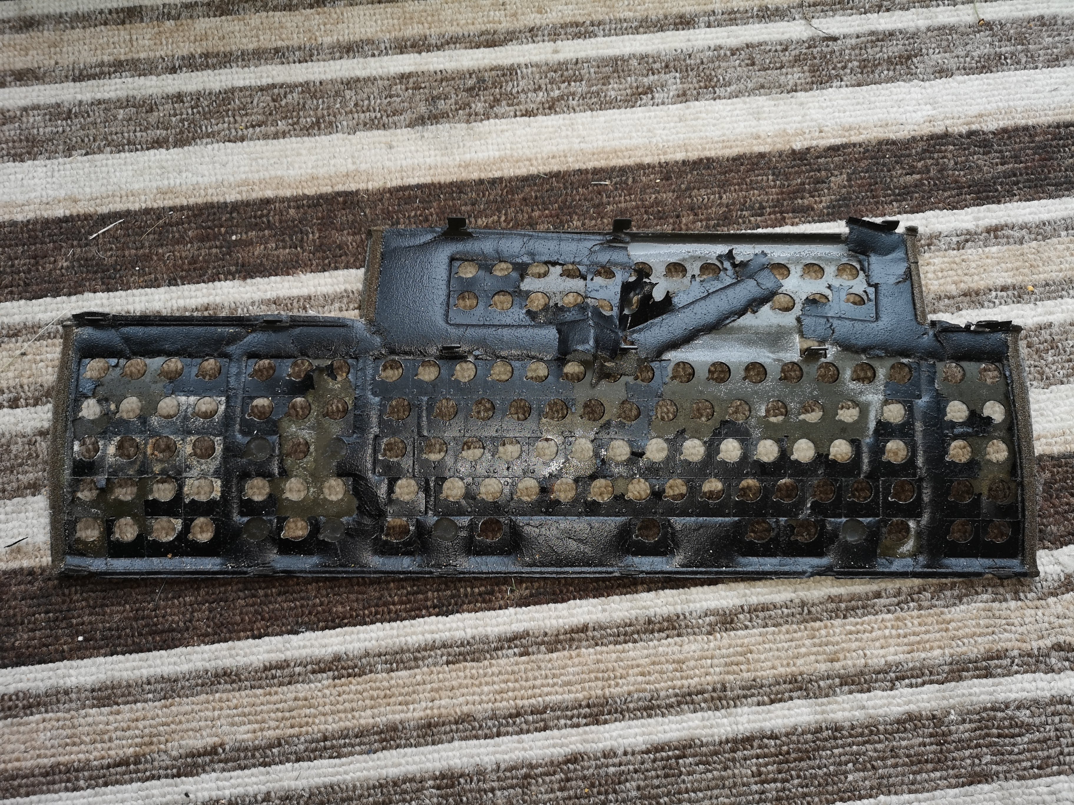

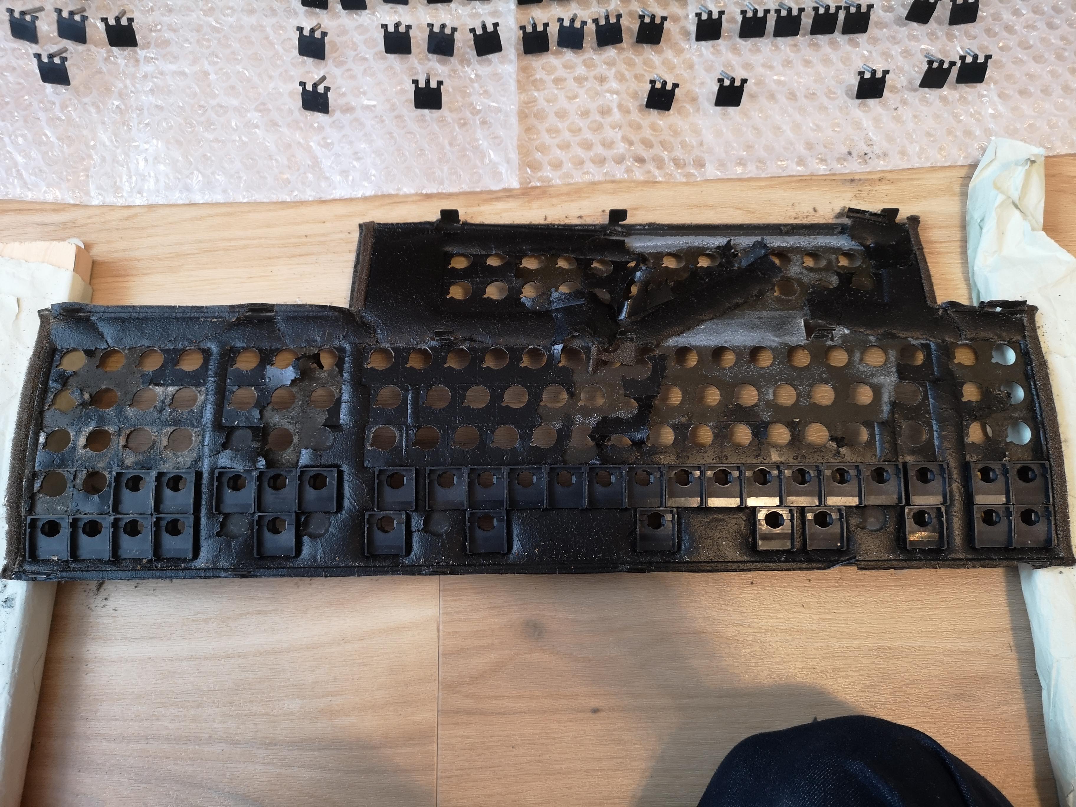

Foam in terrible condition.
Foam is in terrible condition.jpg (2.52 MiB) Viewed 19698 times

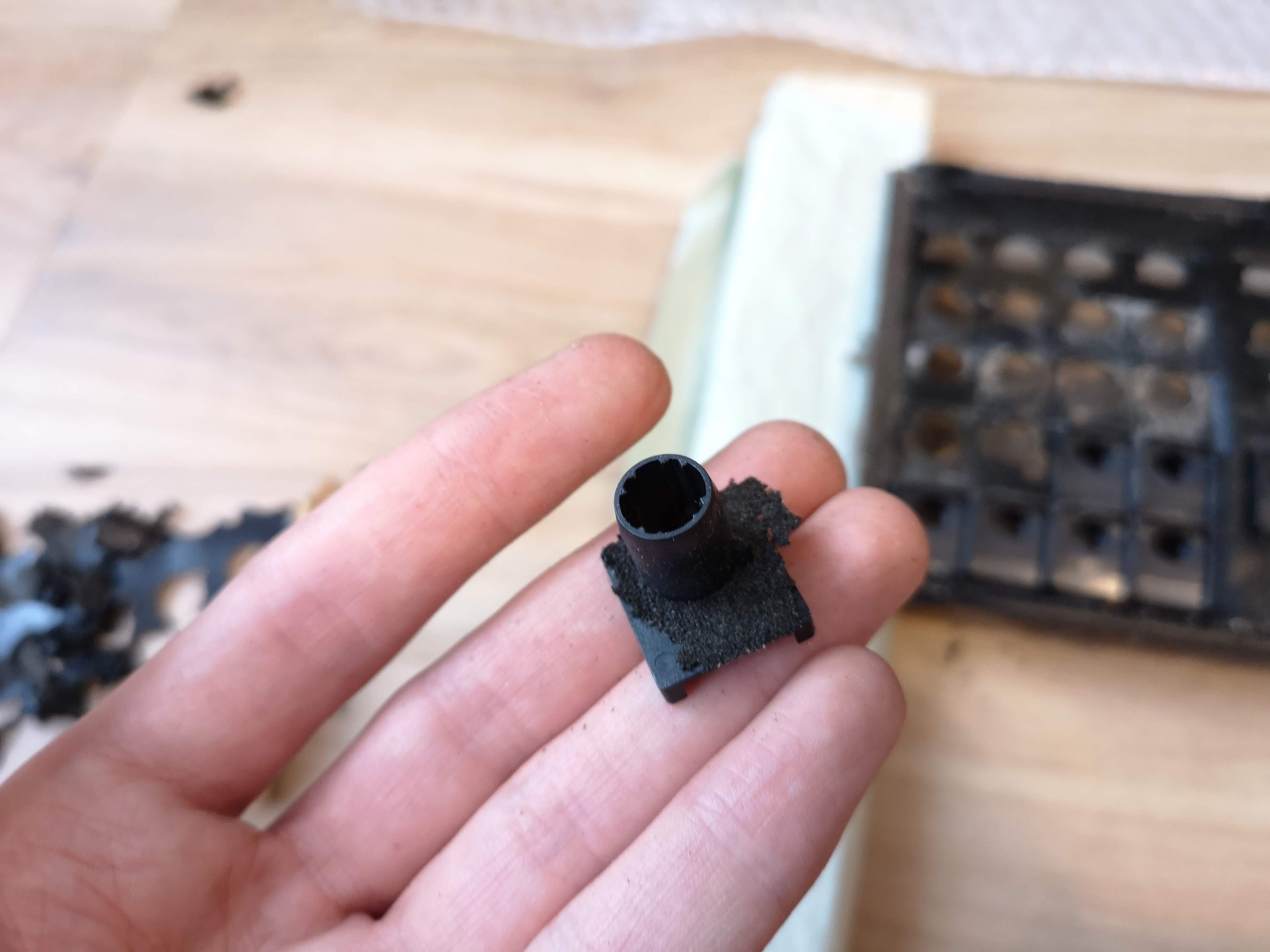

Close up of foam stuck on one of the key barrels
close up of one of the flippers with foam stucked to it.jpg (251.43 KiB) Viewed 19698 times

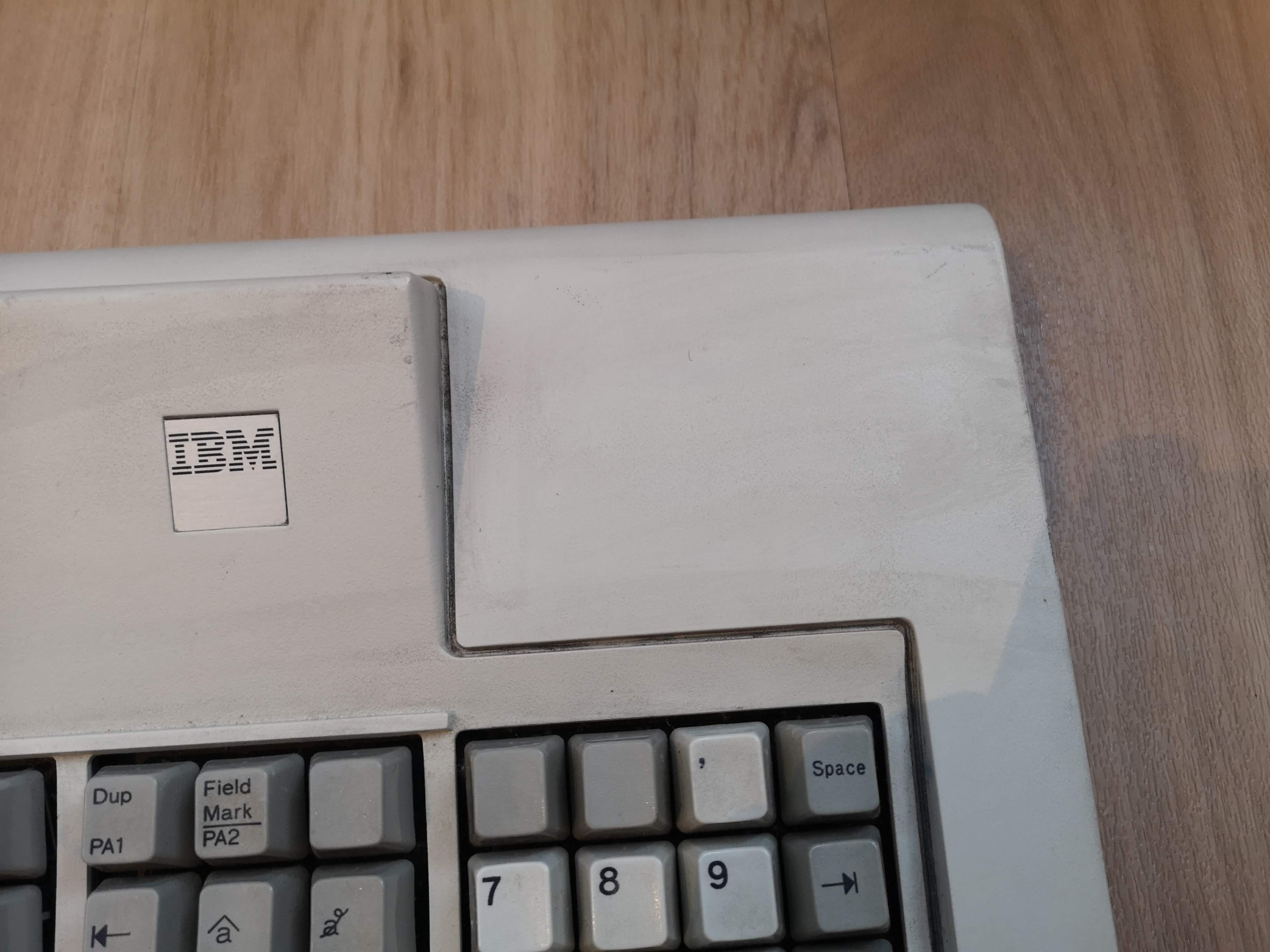

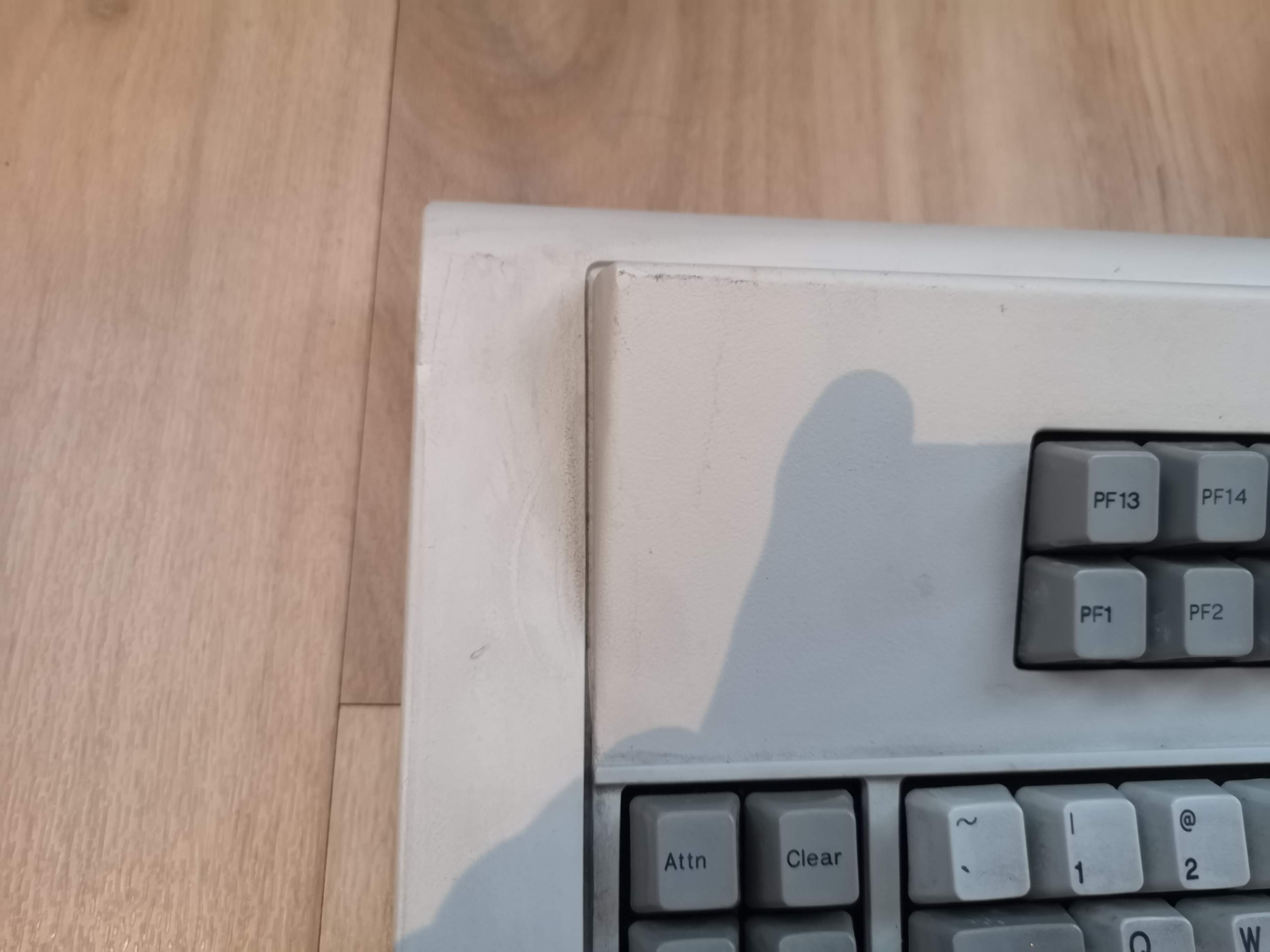

Few close up's of dirt on the top case.
close up of dirt 1.jpg (363.32 KiB) Viewed 19698 times
close up of dirt 2.jpg (369.41 KiB) Viewed 19698 times
close up of dirt 3.jpg (234.14 KiB) Viewed 19698 times

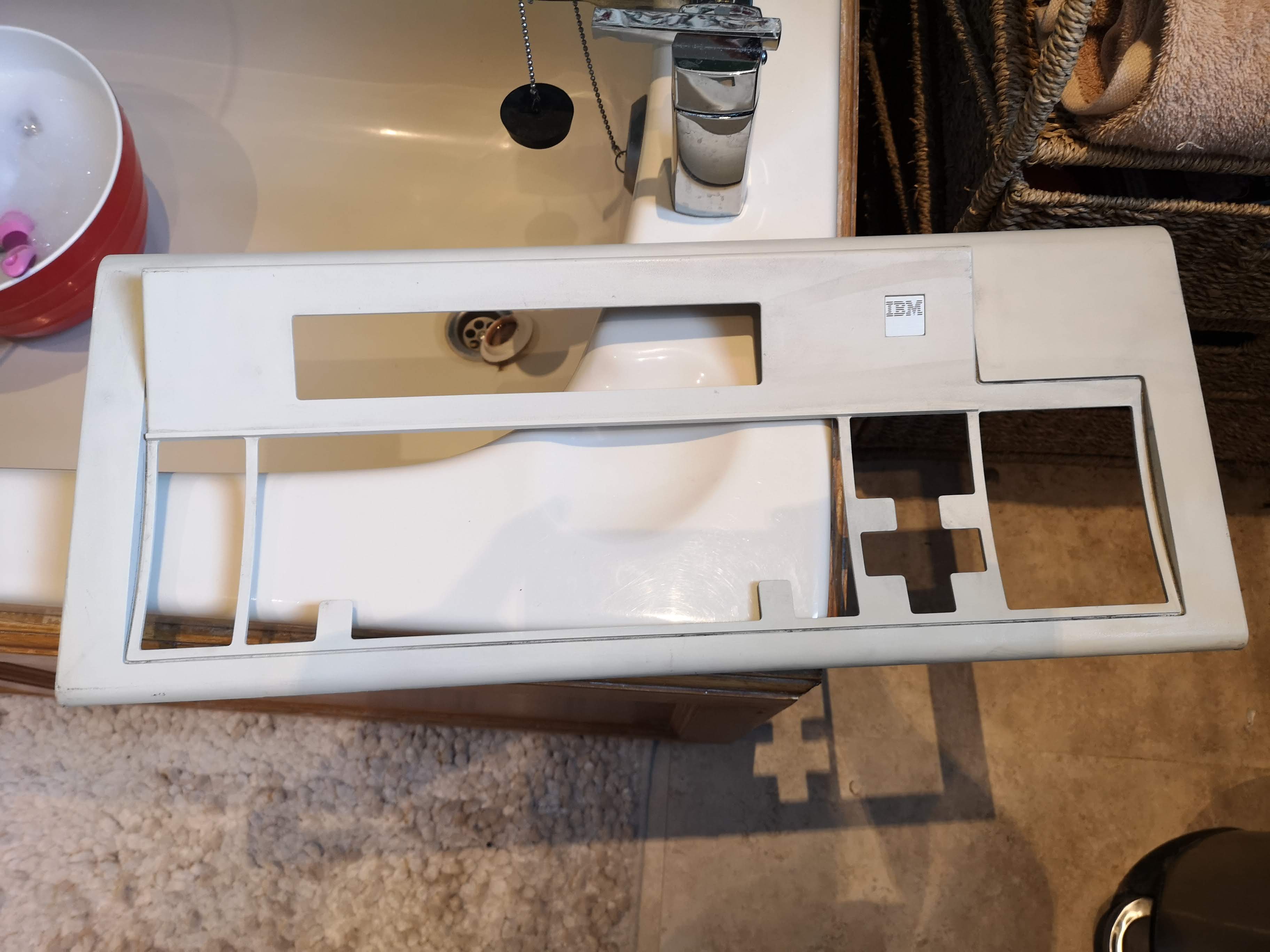

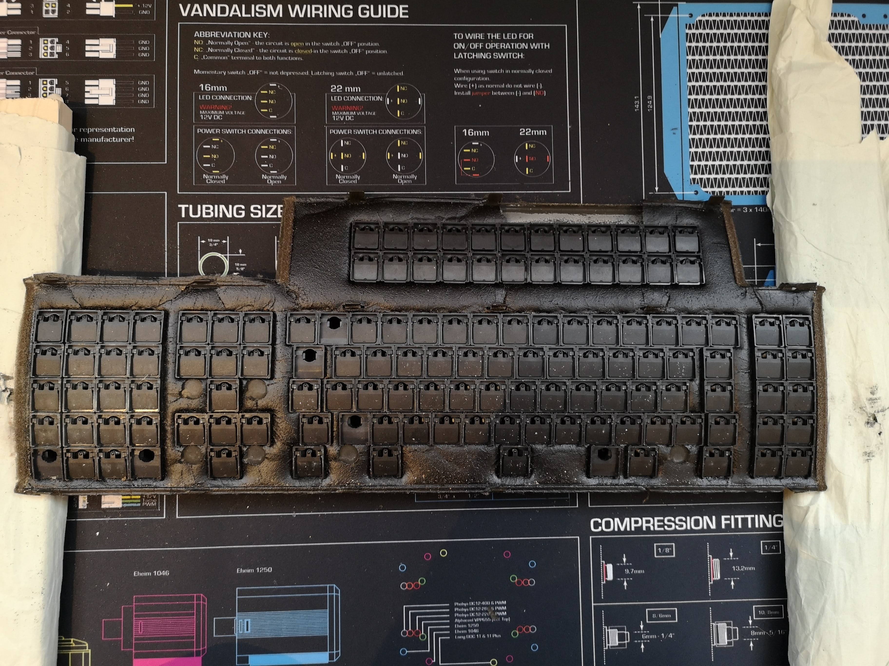

Getting ready to clean the top case.
Getting ready to clean up top case.jpg (399.28 KiB) Viewed 19698 times

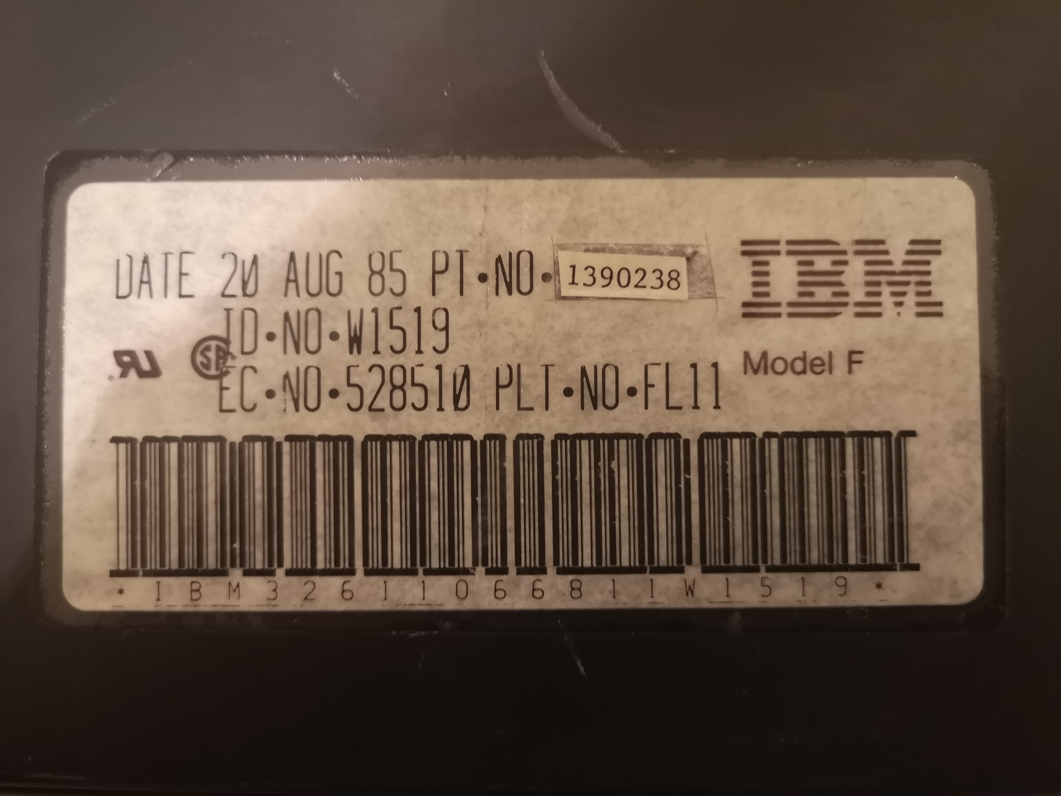

Close up of back label.
Close of back label.jpg (1.58 MiB) Viewed 19698 times

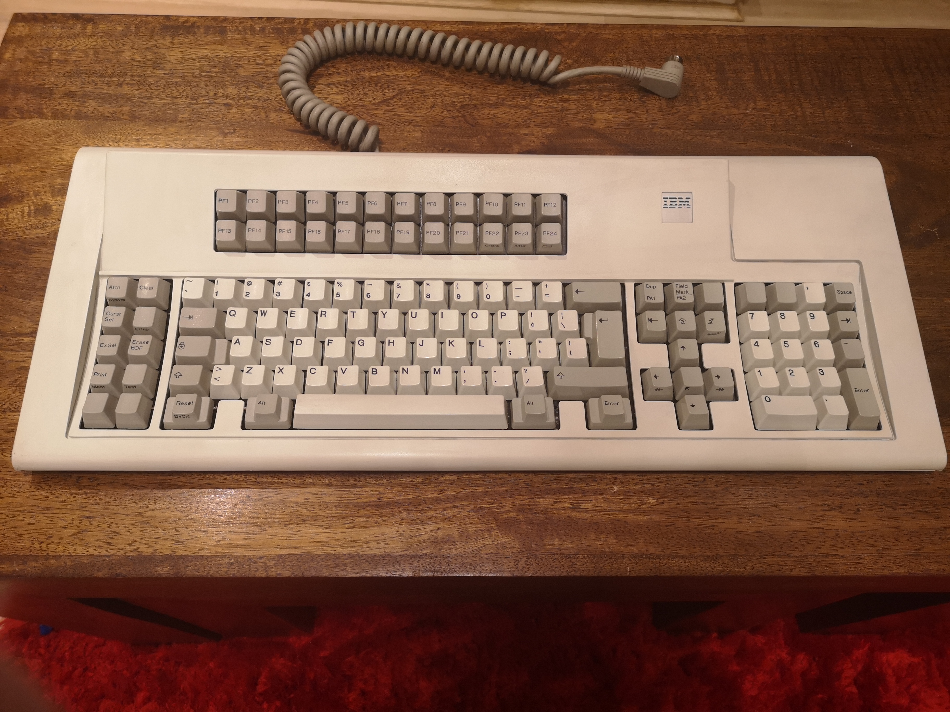

The keyboard fully restored.
image fully restored F122.jpg (2.87 MiB) Viewed 19698 times

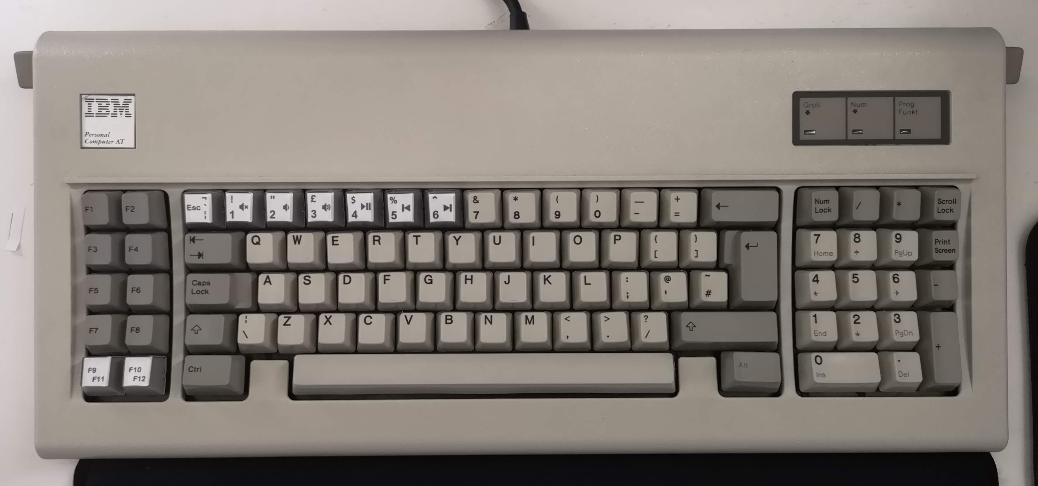

I also use an IBM Model F but not the F122 I use an IBM Model F AT with a modernised layout as my daily driver. Here is a picture of my daily driver not sure if I will switch to the F122 as my daily driver just because of the sheer size.
modernised AT.jpg (188.99 KiB) Viewed 19668 times

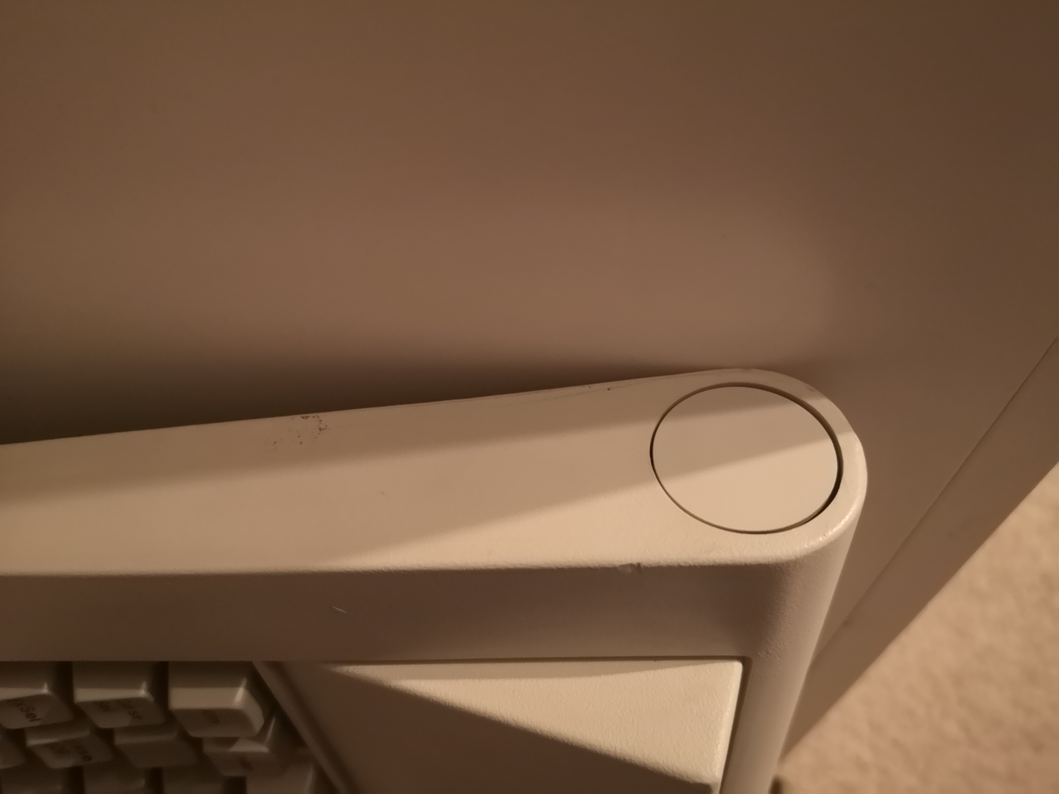

Also side note not sure if this is unique but the flip out feet buttons on my keyboard are white like the rest of the case whereas all the other F122's I have seen online have grey buttons just thought it would be worth pointing out below is an image showing this.
flip out feet buttons.jpg (1.23 MiB) Viewed 19542 times
24 Jun 2019, 02:52
I noticed that in the video. Definitely an interesting unit.

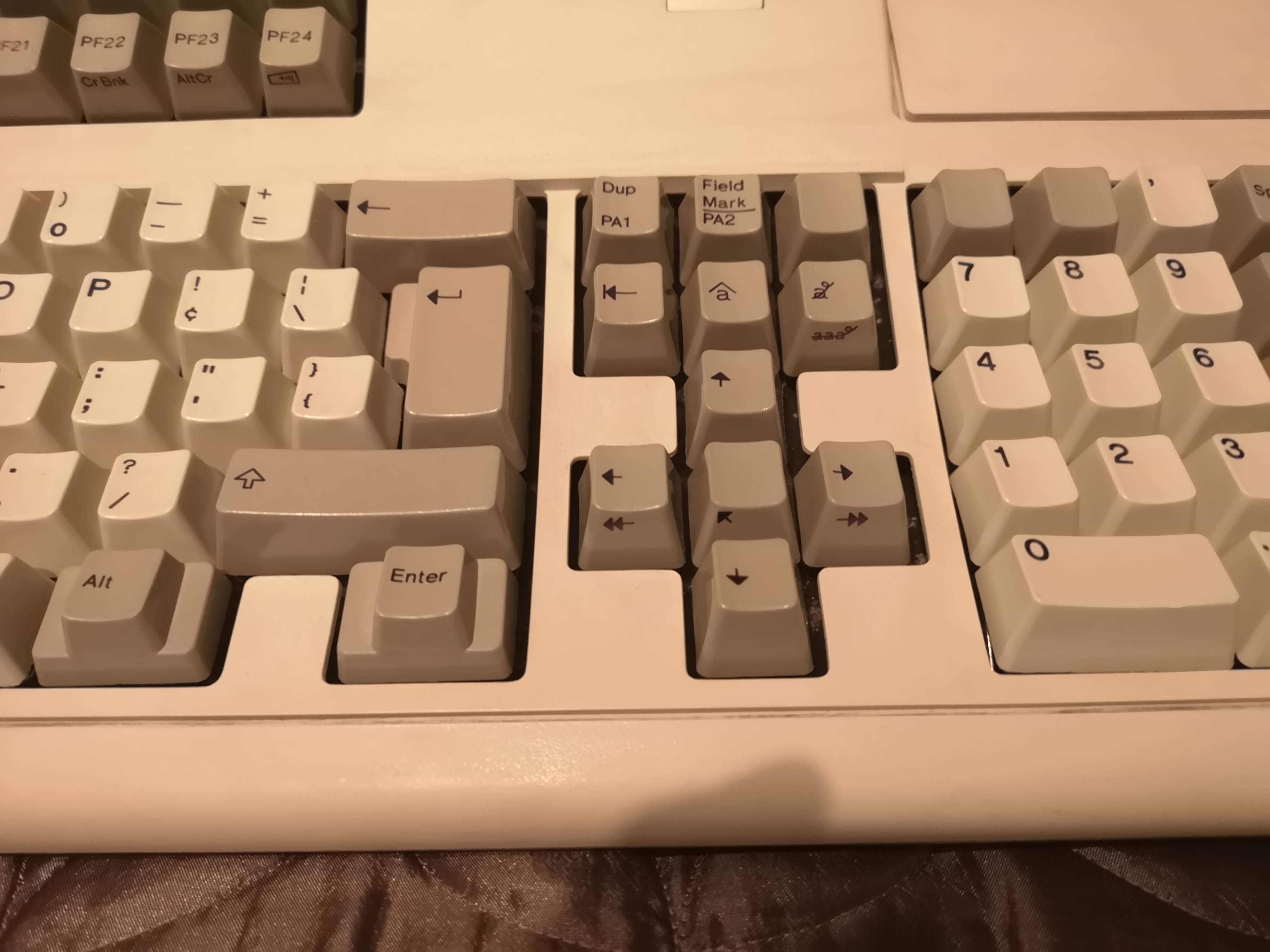

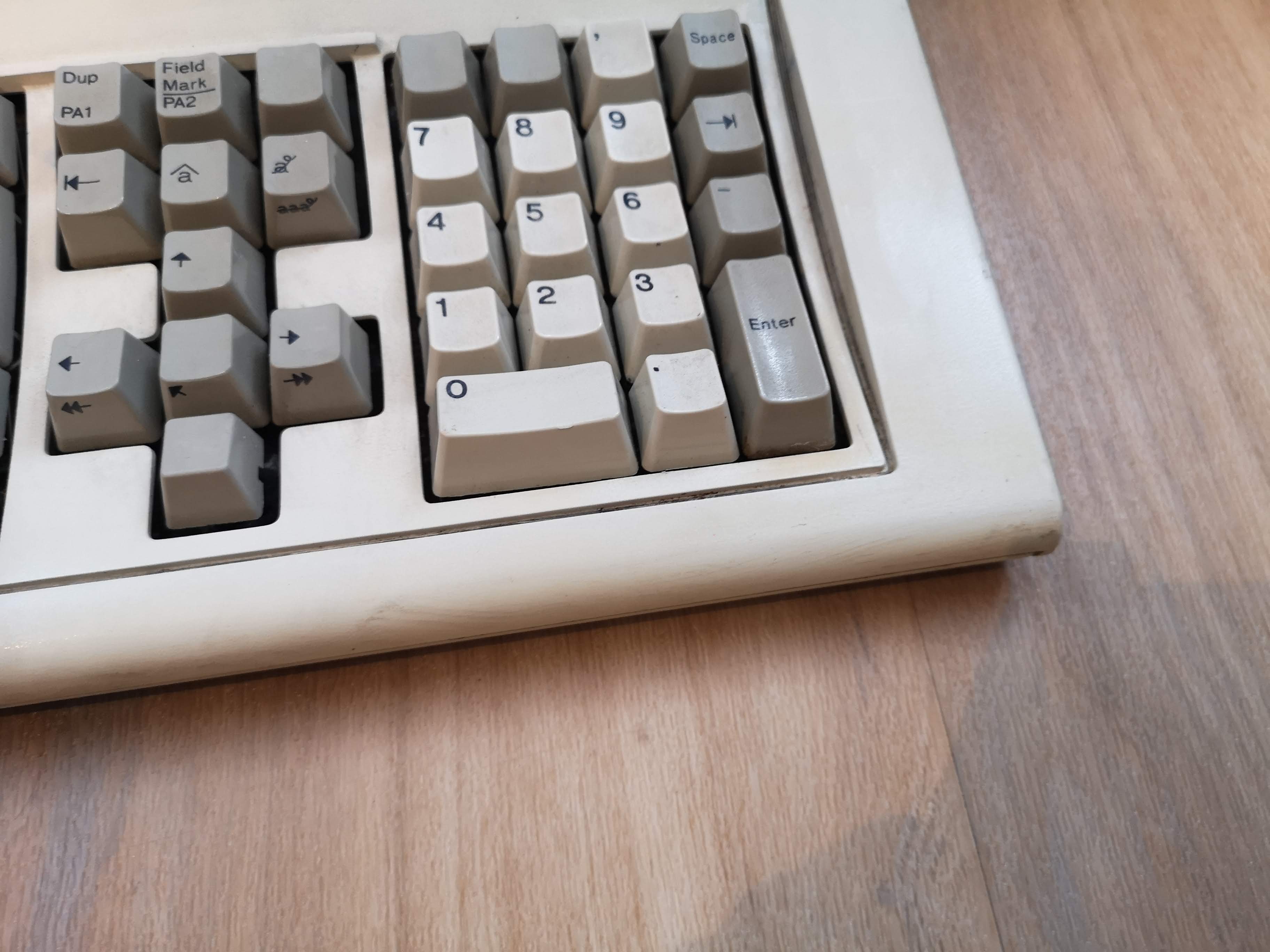

Also what is up with that key in the middle of the arrow keys never seen that before also all my function keys are labbeled PF1 to PF24 where as most of the the other ones I have seen online have CMD1 to CMD24 is that something else of relevance to what terminal this keyboard came from?
Below is an image showing what I am talking about.
arrow keys.jpg (1.31 MiB) Viewed 19530 times
24 Jun 2019, 03:25
Depends on what the terminal was supposed to be used with - some battleship keyboards (be them F122 or M122 or... gasp... off-brand) had Cmd1..24 keys, others had F1..24, or PF1..24; some had blue legends on top, some had pront-frinted legends of differing sets. What we now call EF9 sometimes had a "Setup" legend in blue. Your keyboard has a "space" key on the numpad (while most other battleships and battlecruisers have a "Field -" legend there). Mine didn't have a comma key on the numpad (and I had to buy one from Cindy); yours does.
There's dozens, if not hundreds, of variations on the mod legends on IBM M/F keyboards for terminals (and that's not taking into account non-English versions of them). IBM being IBM, most of those variations had their own part numbers, some of them famous (1393464 comes to mind), and surely, somewhere within IBM's old documentation, there's a guide to which is which.
Now, if I could lay my hands on OG 1U numpad zero keys...
