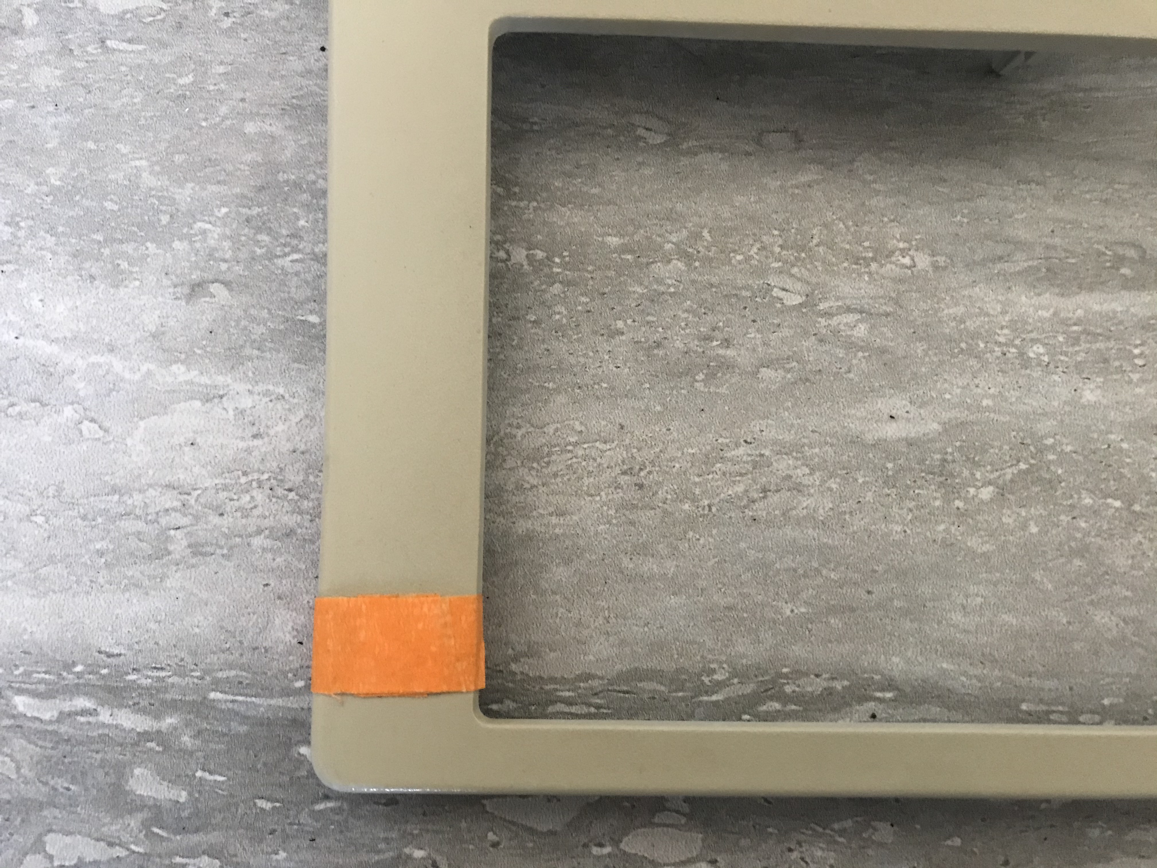

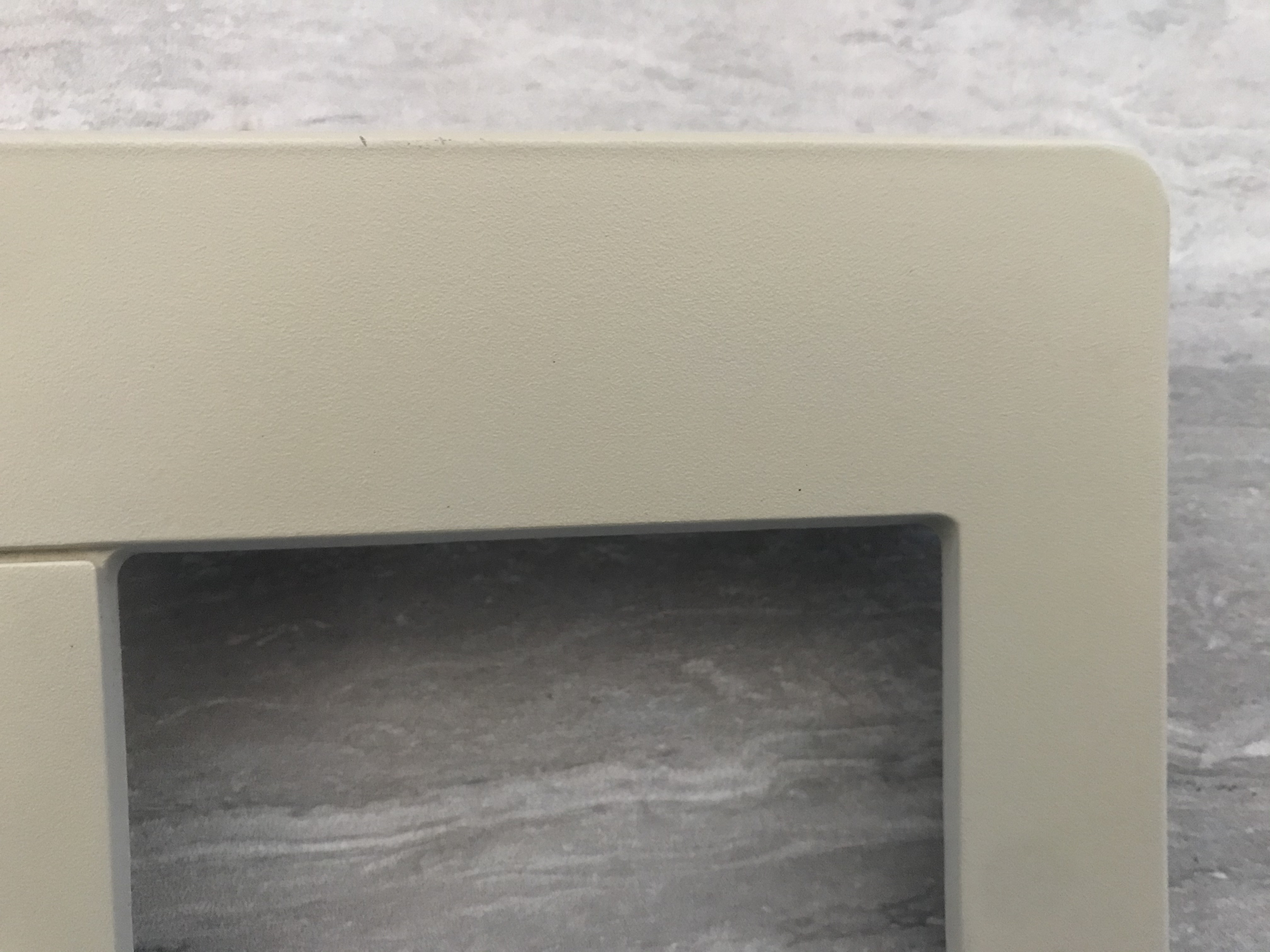

hellothere

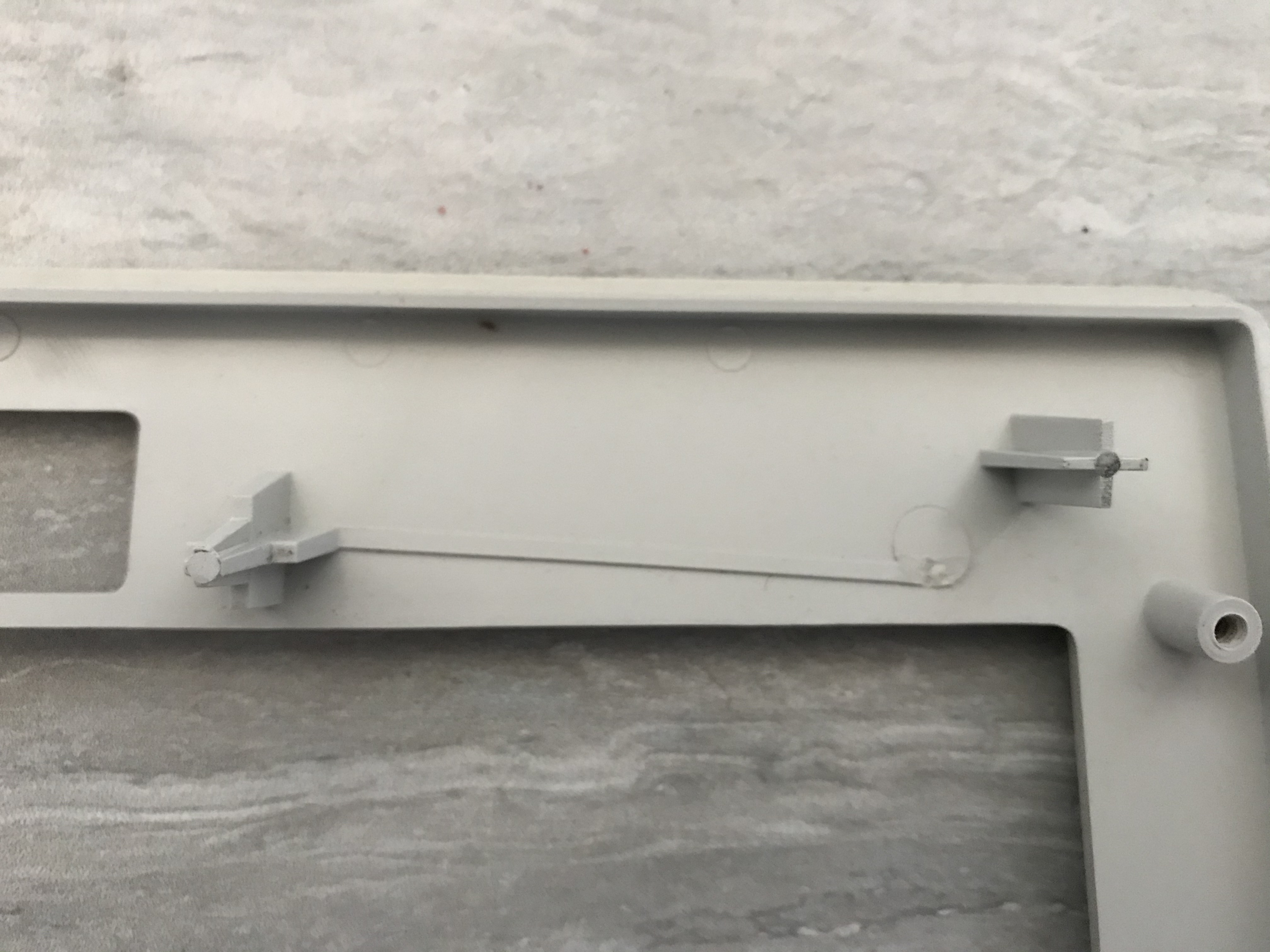

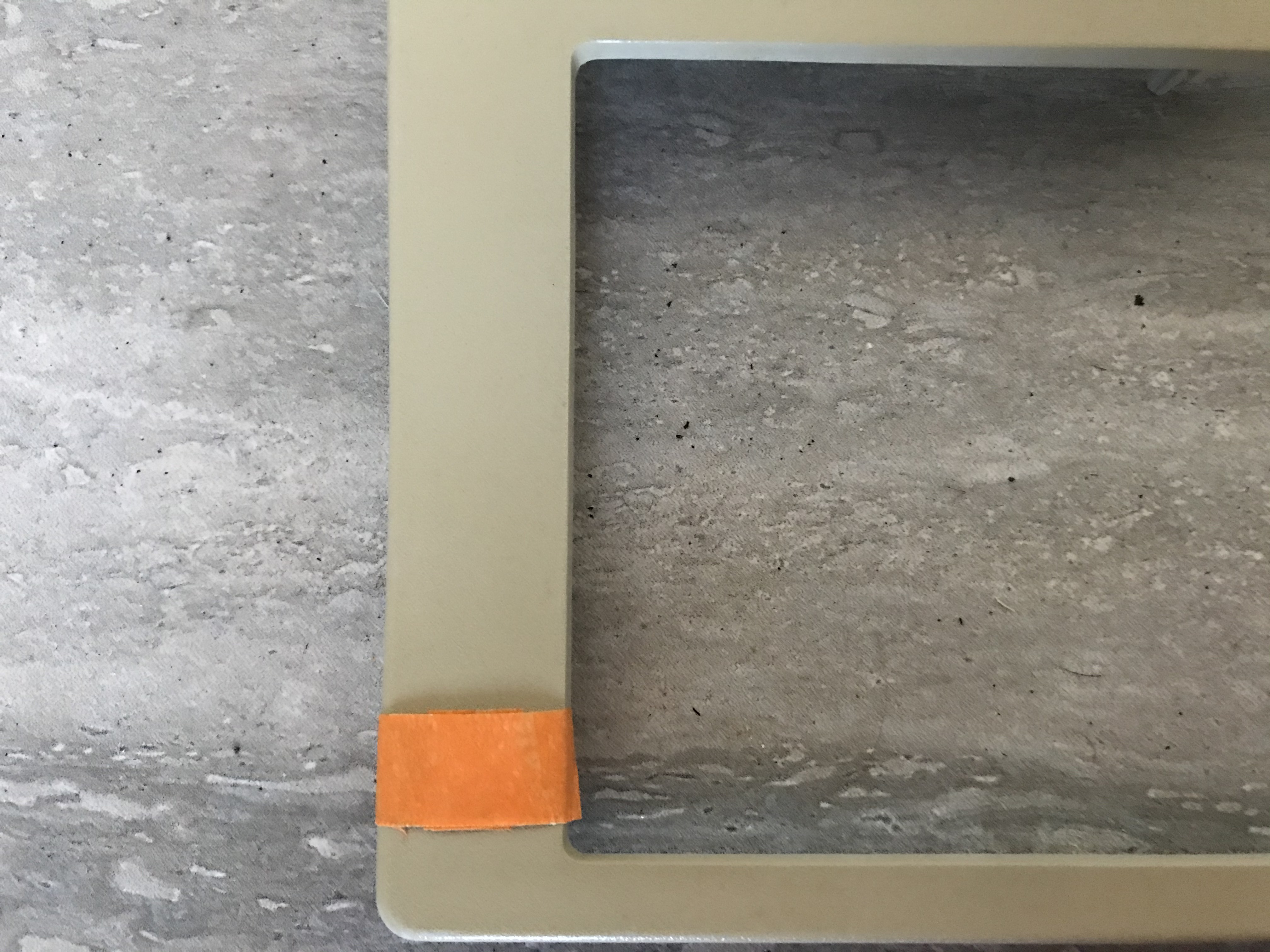

18 Nov 2020, 18:28

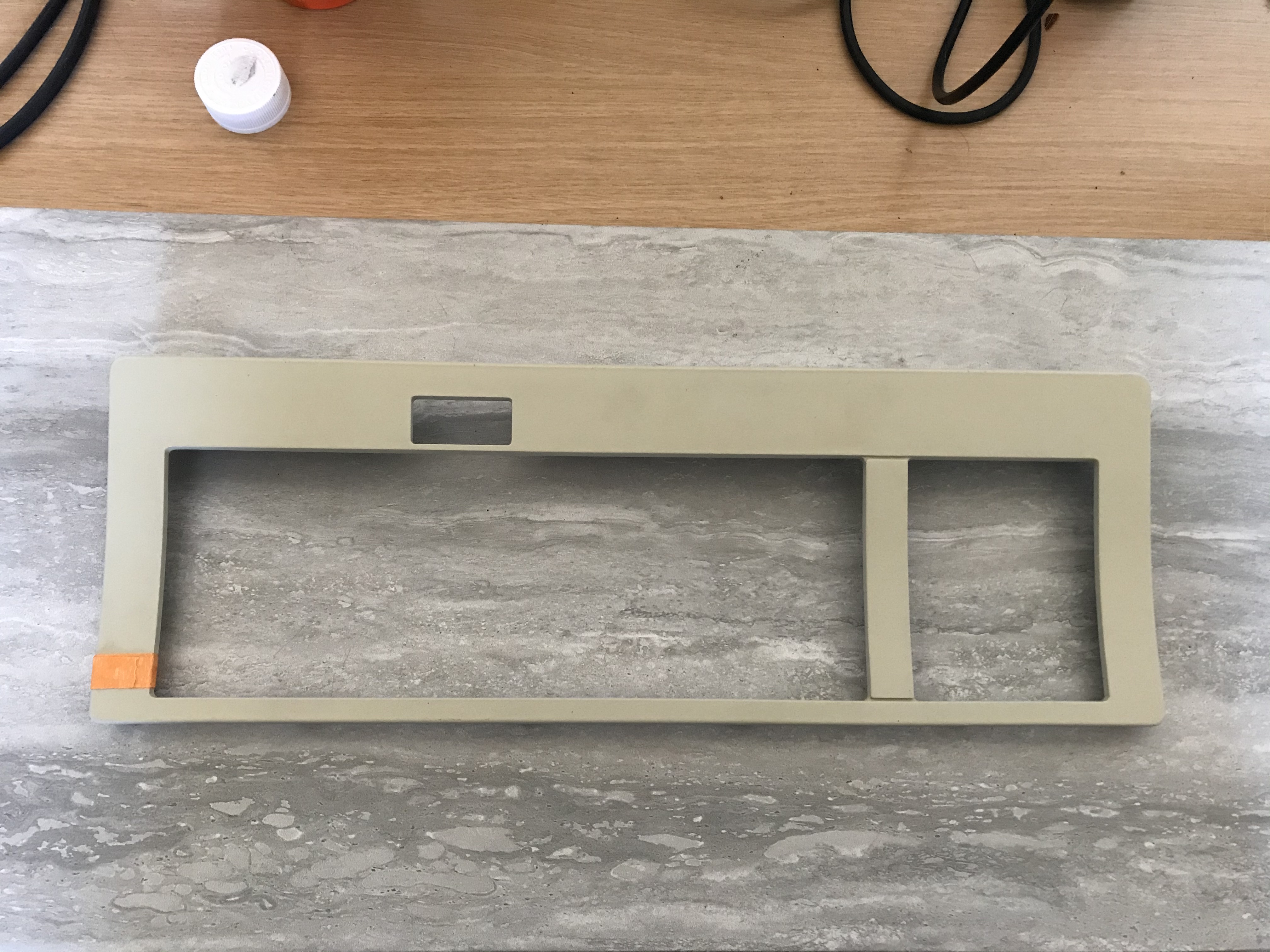

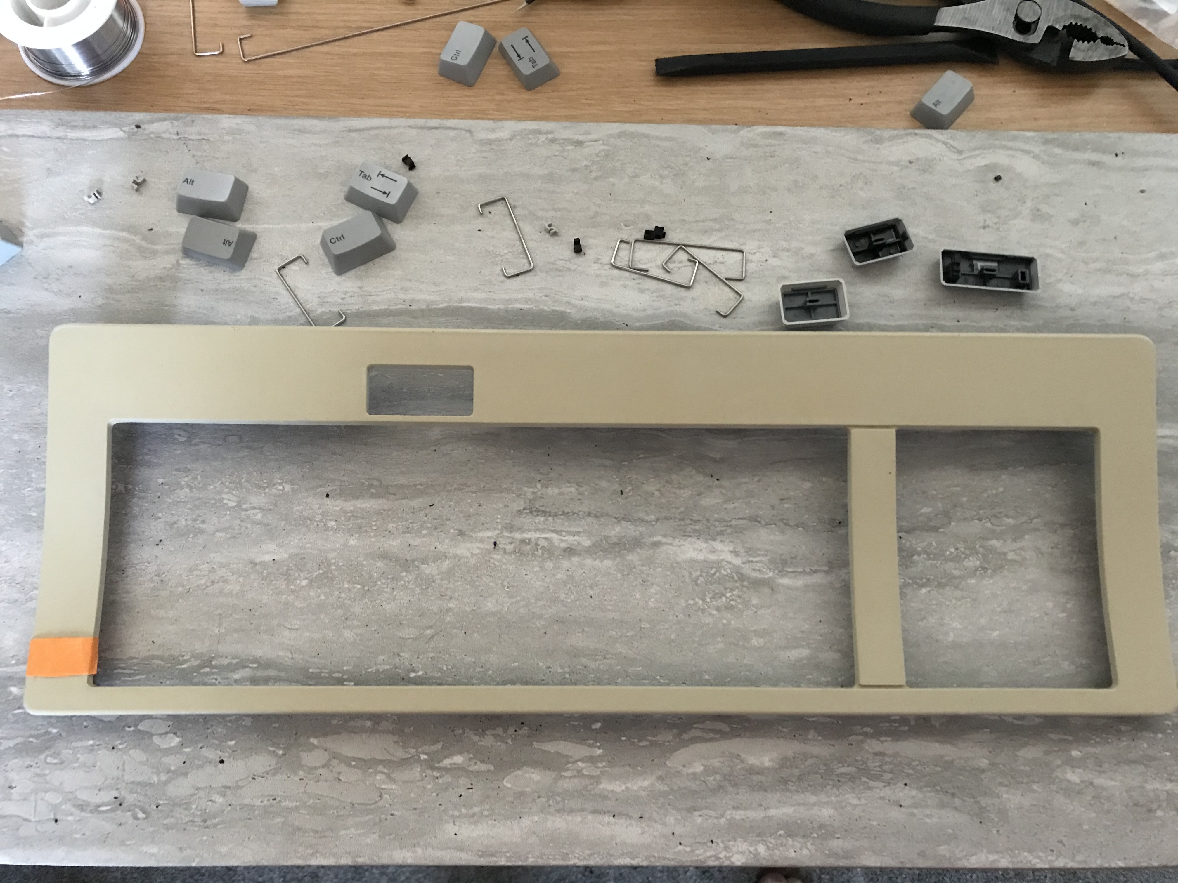

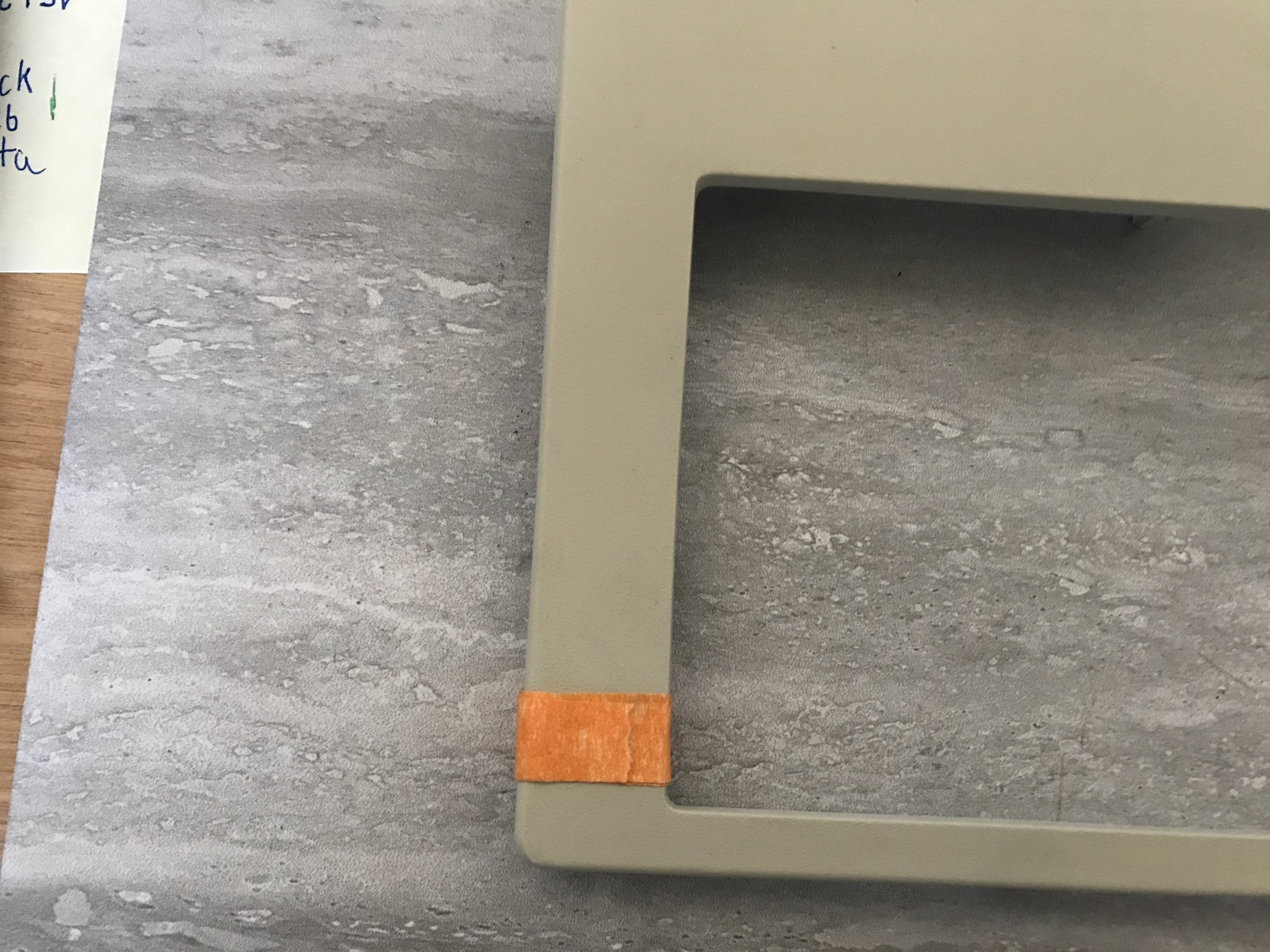

Since I have no clue where I put my AEK II top case (I had it yesterday), I'll use this top case from an Apple Standard Keyboard (M0116). A thing that's as shocking to me as much as to you, the photos I took on my potato again do match real life, so the colors are accurate.
The orange painter's tape is over the Apple rainbow logo/design, as I don't want that to lose its colors. It's 4 or so layers.
If it gets windy, I'll take it in. However, the 10 day forecast says winds under 10 mph (that's 12 Teslas in metric) for the next 10 days. UV index says 4 out of 10 or lower.

Regarding the hair cream, i.e. 40V to 60V developer, zrrion has a point and I've seen that happen, even during my own adventures. Submerging the case in the developer/OcyClean works relatively well, but it's somewhat annoying to do: you either need a big plastic or big glass tray that has sides taller than your keyboard. I looked hard for one that wasn't extremely expensive. I couldn't find one, but I do have cardboard boxes about the right size. I cut them down then line the box with a garbage bag. Alternating between top up and top down and flipping the case every few hours is the best method I've tried. Just remember that you want the whole thing submerged, both when face up and when face down.

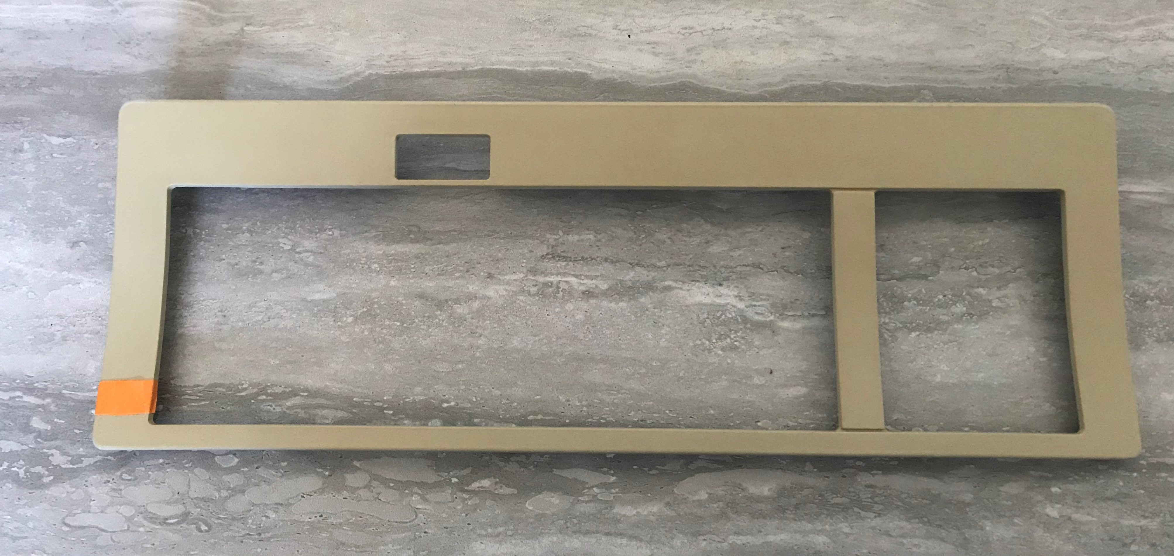

It hasn't been even 12 hours, but I'm posting before I forget. Bonus points to the person that can figure out what keyboard I'm working on by the key caps that are scattered about. I flipped over a few so you can see the mount. Hint: yes, some are grey double-shot and some are black double-shot. People that I've bought from/buying from are disqualified from this game :P.
Oh. I did find that AEK II case. I put in a box with an IBM case. I'm going to continue to use the Apple Standard keyboard for this test, though.

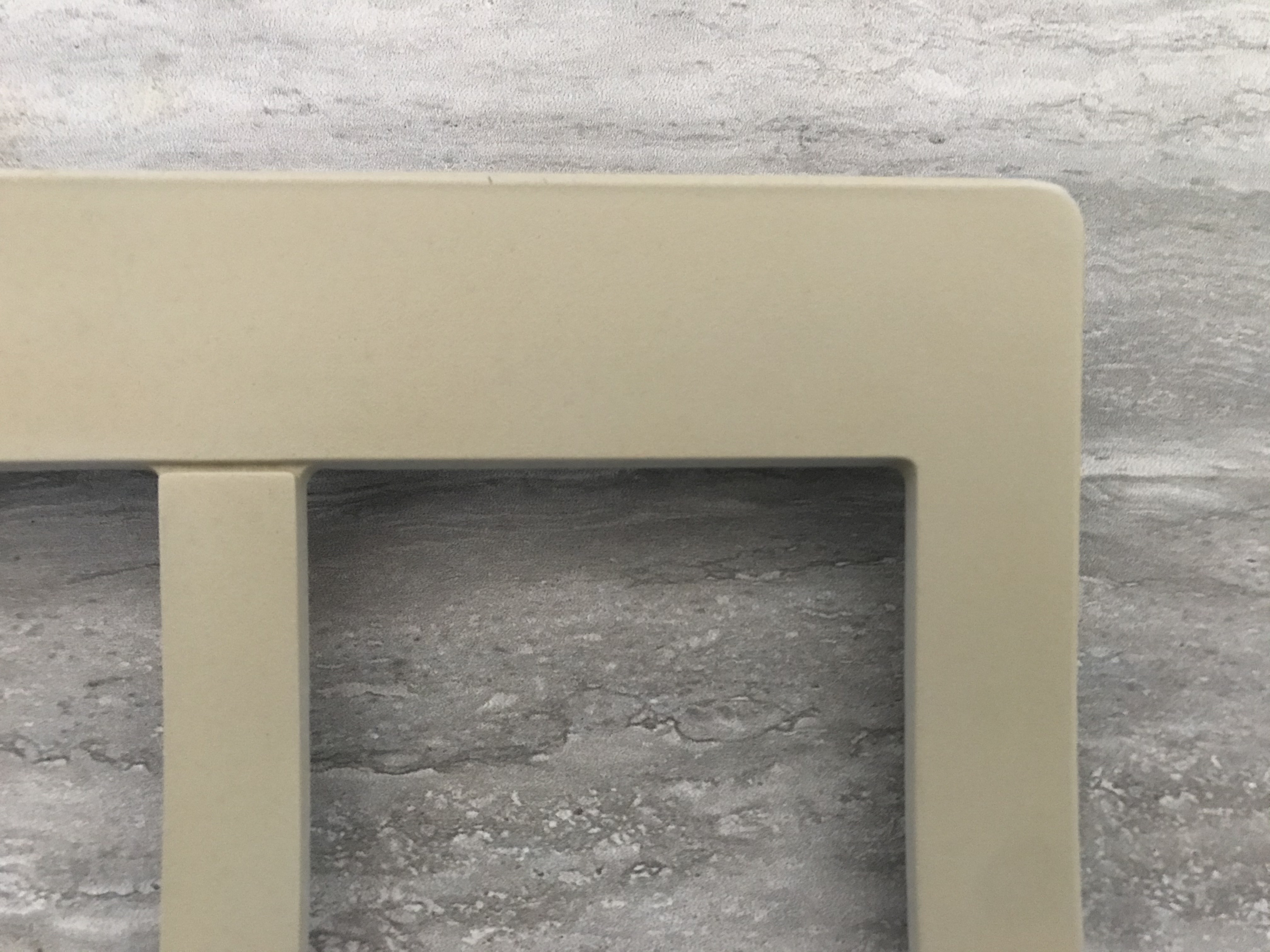

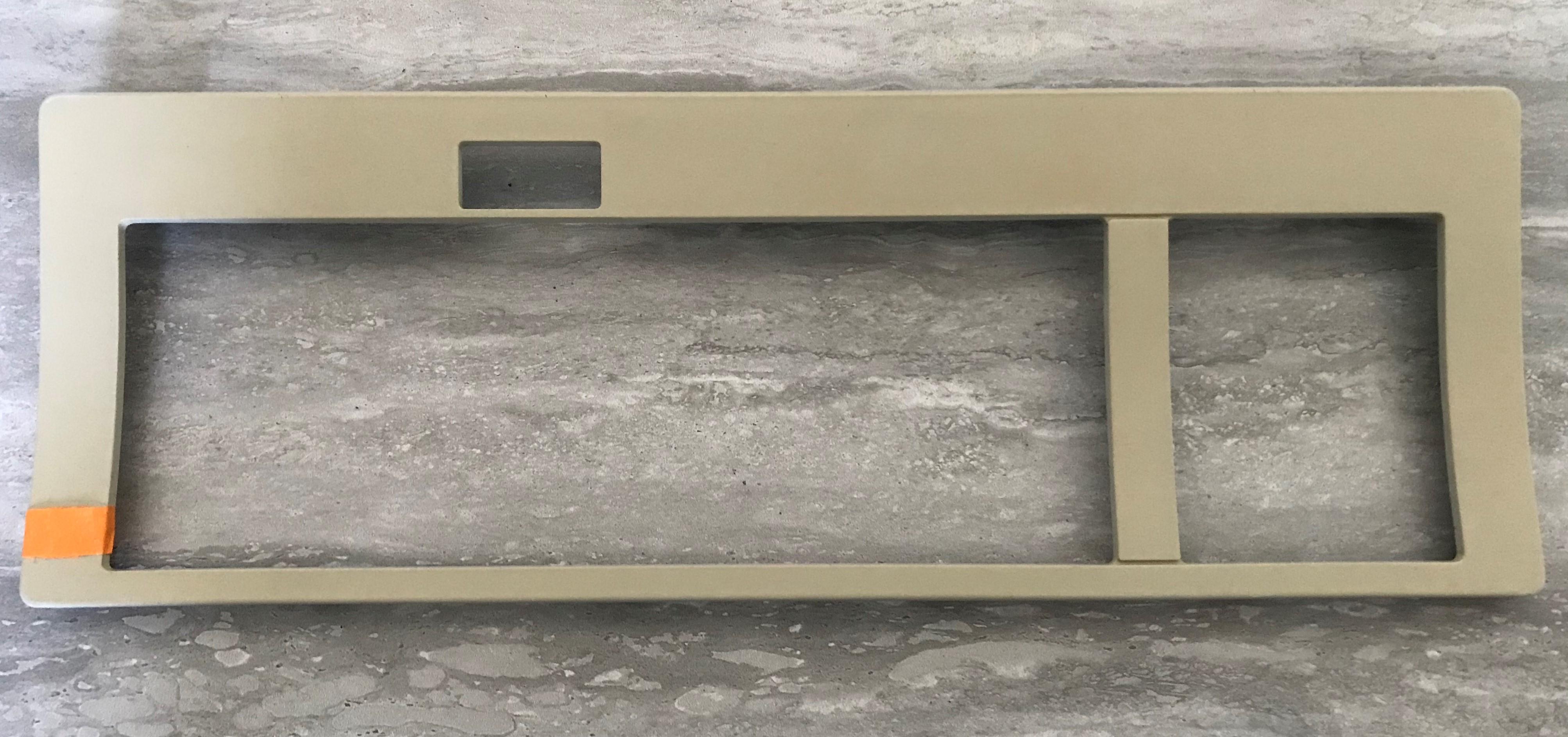

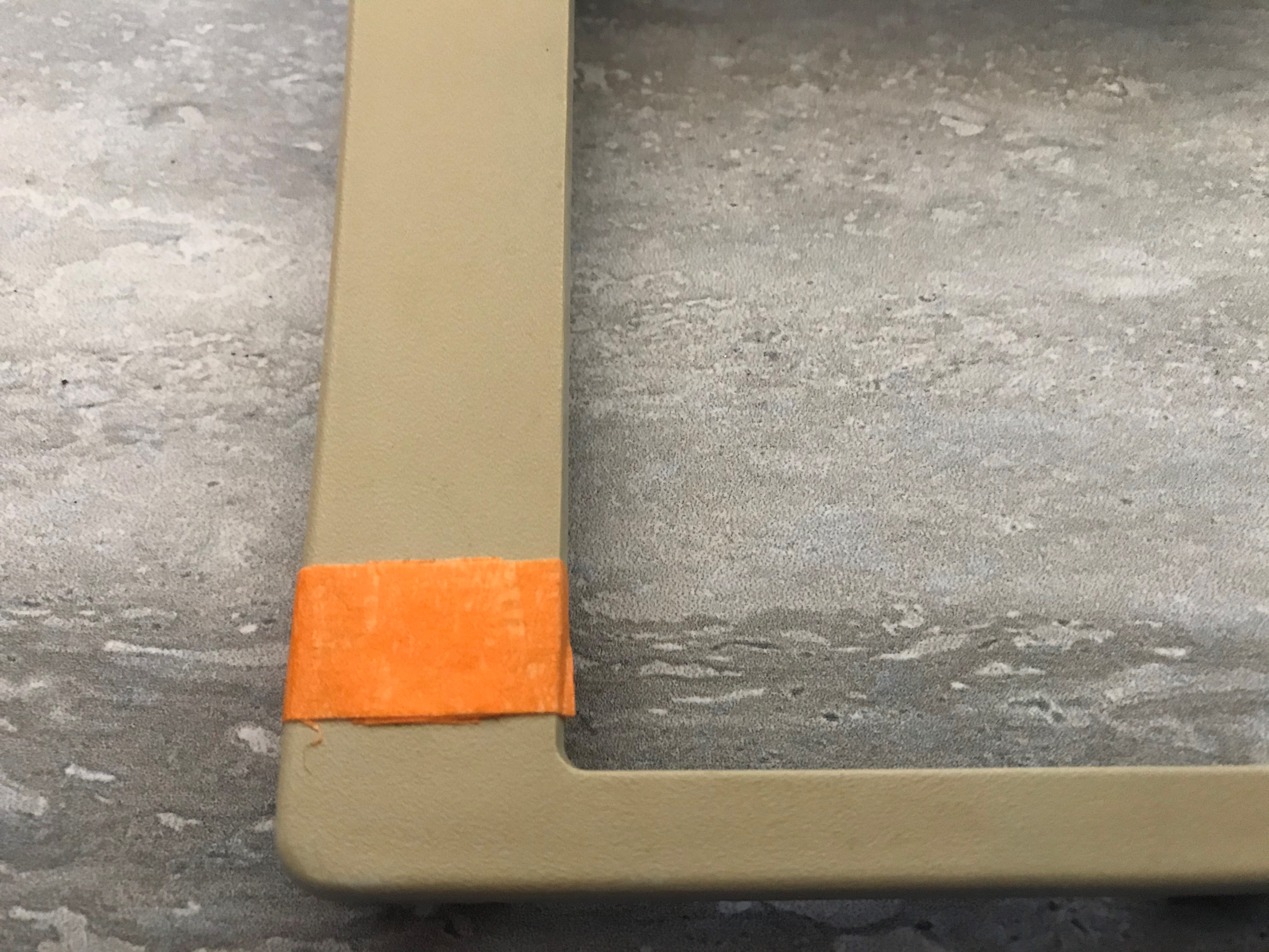

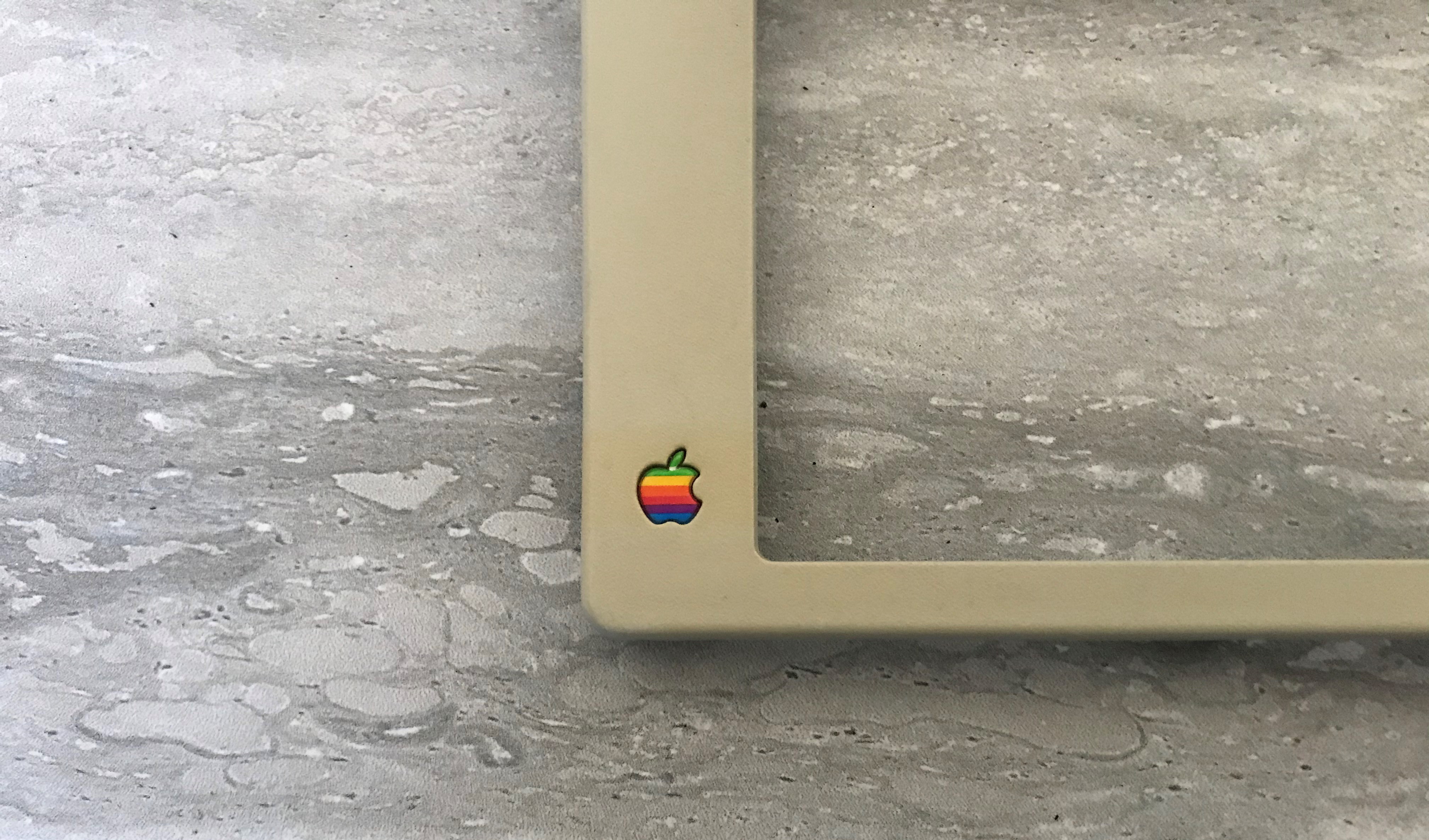

hellothere
20 Nov 2020, 22:39

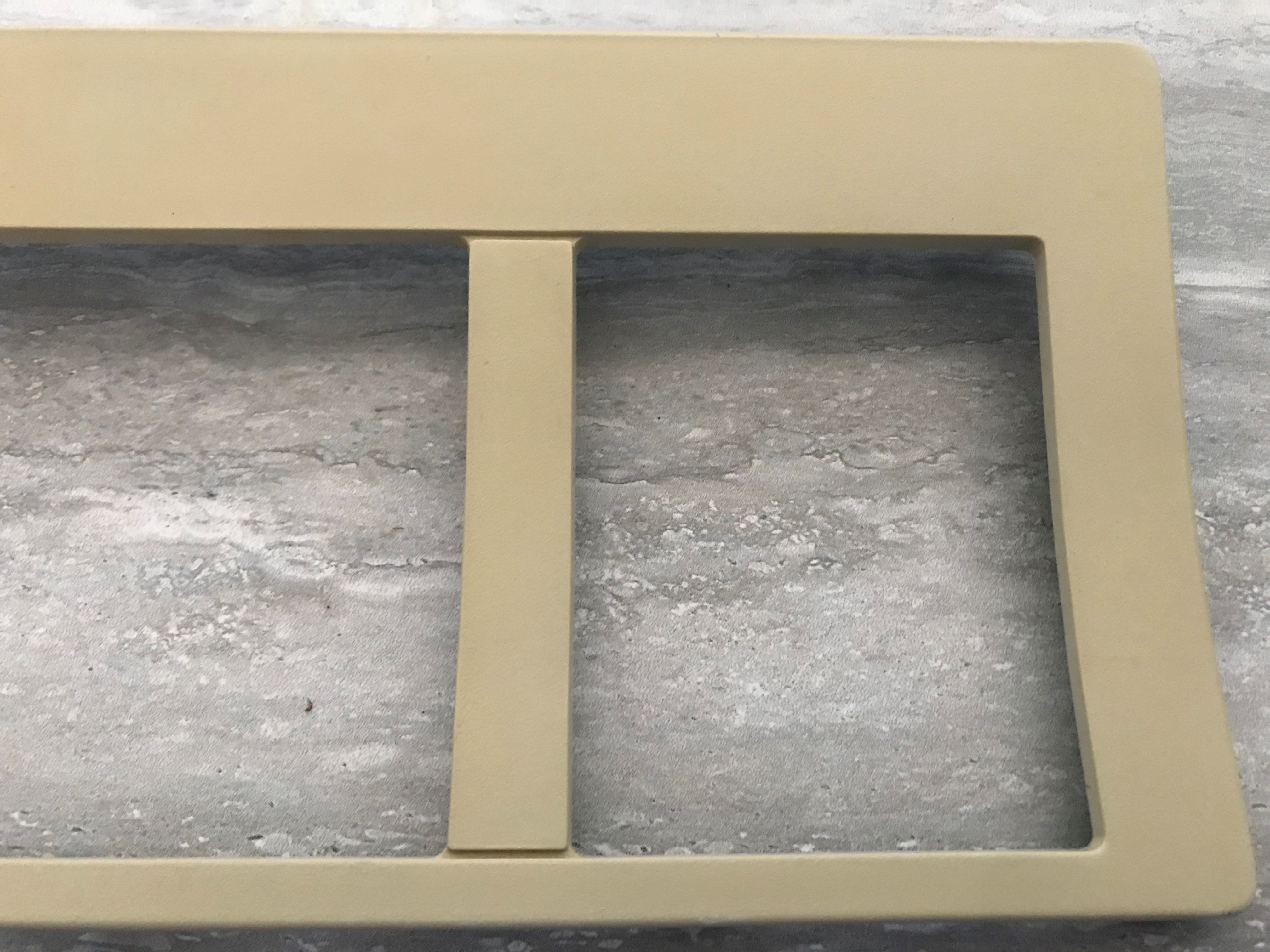

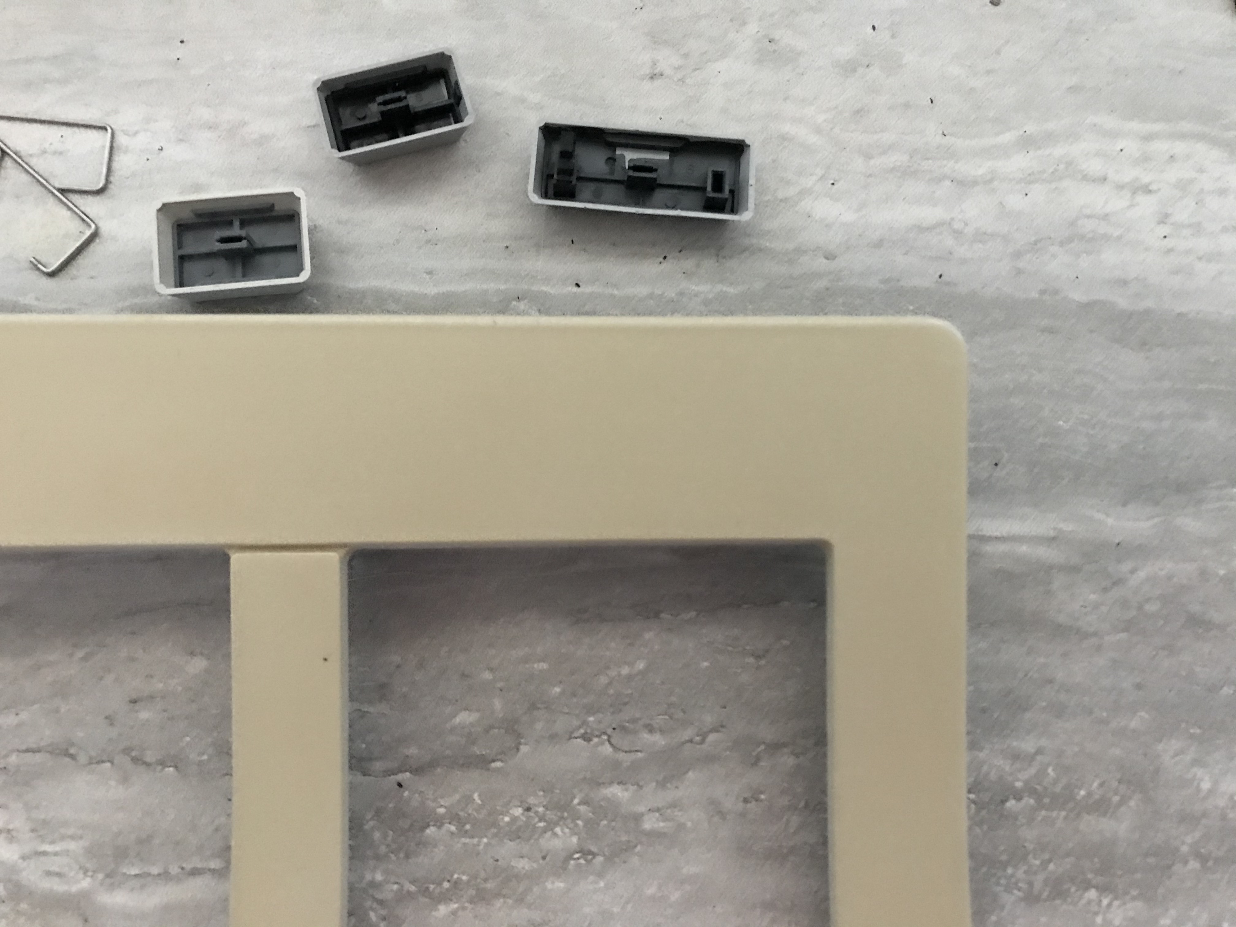

Well, there's a tiny change. Check out the bottom most picture. That's the one with the Apple logo. I removed the painter's tape.
IMG_1274 (2).JPG (1.17 MiB) Viewed 10011 times
IMG_1277 (2).JPG (1.65 MiB) Viewed 10011 times
So, as this does appear to be working ... very slowly ... I'll keep up this experiment. I'm going to leave the logo covered up, though. I'll give it the full week.

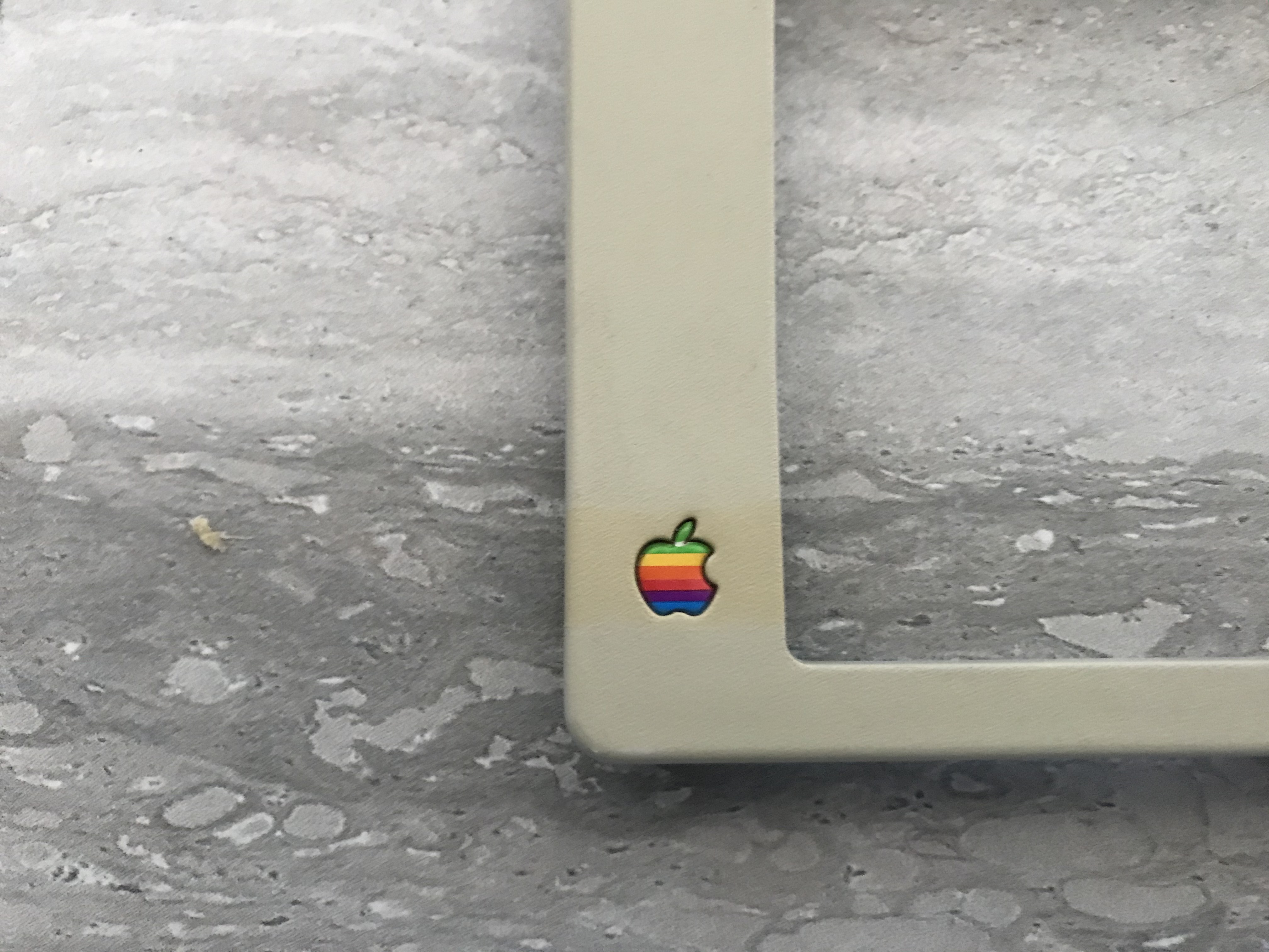

hellothere
20 Nov 2020, 23:26
However, it is nice to know that the colors in that Apple logo haven't faded in 40 years.
An additional thing, as far as the experiment goes, is that I can remove that tape in a week and it'll be easier to see how much yellowing has been removed.
hellothere
28 Nov 2020, 18:05
Last day.
So, this is a pic of the inside of the top case, so this is the color I was aiming for.
Here are pics of the top of the case, in approximately the same positions of the other cases, if you'd like to do a comparison with the other pics:
Here's the big reveal, where I take off the masking tape over the Apple logo ...
So, yes, there was an improvement, but not much. I'll again point out that I live in a desert and I had sunny days throughout this test. I also rotated the keyboard 90 degrees every day to make sure there was equal sun coverage throughout.
