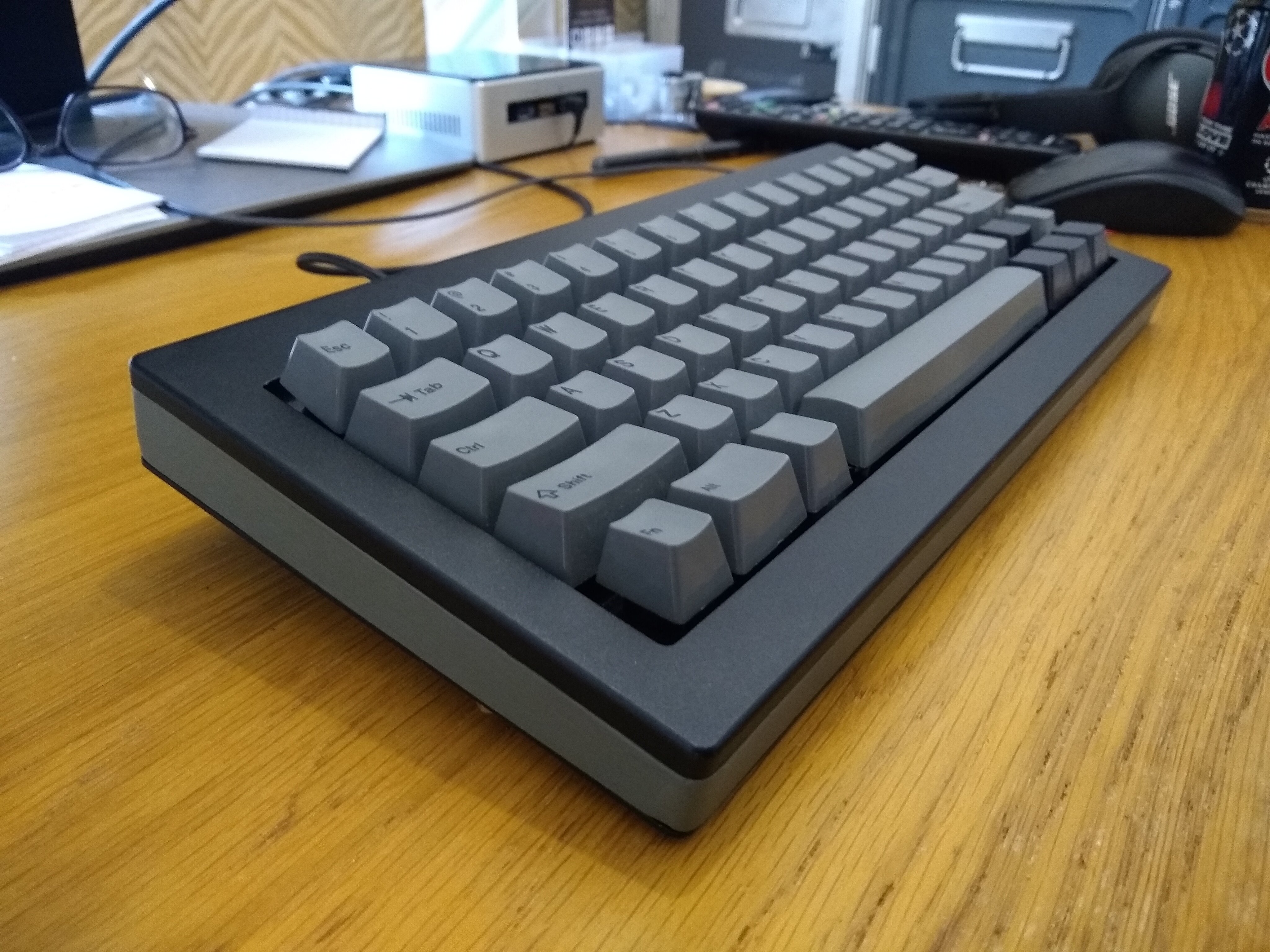

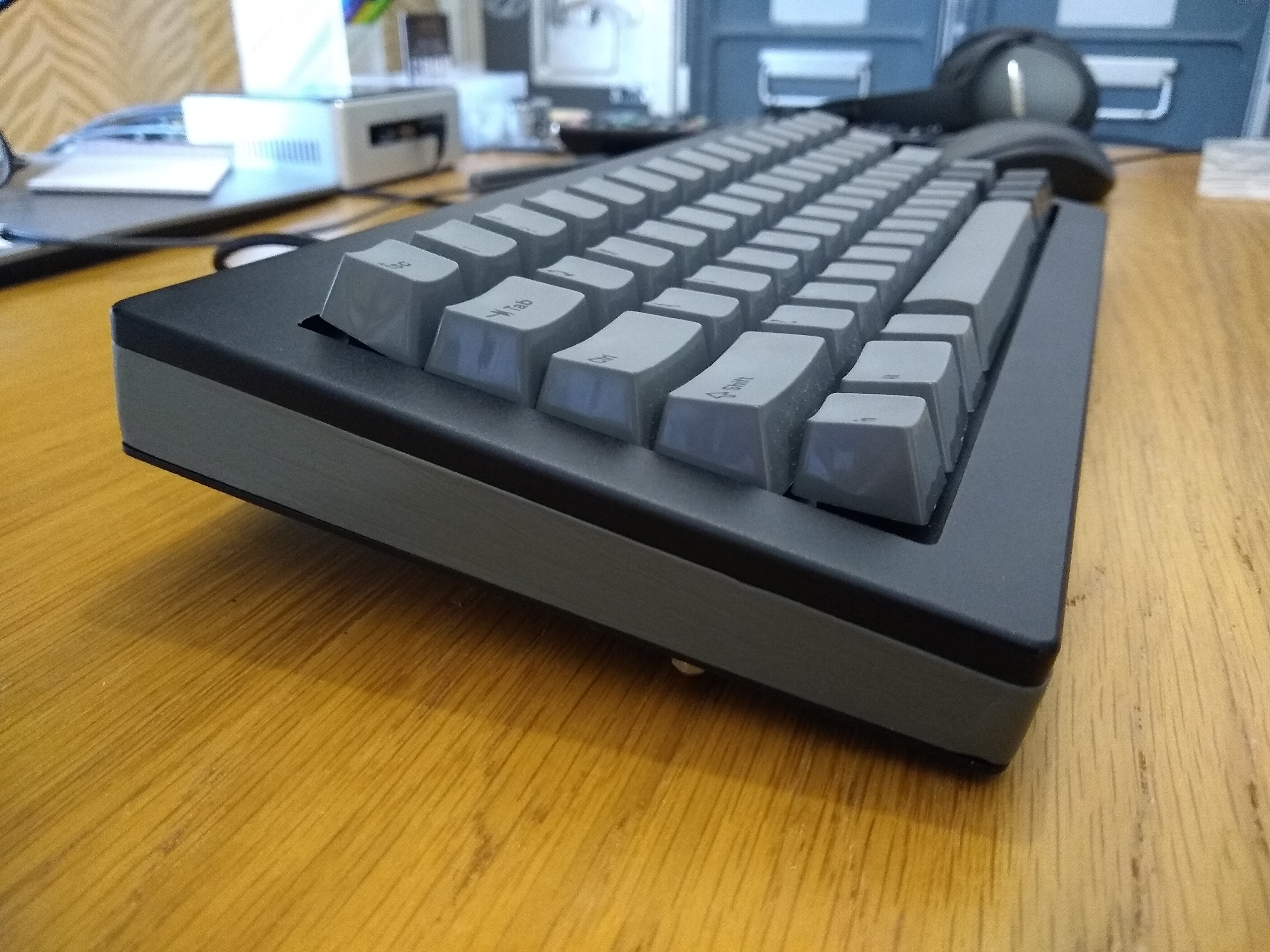

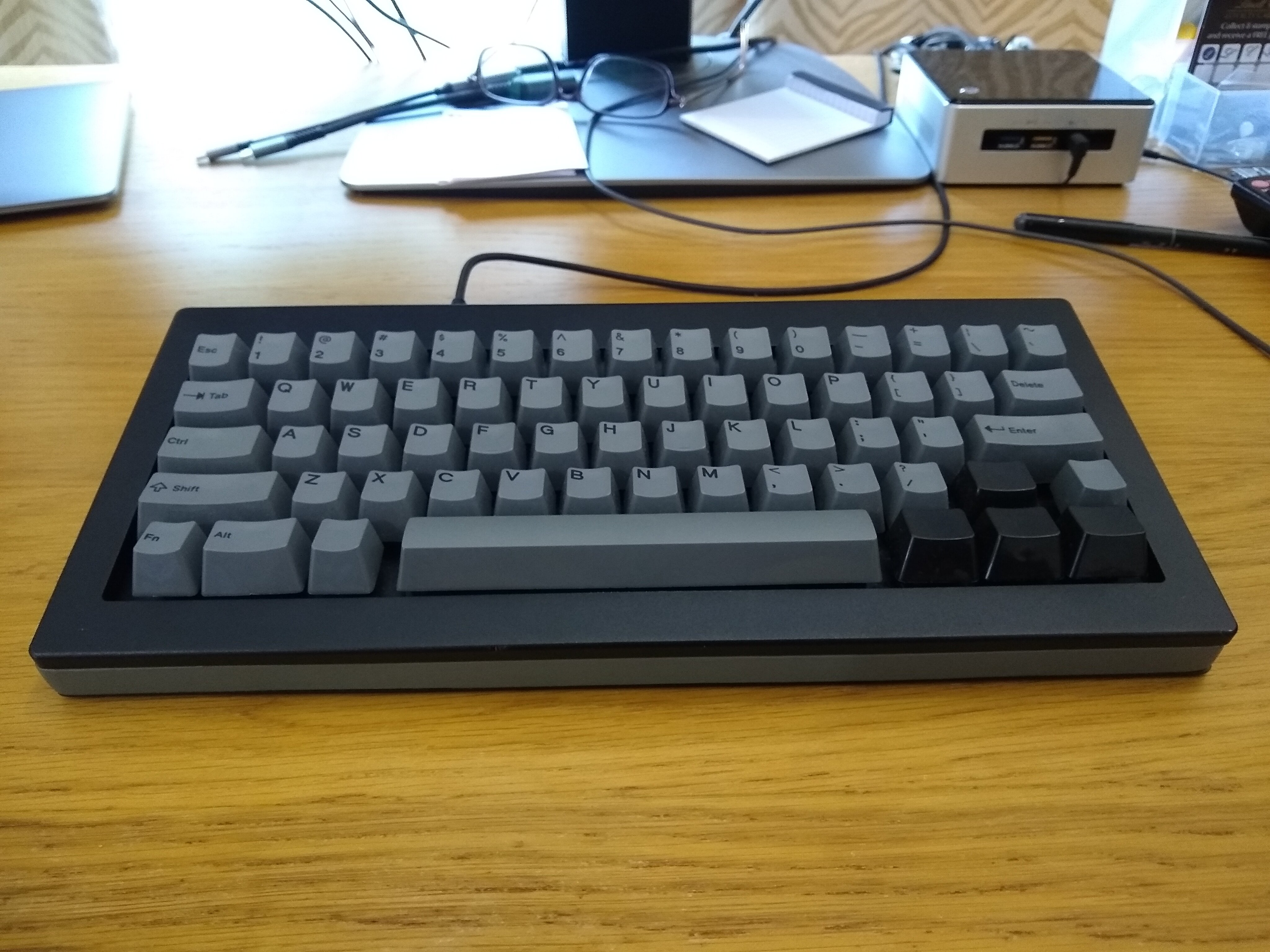

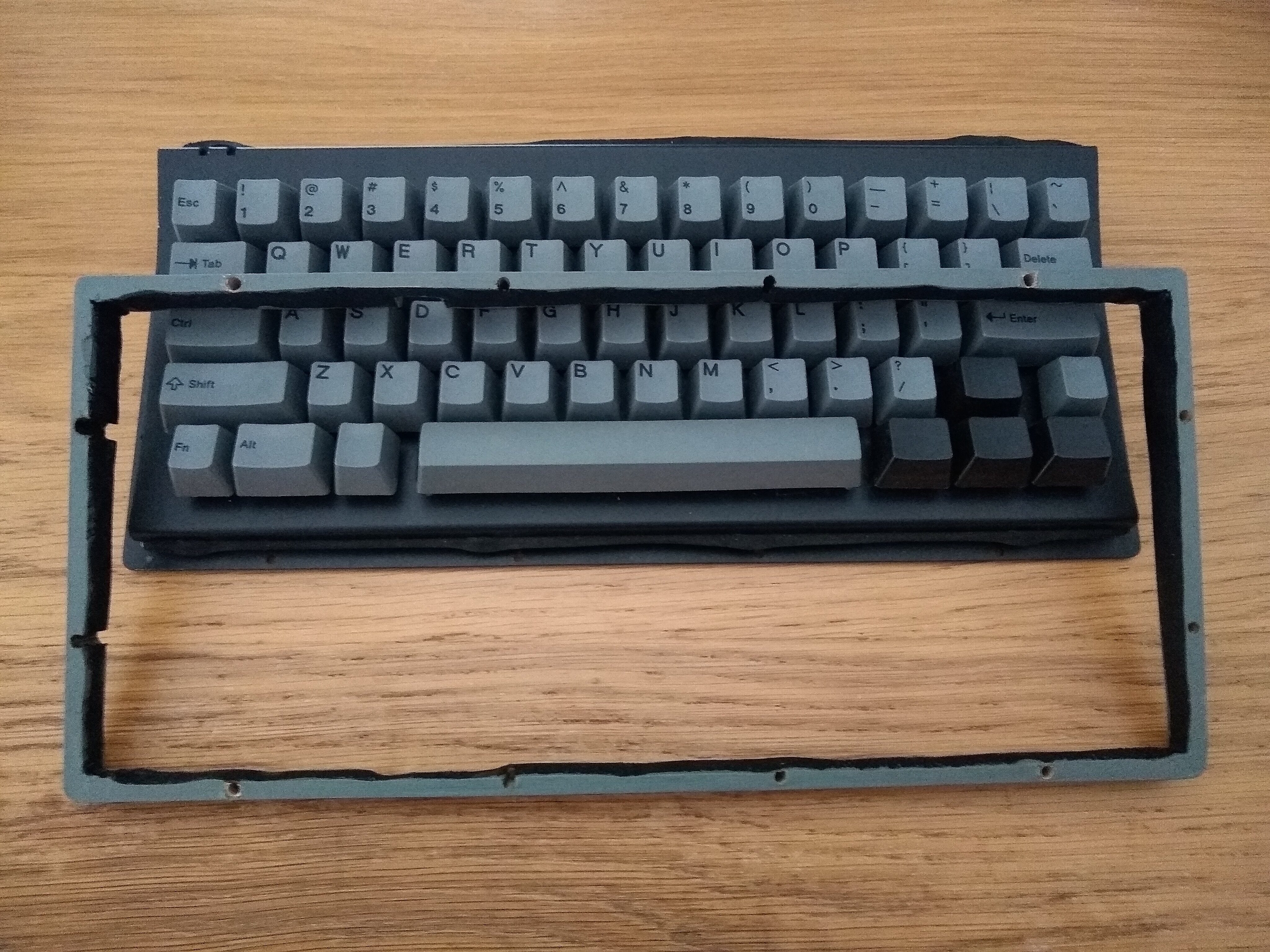

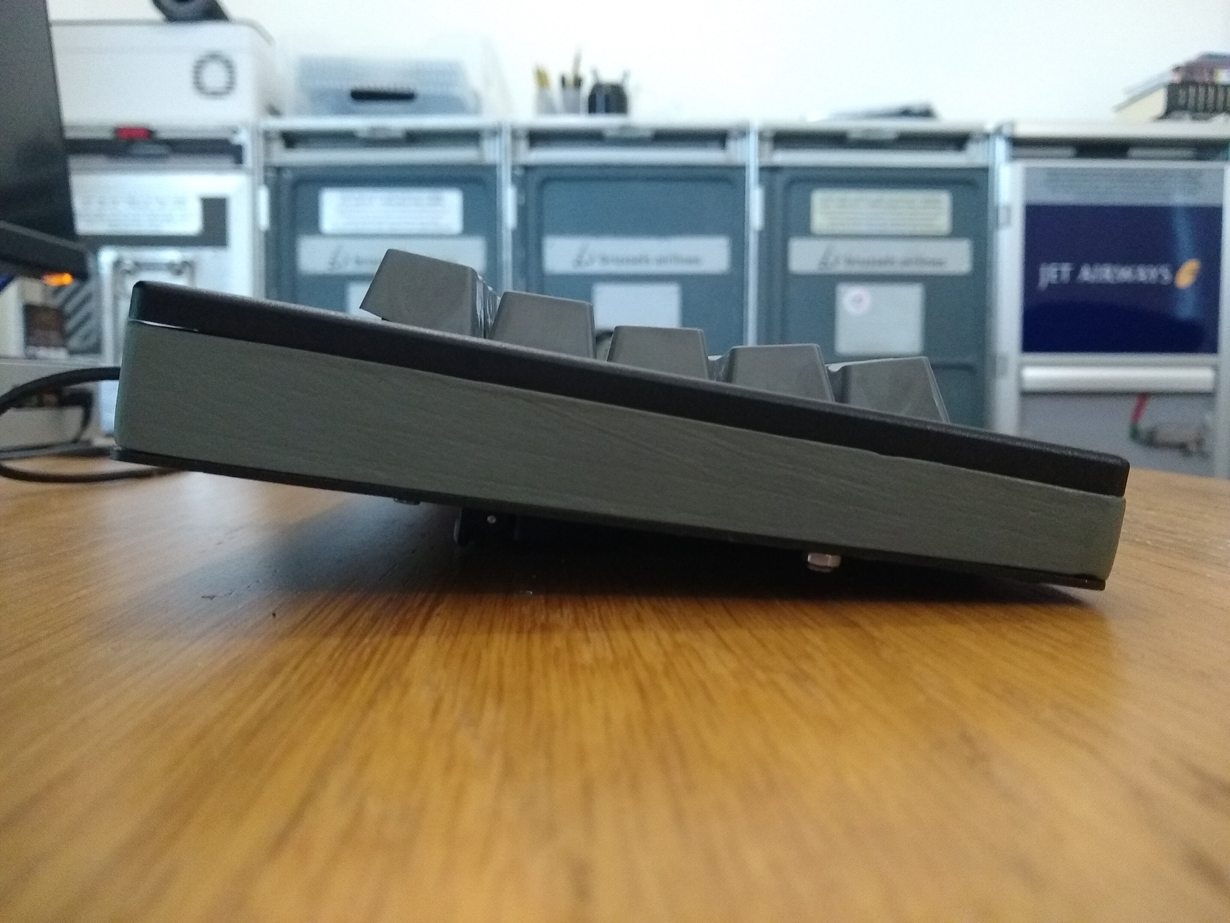

So a funny thing happened when cleaning my compact F62. I removed the case to dust it and I happened to rest the case top over the mechanism for a moment ... and the keyboard looked so much cooler with an inclined top.
Anyway. I've made a prototype replacement for the "mid case" which has a 12 mm high front and 18 mm high back (the original is a bit over 16 mm on both front and back edges). I'm going see if I can convince a friend to machine me a proper aly replacement (this one is made of modelling wood)
Unfortunately I think I've added about a millimetre back with over zealous painting. I might have to sand off the paint from the inside surfaces to get back the full "exposed mechanism" feel.

That’s a really nice aesthetic.clickclack wrote: 22 Aug 2021, 12:20 So a funny thing happened when cleaning my compact F62. I removed the case to dust it and I happened to rest the case top over the mechanism for a moment ... and the keyboard looked so much cooler with an inclined top.

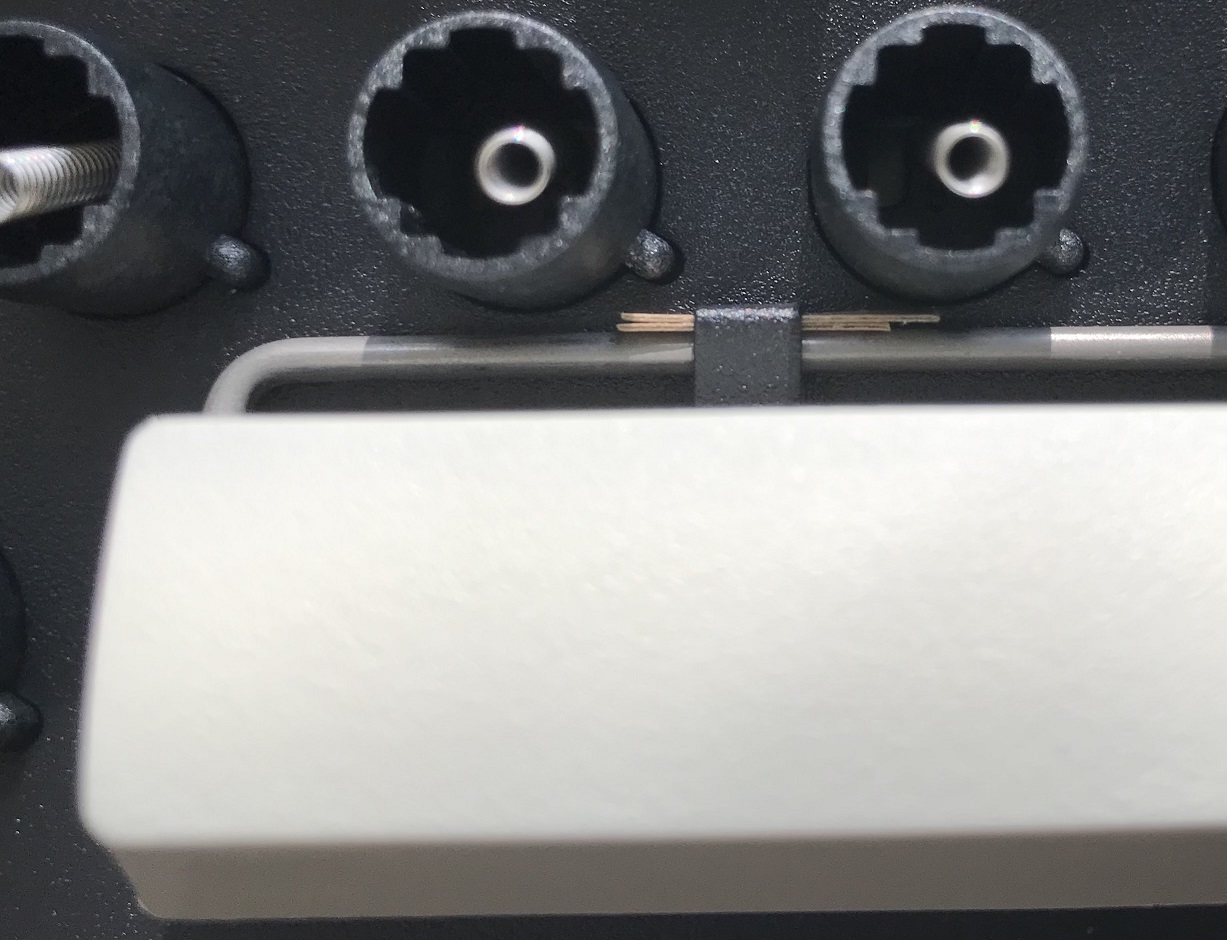

I just received my new F77 after waiting these past few years and I a bit let down by some rather inconvenient issues on an otherwise quality piece of kit. Right out of the box the spacebar is not operational as it will not release on it's own. It is simply stuck unless I manually pull it up. Seems like a basic thing to test prior to shipping but I guess other bigger and better projects may have taken precedence. It kind of seems like the space bar stabilizer clips or metal stabilizer bar are not adjusted or installed properly and I'm just not sure what I can do without making things worse
Additionally after just putting a handful of keys in place I am having trouble getting many keys to click even after reseating a few times. I guess I have this issue on vintage Model F's but not nearly to this extent. I may end up swapping with original parts from a vintage donor Model F to see if this makes a difference. Per the operator guide holding the keyboard vertically "space bar side up" does seem to help but still have some extra tricky keys it seems.

I ended up using the stabilizer bar from a 1987 vintage Model M (because that was it had close by) and it works perfectly. The vintage stabilizer was slightly thicker (likely more so than later Model M's) and it's length appeared slightly shorter than the one that came with my F77 when comparing them side by side. They look very identical but the included one was out of spec is some manner where it just does not work correctly. After reseating I actually did get this one to work slightly so that the spacebar would return if I slapped the spacebar fairly hard. The same issue is also present when I try and use the F77 stabilizer bar in the donor Model M.
With the spacebar functioning well I noticed it was fairly loose and kind of rattly. Just not quite satisfactory but functional at least. After some quick thinking I used some thin strips of some 3M double-sided tape (with the smooth non-adhesive backing left on) as shims to fill in some of the dead space between the stabilizer bar and the clips. Now at least the spacebar feels and sounds like a proper Model F now.

JP as a note I install and test each space bar on the keyboards that go out, but sometimes they require adjustment after the keyboards are bounced around in shipping - sometimes they are bounced so much that people have found the space bar separated from its keyboard barrel!
It's a matter of slightly bending the space bar so it performs optimally. Definitely more of an art than a science. When the space bar gets stuck in my QC process, I usually take the wire with two hands, with the long part of the wire closest to my thumbs, and use both thumbs to very slightly push up the wire - I do this about 4-5 times but not too hard that the bend becomes noticeable. That way the wire is pushed out of the way enough of the metal stabilizer tabs so that there is a little room, maybe 0.5mm to 1mm. If they're too close to the back of the metal tabs, the space bar wire can get in the way of normal operation. This will also make the space bar stabilizer wire ever so slightly wider in the two places where it connects to the space bar itself - this also helps adjust the looseness vs. tightness of the space bar while in operation. And as mentioned in the manual, the metal space bar tabs should not be pressed down so far that they cause the space bar to get stuck, nor should they be parallel to the top inner assembly plate, where they may get stuck on the end of the space bar.
As part of the initial install process, if keys are not clicking you may have to adjust the springs as shown in the QC secrets video. Sometimes the keyboard should be tapped gently or the springs pushed down gently by hand to make sure the springs move as low as possible from the perspective of the keyboard held vertically, space bar side up.

I'm actually typing on my new F77 now!Ellipse wrote: 27 Aug 2021, 18:11 JP as a note I install and test each space bar on the keyboards that go out, but sometimes they require adjustment after the keyboards are bounced around in shipping - sometimes they are bounced so much that people have found the space bar separated from its keyboard barrel!
As far as the spacebar it is dead to me.
Thanks for the tips. So far all keys appear to be working just fine. Also to be fair I was pretty tired when I first tried installing a few keys just to get a feel for things.Ellipse wrote: 27 Aug 2021, 18:11 As part of the initial install process, if keys are not clicking you may have to adjust the springs as shown in the QC secrets video. Sometimes the keyboard should be tapped gently or the springs pushed down gently by hand to make sure the springs move as low as possible from the perspective of the keyboard held vertically, space bar side up.

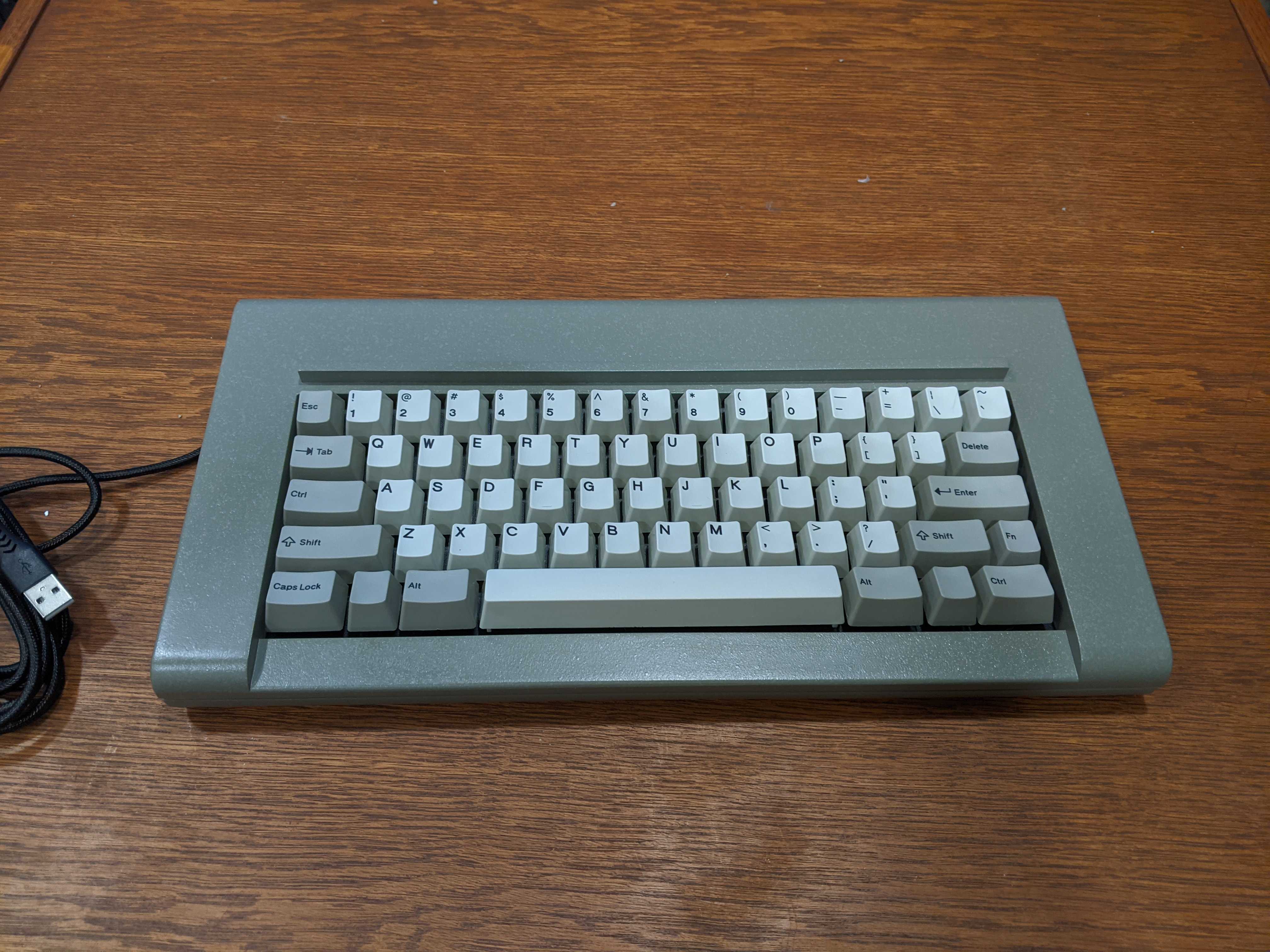

Finally got my F62. I love typing on it except for a sticky left shift which I can't seem to resolve.
One question for Ellipse: will the front-print and custom keycaps be shipping separately? They were included in my invoice but not the order.
Picture:
Picture:
Ellipse
Thanks for posting your new Model F photo PhineasRex! Please do read the manual - troubleshooting section as the fix for stuck keys is noted there.
