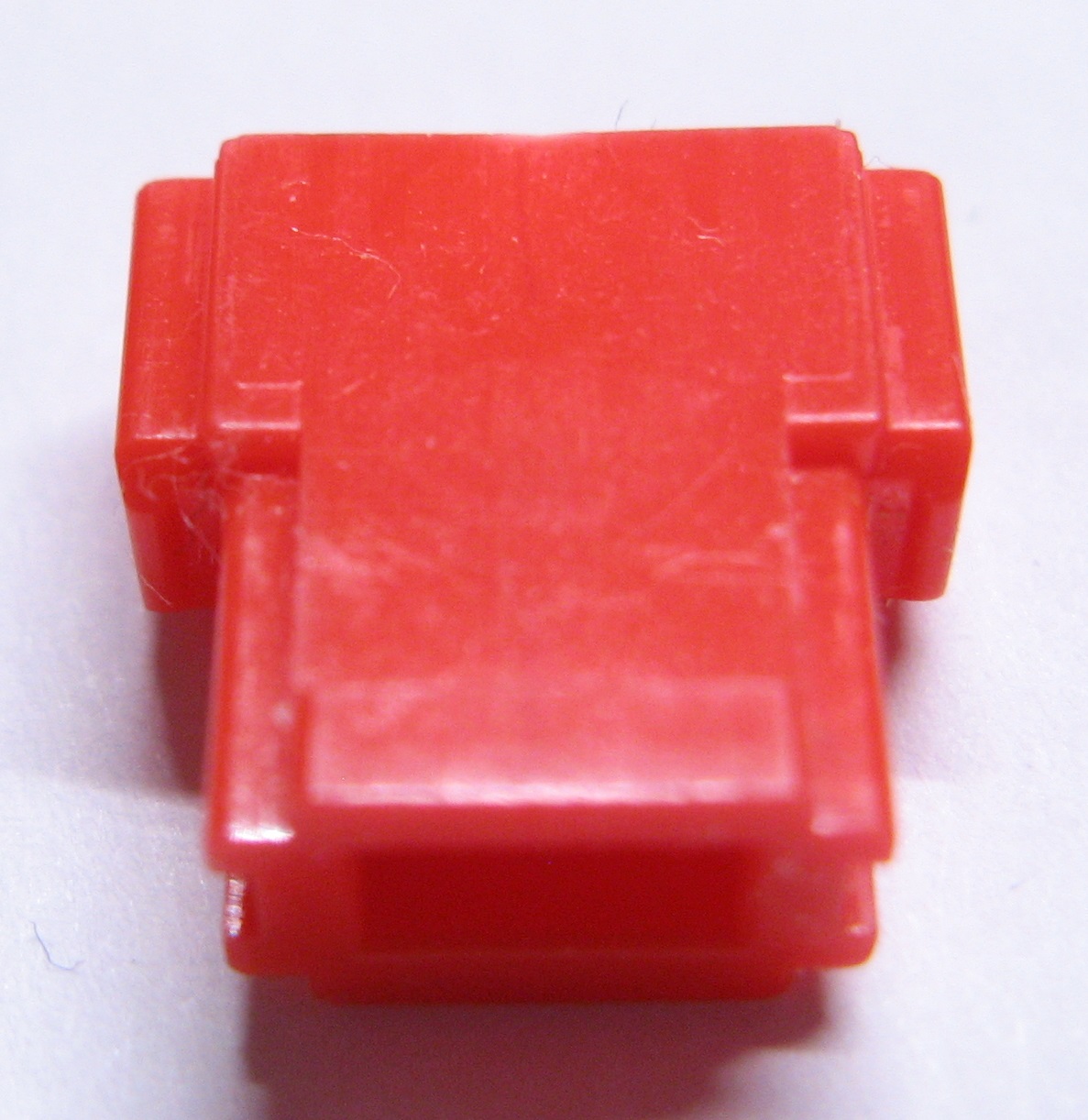

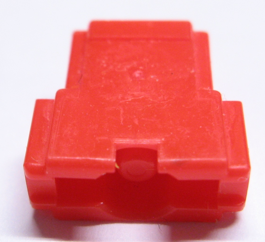

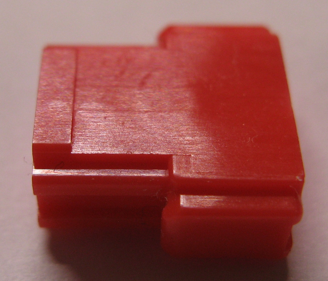

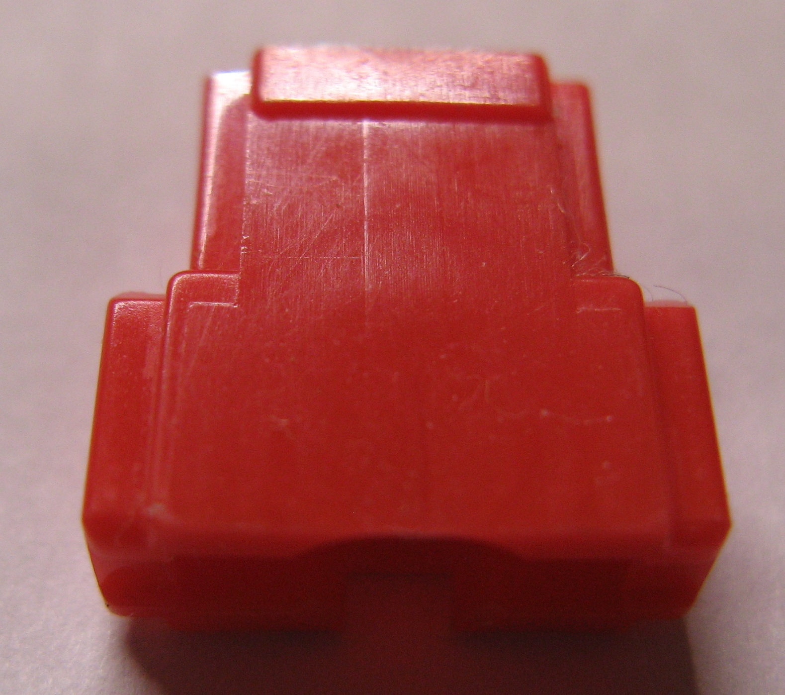

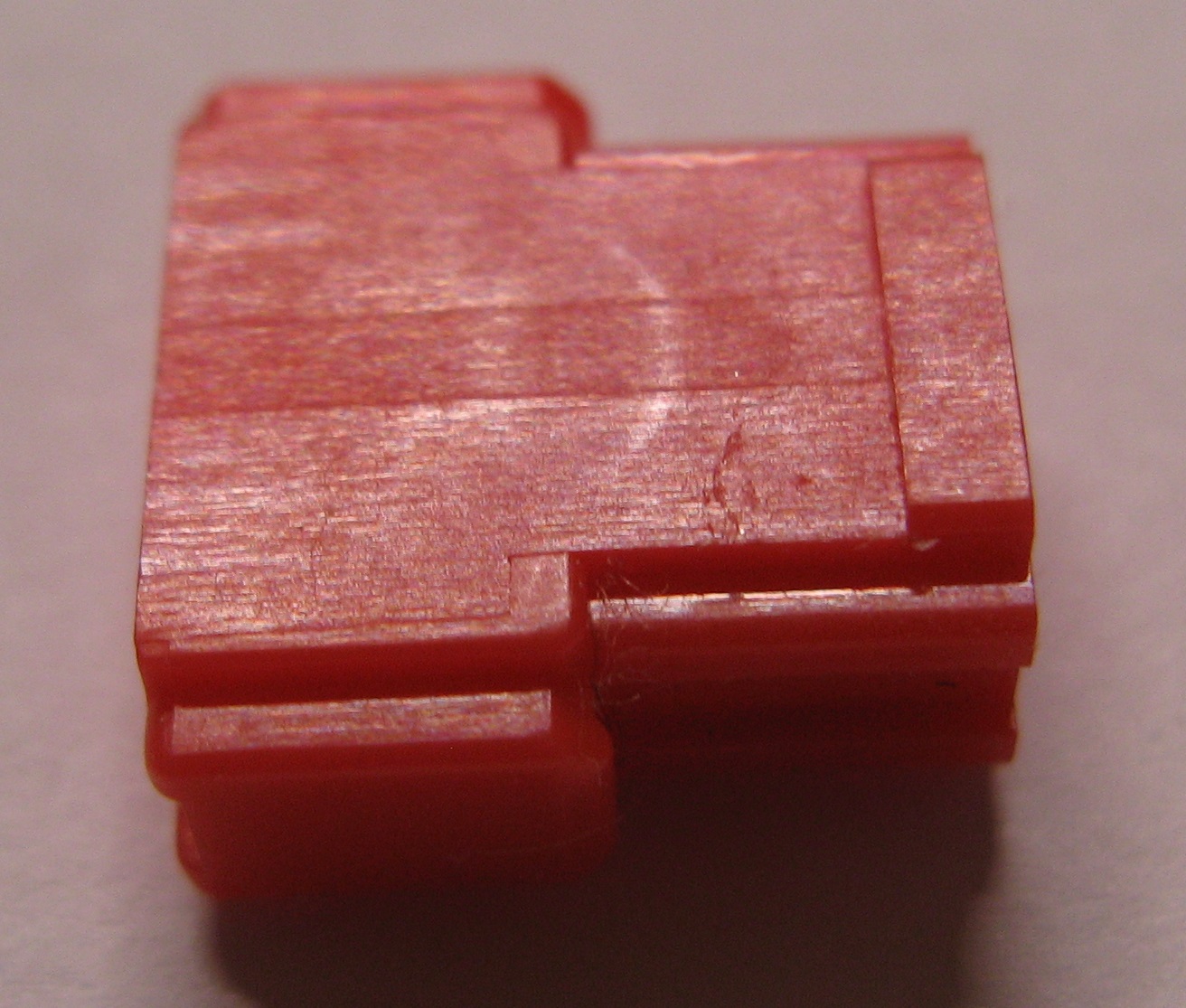

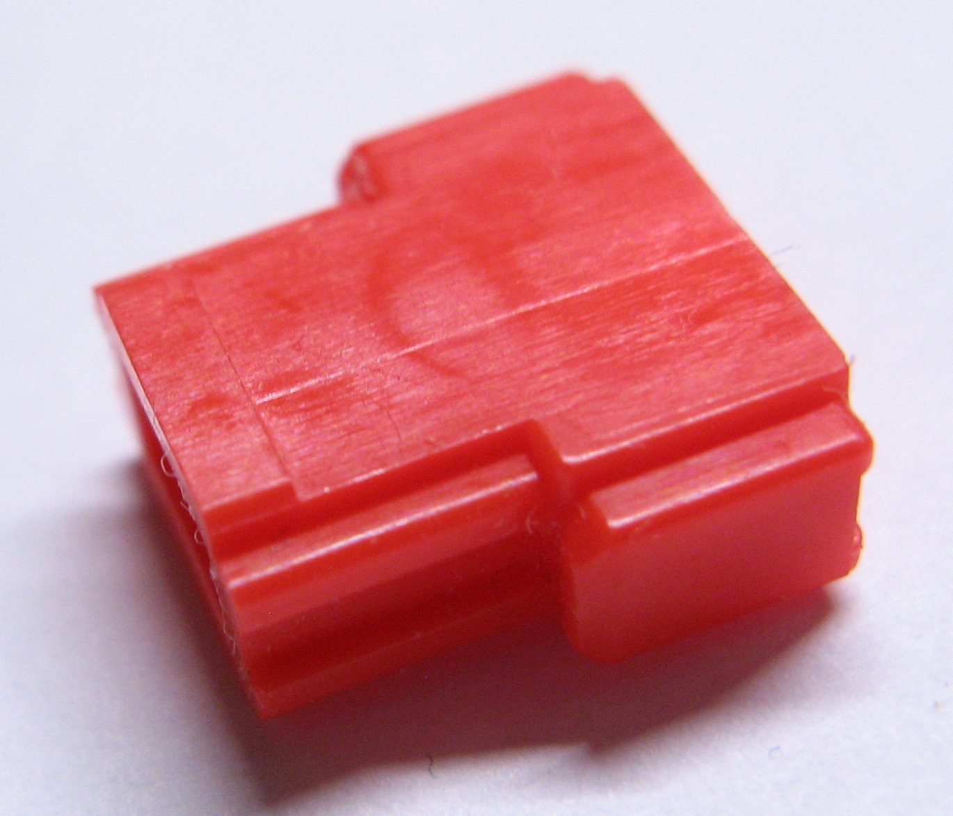

For what it's worth, the pictures we really need are detailed and well-focused pictures of the slider. A slider could be removed without disassembling the entire keyboard or desoldering anything; you just need to remove one of the switch tops from the plate.fool wrote: 03 Jan 2023, 18:00 Sorry for giving the wrong picture. It's not that I don't want to. I have disassembled and washed many keyboards and know it's not quicky well done. Just saying it's not happening today or tomorrow, but when it happens, I will give more details.
I'll look forward to seeing some pictures sometime soon, hopefully
I had some time today to clean this keyboard externally. I must admit my camera is almost as old as this keyboard... so detailed and well-focused I can only dream of. Here's a few shots, sorry for the quality. Please ask if you need shot from one certain spot etc. I may have bought a new camera since.

I wish there would be a resource from ALPS available working there during those days, when the switches were produced. Information or more details would be so interesting (e,g. were red sliders used for pre-production switches?). There must be the one or other person around who has that information; not everything can be lost in the void of space and time
Huge thanks for the detailed photos. Highly interesting stuff you have there.
