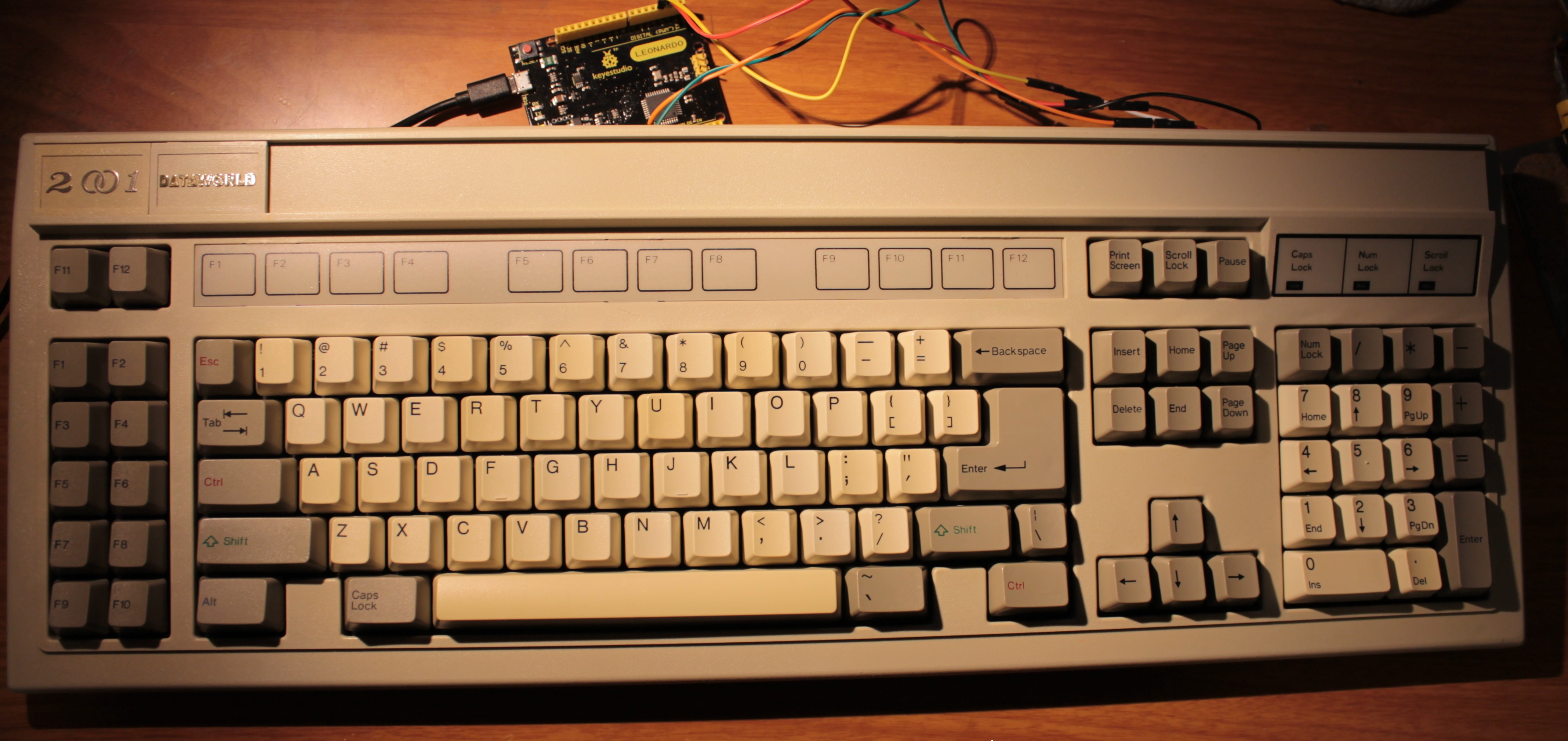

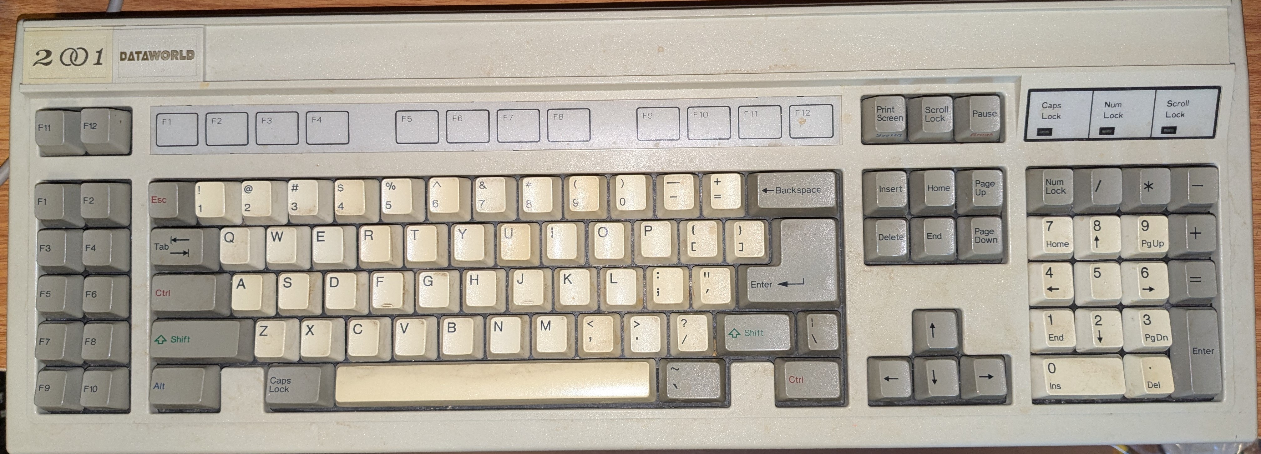

Wow, nice! Looks like a rebadged Gen1 Northgate 102. It sure isn't like any Focus FK-2001 (which used that style badge) that I've ever seen. Any labels on the bottom side that would tell us more?
Just the serial number, the inside says both "Omni-102" and "Omni/101A," along with a Focus sticker stating it was "OK" and manufactured in 1990/7/4.
- Polecat
Thank you. The reason I'm asking is because there are some mystery Gen1 102 keyboards that seem to have been built in 1990, after Northgate came out with the Gen2 models. Those seem to have had no Northgate labels or branding, and were probably sold under another brand name. The serial numbers on these do not use the normal Northgate format. Instead they have a 7 digit serial number beginning with 100, 101, or 102.
Yours is the first one of these (assuming it *is* one of these) I've seen with any kind of badging, and I'm wondering if the Dataworld and 2001 badges came there, or were added later? I've been trying to solve the mystery of how these were branded and sold for some time now.

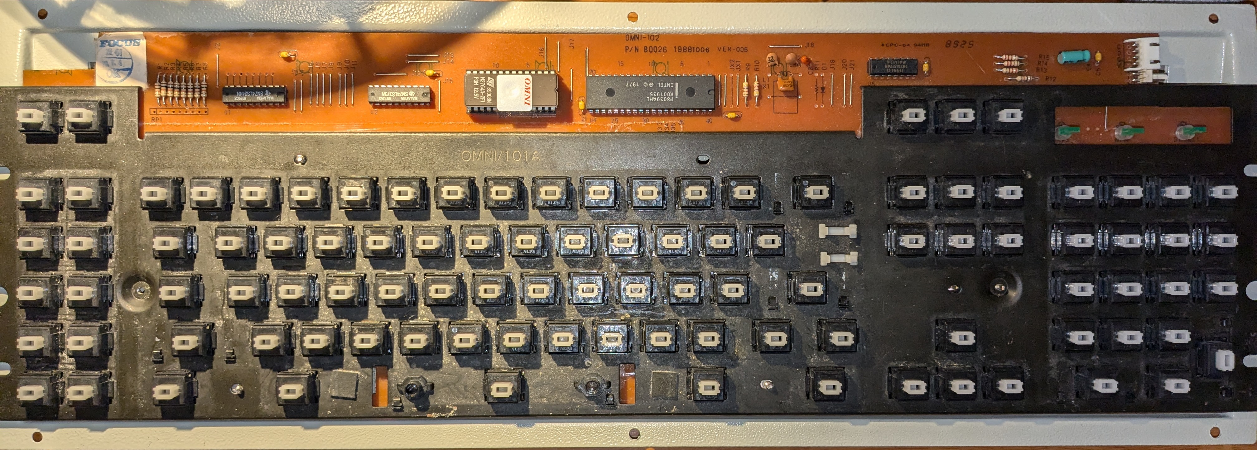

Here's the bare PCB, in case you can make any sense of it. I've cleaned it after this image, thankfully! The Dataworld badge can come off, but the 2001 is either just on there or glued on very tight.
- Polecat
Thanks again. The PC board is the same as the gold label 102 models. I have one of the generic ones myself, also with a Focus label inside. But mine, along with the others I've seen, has no branding at all, just a blank recess where a badge would normally go. No sign of glue or removal marks. One seller of a blank example said his came that way. I have 6 of these on record out of almost 900 Northgates in the database.
Here's an old post with a photo of the bottom side of a generic model. (second photo) This style label is sometimes seen on non-U.S. Focus keyboards, and the serial number falls into one of the Focus formats. We know Focus built the Gen1 Northgates, but these generic 102 boards are still a mystery.

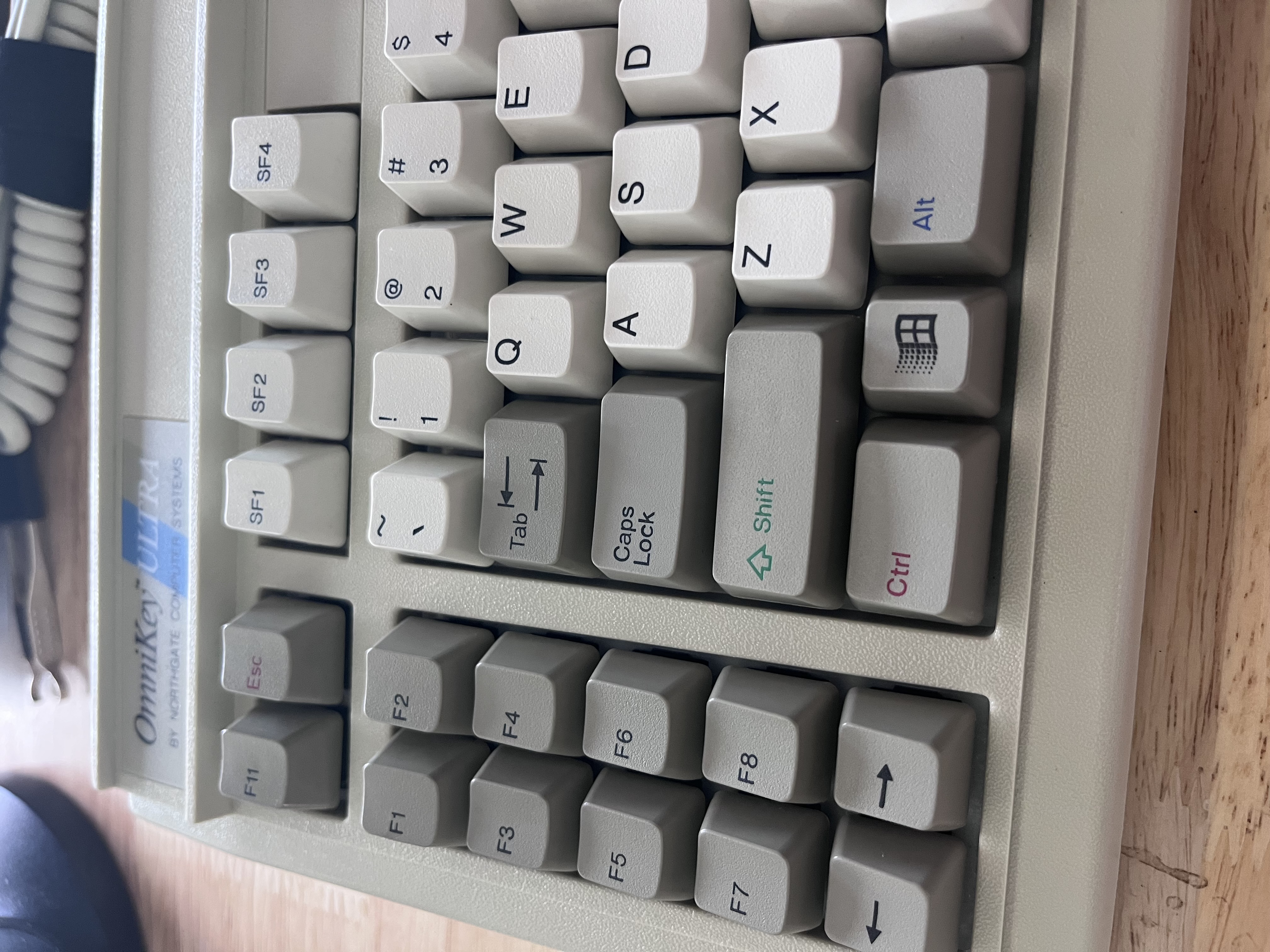

Wanted to show off my Omnikey Ultra with remapped keys. I recently purchased for a comparatively low price and was shocked at how pristine it was (other than an F1 key switch which had completely shattered and replaced from a donor) I pulled the implanted keycaps off an Omnikey 101P I am in the process of restoring (hence the windows key). As this is now my daily driver, I wanted it to be as functional as possible.
